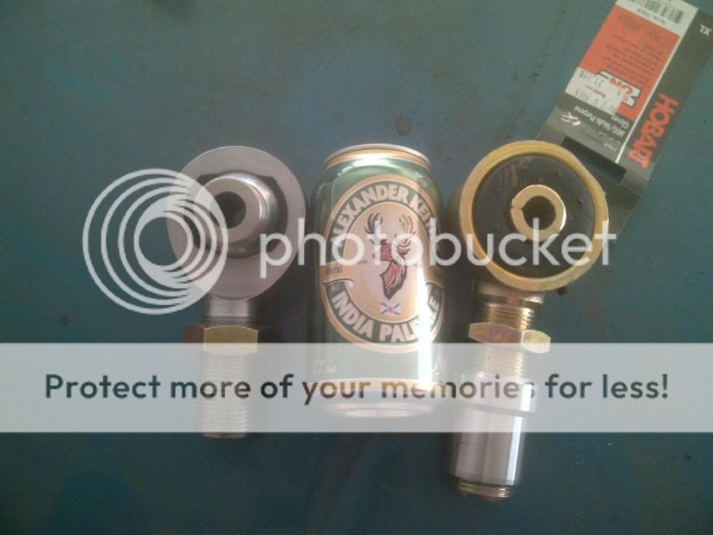

Small update...got some parts in the mail. A pair of 1.25" shank forged bushings. Here is a picture next to a 1.25" heim, and beer can.
Rangebe...version 2.0
Any guesses where and what Im going to use them for??

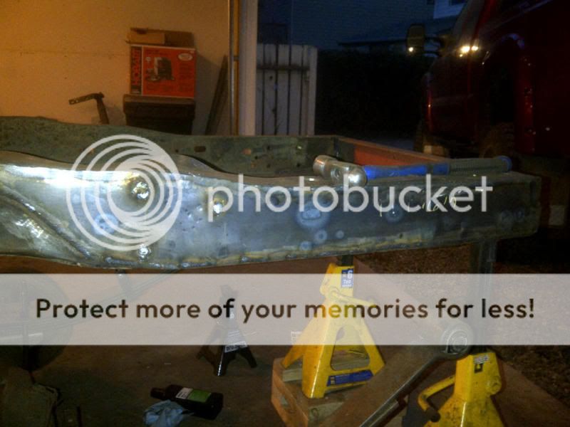

I'm just messing with ya. Everything looks awesome man. I love all the plate work. How did you get it to form to the metal?
:thefinger:
I dont have a torch, so I used what I had...a large bicep and a ball peen hammer :D

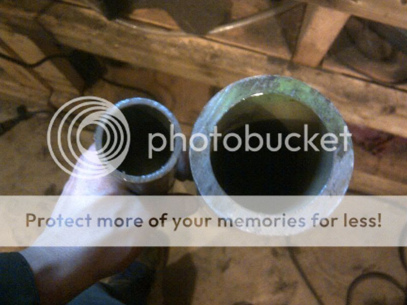

Got a bit of time to start on the radius arms, and also got my 2" 0.250 wall DOM home.
Most dezert guys make their rad arms out of 1.75 0.120 wall DOM, however, I build things for the apocalypse... this is 0.250 wall 2" DOM vs 0.120 wall 1.5" HREW......

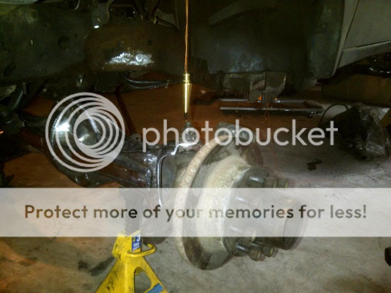

LOTS of measuring, fitting, and adjusting the placement of the beam.

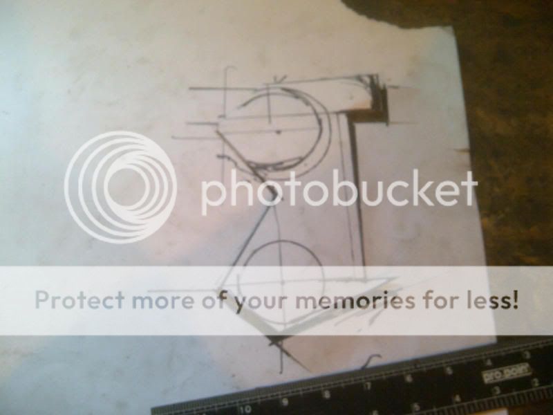

Some math and measuring later...template and arm mount. These are just the initial cuts, still need to be rounded off. Remember, all I have is my angle grinder.

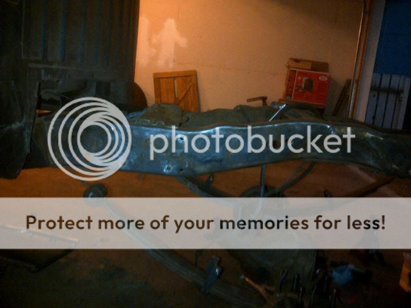

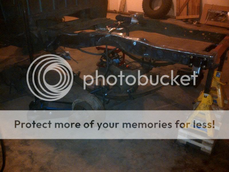

Been busy working on my house, but got a bit of time in the shop tonight. Wire wheeled the frame (ughh) and prepped for welding.

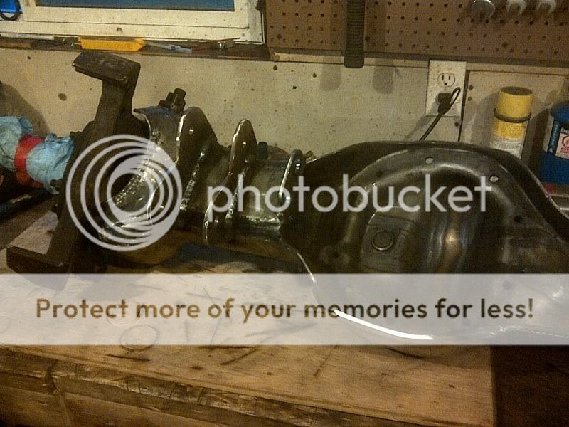

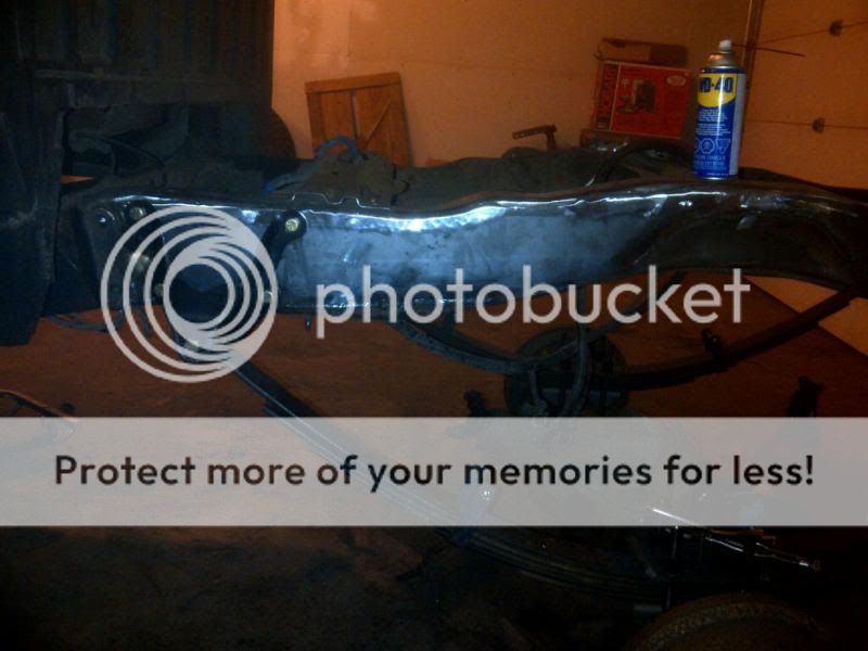

Made template, cut out steel (1/8") and welded in place.
Front section

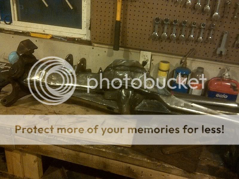

Plated, and holes drilled for front hanger

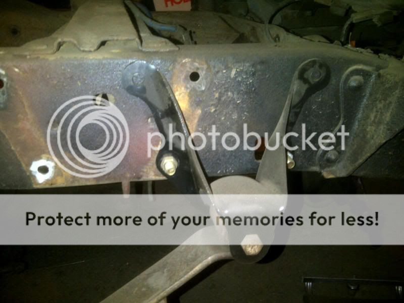

Here is a stock hanger

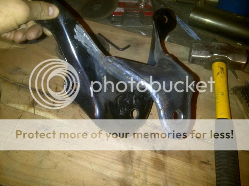

And the start of my modifications to them.

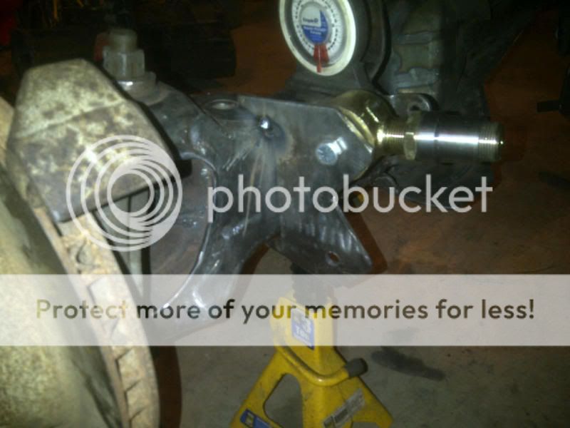

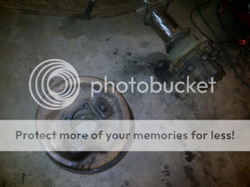

got the drivers side bolted up.
and tore the brakes off..what a pain...

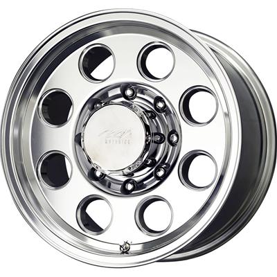

wheels on the way...
17x8.5 4.5" backspace.

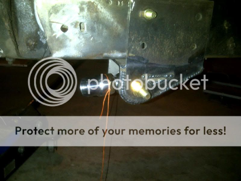

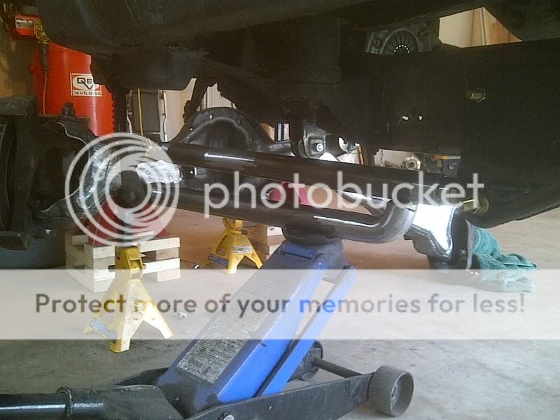

radius arms mocked up so I could start on brackets.
brackets done and burned in

Just need my rims and I can finish weld the rad arms...
