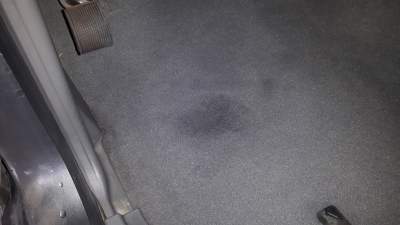

I've been having an on-going issue with a rain water leak. Just to give a bit of history, I noticed it a couple of weeks back. I dried out the carpet and continued to monitor it closely hoping I could see some sign of where the water was entering from. The only collection point of the water is the driver side floor.

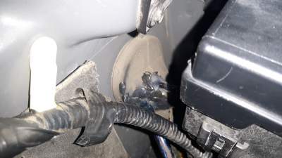

Another idea I had was that my amp power wire and alarm hood pin wire were to blame. They are both going through the firewall plug and hadn't been properly sealed with silicon. I have noticed quite a bit of water flowing under the hood and it could have been possibly dripping on to the wires and flowing through into the cab. So I caked 'em with sealant.

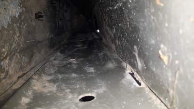

I thought that it could also be one or all of the drains on the corner panels, even the long hollow channel that follows the panels under both sides of the cab. They were both completely caked SOLID with sand/dirt. It took some scrapping and blasting with the garden hose, and I managed to get that clog-free.

I removed some trim and pulled up the carpet. The drain plug is still nicely attached in the floor. There was no water trail anywhere. One of the first places I checked was the third brake light. There really doesn't seem to be any water flowing from it. No wet carpet other than drivers side floor.

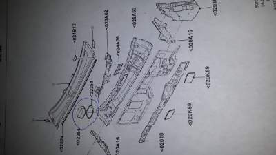

My other thought is something to do with the wiper blade cowl. From the looks of it, it is welded in place and not easily removable. I figured that dirt/debris have maybe clogged proper drainage within. No way to tell though.
I do have a diagram from a parts guy at Ford and it shows a plug/gasket within the cowl assembly.

Water accumulates at lowest point; as driver & gas tank are on driver's side, that is usual the side that water shows up.
The "usual" suspect for water ingress is the rear window/rear brake light. Then, it just flows to lowest spot.
Not to say you might not have another leak; but I would start at rear window...
