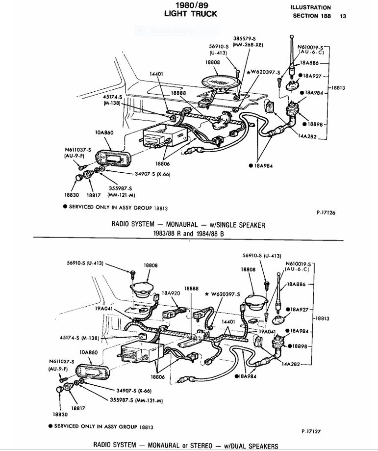

And these drawings from the Ford parts catalog:
Radio-speaker set up. 1st generation, short cab
The radio in the drawings is the 1983-84 version; single DIN came in with the '85 models.
Did they reuse the center speaker location for the transfer case shift module? That looks exactly like where mine was.

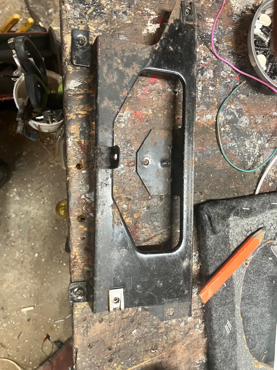

The OEM speakers behind the seats, in those plastic boxes that are about the size of a loose leaf binder (that taper), are worthless. I put in new speakers, about 5 x 3 (the actual speaker in the OEM box). I sliced the face off and replaced it with a flat piece of half-inch plywood that holds the speaker, and covered that with thick felt to protect it. They sounded pretty good when I hooked them up and checked them out, but when you fold the seat back, it’s almost flush up against their output face, rendering them useless.
Those speaker boxes sit on top of a stamped metal frame about an inch off the floor. And remember that the cab humps up behind the seats.
The speakers are about as long as the opening in the middle, and a little bit wider than that bracket. My plan is to build a tiny plywood box, maybe an inch and a half tall, that holds the speaker, with the magnet hanging down into that opening, so the speakers are as low as possible, facing upward. Down low, the seats won’t be smothering them, I hope. If they’re still muffled, I’ll move them to the doors.
