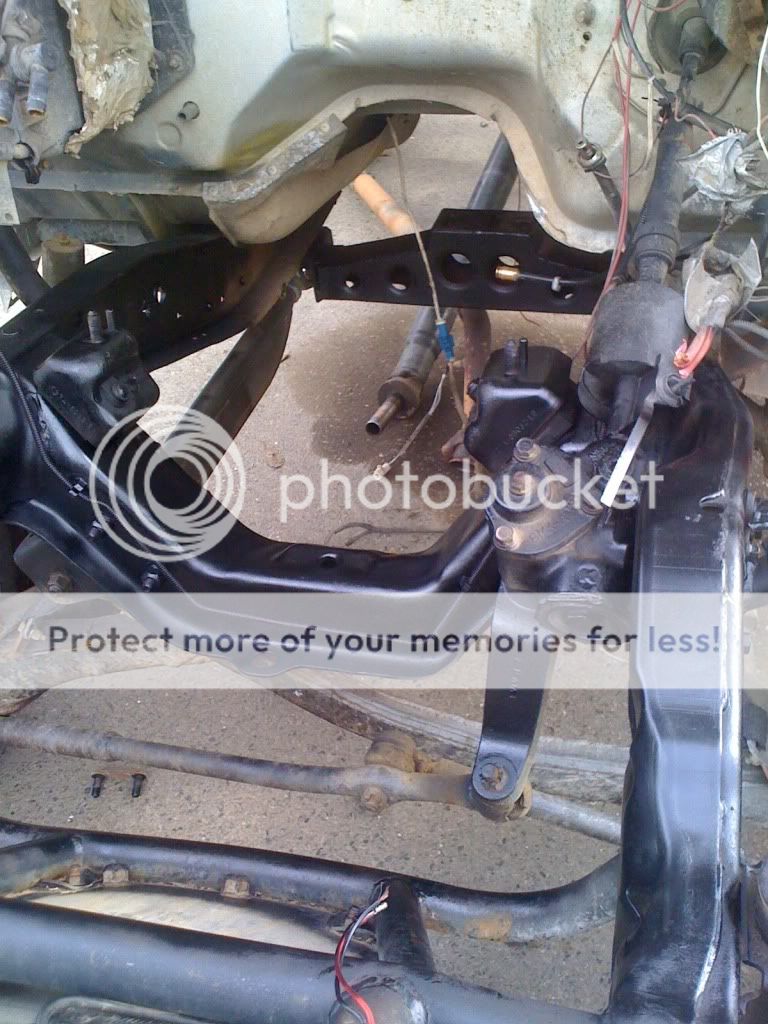

Today I cleaned up the frame and put the motor in:
Are you going to try and set the motor back any, or are you putting it in the stock position?
I was thinking about it but I would have to re-do my tranny x-member and chop up the fire wall a bit. Ill save that headache for the other race truck with the V8.

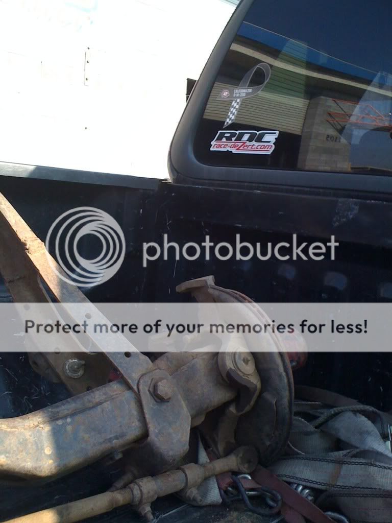

Went and got a set of D44 beams to start my equal length.

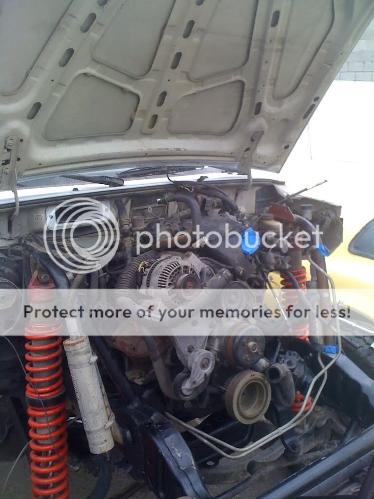

Started plugging in the 4.0 as well, because we are goin crazy with the other truck I decided to tie the stock core support into the engine cage to hold up the lights and what not, makes it a little more simple.

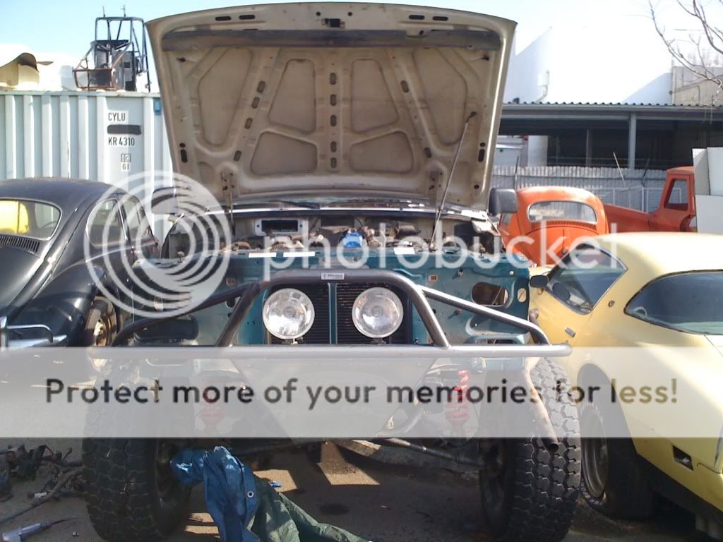

Still have to do the tube work in the engine bay but the motor is almost ready to start. Should be mobile here soon.
So why did you flip your shackle hangers up side down on your rear suspension? Is that for stability?
IIRC, mainly for travel. A lot of people run the Belltech 6400 extended shackles for more movement without using lift blocks, and the desert guys also flip stockers it for stability, lower center of gravity, and some other stuff I just can't keep up with.
