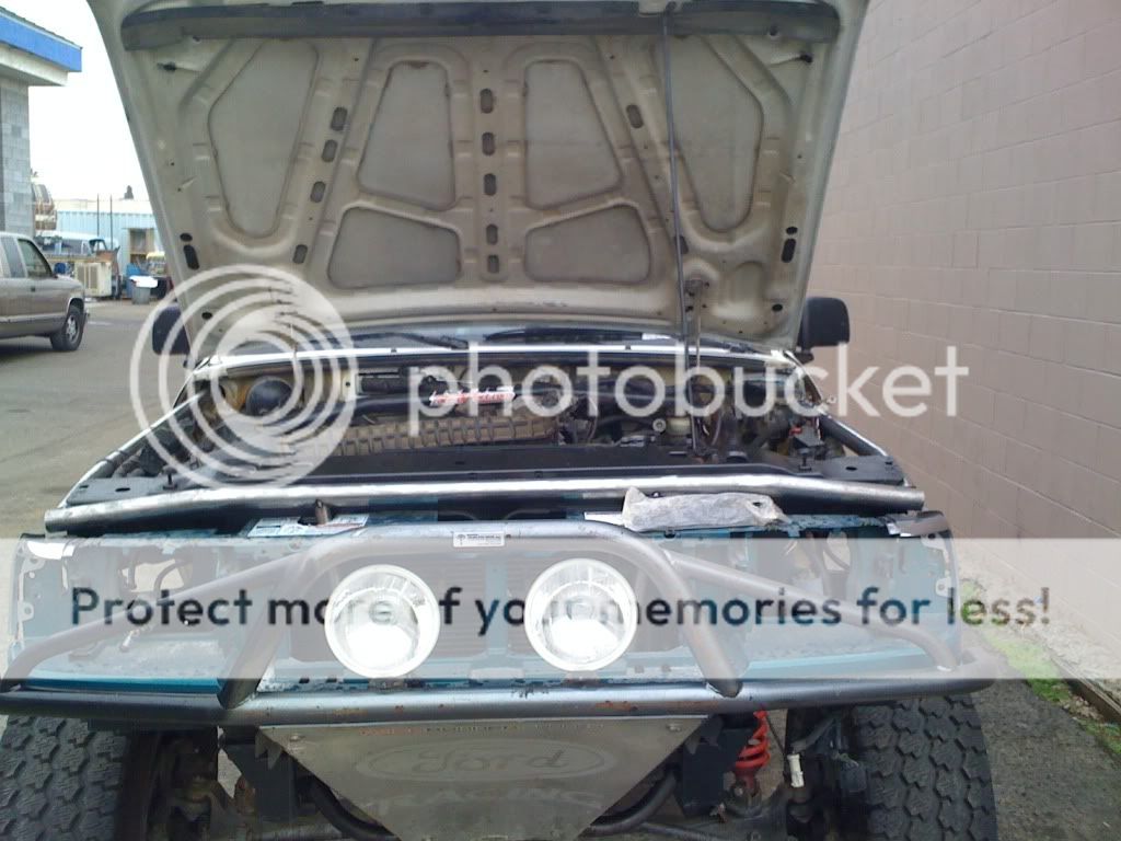

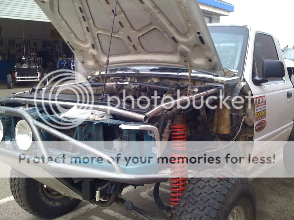

Started the motor finally! Soo much better lol...still have alot of little things to do to make it run right though. Also still trying to figure out how to do the shifting linkage and control over drive. Added more tube to the engine bay as well. Gotta make some room for my equal length brackets and cross over steering.
why remove the smog stuff when your making it. if you just leave it then you wont have any problem.
Aside from exhaust and charcoal canister the motor will stay just as it was in the other truck. I actually already mounted the canister and may leave that even.

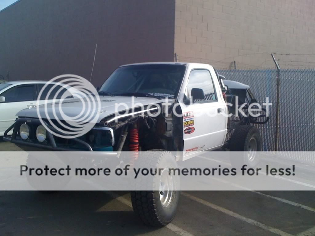

Been a while since i have posted. The swap is done and it drives great, can't believe how much more power it has with the 4.0. It really winds out quick with no A/C, clutch fan, or power steering. Aside from that all i have really done is order parts.

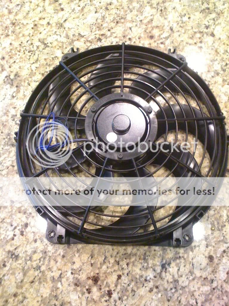

ordered a B&M Zgate shifter, 16" 2100cfm electric fan, and a New red-top optima.
