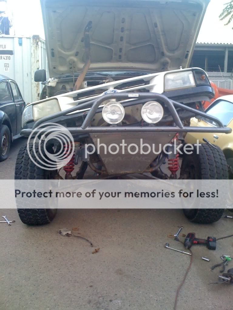

are you going to link it when the 9" goes in? And when you swap the 4.0 will you have to adjust the shocks or will they be alright?
not right away but yes it will be linked..Yeah I am going to have to change valving/spring rates up front. I might be able to add bypasses, we'll see. I havent decided if I really want to dump a ton more money into this truck yet. But D44 equal length is also going in after the motor. If im going to be driving even harder/faster with a heavier motor, I dont feel comfortable on the 2wd spindles.

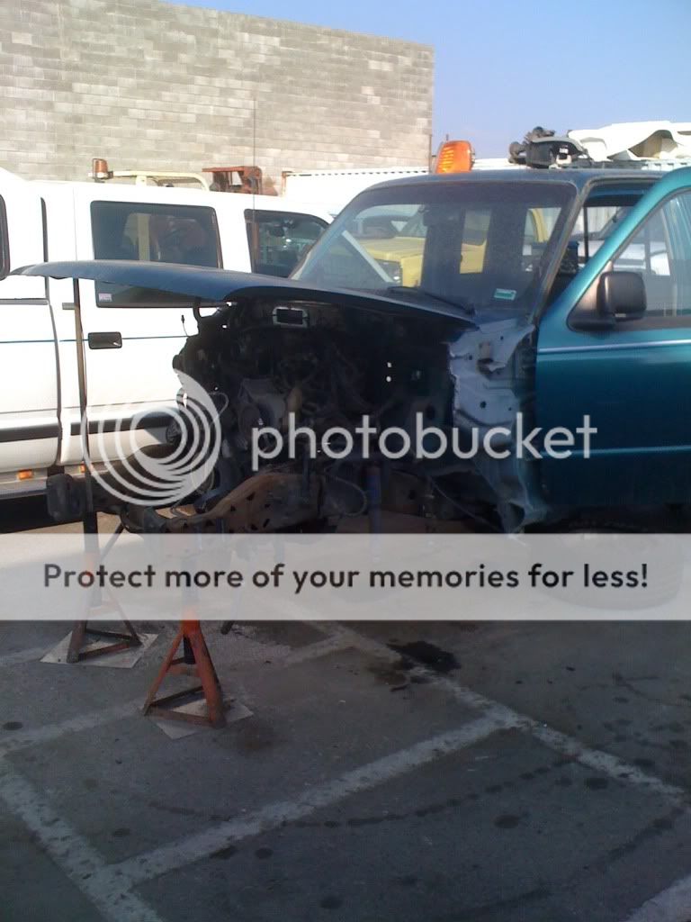

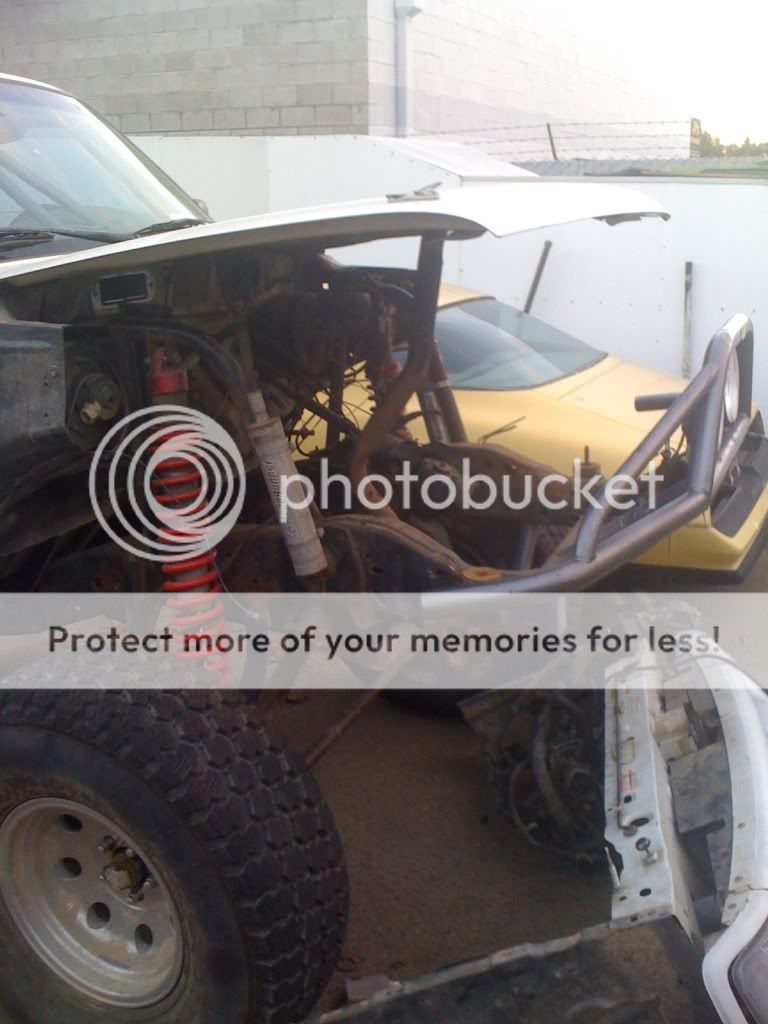

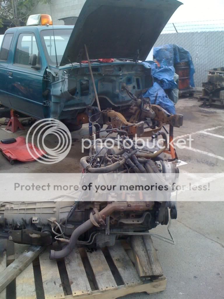

Stripped the 4.0 out of the other truck, now I am deciding whether or not to cut the front inner fender wells and core support off and redo it with tubing.

Your 97 is looking really good, glad to see your upgrading to a 4.0. You gonna rebuild it or just drop it in? Are you keeping your Ranger a 5spd still?
Oh yeah you gonna replace your parking?
Thanks man. Because it has low miles and ran so well, i dont think I am going to tear it apart just yet. I am putting an auto in it for now. I will either go back to a 5spd or build a C4 down the road. Replace my parking??
