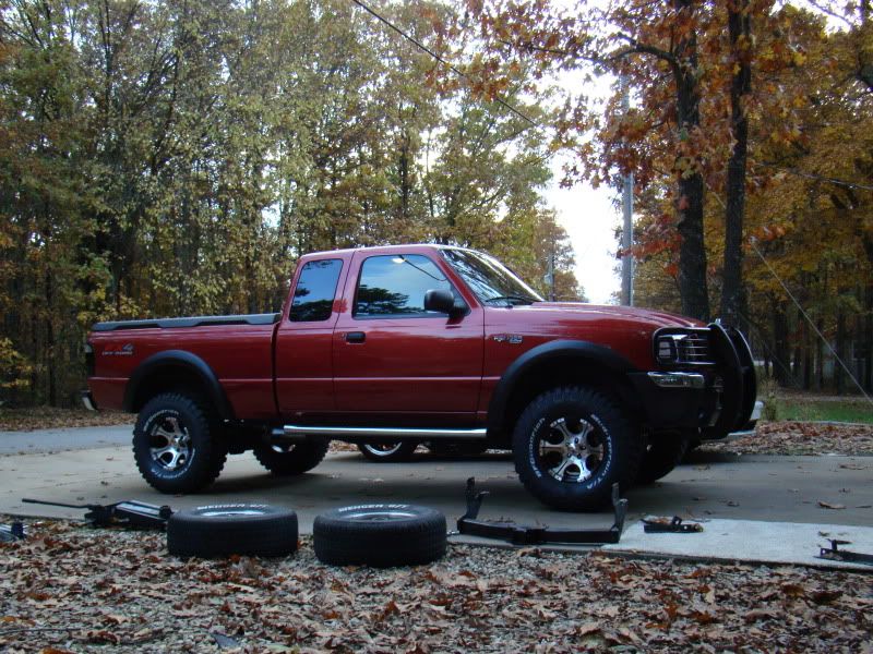

and for what it's worth, here's 3" bodylift and 32's....
^thats a sexy truck:icon_cheers:
