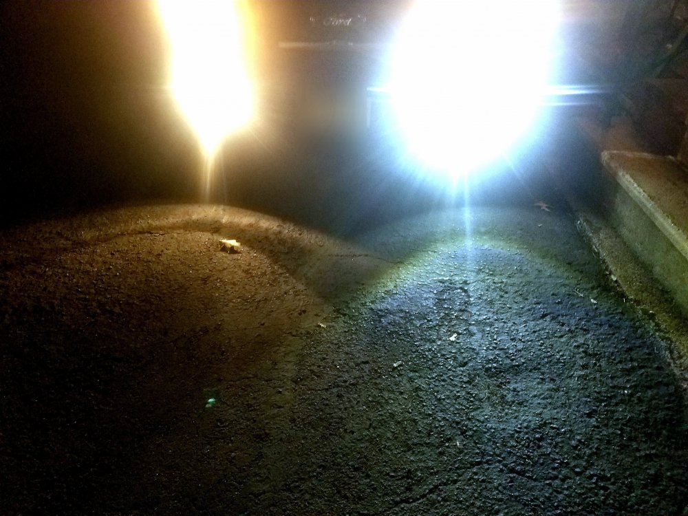

Left, standard halogen. Right, 6500k led. Notice how much better you can see the ground with the 6500k light.
