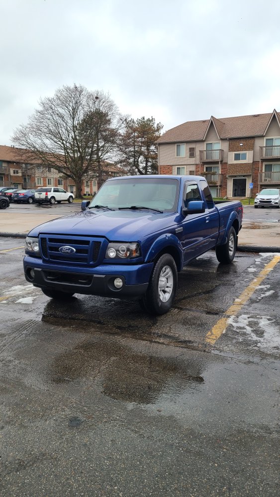

Does anyone recognize these headlights?
The adjustment screws don't seem to do anything. I'm thinking I need to replace them, but with an aftermarket setup like that I'm not sure if they have the original wiring.
They are probably cheapo Ebay specials.
Id replace them anyways if for nothing else they are a fire hazard
There are lots of those out there.
I would guess that the factory wiring is unchanged... but you'll have to dig in and find out.
I've chose just to keep my factory light housings.
Are the factory housings two pieces? Ford said they're discontinued, so it looks like ebay or junkyards
Most aftermarket lights just plug into the factory harness.
Those look like EBay/Amazon specials. The adjusters on the aftermarket stuff are sketchy at best and flat out don’t work at all half the time. I’m running aftermarkets on my green Ranger (2000 but I switched to the 01 style front). I greased the adjusters to keep them from sticking in hopes that they would be adjustable for awhile
Yes, side marker light is separate in stock and most aftermarket lights for your vintage
While at it, replace the headlight bulbs with HELLA H4 100/80 W bulbs. Yes, for off road use but sure are nice for night driving.
