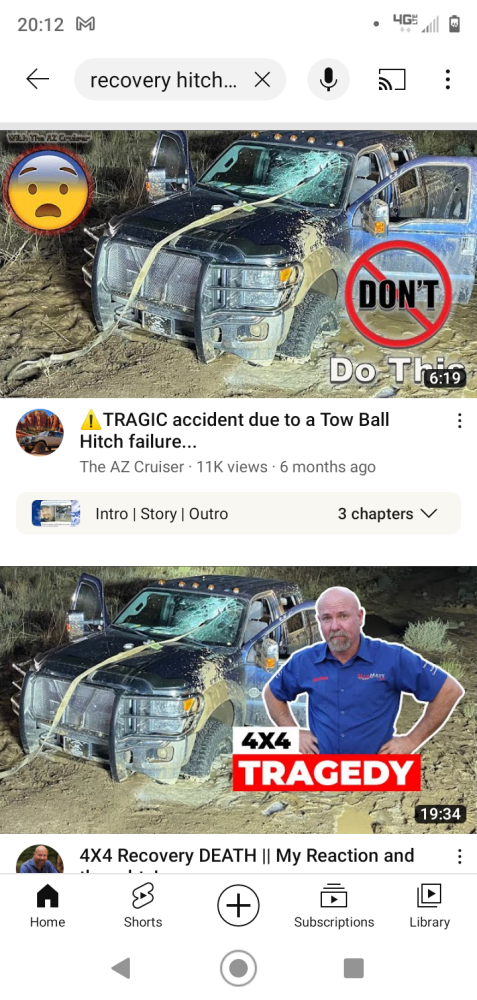

Take a look at this then consider the options.
I figure at minimum gear needs to be 2x vehicle weight if not more. And on that note I never pull without a weight on the strap/chain to drop the kinetic energy.
I actually had truck that looked just like that. But I saw situation unfolding and laid down across the passenger's seat, so just got covered in glass pieces. Cost me a good windshield and my wife doesn't like towing with me anymore. But I'm not part of the "selfie" generation, so there's no proof it ever happened.
There is a point at which most of us need to admit that we are not tow/recovery professionals, that some jobs are better left up to them. One of the members once suggested (on another thread) that we should practice first.
I would never have thought this needs to be said, but avoid using that hitch ball, especially for difficult pulls.
Practice isn’t a bad idea. Get familiar with how the equipment works before you need it instead right when you need it. Getting assistance from someone who has experience to teach you and point out tips and tricks isn’t a bad idea either.
