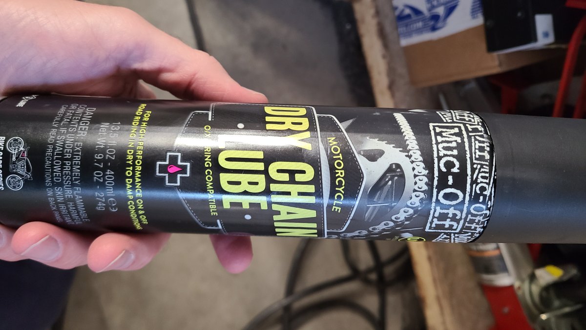

Here is what I have on hand.
I have this for the motorcycle chain. Not sure how well it would work on the wire rope.
I'd think spool it all the way out and get all the tension off of it, then use some type of cradle to slide along the bottom to hold any spillage on it longer while making way with the oil to the end. Maybe leave it overnight to allow as much as possible to soak in and bond, before spooling it back on as tight as possible.
