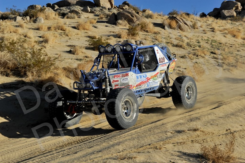

This is what I'd do for a go fast rock crawler.:thefinger:
