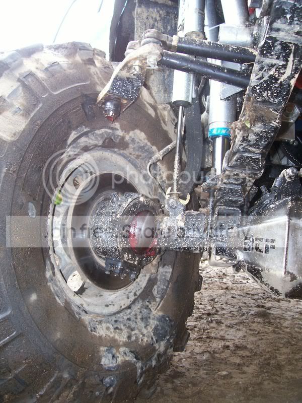

i said WHEELIN, not rock crawling, there isnt a drop of mud of those rear and no mud residue, they arent rock crawling axles there real wheeling axles, considering it looks like he wasw goin down a drit road and that happened its not wheeling, if it was completely covered in a few inches of mud then i could see that i broke while wheeling, to me it just looks like someone didnt build the axle properly and put EXTREME stress on the axle itself

Oh, you're one of those.. yeah.. muddin ≠ wheelin. Sorry for the confusion.
