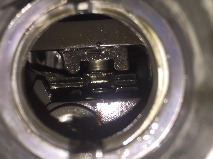

Last picture shows 2 of the shift rails aligned in Neutral position, there are 3, all 3 need to be aligned for trans to be in Neutral
Make sure wheels are blocked when shifting trans manually or it WILL roll away on you, lol.
You usually need to rock the truck back and forth to release pressure on shift rails(gears) to get them to move to Neutral position.

Thanks Ron for the detailed reply, I think I've gotten a reply from you also on ranger-forums haha. Anyways, I've taken the shifter out and this is what is revealed. Anyone got any input on it? Car was in neutral when I took it out.

Looking down in the shifter hole you will see the 3 shift rods each has a shifter slot that needs to lined up with the others in the middle, and thats neutral
Each rod also has a Shift Fork, in Neutral position each Fork is Between its respective gears, 1 and 2, 3 and 4, 5 and Reverse, nothing engaged
This setup doesn't allow you to shift to another gear unless the 2 other shift forks are in "neutral position"
Shift forks and shifter slot are held on to shift rods by Roll Pins.
A roll pin can come out or shear off, this will lock transmission in gear, because it can't be put in Neutral position to shift to another gear.
Sounds to me like it's stuck in 4th or maybe 3rd gear, regardless of what the shifter and shift rail looks like (it's in the correct position for Neutral in the pic above.) That would explain why it tries to stall out in neutral when you let the clutch out, because it's not actually in neutral.
Pull the trans, remove the top cover and I bet you'll find a worn out or broken shift fork or roll pin like RonD said.
