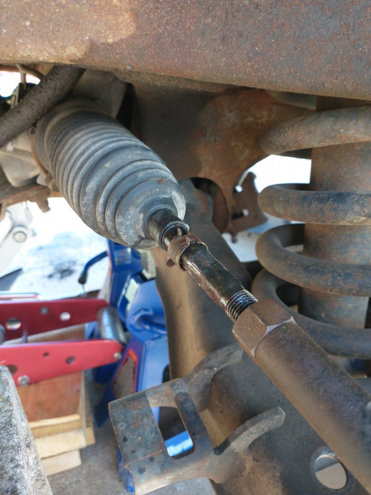

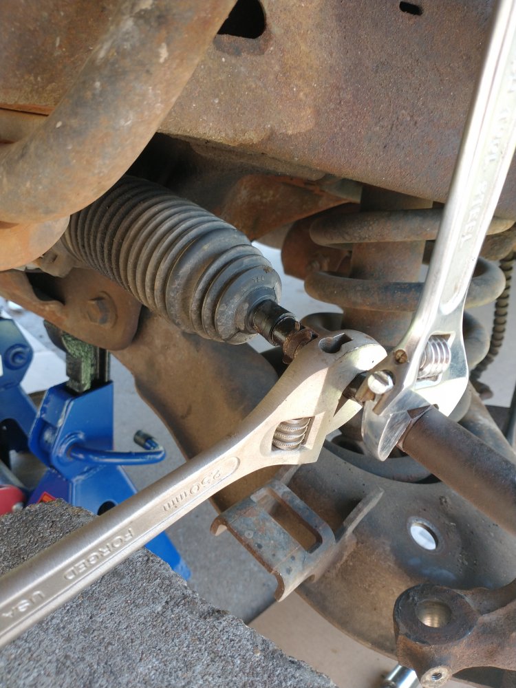

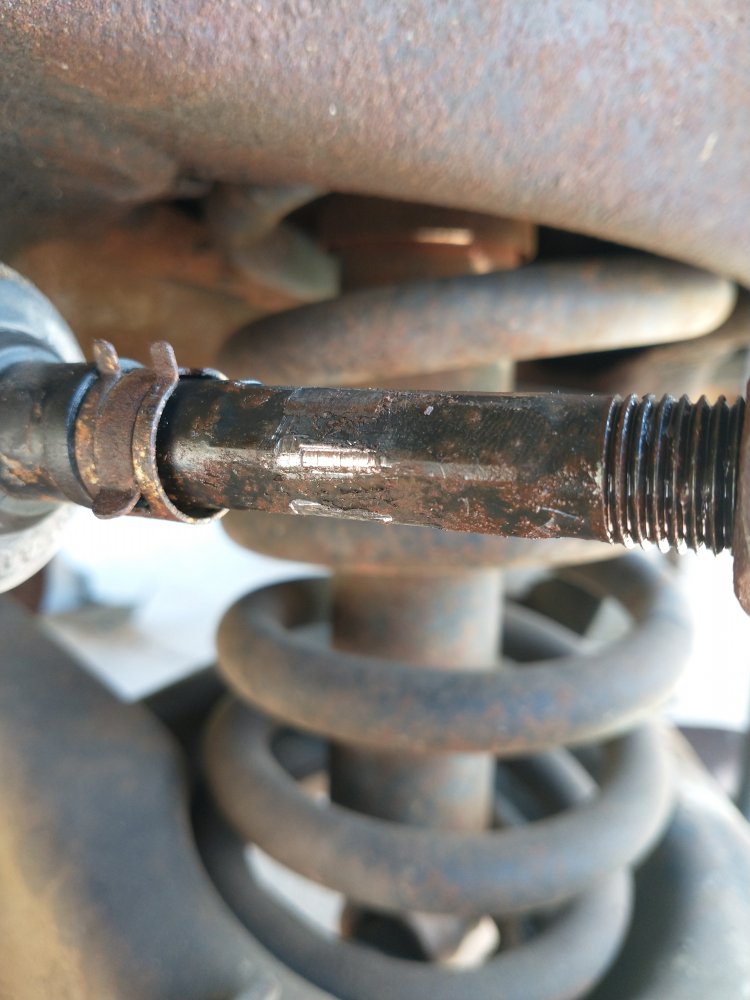

So I am just rounding the inner tie rod trying to get the end off. Ideas?
Do you have the proper inner tie rod tool?
I am using 2 wrenches. I thought the inner tool was for once I got the end off. But I am replacing the inner so I can just try to take off the inner with the end attached correct? I am also replacing the bellow as well
What else you need?
