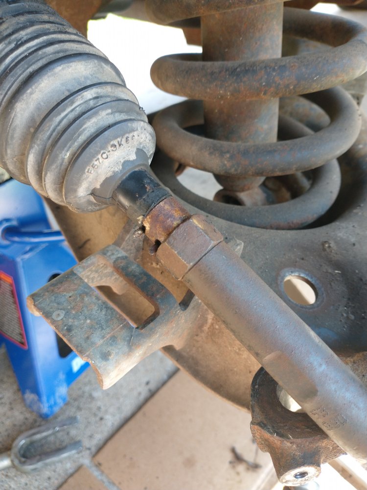

Did you loosen the locknut from the adjusting collar?
By the way, some of the threads in these assemblies are left-hand threads.
Go with what Dirtman said.
Locknut? Adjusting collar? This?
