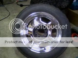

I mocked up a wheel from the Ranger on my S10, they look pretty good on there IMO.
Opinions?
Eventually I would like to go to a newer style wheel. I'll make sure to get it in a universal 5 lug with 5x4.75 and 5x4.5 just so I can put it on my Ranger when the S10 blows up on me. These rims are American Racing Hammers from the early 90's, lol.
Here's how they look once you clean them up..
They DEFINITELY need it.

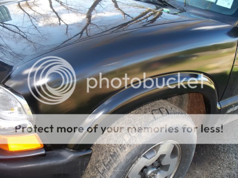

I also started painting those fenders. I know it's gonna look like crap, but whatever, it's a beater.

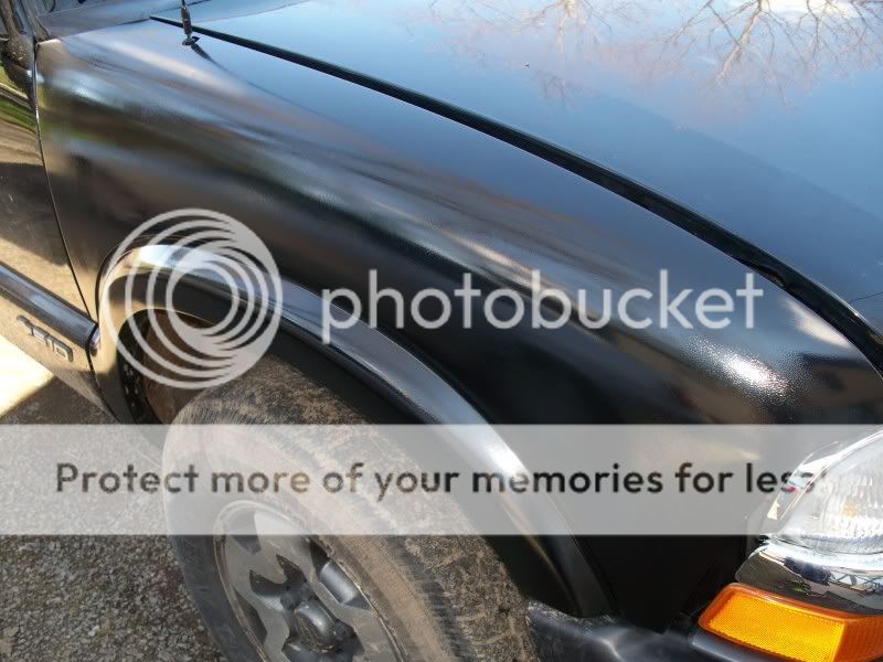

Paint!
Looks a lot better. I was going to align the fenders better but now I see it's the way they're made. Damn cheap ebay fenders! I'll have to keep an eye out at the JY for a pair of fenders.
