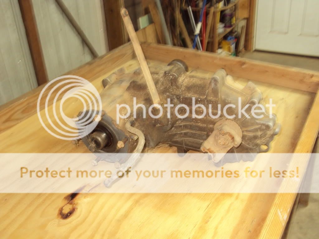

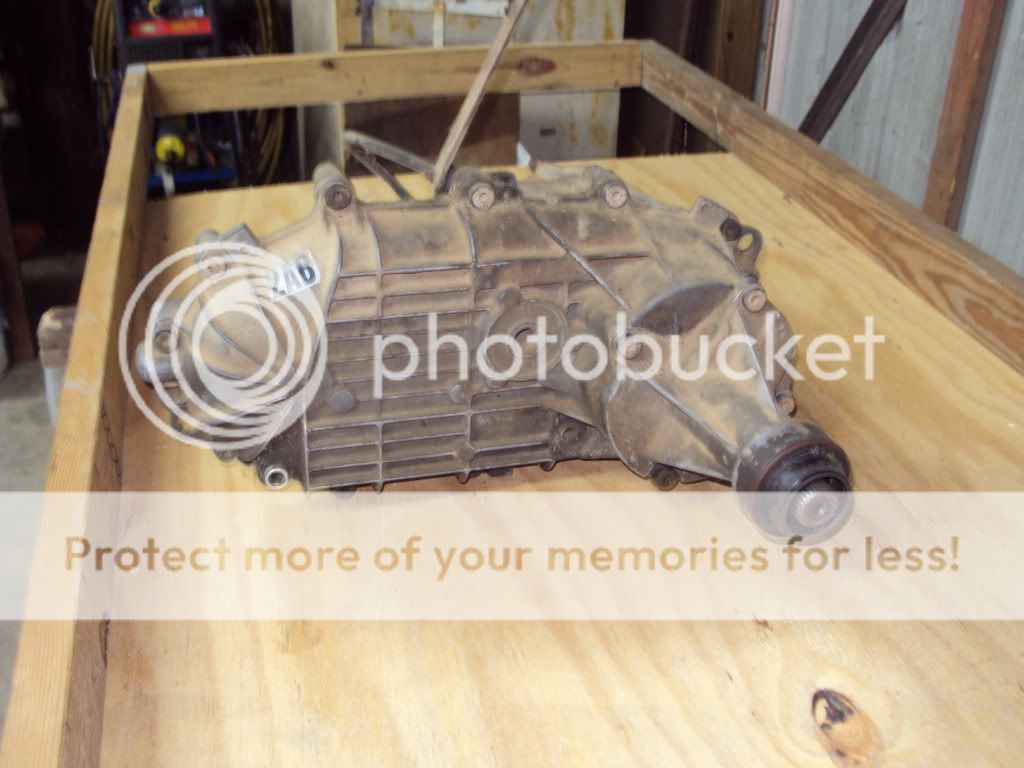

What I have here is a 1356M from an F-series truck...
Oops!!

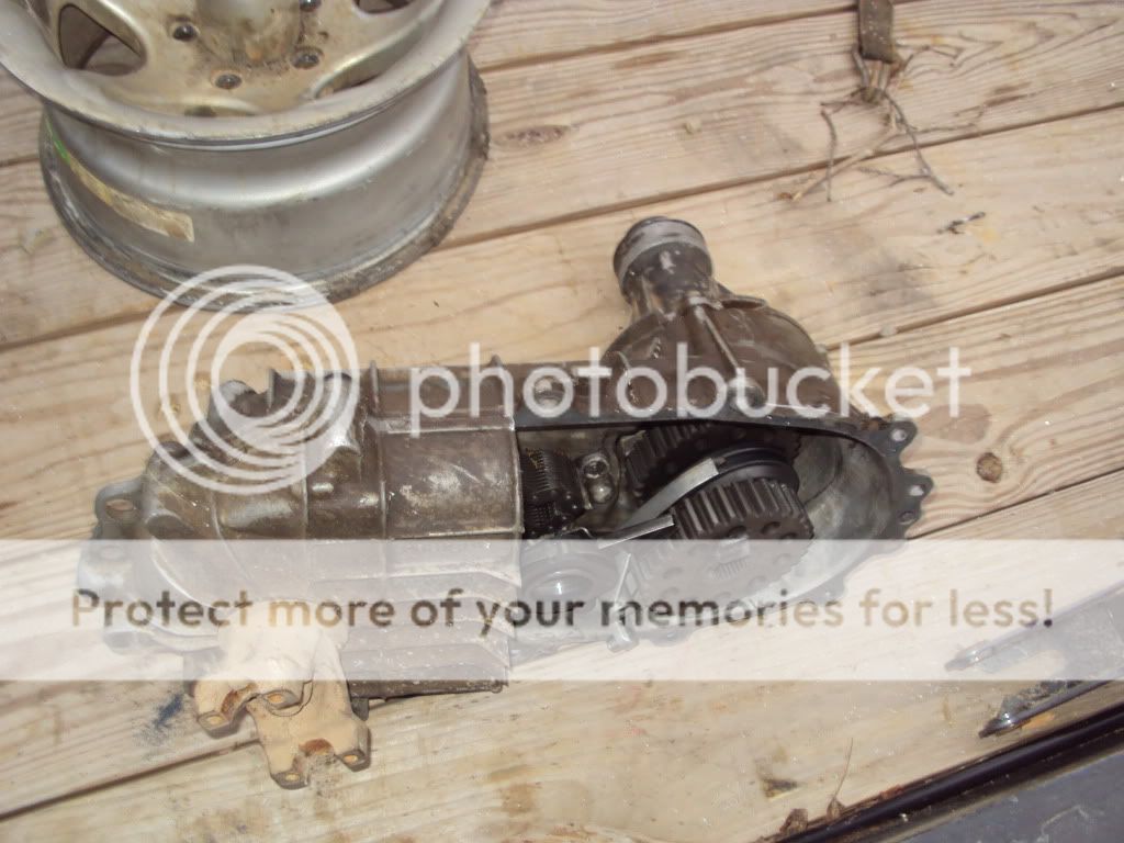

And this is whats left...Anyone need parts??

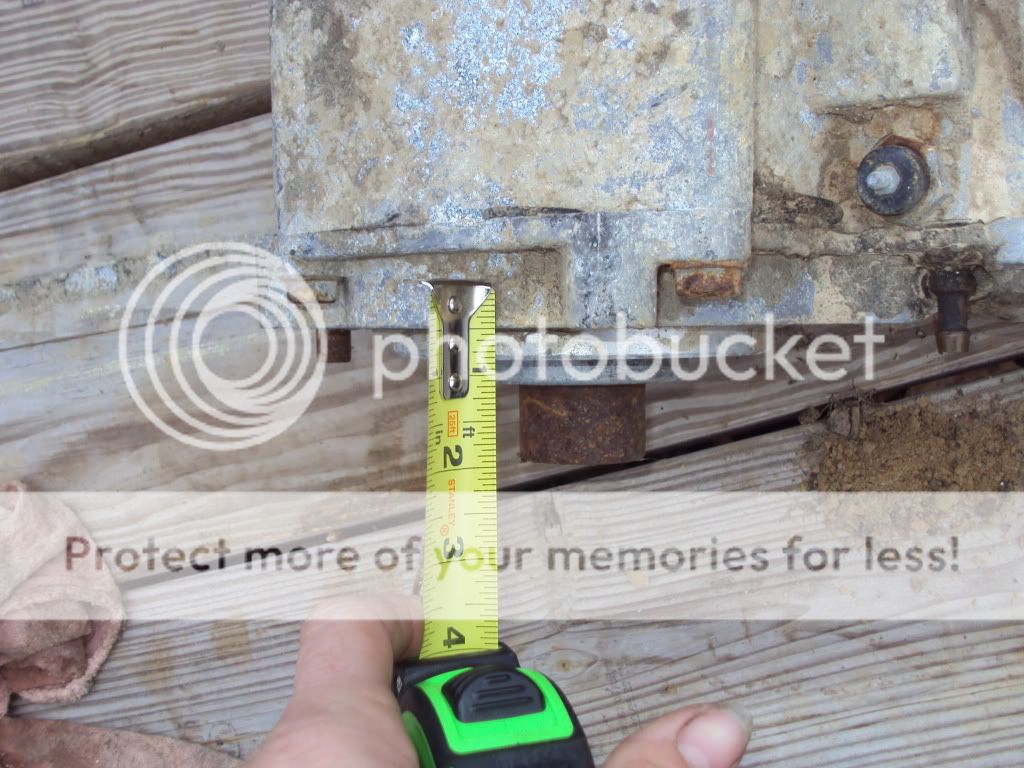

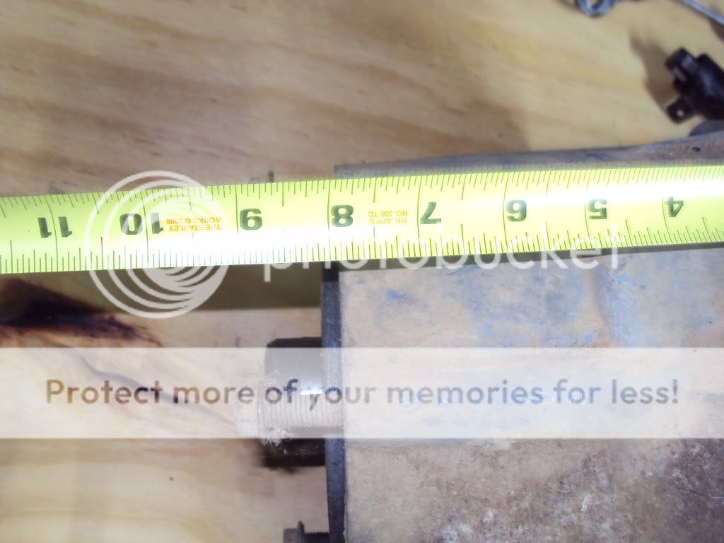

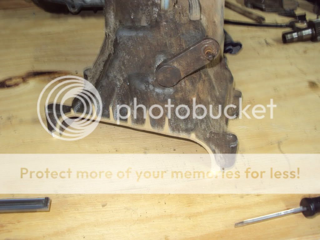

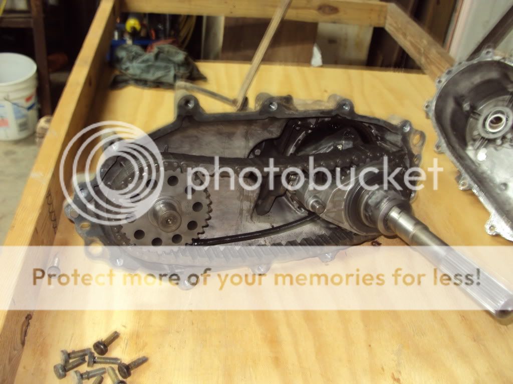

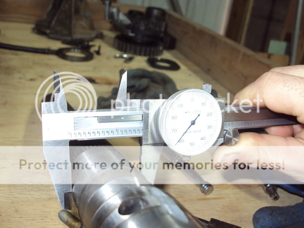

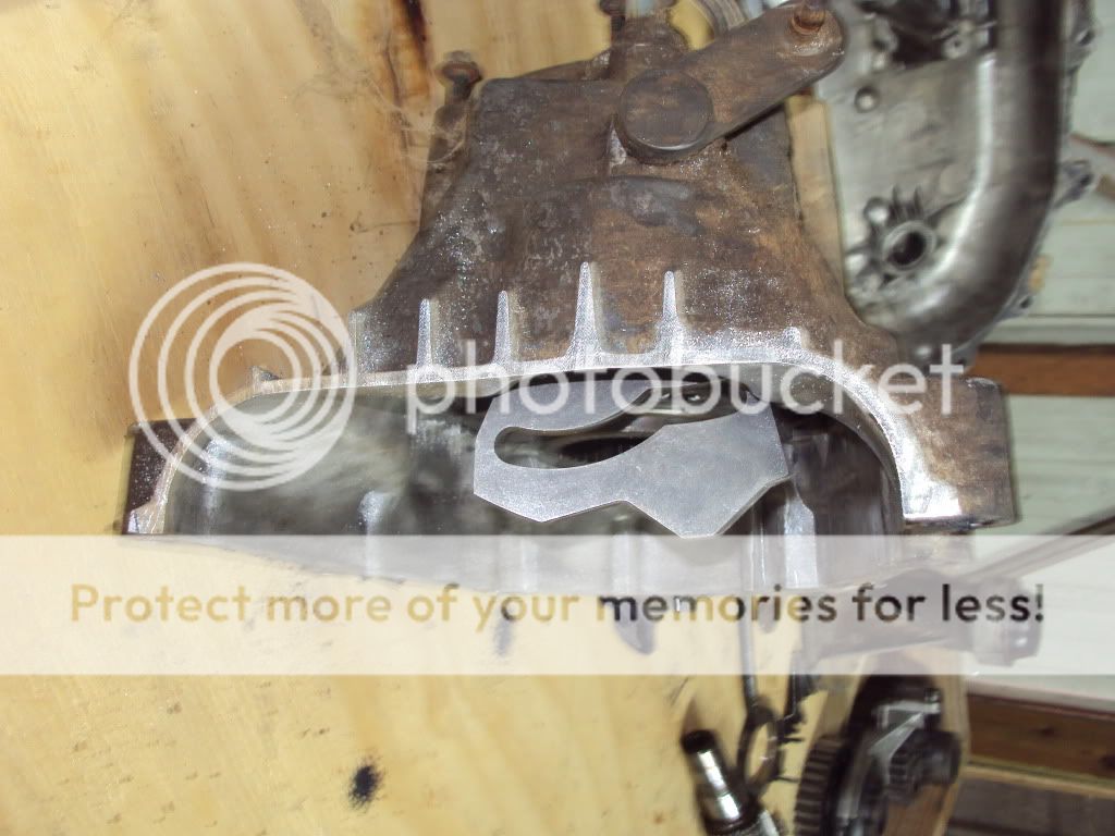

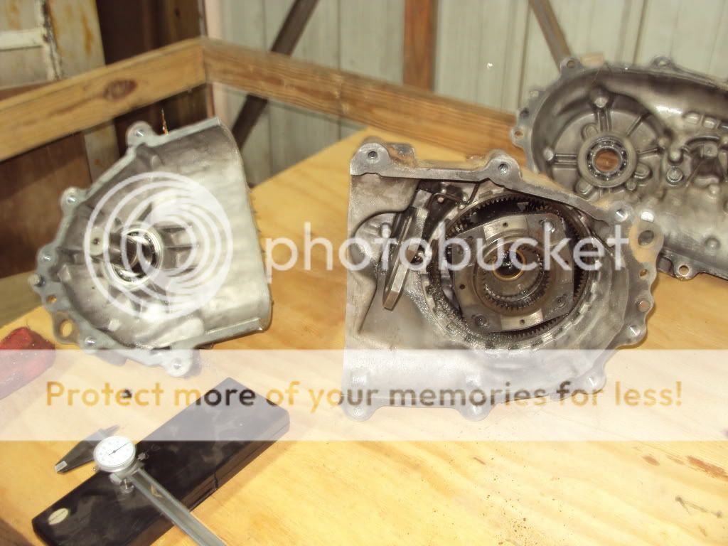

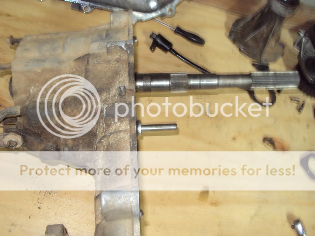

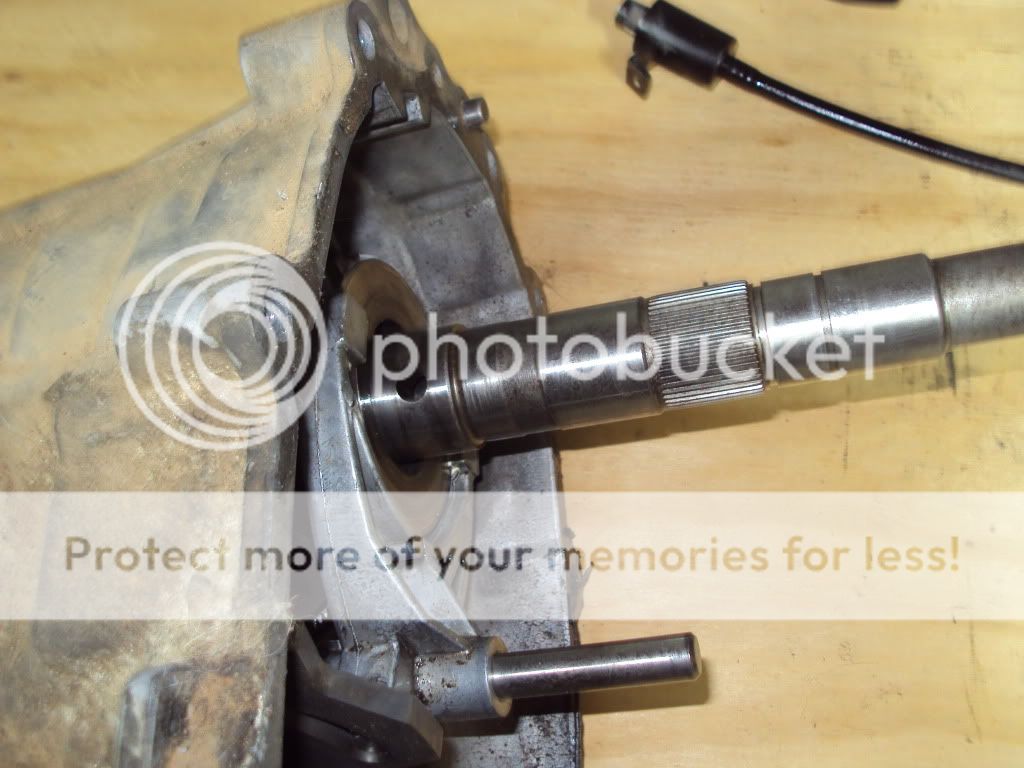

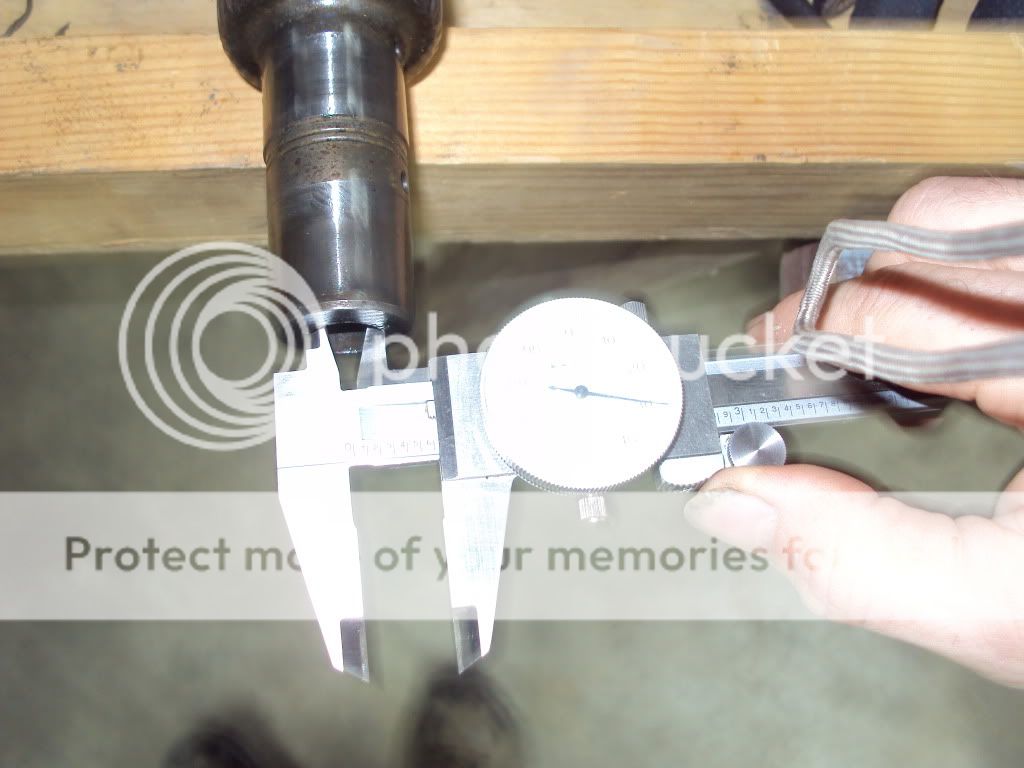

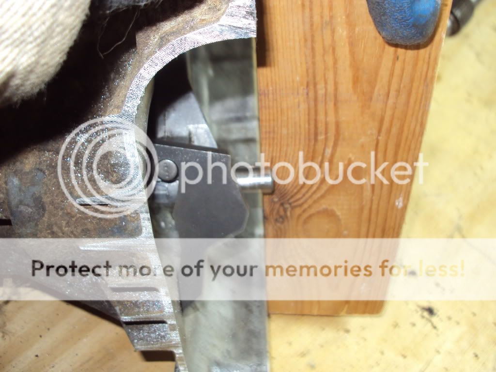

As you can see I started my doubler build. I took a bunch of pics and measurements, and then I took even more measurements...I have most of what I need figured out. I sectioned the case, cut the shift rail rod, measured the main shaft of how much material I have and where I have it and where I need to cut, measured a 1350 ( I don't have a 54 available for measurements, its in the Sport Trac) for shaft diameter and length, as I don't have the output shaft from an RBV trans yet available, its also in the Sport Trac...My reduction box will be 7 7/8 long, with either a 1/4 or 1/2 plate between the cases. My intermediate shaft will be 8.750 inches long. I haven't yet measured where my Tcase will be in relation to the fuel tank, but I'm sure I will need to mod it. I'm thinking of making a new fuel tank out of 1/8 diamond plate (only cause I already have the material) and taking advantage of my body lift and making the tank 3 inches taller as well as XX inches shorter for the doubler...
