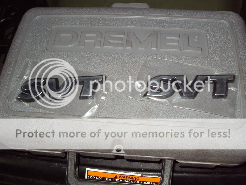

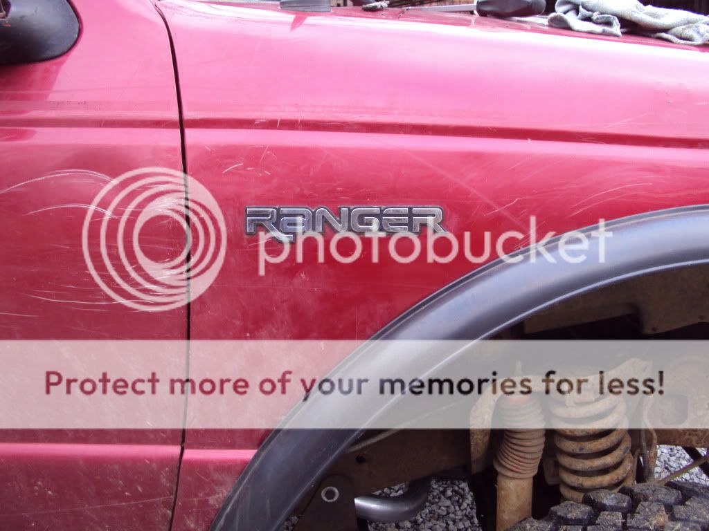

No, but I ordered these after the shop closed, didn't take but 10 minutes, wish the low range case took that long :annoyed:
Good one Copperhead!!
Low range, who needs that when ya think you can throttle over, through, around anything with a V8. We'll see how that works out..

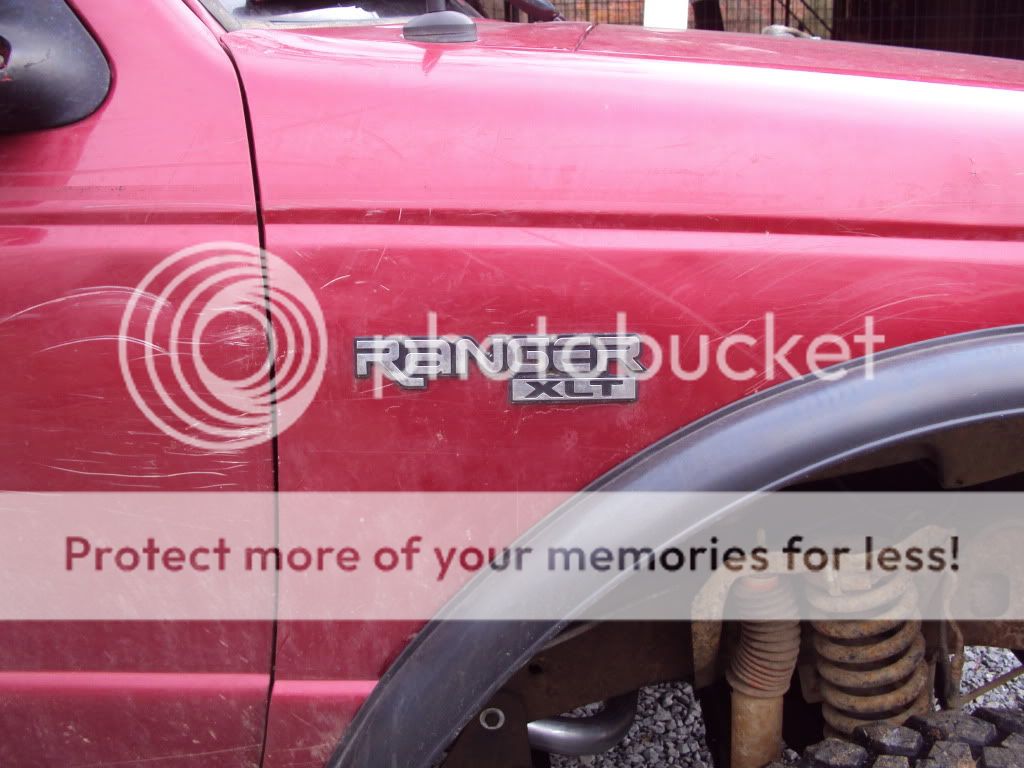

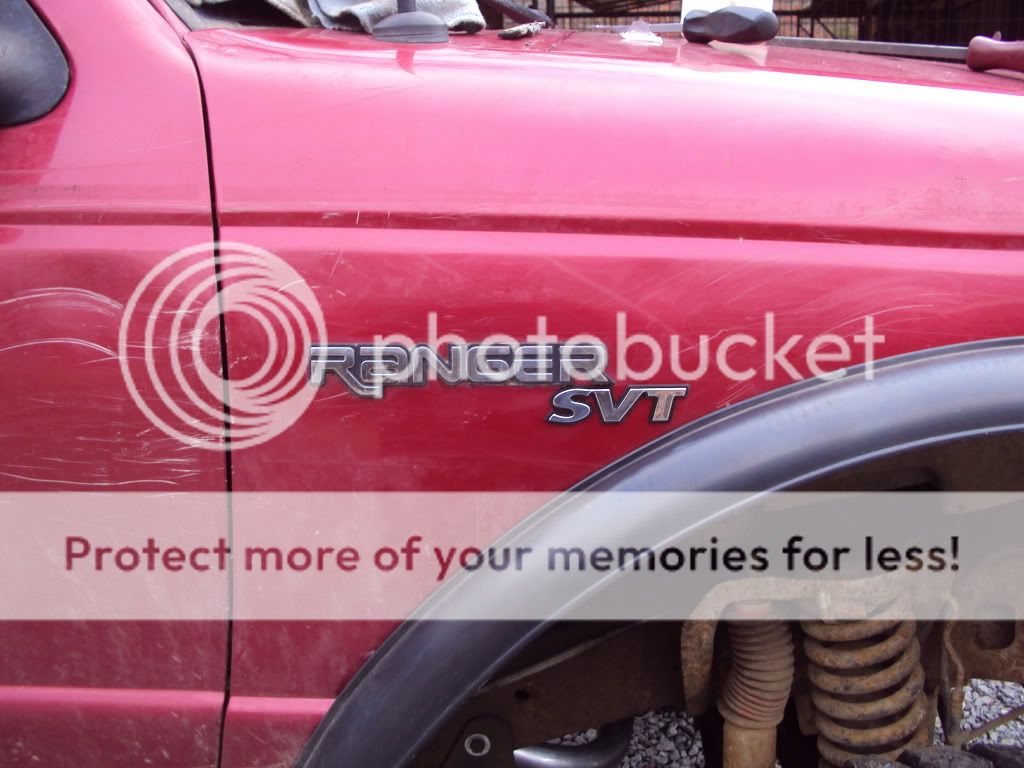

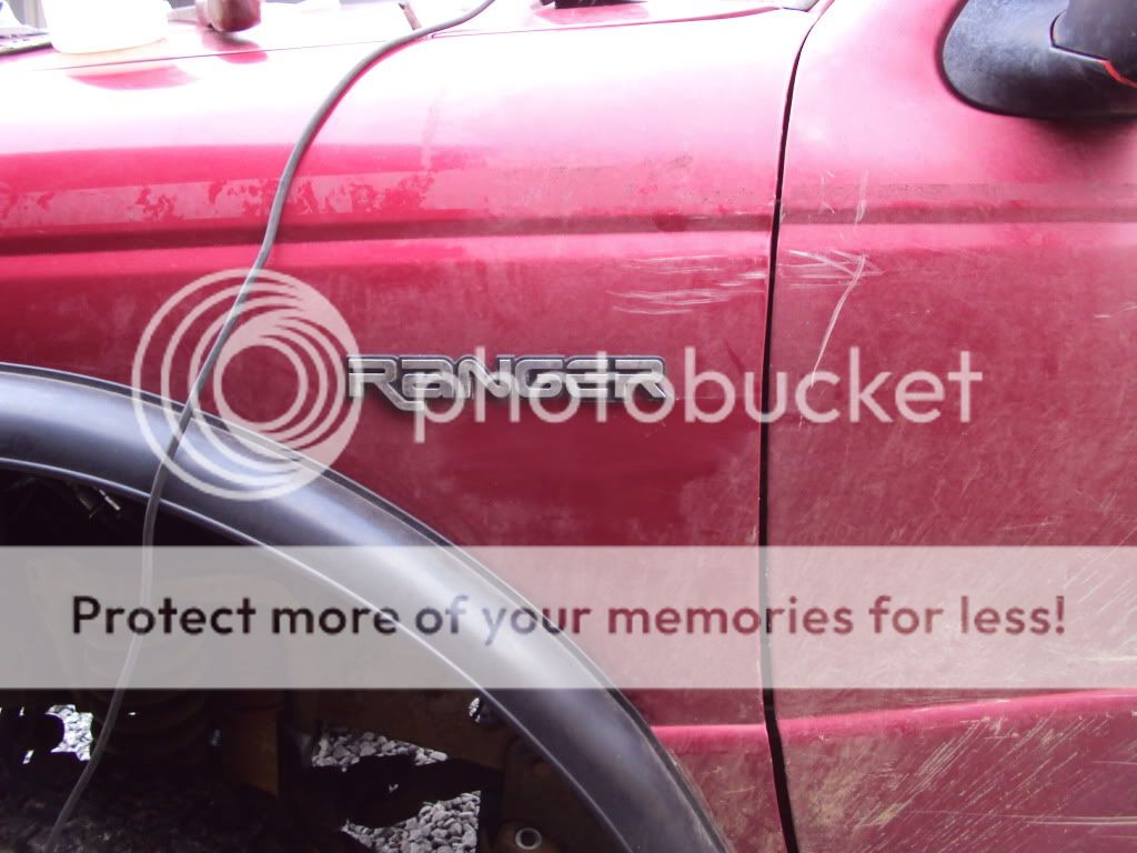

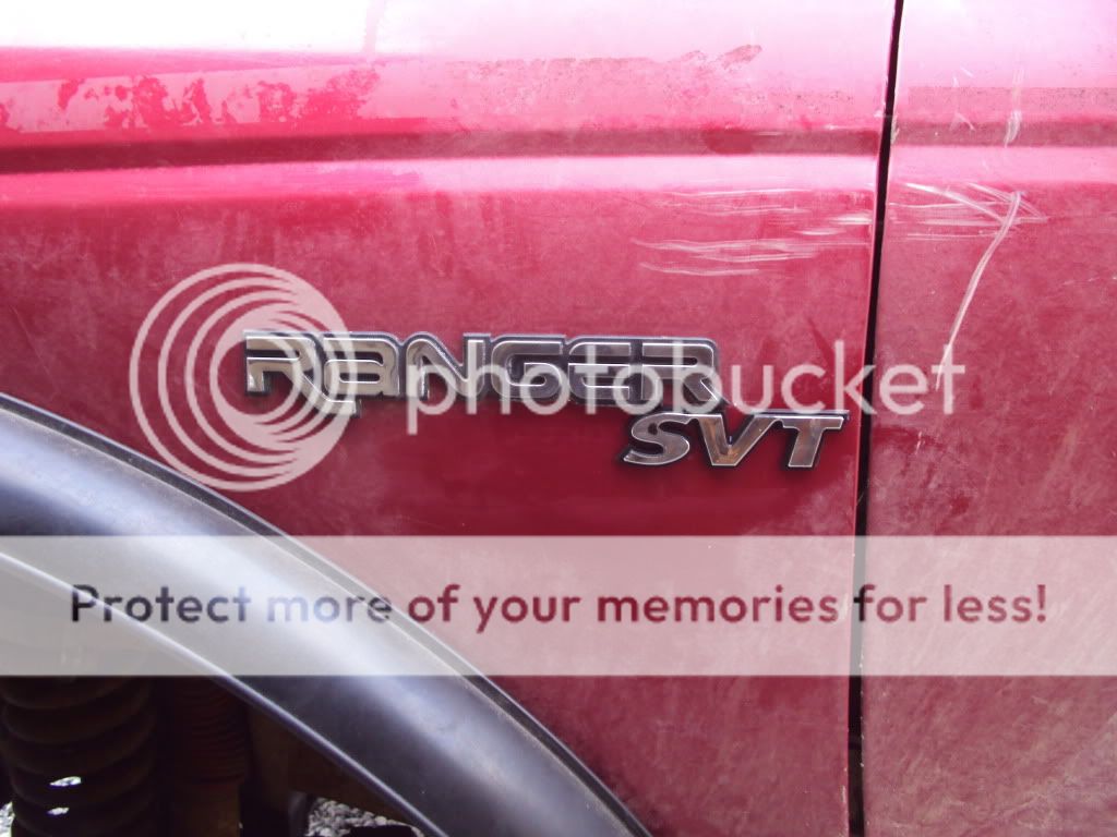

Well, its not the upgrades I wanted to do, but I had 10 minutes, and it looks kool...

What ya think??

Ohhhhhhhh, Now your truck is sweet, how special. Guess that's what happens when ya coulda had a V8 then got one and some flashy new emblems with no low range! :icon_rofl: :icon_rofl: :icon_rofl: :icon_rofl: :icon_rofl: :icon_rofl:

Nice badges. That'll help get you home.
forget about getting home....i just hope he makes it to the trailhead:icon_rofl::icon_rofl::icon_rofl:

I know I know, chrome don't get ya home, but it wasn't much chrome and it adds a nice touch...Well, after some more research the 4406 tcase is actually a TOD (Torque On Demand) full time with low range, meaning the front drive has a clutch pack in it...So I'm going to go ahead and build a 1356/1354 doubler setup. The 56 has a 2.72:1 ratio and the 54 has 2.48:1, combined I will have a 6.75:1, with my Tranny's 2.84 first gear, my final crawl ratio is 103.07, which is not bad considering I'm running an automatic...I'm going to go back to the wishing well and ask the help of another TRS member with my build when it comes time...My doubler setup will not be built as fast as my V8 swap, and it will take some time, but I plan to start it on monday :icon_thumby:

I like it, but uh, where's the lights to go with the honor of that emblem?? Looks more suited to be on my truck since I have the lights to go with it:D

Time to go buy a red mag-mount cherry, Starsky and Hutch style:icon_twisted:
