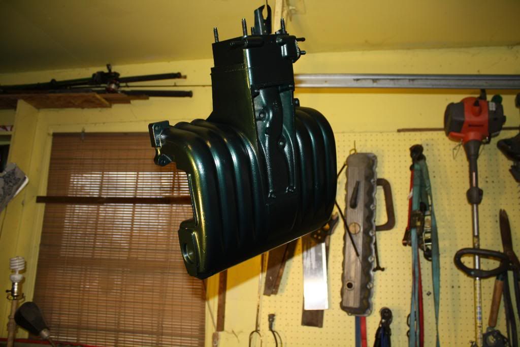

Well, my g/f took some pics of what I have been dong when I've been at her house...Here are some of the pics from me doing the 5.0L HO V8 swap on a 2002 Jeep TJ wrangler...
