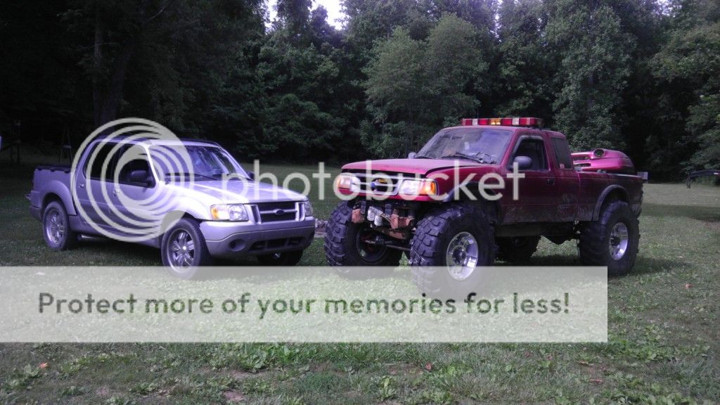

glad its rolling....but I am VERY skeptical about running those tires on a dana 60.....
I didn't intend on running that big a tire, but I got a deal on these tires that I would have been really stupid to pass on them ($100 per tire :headbang:) so phase 3 will start near the end of this summer in the form of a new frame and Beefier axles. This way i can still wheel it while I build the new axles and suspension. I got a different idea altogether for the suspension setup. It will be linked, but that's the only part that will be similar. Stay tuned :icon_thumby:

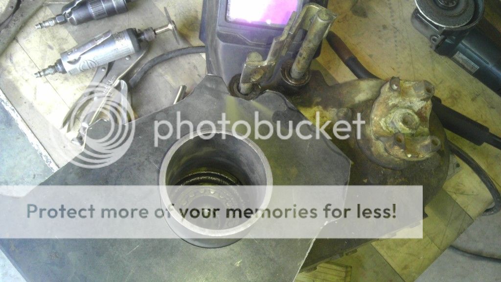

Well, I finally got some work done on the doubler. Yesterday I got my last piece in that I had to get machined. My adapter pipe was about 7 thousandths too big, so I had it turned down. Come to find out, the pipe was out of round, it was 3.990 on one side, 4.002 on the other. My dana 20 housing is 3.998, so I had it turned down to trueness, which was almost 3.990...

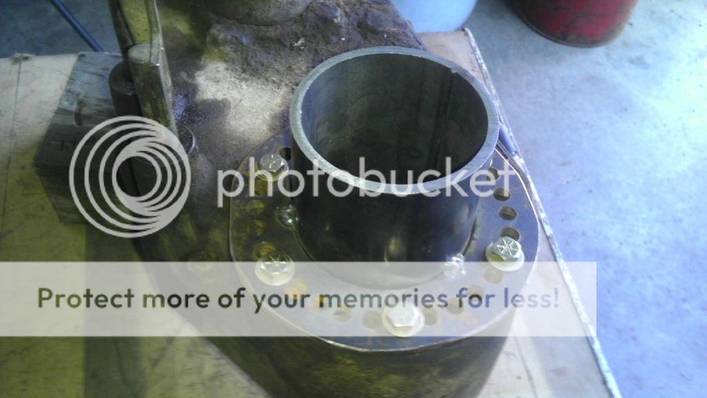

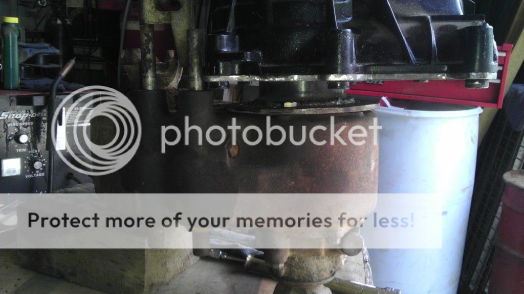

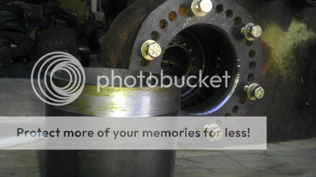

Here is the adapter bolted to the housing with the pipe inserted...

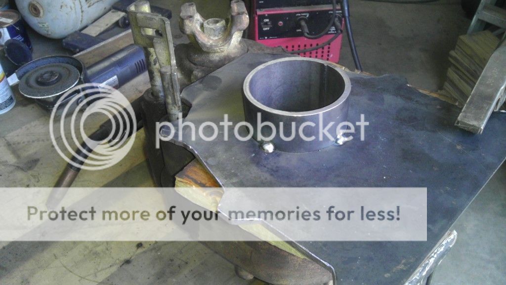

Tacked in place....

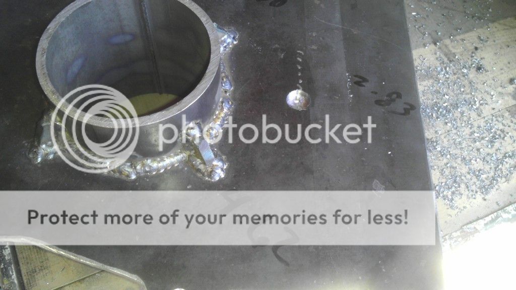

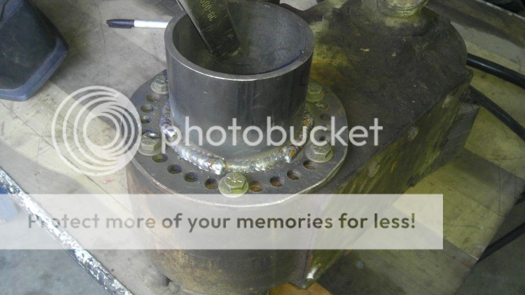

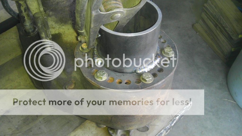

I made several welds, switching sides so it wouldn't warp on me..
Project SVT
All burned on....

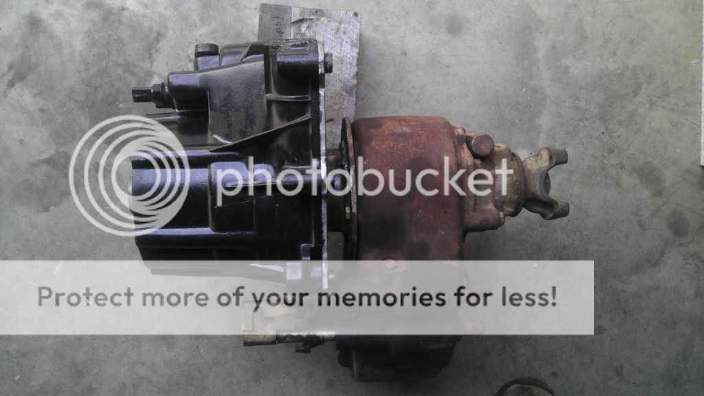

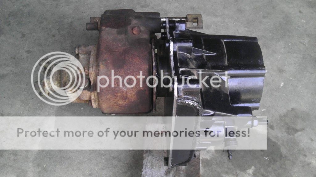

This shows how close the reduction box is to the rear case...

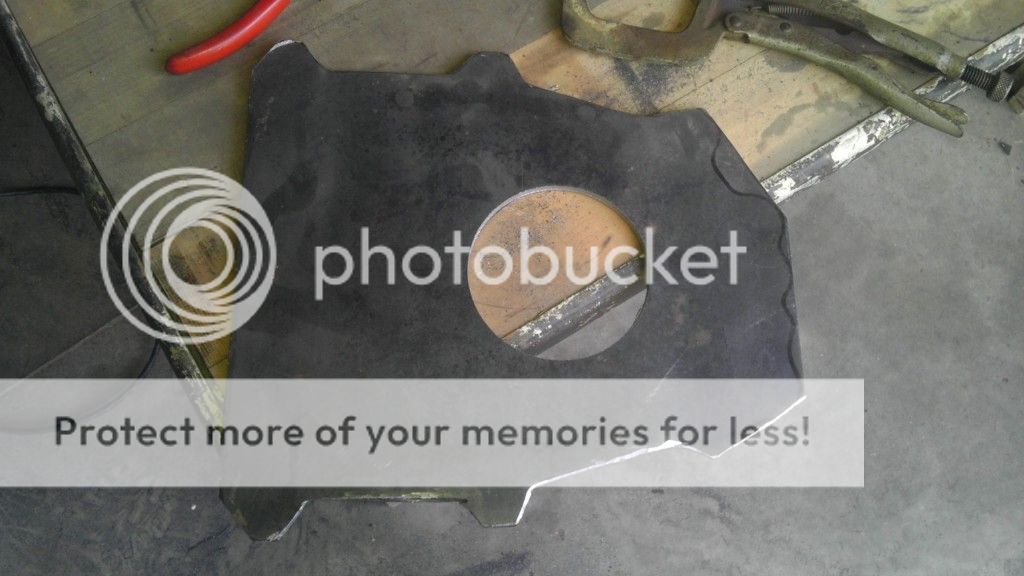

Here is the plate that bolts to the reduction box, all trimmed out...

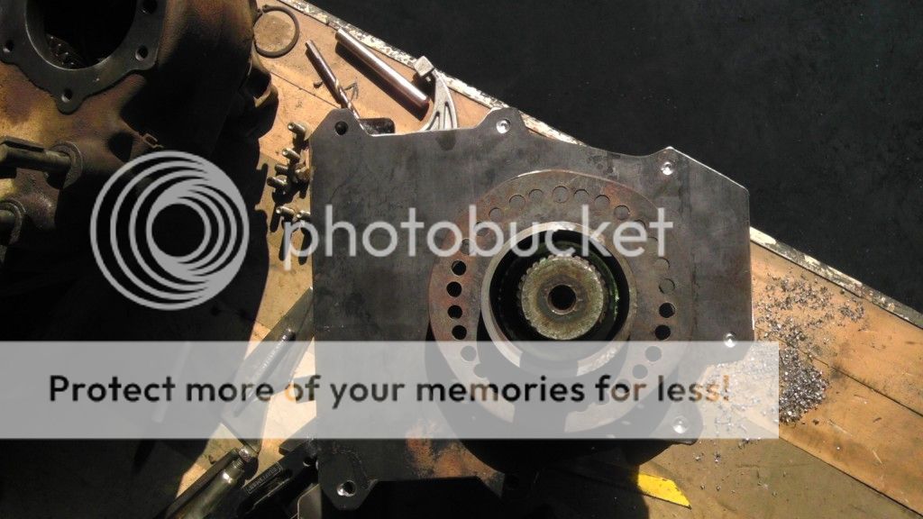

Here's the plate mocked up in place where it needs to be placed. I won't have the adjustment that I thought I would as far as clocking the rear case...

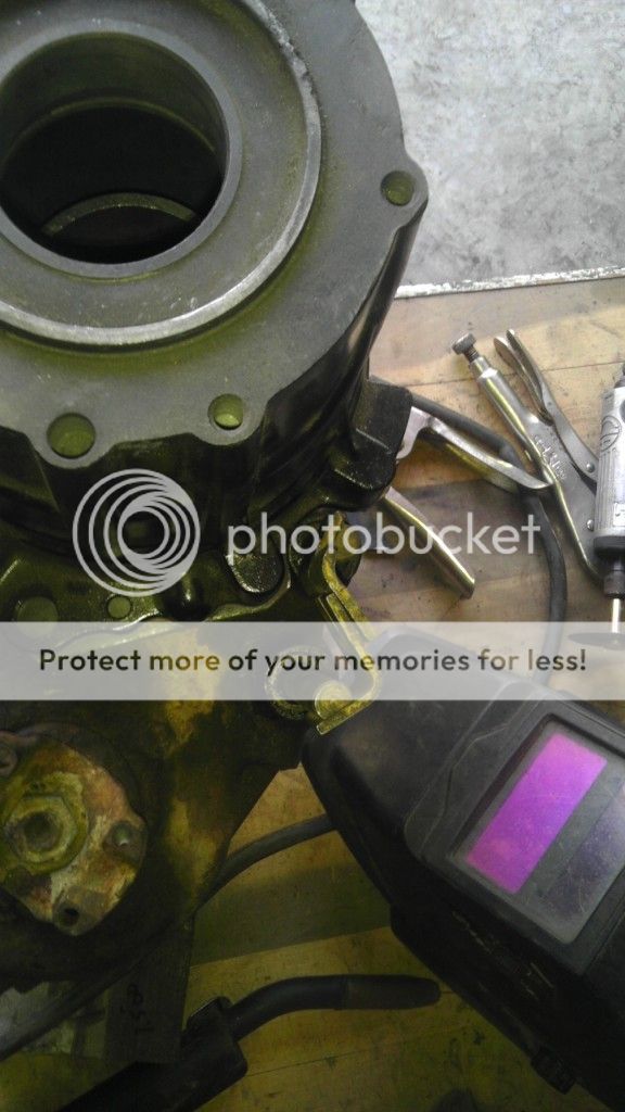

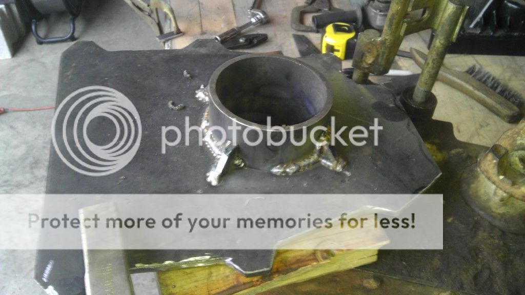

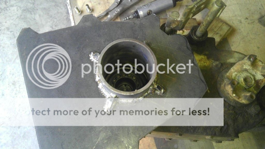

Tacked in place...
Project SVT

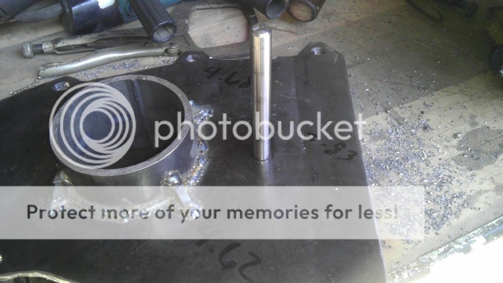

I made some gussets to help support the pipe to the plate, since there is nothing else holding the two together. I also did partial welds in opposite sides, again, so not to warp the materials...
Project SVT
Finished with all sides and gussets welded...

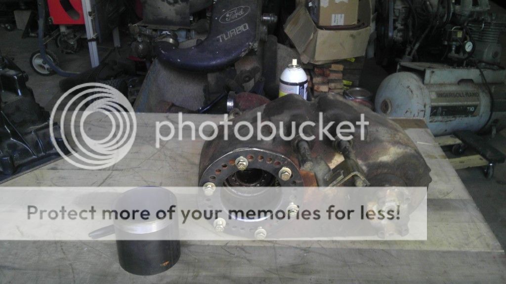

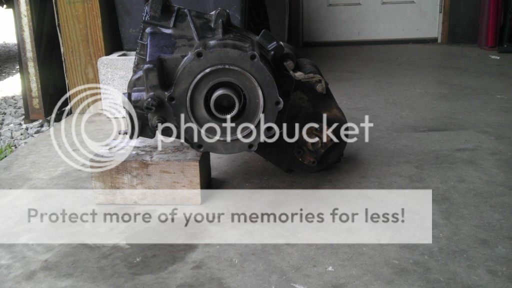

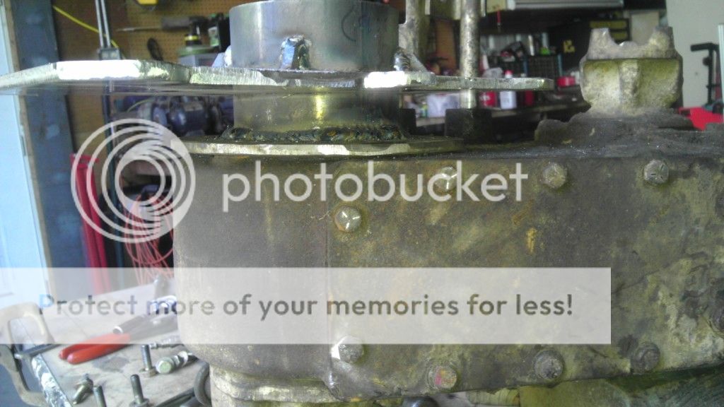

Here is the space I have between the reduction box and the rear case. I originally intended to have 3/4" between them, but I stepped it up to a full 1". The rear case will have studs installed and will attach to the doubler with nuts rather than having bolts going into the rear case...

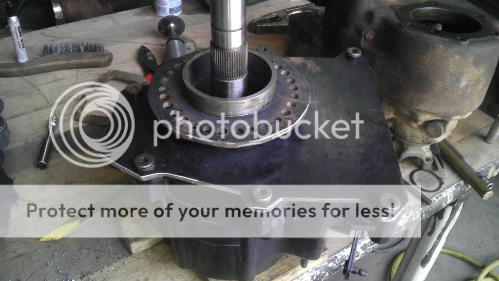

Here is the bolt going into the reduction case and its bottomed out. Looks like I will need to cut the bolts about 1/4" shorter...
Project SVT

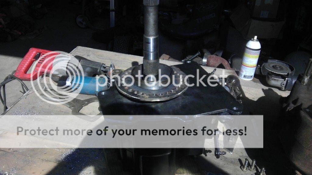

Here the mainshaft is installed in the reduction box. You can see by the length that I will be able to have a one piece shaft instead of an intermediate or sector shaft. This is the main reason why I chose to use this case. Where I need to have it resplined the shaft is solid, so I don't have to worry about running into a hollow core...
Project SVT
This shows the mainshaft is very close to being centered...

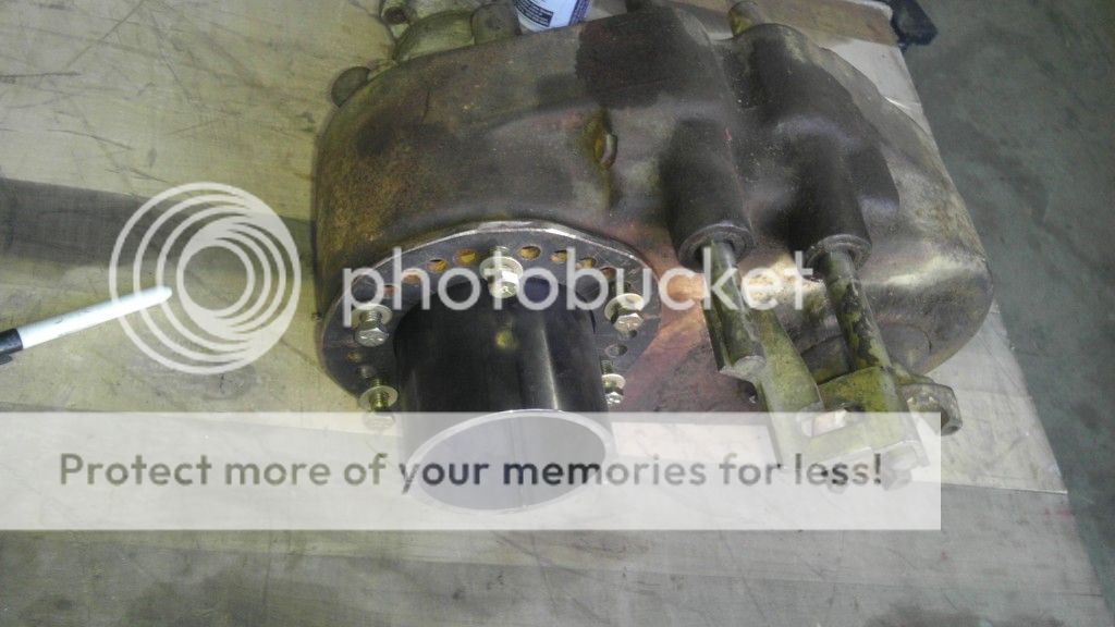

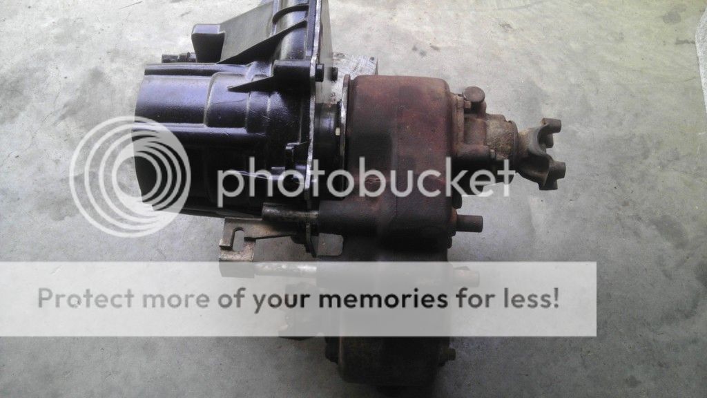

Here is the doubler assembled. I don't have the studs yet, but I was able to get one short bolt in just to hold it together for the pics..
Project SVT
Here's how it will sit when mounted in the truck. I'm thinking the angle is pretty good where its at, but I'll see once its in the truck..

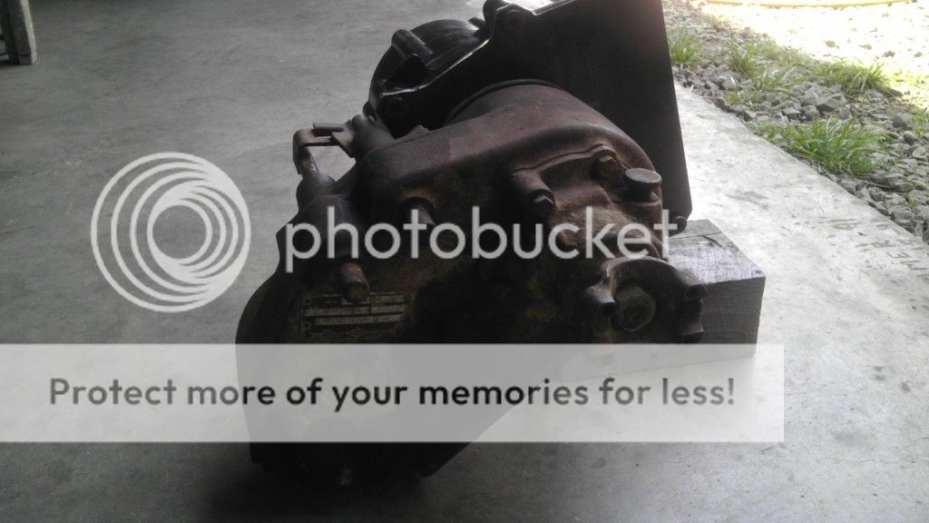

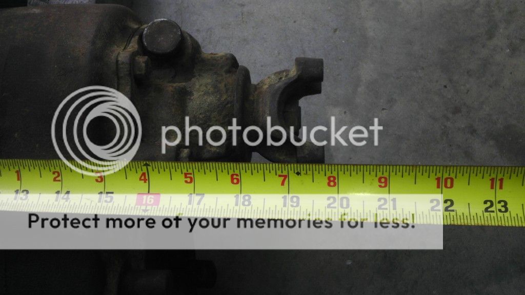

Here's the length from mounting surface to center of driveshaft U joint, under 20"...
Project SVT

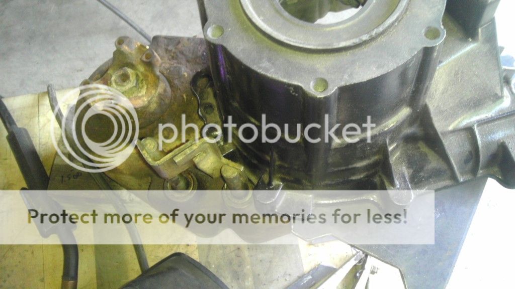

Here is the shift fork pin that I machined into the adapter plate...
Project SVT
Project SVT

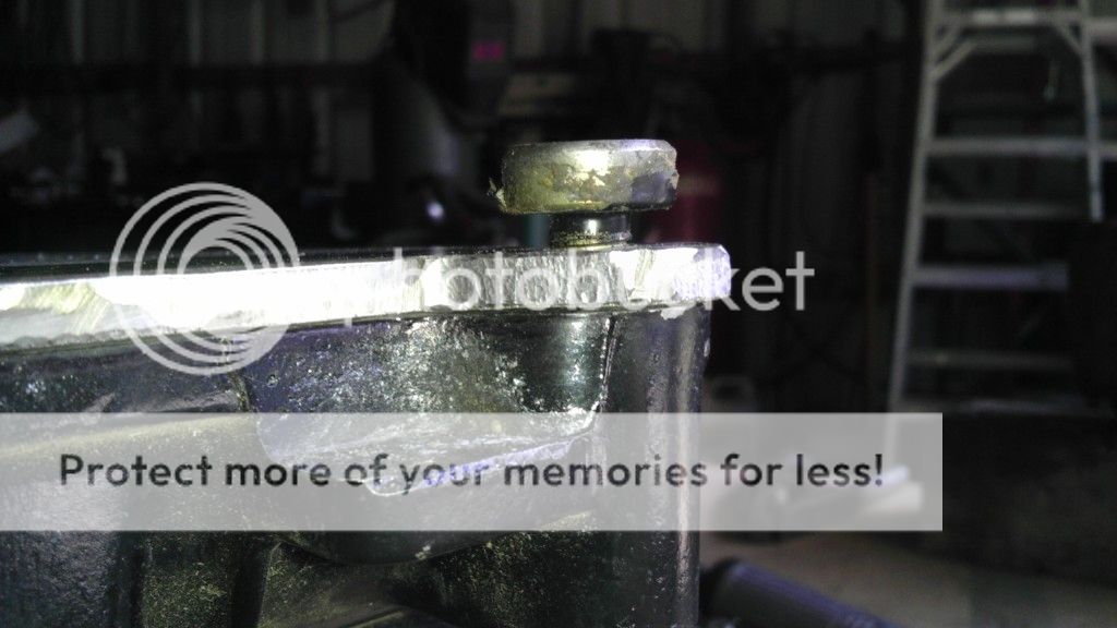

What's not shown is the height of the pipe coming into the reduction box, its too tall and won't allow the reduction box to shift into low gear. I did some measuring and I need to get it down to under 5/8", so I cut it down to about 1/2", and I need to do some machining where I cut it down. Then I can do one more test fit to make sure the reduction box shifts into low range...
