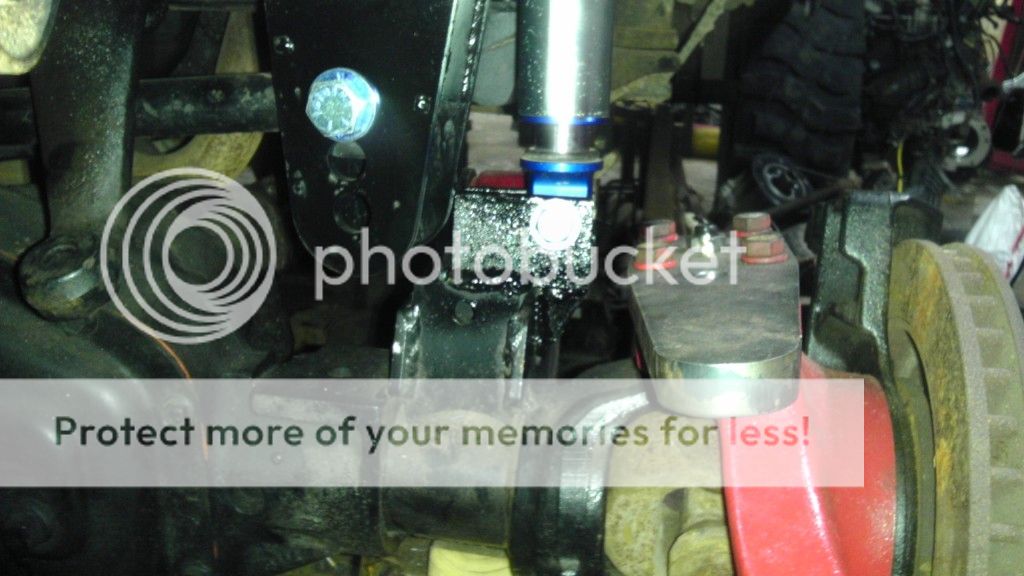

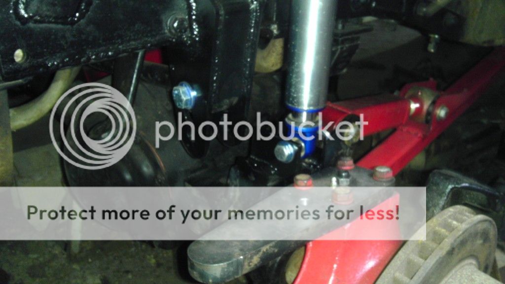

Well, did a little work Saturday, but my phone was dead... I re-did my front lower shock mounts as they were too far in. Because of the way the link mount plates are designed, cosmetically the shock mounts are stupid ugly. I know it will hold, but i don't like it. I'm thinking of pulling the link setup out and going to 44 radius arms/wedges, modifying the wedges to fit the 60 and modifying the 60 to fit the wedges (I measured and can fit them with a little trimming) and making a simple plate to mount the shocks to and extending the arms. Anyone have a set laying around they want to get rid of, or know where I can get a set?...
Kind of hard to see, but its gussetted under the mount...
