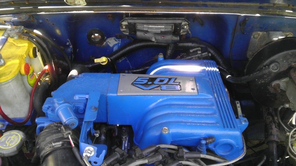

Updates!!! Well, no, not really. But this is why no progress has been done on SVT. I've been doing a v8 swap on a 93 jeep wrangler YJ, a member of a local jeep club. I used a 97 explorer 5.0 motor and trans, along with the ecu and harness. After I get the motor in, the wiring done, and ready to start the motor came to life, and realized it was in a jeep. It developed a fuel leak, a pinhole on the rear fuel rail crossover line. A place I have never seen or heard of a leak forming. I stripped the coating back and it looked like I took a 1/32 drill bit to the line. No pinch marks, no scrapes, nothing. Anyways, here's some pics of the motor as it sits now. When it was out I painted the motor and trans after a brief cleaning..
Ex fead minus the ac compressor. He didn't run ac, so I didn't bother trying to fit it. I just short belted it..
Here's the dash with the old gauges removed. Went with all autometer gauges...
Custom panel made for the gauges..
Barely visible in the lower left corner, but I also wired in a factory od switch from a 91 f series truck as well as an OBD2 port. Should have it done tomorrow or Saturday...

Well, I'm just about finished the jeep 5.0 swap. Power steering pump is a little noisy so I need to swap it out. Also need to modify the wiring for the speedo. Here's a couple pics of the finished engine bay..
SVT
Looks clean and fits in there nice.
