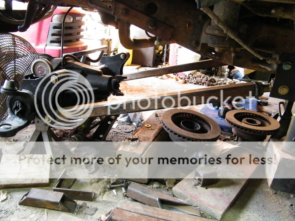

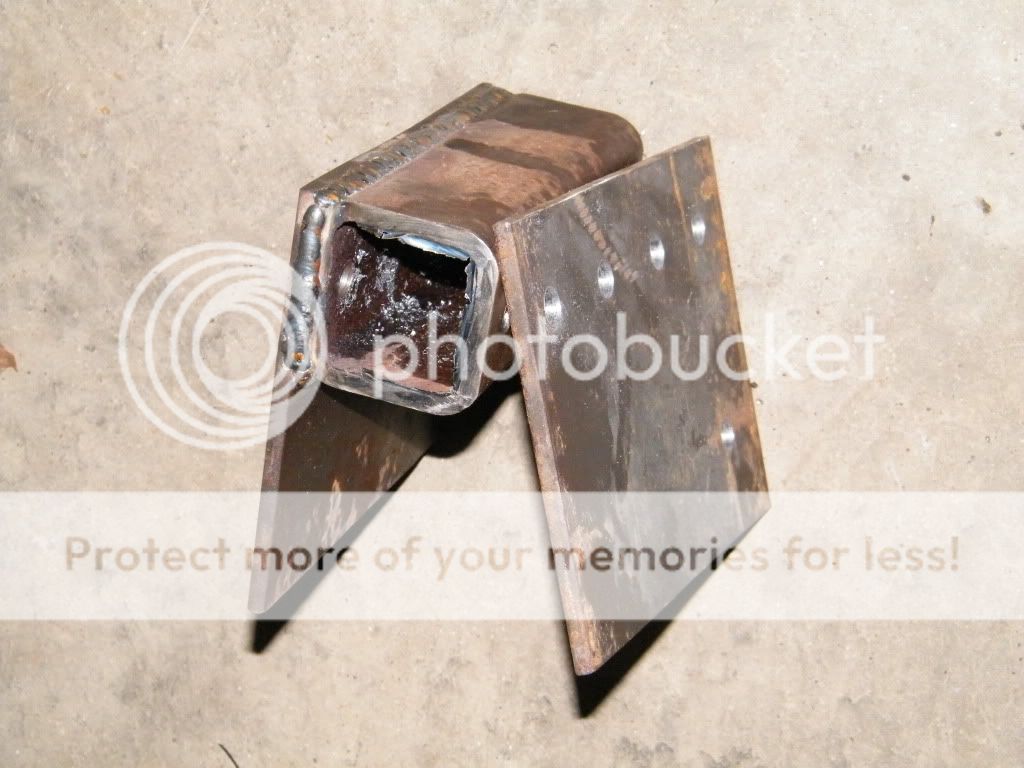

Update...Finally With Progress :yahoo: I only had about 3/4 of the day to work on SVT, but I'm happy with the progress I got today. Still need to get some link mount frame brackets, tracbar frame and axle mount, relocate the fuel tank, battery, get some hydro hoses made, getting to the little stuff. I got my upper and lower link bars fabbed and installed, lower link bar mounts fabbed and installed, shock tabs burned on and shocks mounted...On with a couple of pics....

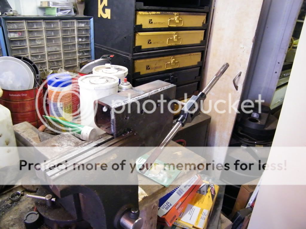

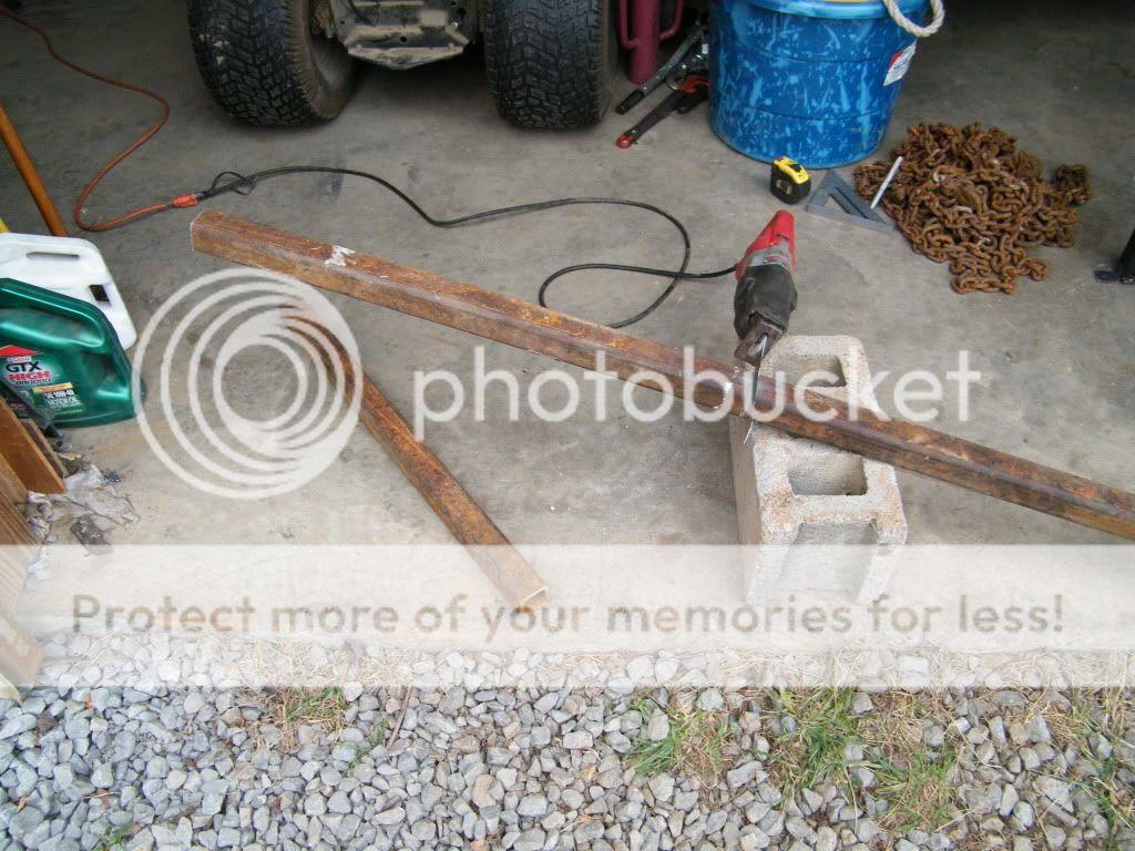

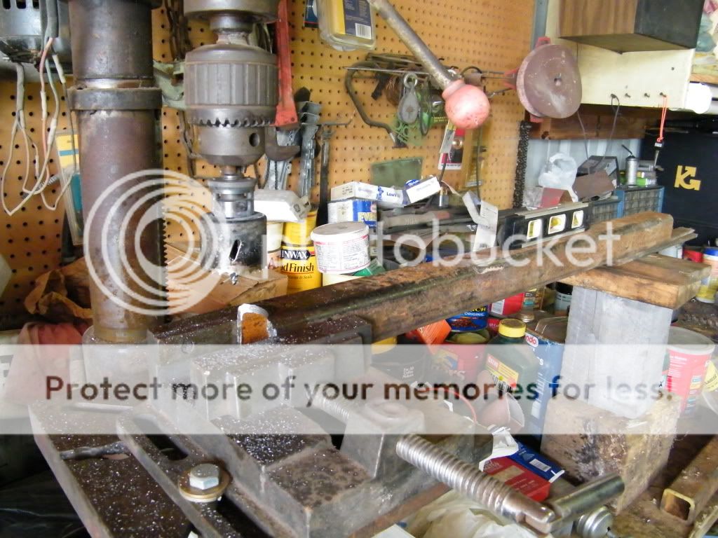

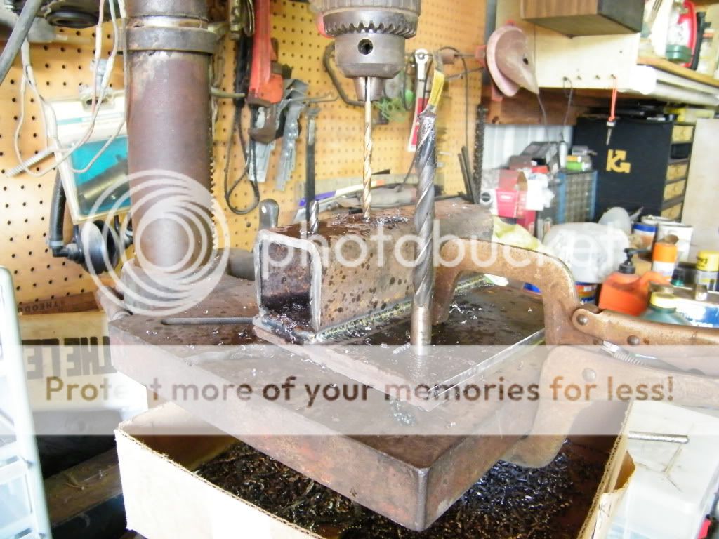

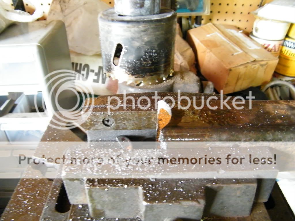

I decided to use a different tool for cutting my steel today (got tired of using the cutoff wheel)...
Made my own tubing notcher...

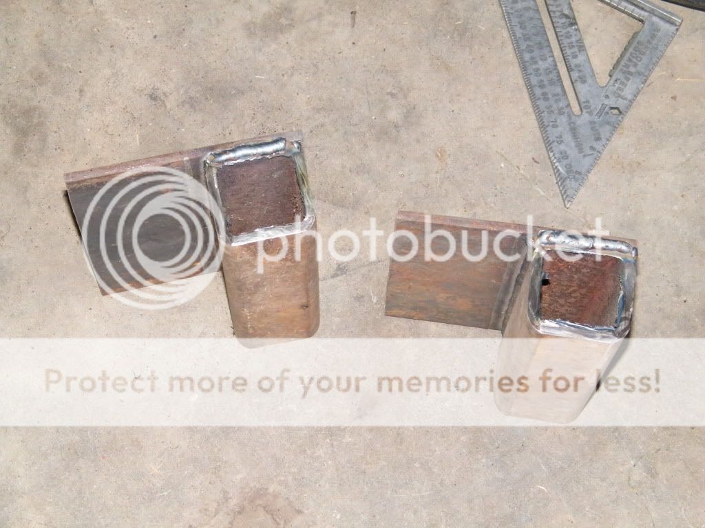

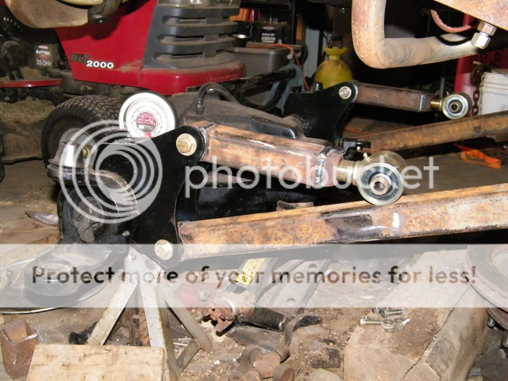

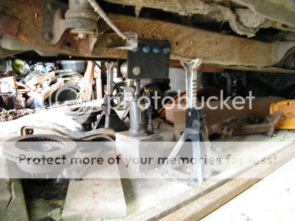

Lower link bar mounts installed...

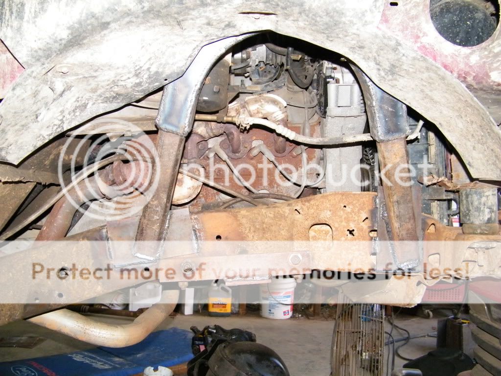

Shock tabs burned on, they are 3/8" thick, so they shouldn't go anywhere. I wanted to mount them on the top of the hoop, but I ordered the wrong tabs and made the shocks contact the lower portion of the hoop...

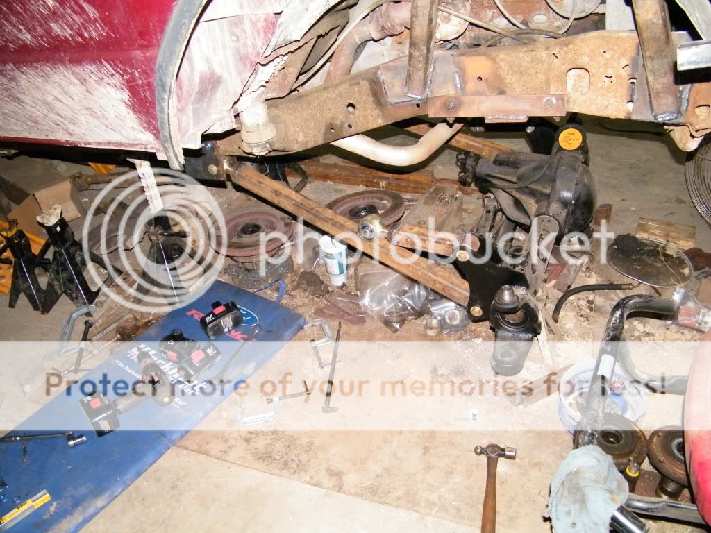

Lower link bars mounted...
I know it's hard to tell, but the front axle is moved forward about 5.5"...

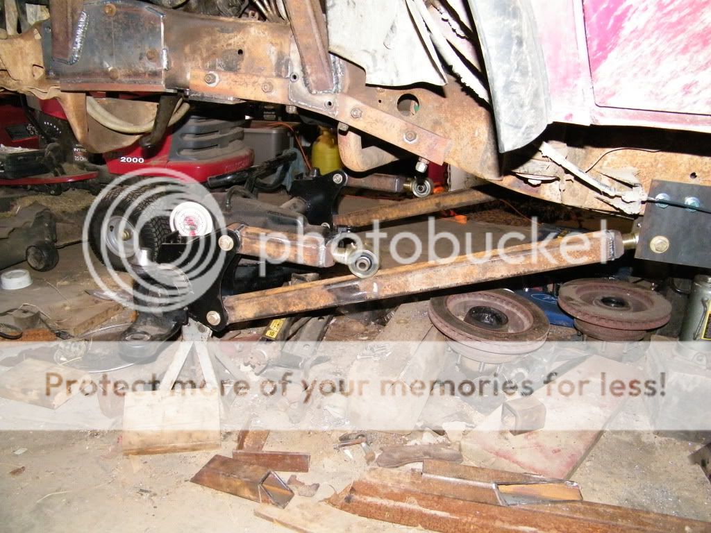

Upper link mounts....I need to get some frame brackets so I can attach the uppers to the lowers...

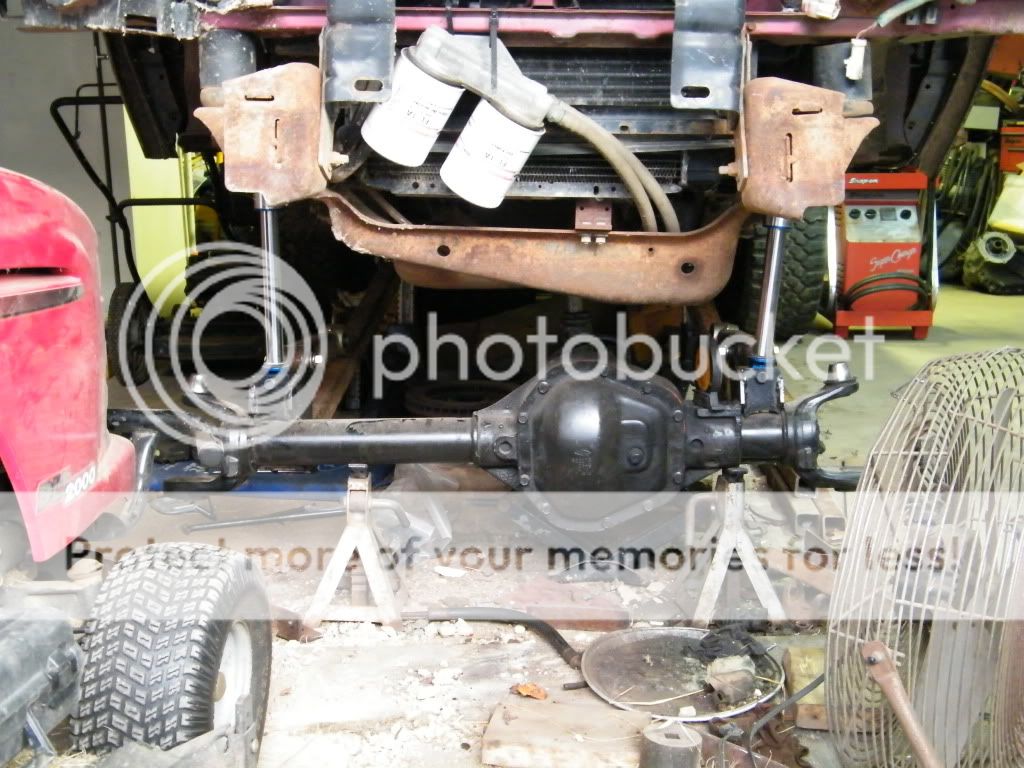

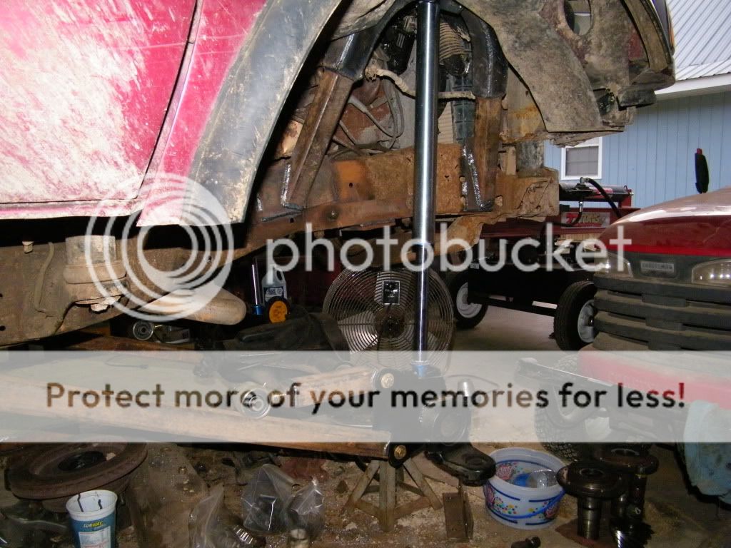

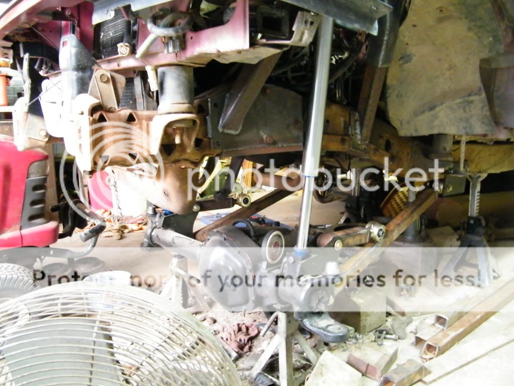

Air shocks mounted. I just have them temporarily mounted as once I get my tracbar frame and axle mounts burned in, and my upper link mounts burned, I need to disassemble everything to paint...
I plan to move the axle back about a 1/2" as the shock is real close to the engine crossmember. It's not touching right now, but its real close and may contact when stuffed. The axle is also sitting to the passenger side, so getting the axle centered will also help with clearance...

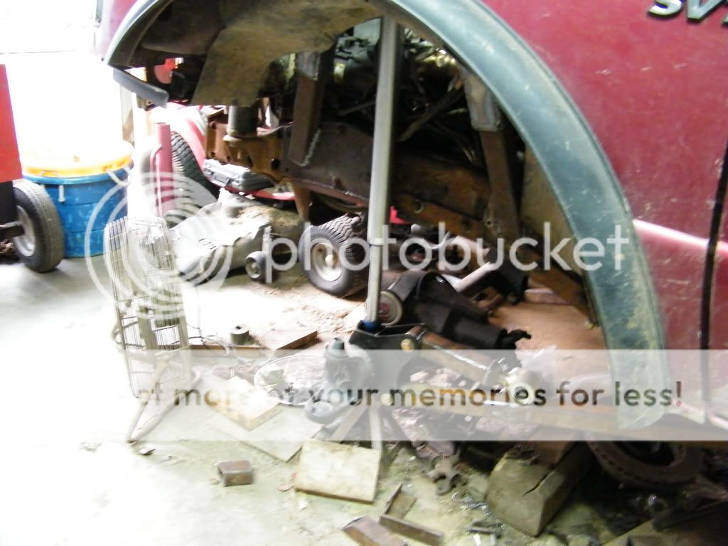

Passenger side shot of the shocks mounted...

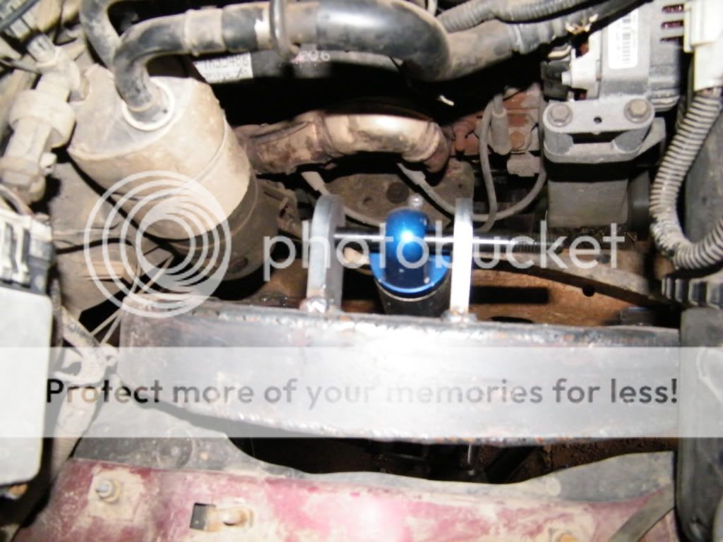

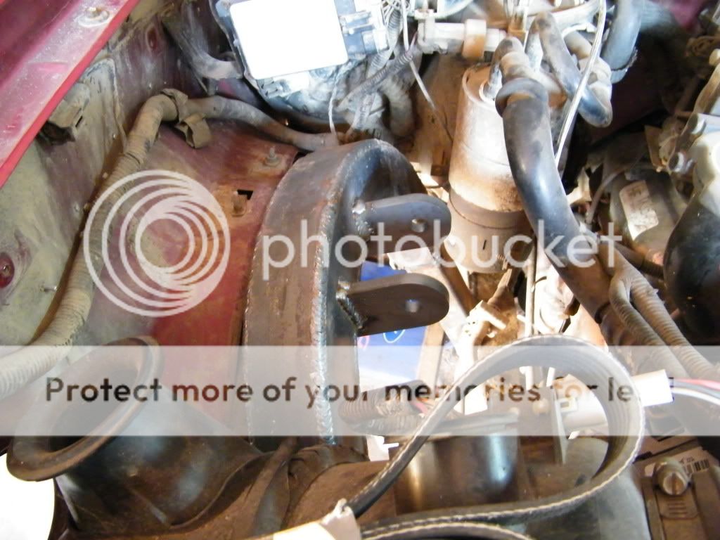

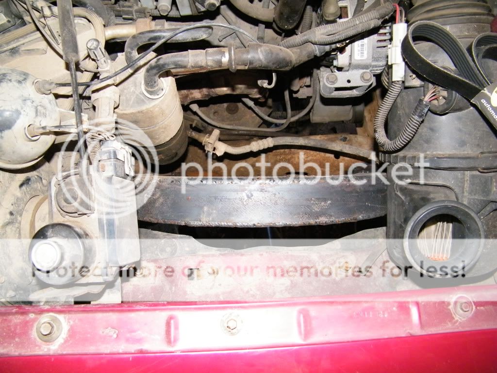

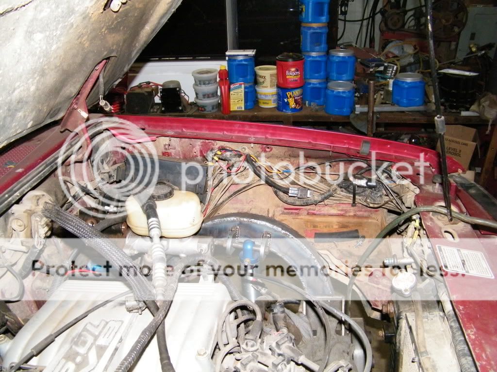

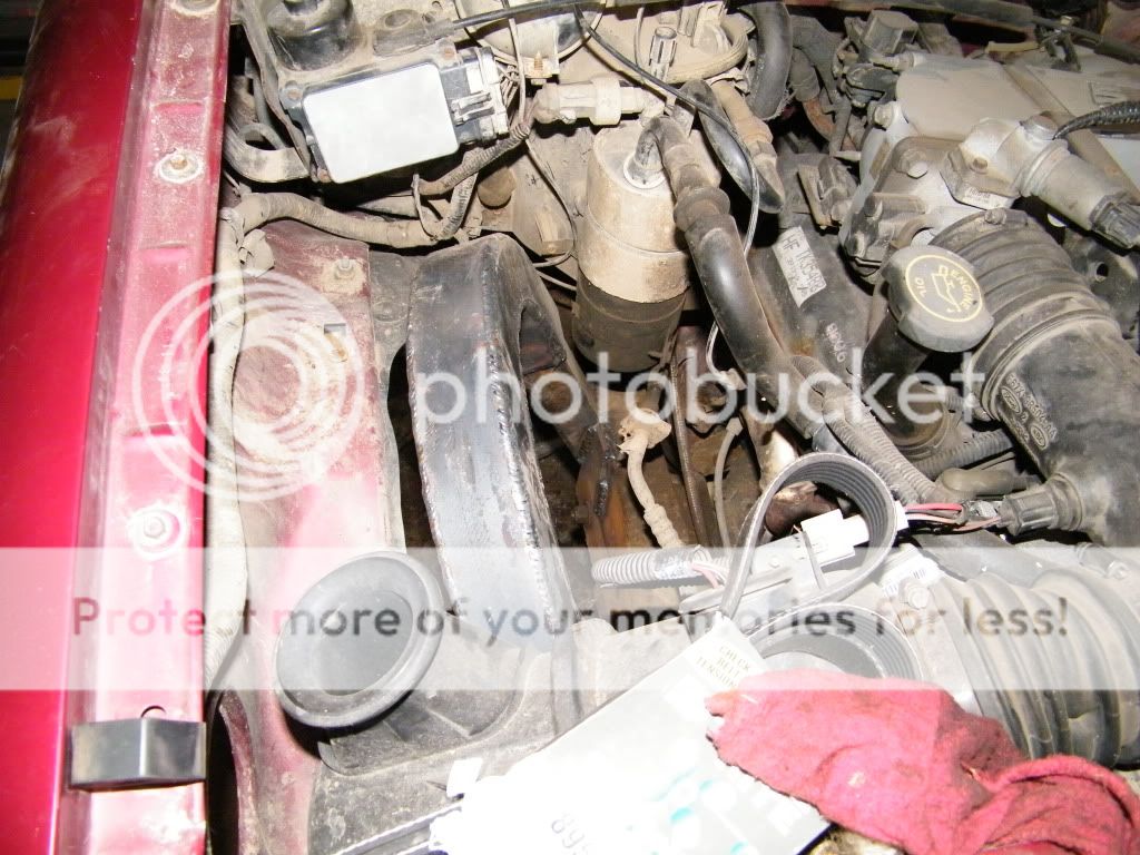

Here are the engine bay shots of the shock hoops. Still need to fab my shock hoop crossover bar...

Looking good! I'm wondering why on the radius arm the longer link is on bottom? Wouldn't it give slightly more ground clearance if it was on top? Or is it that way for clearance on the frame?
Richard
It serves 2 purposes...If it was on top, it would contact the frame when flexed out, and it also serves as a skid plate if it ever contacts the rocks, although it shouldn't with almost 2 whole feet of clearance from the ground...

Pics at full bump? Why radius arm over 3 link? Is there clearance issues at full bump, hence the short uppers? Right now, your uppers are creating the absolute maximum bending moment possible on the lower link (mount right in the middle of the link). Though it probably won't matter, it's the worst posible position to put them, design wise.
Regardless of your axle location, your shocks are going to be tipped the wrong way (judging by the pic). It's going to encourage body roll.
It'll be interesting to see how the frame mounts hold up as well.

I agree. I would relocate your shock hoops in a little toward the motor or move your lower mounts out, maybe onto the C. It would help you with frame clearance. Once you put a track bar on you will swing the axle more to the one side and you might have issues with your shock hitting the frame.
The frame mounts, I would suggest a couple of rosset welds. With the size of the plate I feel the leverage put on it by the hoop can pull it off the frame in the center of the plate and over time weaken the whole get up.
