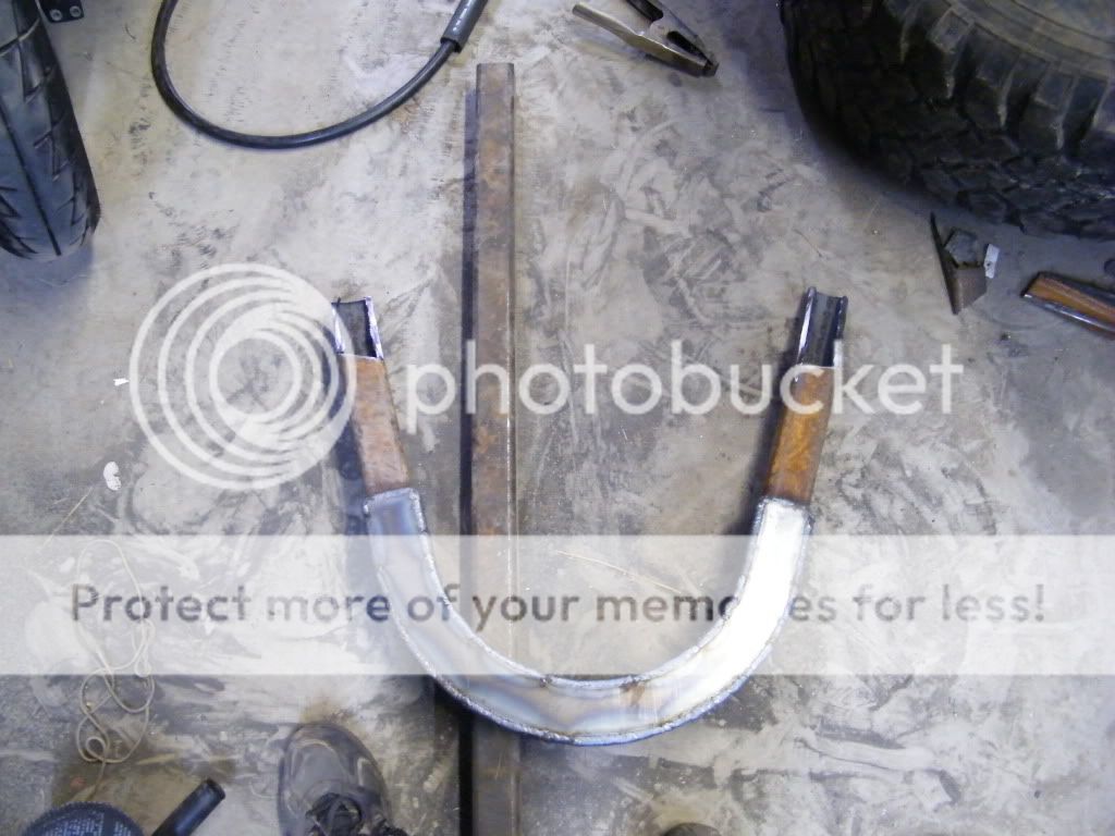

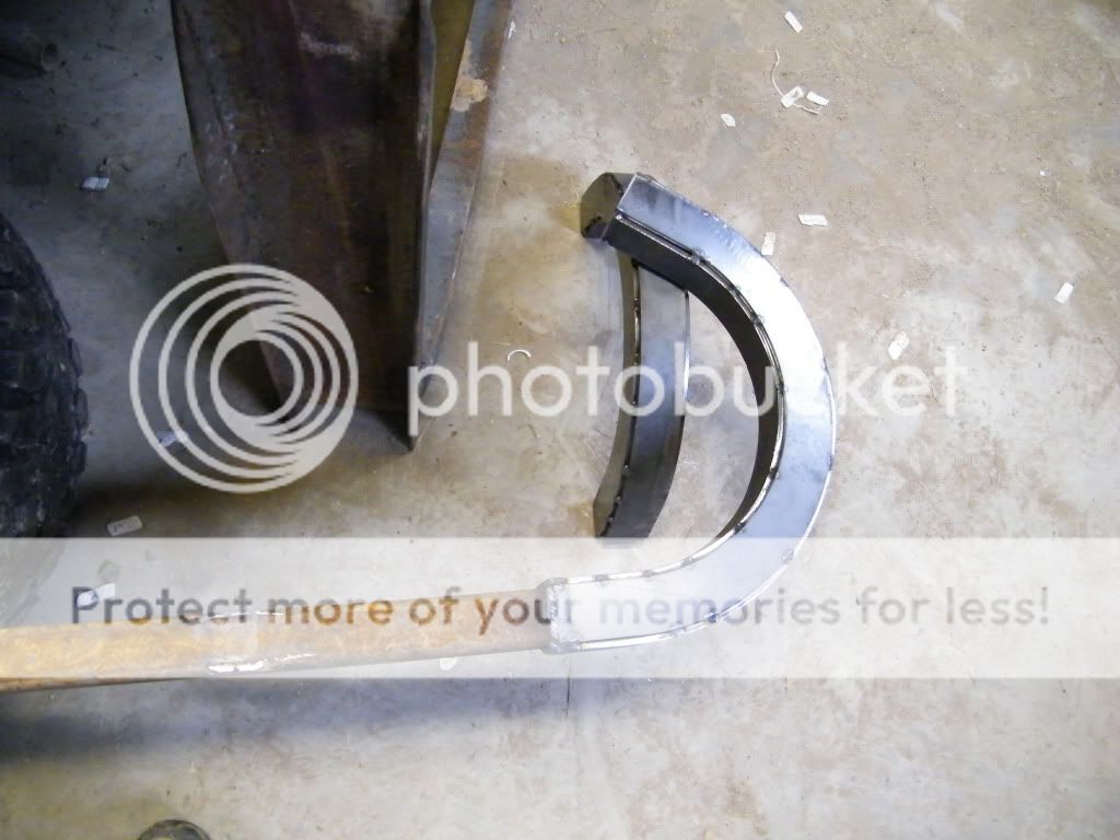

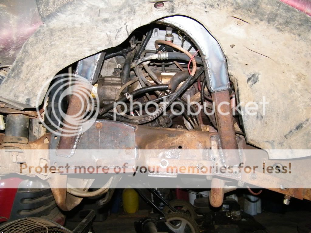

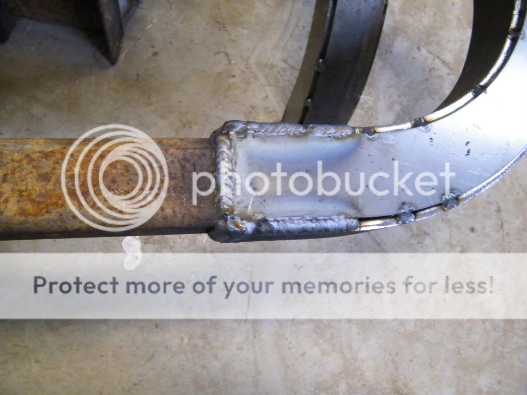

Ok, time for a long overdue update with progresss...Not as much as I would have hoped, but with what I had to do and what I had to work with, it took a while...I got my shock hoops in from a buddy who has helped me out on this project before. A big shot out to Paul for getting these cut for me, it saved me a lot of time trying to do this by hand :icon_thumby:

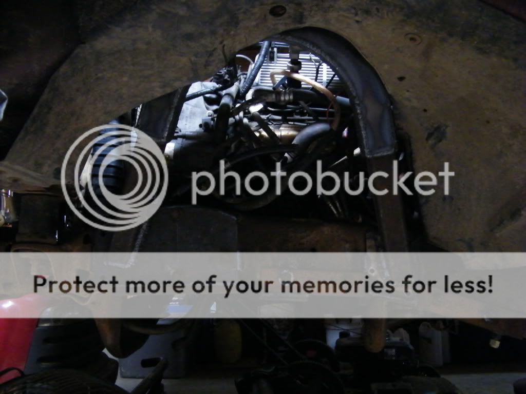

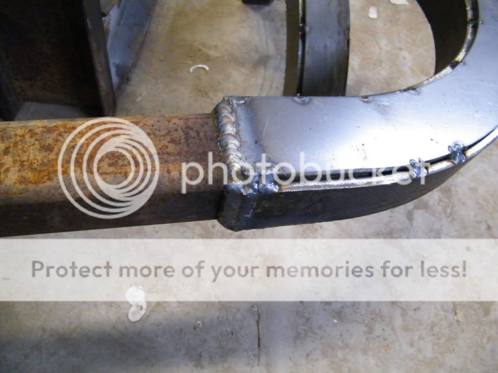

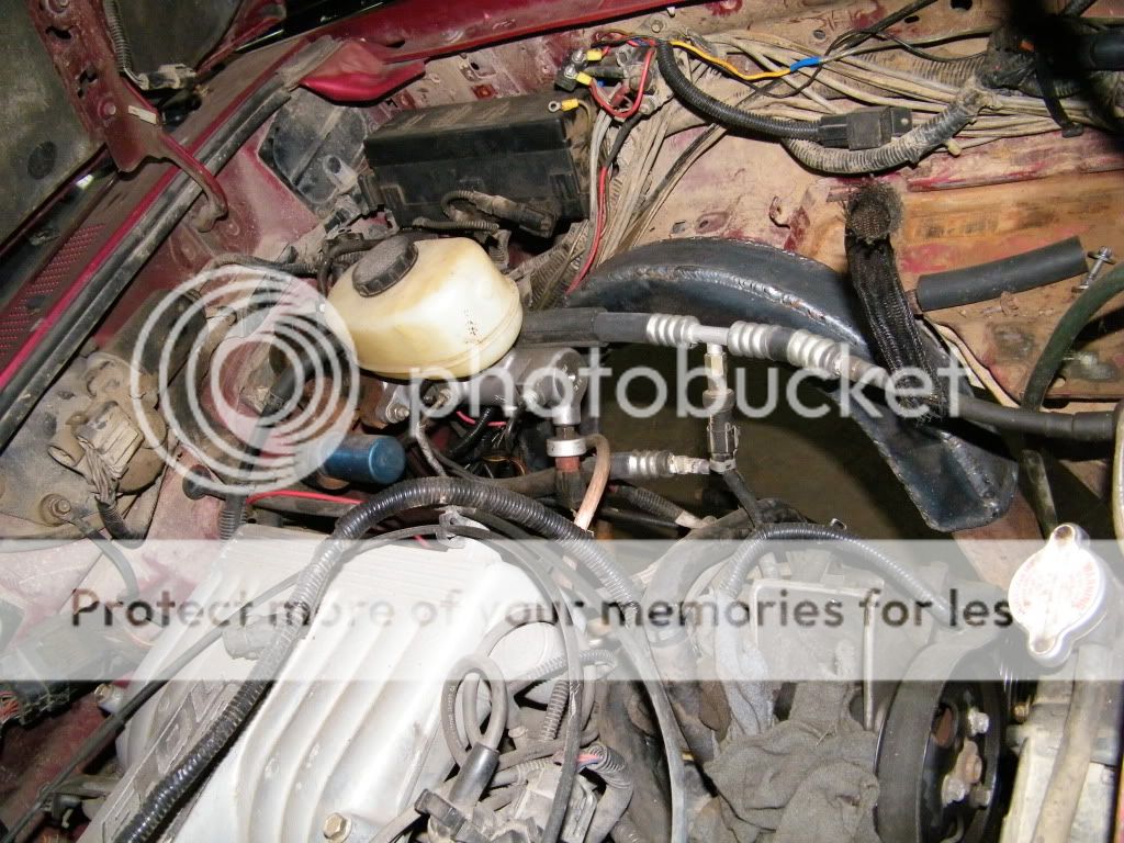

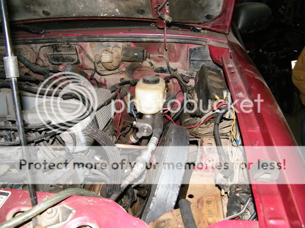

Ok, I got the legs of the shock hoop cut and the hoops welded together, but only had time to install one of the hoops on the truck (I only had one day to work on it), and since I don't have much fab tools, I had to cut the complex angles by hand with a grinder and cut off wheel (Did I mention I need a bandsaw :icon_idea:) Anyways, when I got the hoop mocked up in place, it wasnt where I wanted it to be, and would have required more extensive fitting, and I'm ready for this to be rolling again, so I left it where it would fit. It's about 6 inches lower than where I initially wanted so SVT will be sitting 6" higher than planned. Sometime next year I am planning a new frame for SVT, so it will get addressed then. I also burned in the plates to the frame for the same reason. After I started fabbing reinforcement plates and bolted them to the frame instead of burning them in, I realized later just how weak the frame is, and since its not going to get any stronger on its own, I decided to just burn them on and later I will start with a new stronger frame rather than trying to patch this one...On with the pics....
I should have more updates next week as I plan to work on SVT more often since a lot of the other projects are now finished or near finished...
