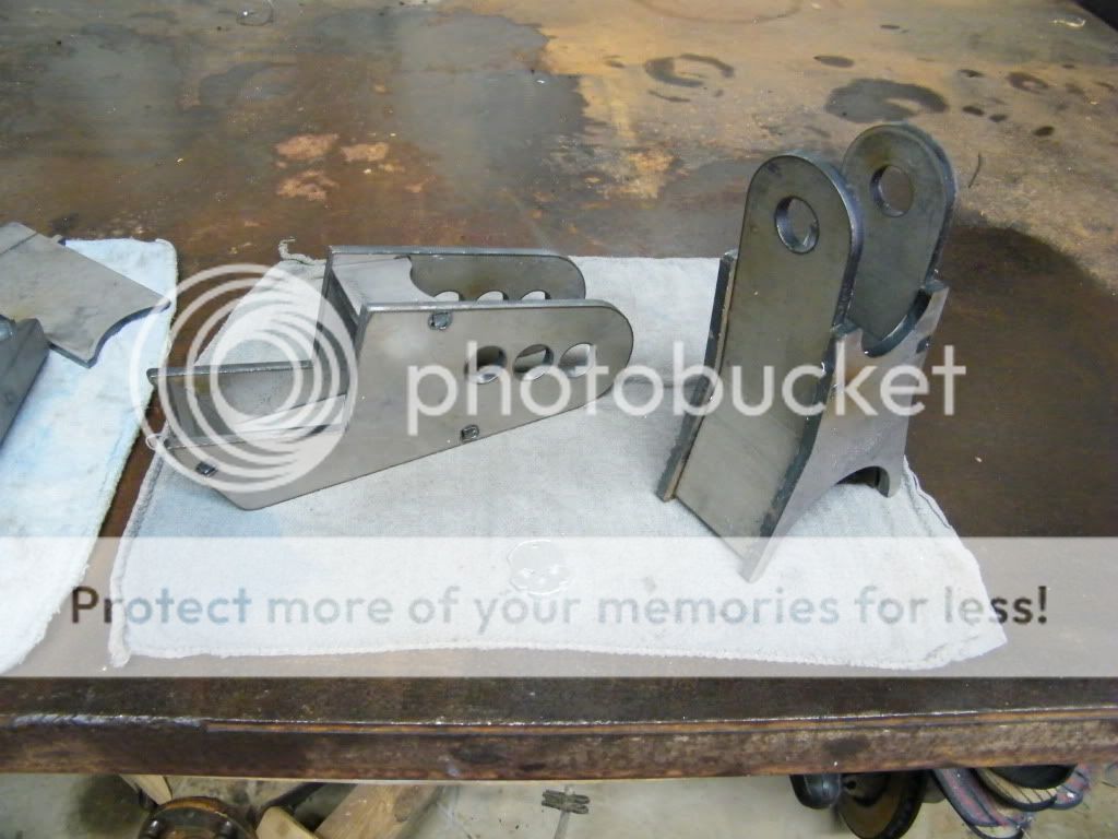

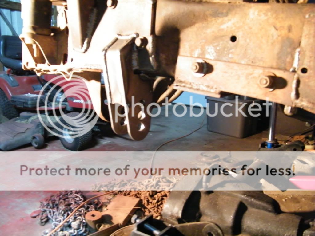

So, I've been gone for about 3 months, glad to be back, and finally got some work done on SVT. A week before I got back home I ordered some parts for the rest of my front suspension. I ordered a pair of frame bushing mounts, a frame trac bar mount, and an axle trac bar mount. I got all but the axle trac bar mount on. I don't like the way the shocks are mounted, they are too wide at the top, and look uneven to me. But they will more than likely stay this way as sometime this summer I'll be building a new, stronger frame for SVT. On with the pics...
The frame bushing mounts...
Project SVT

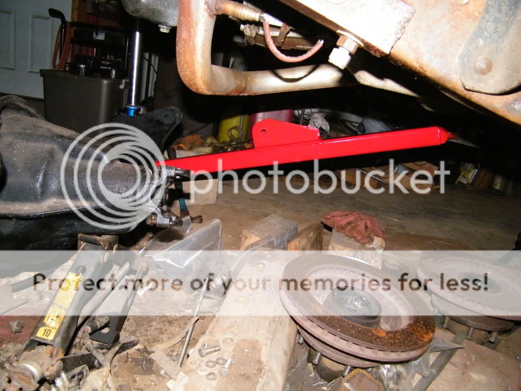

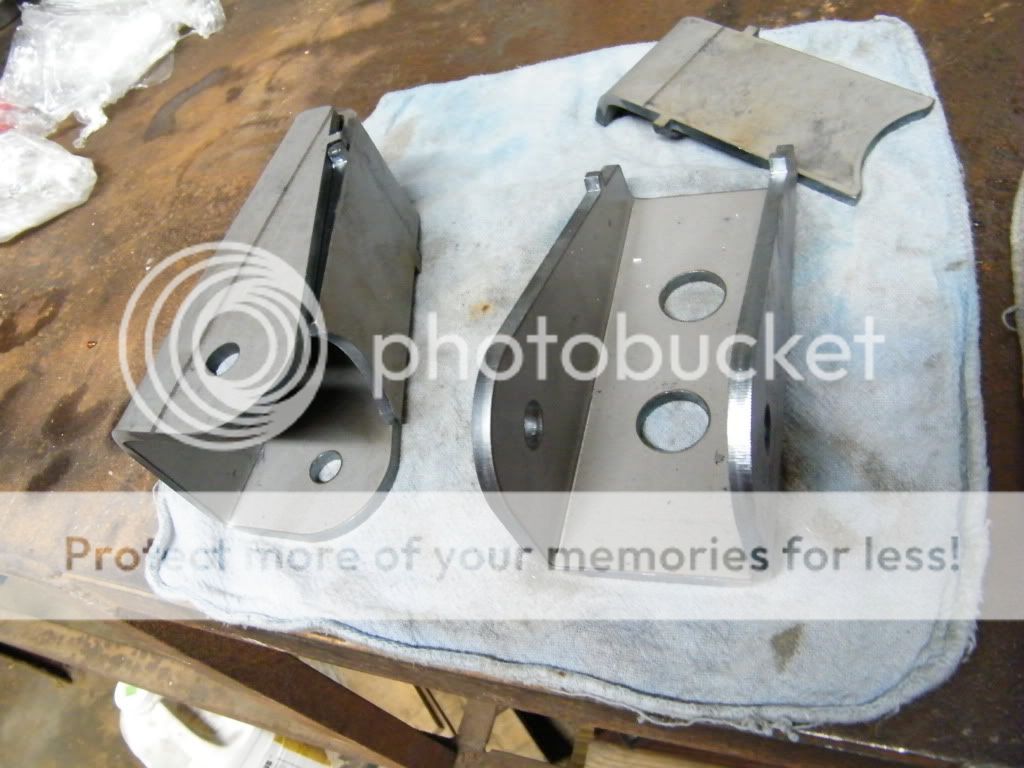

The trac bar mounts...
Project SVT

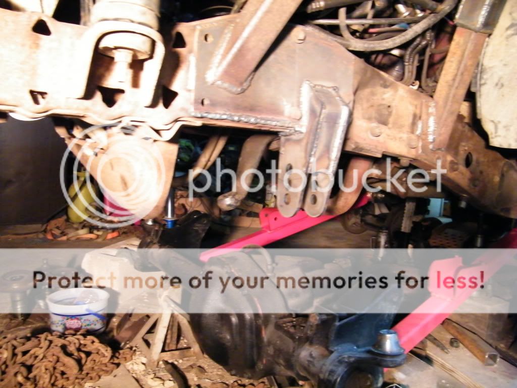

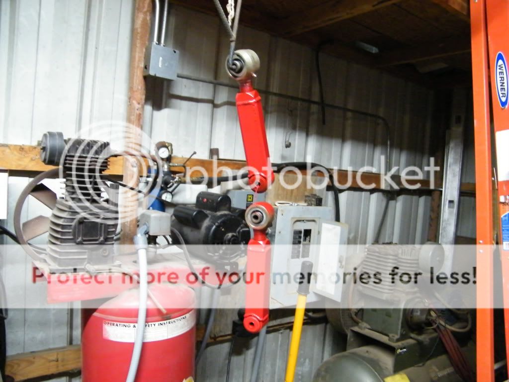

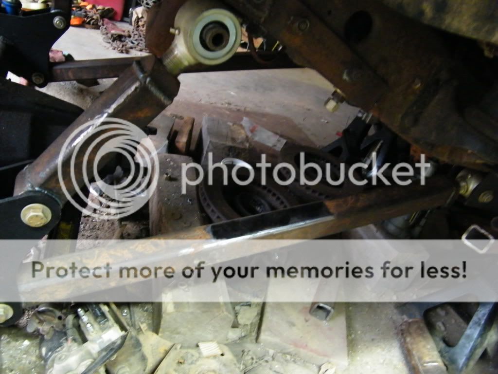

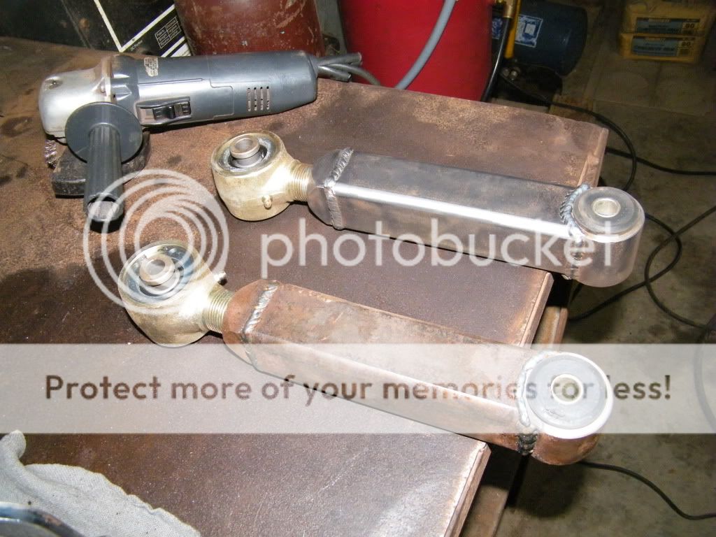

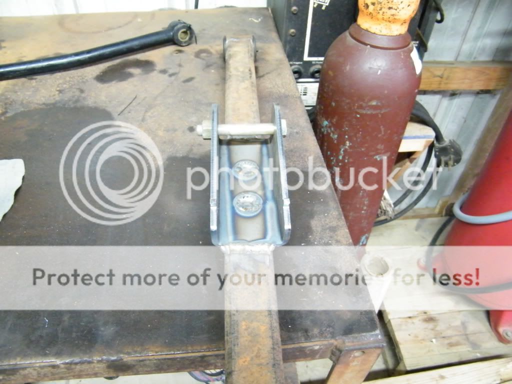

Prepping the lower link bars for the frame bushing mounts...
Project SVT
Project SVT
Project SVT
Project SVT
Project SVT
Project SVT

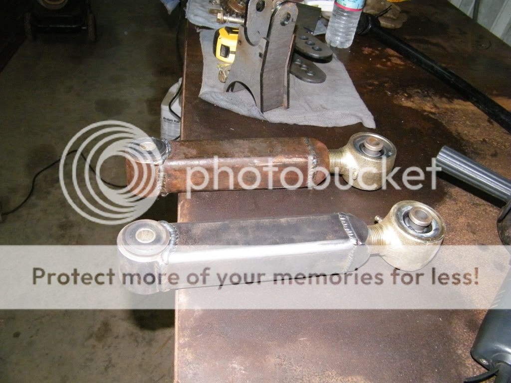

Adding a little rust protection and bling the cheap way...
Project SVT
Had to do some cleaning, the bare metal has been sitting too long. Can you tell which one has not been prepped??
Project SVT
Project SVT
More rust protection and bling...
Project SVT
Project SVT
Project SVT

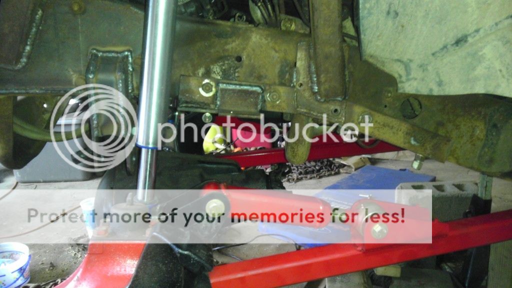

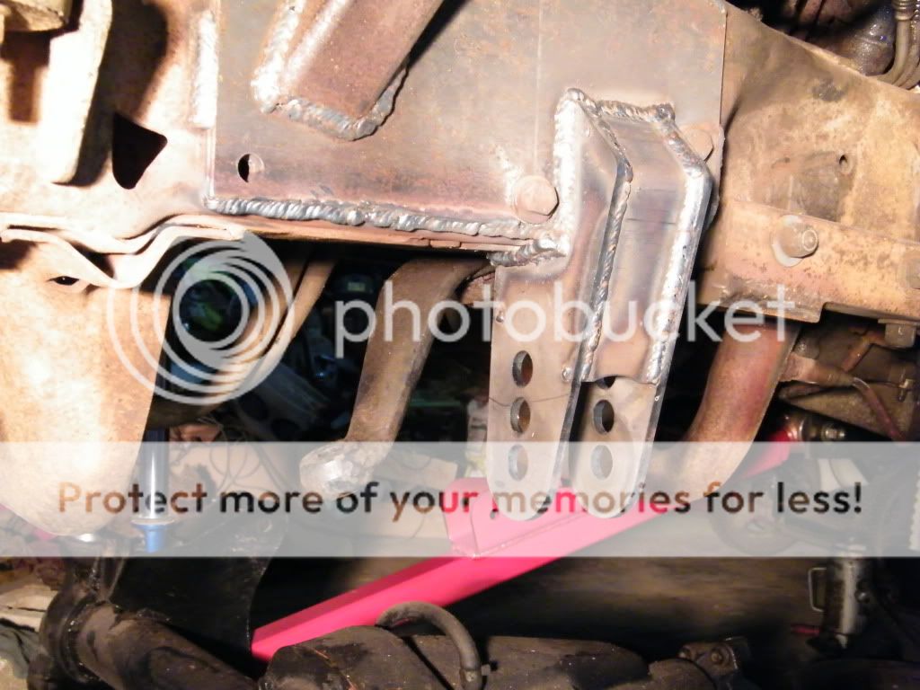

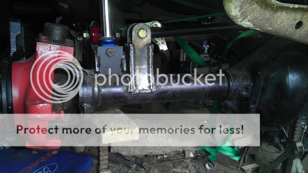

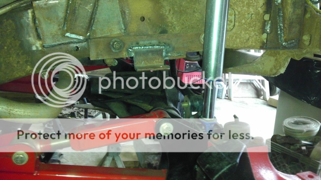

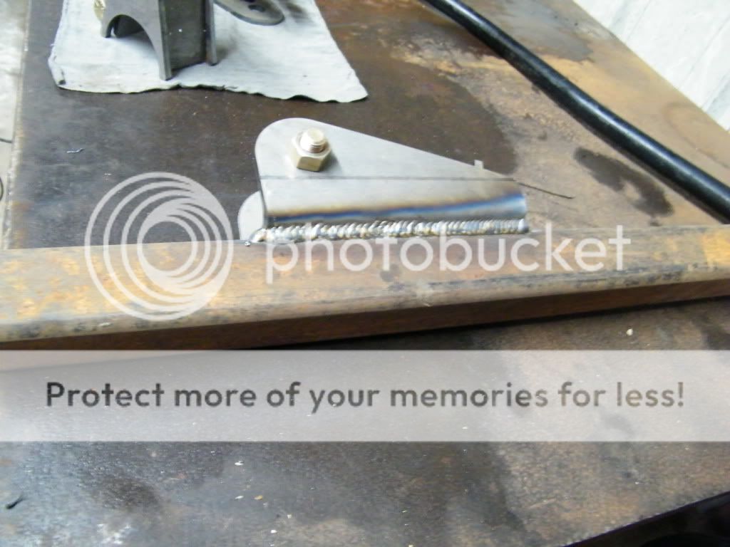

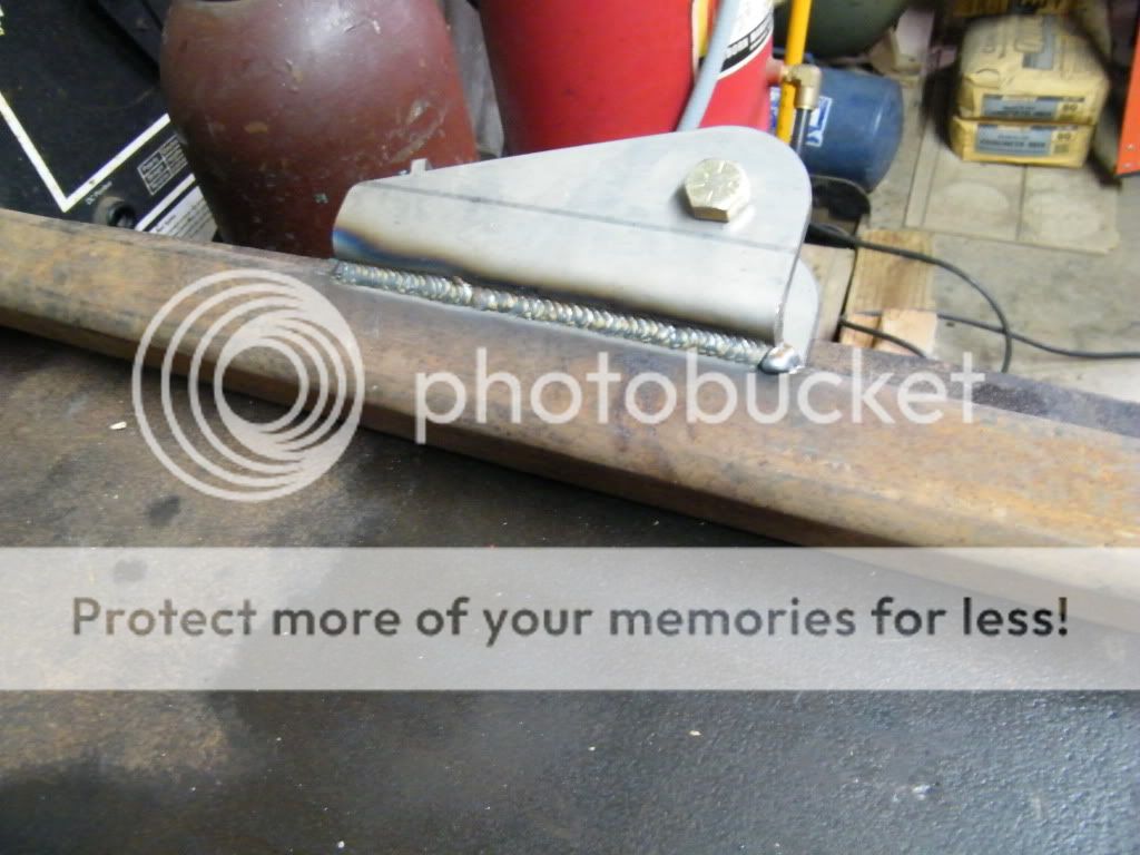

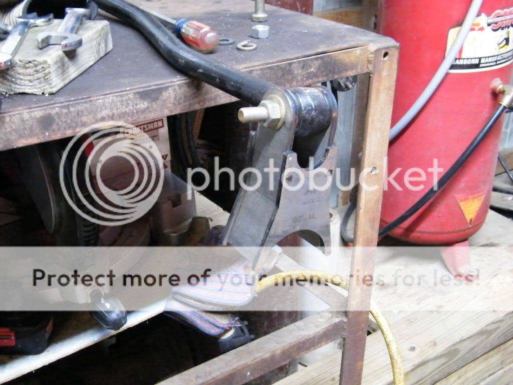

Trac bar frame mount, I also made a pass on the bottom of the plate to the frame for added strength, but didn't take pics of it...
Project SVT

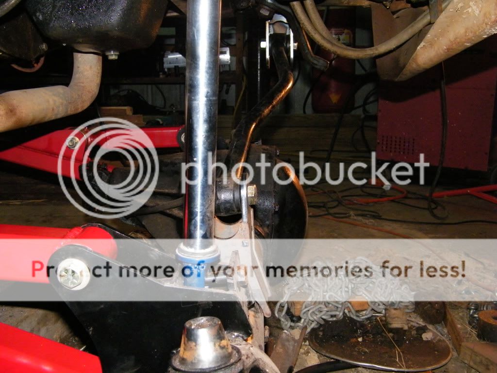

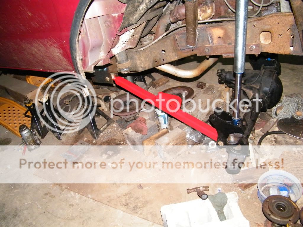

Kind of hard to see, but it doesn't hit the steering, even though its close...
Project SVT
Project SVT

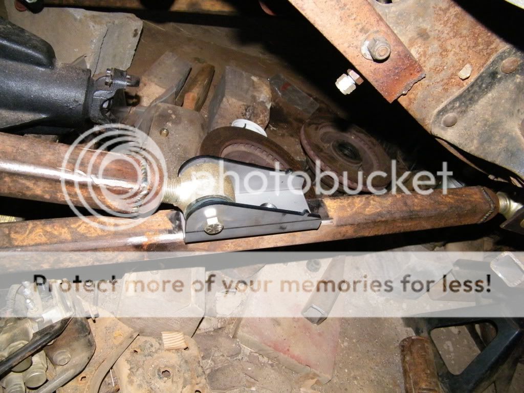

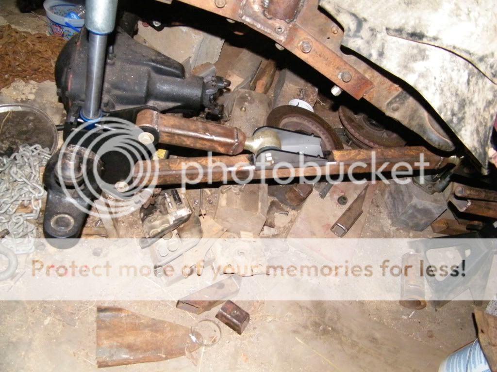

I had to do some work on the trac bar, the bushings wouldn't quite fit. I had to break out the air grinder with the burr bit and do some cleaning on the inside the trac bar...
Project SVT

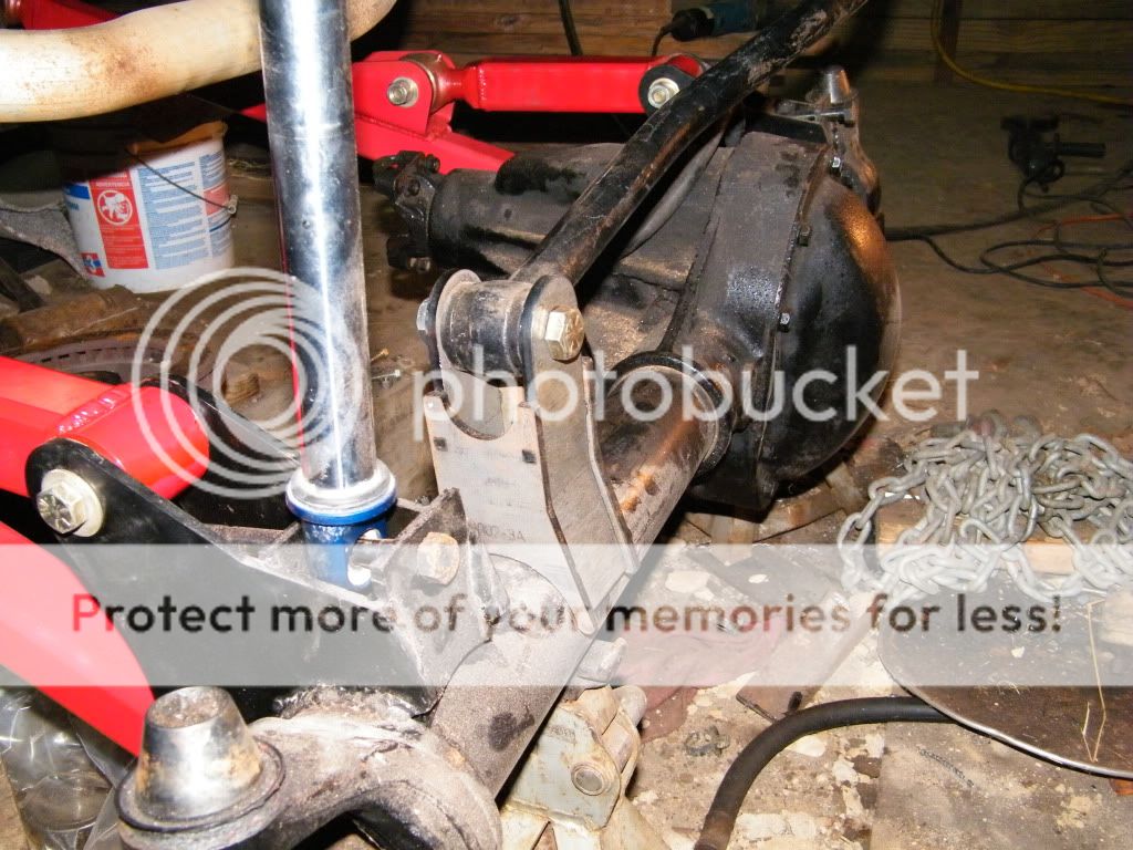

I don't like the angle the axle trac bar mount is sitting at, would like it to sit a little more forward, but the angle of the trac bar will not allow it. As it sits there is slight bind on it. I may have to scoot the axle forward about an inch or so, so its not in a bind. I haven't got to moving it around and didn't weld it to the axle just yet so I can find a happy medium...
Project SVT
Project SVT

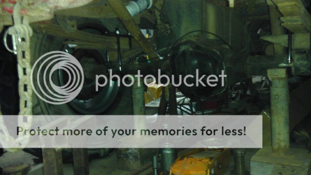

The 60U?? I got the complete axle, if you look in the second pic, with the track bar mounts, you can see part of the axle lurking under the table...

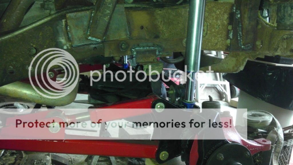

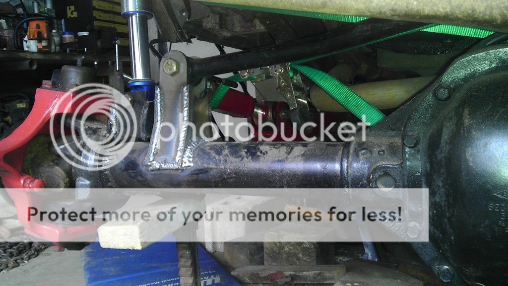

I have completed the front suspension, but I need to go back and redo the lower shock mount, its not far enough out on the axle end. I got my tires and rims and I mounted two of them. I started to mount them last week, but just as i started to drop the tire onto the rim I noticed no valve stems, so I had to run to town and pick up a set, I went with the bolt in style, 1" long. Enough chit chatting, on with the pics...
I moved the axle to get the tracbar mount to align with the axle better, and burned it in...
Project SVT
Project SVT

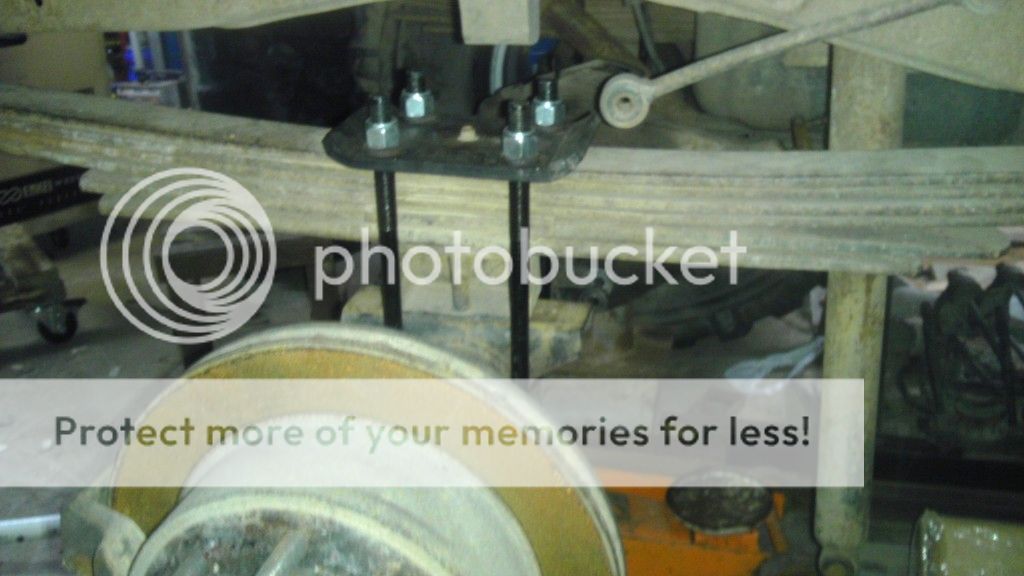

Thanks to Ben, I got these beefy spring plates. 3/8" thick, slotted for extra thick axle tubes, pure sex...I also ordered a set of 5/8" thick U-bolts that are not only tempered, but also anodized for rust protection. Thanks to John for sending me the link, I got all 4 for $29 :shock: To get em at this price, go to Top Gun Customz...

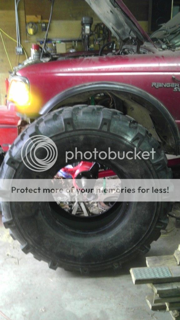

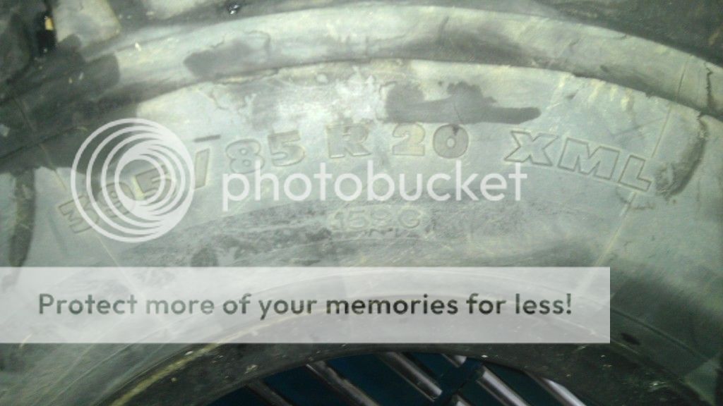

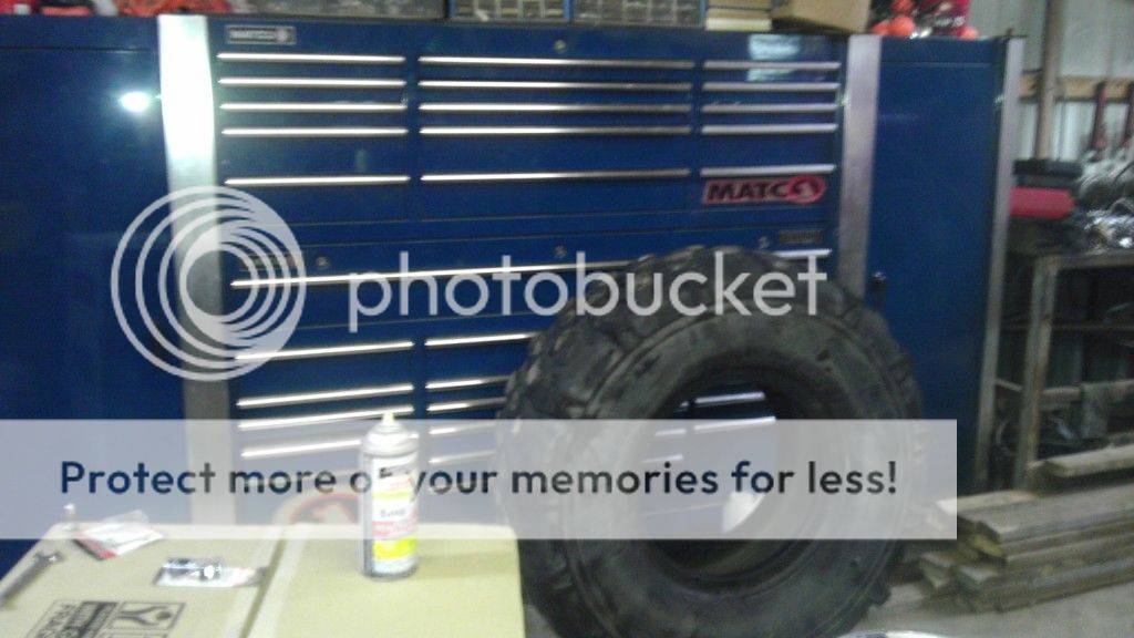

Onto my tires...I've hinted once or twice what I was gonna get, well, here they are, Michelins...
Project SVT
They are a little tall @ 47"...
Project SVT

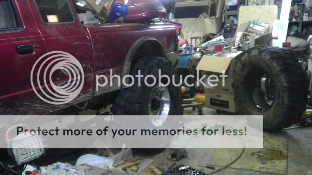

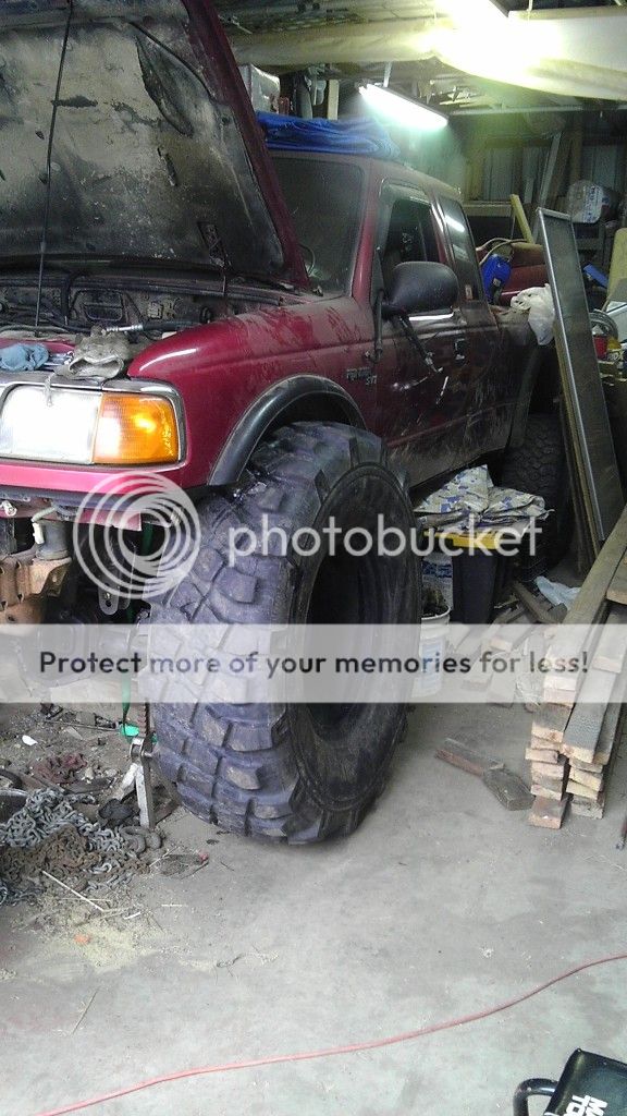

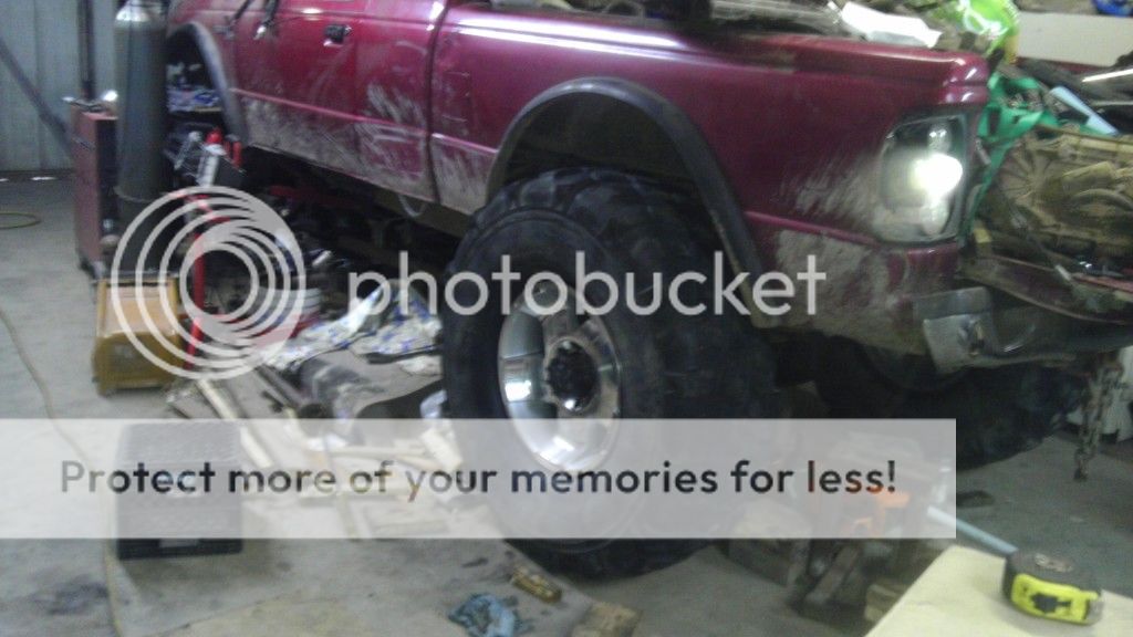

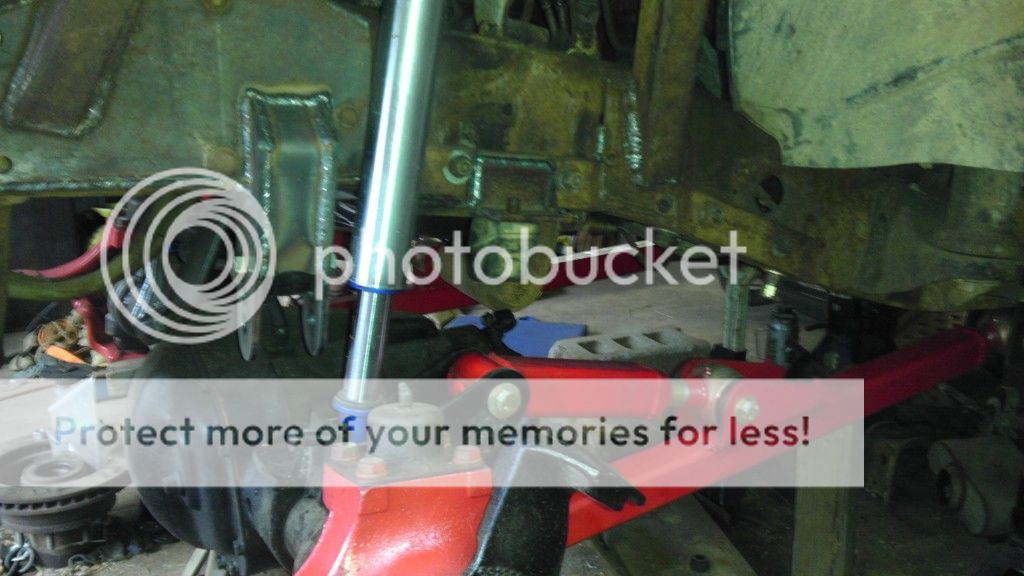

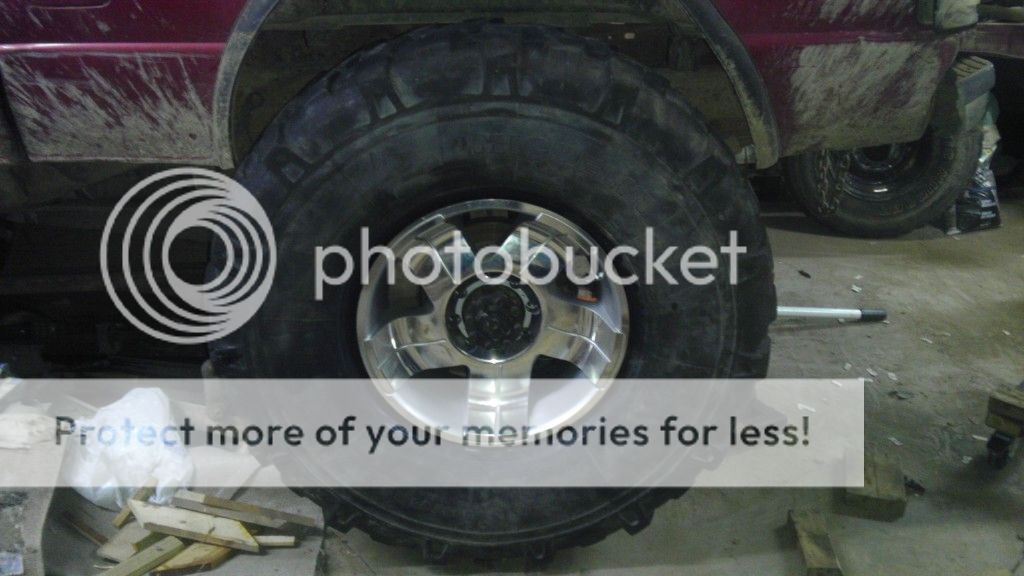

Here they are mocked up in place on the front. It will have only about 3" up travel, 12" down. I need to clearance the lower core support corners. I have raised the truck up 5" after this pic, but didn't take the final shot. The truck will have a little more than the 5" height to match the rear. I mounted the rear tires today and put them on the truck. With the truck sitting at ride height out back, the front will have to go up a little to match the back. I might decide to drop the rear, I don't know yet. First I got to empty the bed...
Project SVT
Project SVT

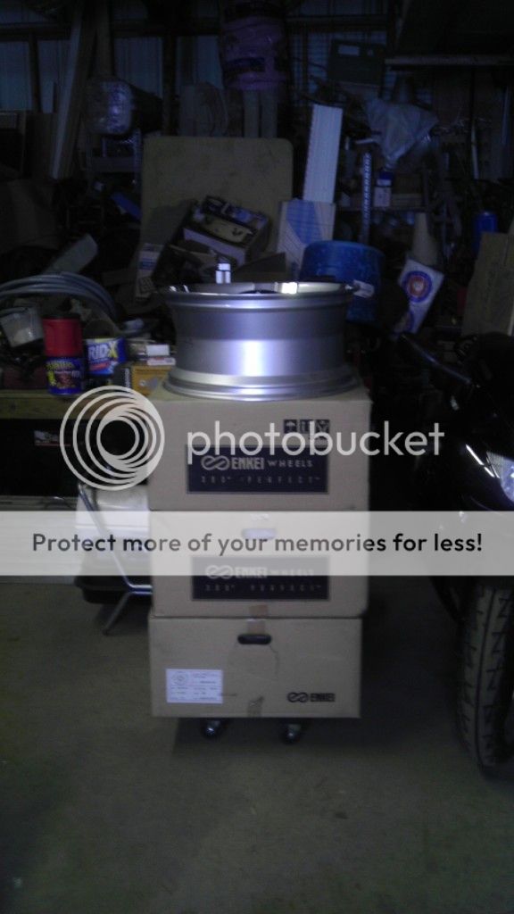

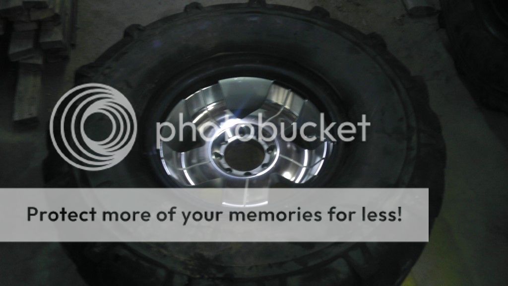

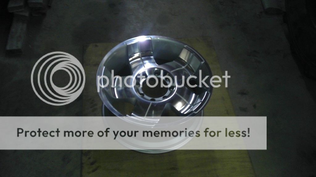

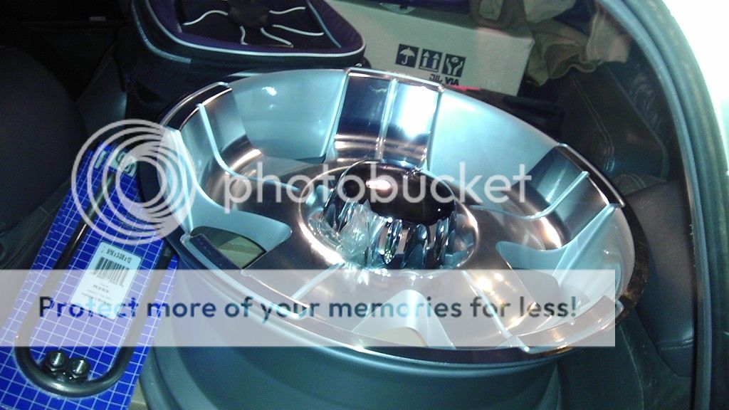

Here are the rims I got. I was going to go with Moto Metals 951's, but I these fell in my lap, CHEAP!! I got all 4 brand new, never mounted and still in the box for $300 :yahoo:
Project SVT
Project SVT
Project SVT

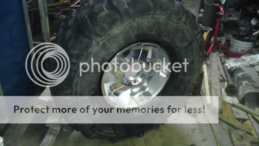

I mounted them for now, but the rims will stay with the 60's when they get moved to ST. Here's how you mount a big rim in a bigger tire....

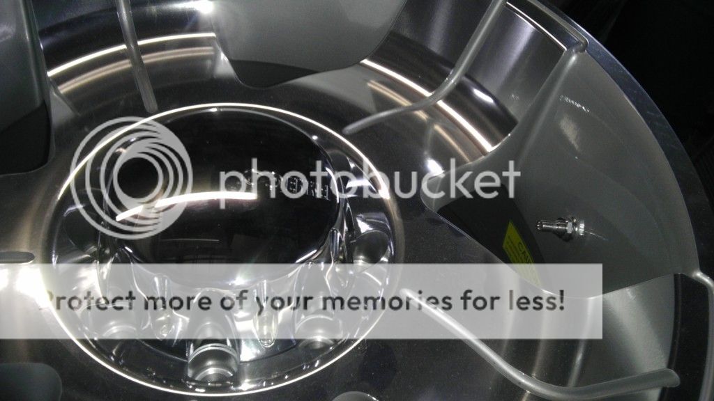

Here are bolt in valve stems I got....

Here they are mounted on the truck...

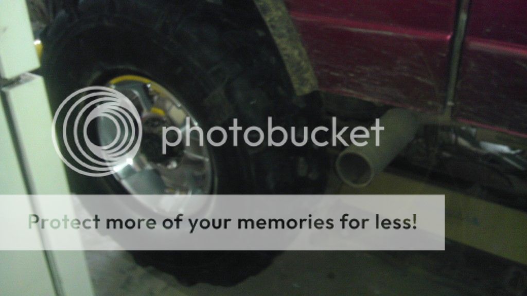

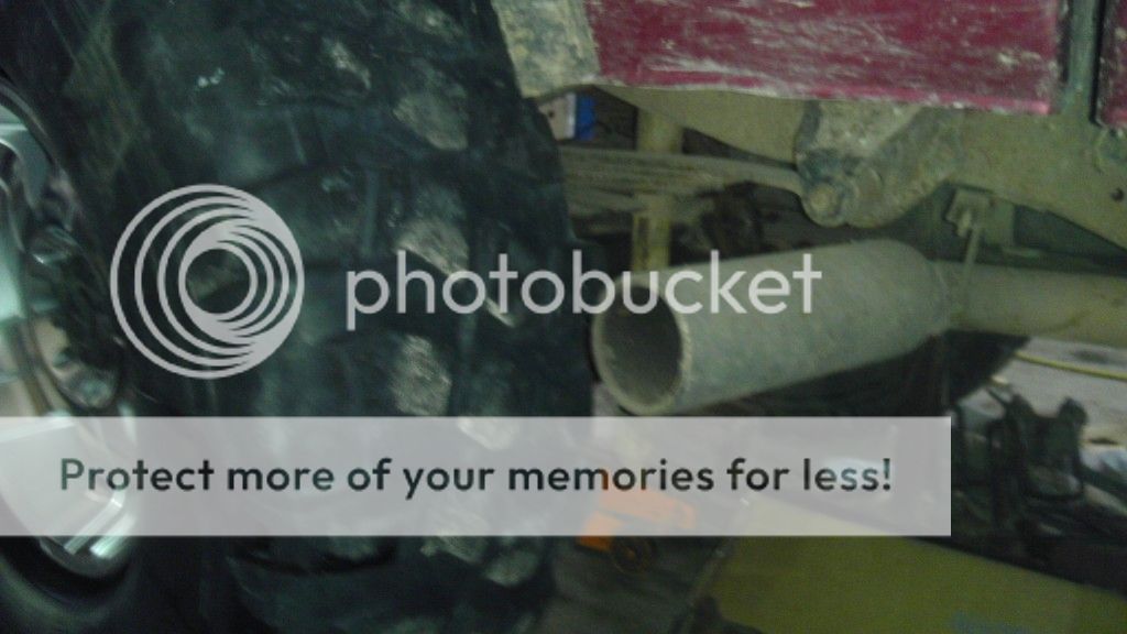

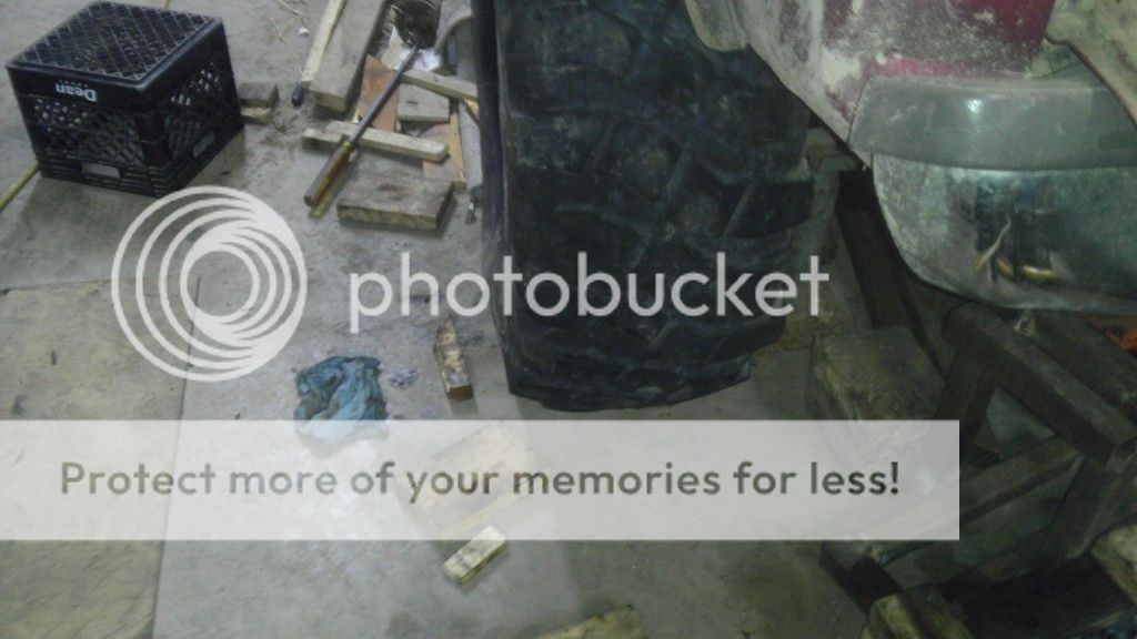

I went to mount the passenger side on, and this was in the way...
Project SVT
So, with a long pipe, I massaged it forward to give me some room. Later I will redo the exhaust. Havent decided if I want to run it out the back, dump it, or side exit...
Project SVT
With all the weight thats in the bed right now, here is how the truck sits with the tires at 7.5 psi. If you look closely, you can see the tire starting to buldge...
Project SVT
Project SVT
