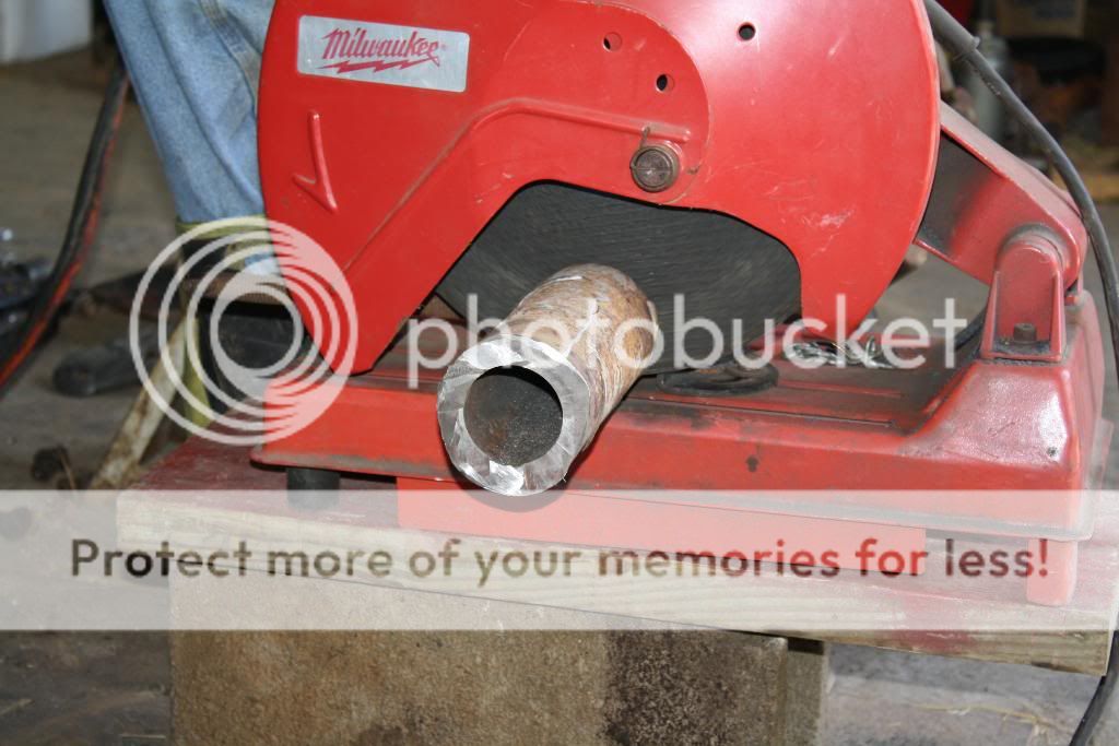

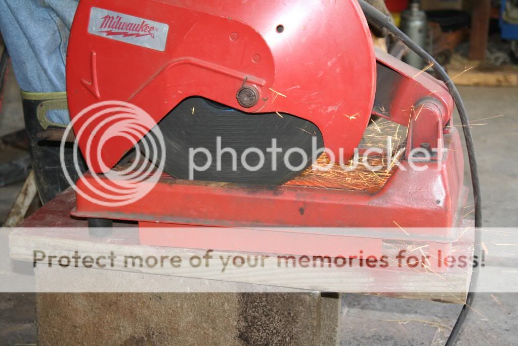

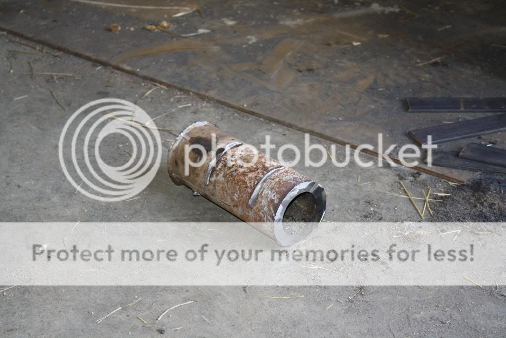

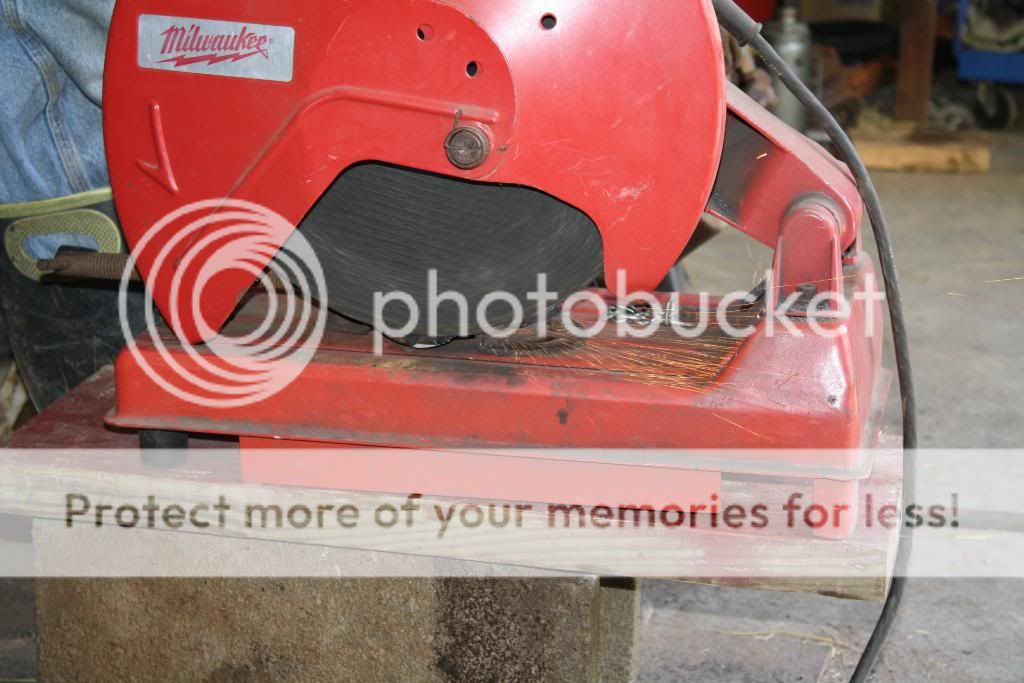

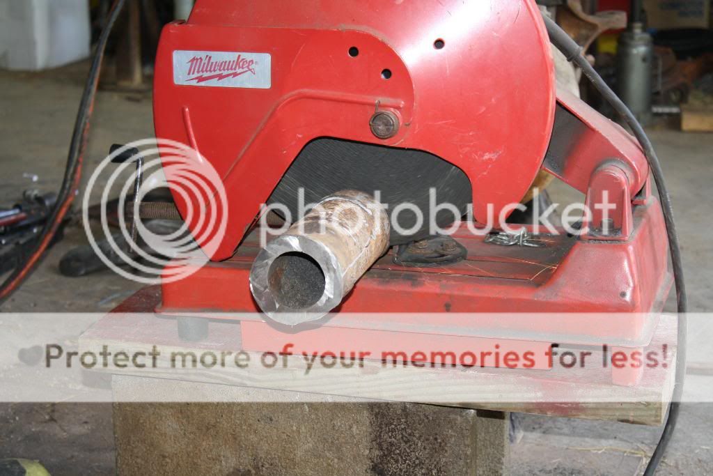

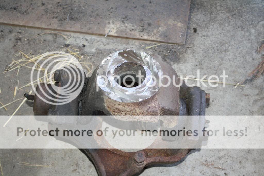

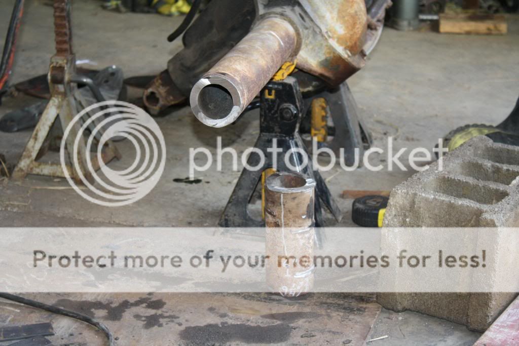

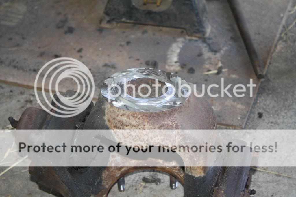

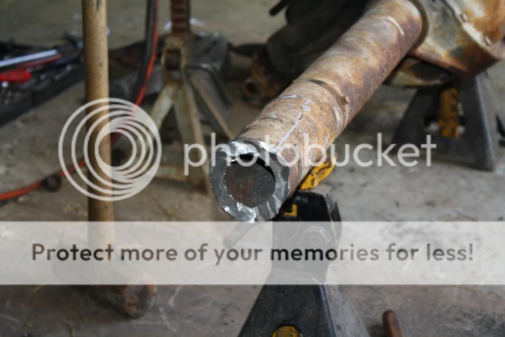

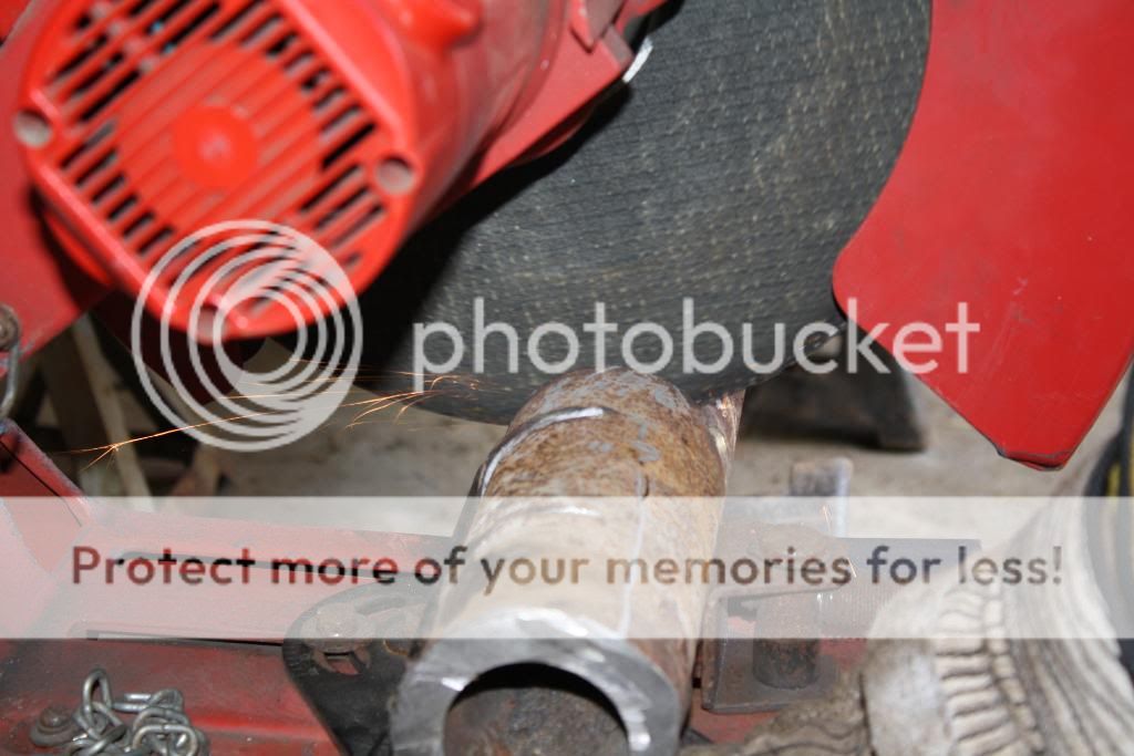

Well, between all the calls I've had and the cleaning up around the house, I finally got to make some more progress on SVT...I got the knuckle off the axletube, the method I tried using apparantly doesn't work on 1/2 thick tubes...so I cut the tube off completely and will use a shop press to press out the tube thats in the knuckle. I also measured and cut the axle tube for the width I want. I cut off 9.25 inches off the tube, so my end width will be 0.5 inches wider than the ranger stock TTB width. I also have a set of 15 x 10 rims that I will be running for a short while, but has a 3" backspacing, which will push my tires out farther....Anyways, here are some pics from today...

I should have the knuckle separated from the tube sometime this weekend or next week....Updates as they come!!

Looks like you used a rabid beaver to chew that off the knuckle............lol!
