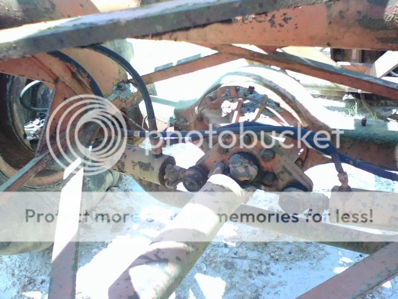

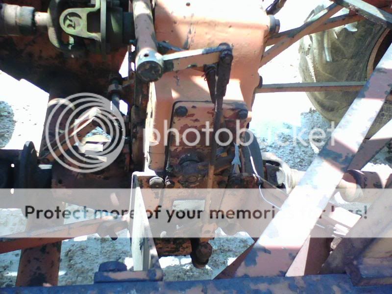

I found these this summer,under a old skytrack,and its still there
Interesting T-Case...
Hmm, I'm sure I could do something with that...but I need to stick to as little projects at a time :icon_thumby:
