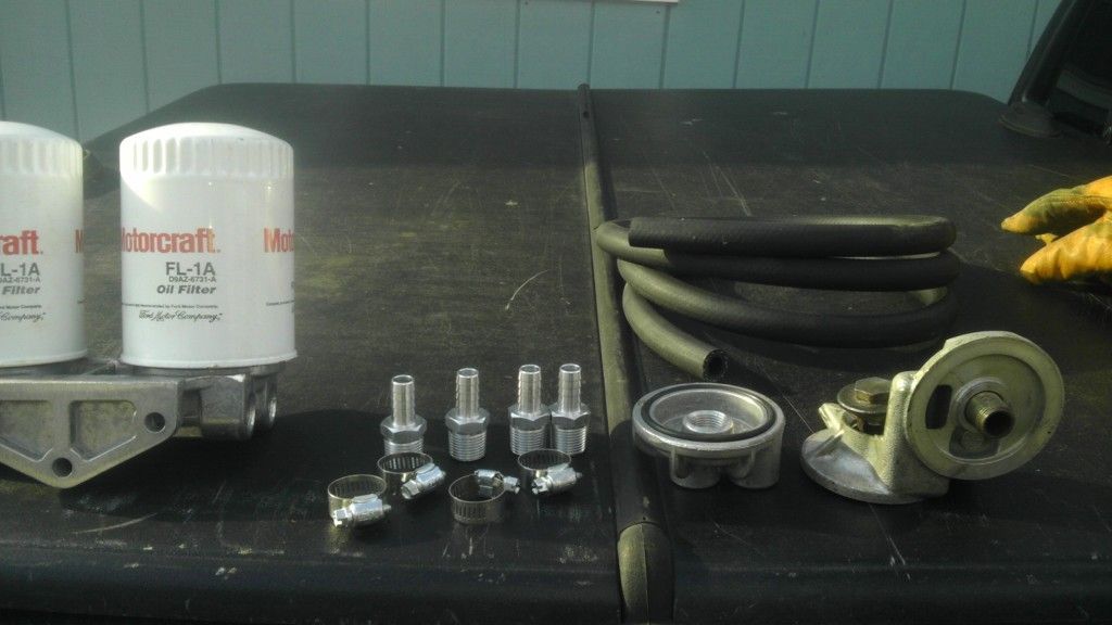

Ok, so here is the dual oil filter relocation kit from Summit Racing, minus the 90* adapter, which is found on the 2.9L engine...

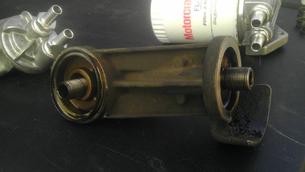

Here is the explorer 5.0L oil filter adapter. It changes the threads from the stock 3/4x16 to a metric 22x1.5. If I knew the kind of headache I had trying to adapt the 2.9L adapter, I would have gotten a kit for the metric thread and used the stock adapter, you will see in a bit...

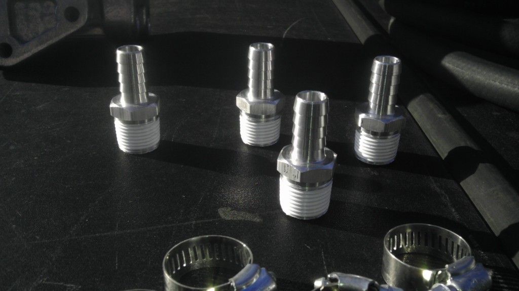

Here is the hose adapters that come in the summit racing brand kit, they are made of aluminum...

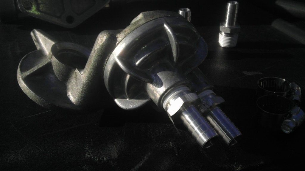

Here the 90* adapter and the block adapter are assembled, along with the hose fittings which turned out not to work. More in a bit...

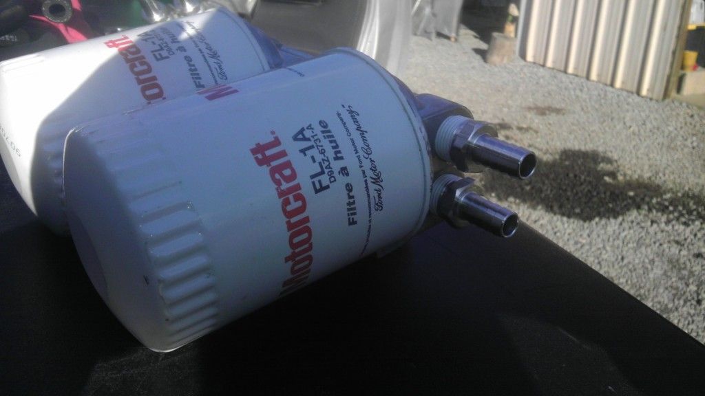

Here is the dual filter housing with the filters and hose fittings installed.
The hose was more than long enough, and I didn't want to cut it as I'm moving the filter housing when I fab my bumper. So I went to re-route the hose to the other side of the dual filter housing (they have input and outputs on both sides and come with a pair of plugs to block off the side not used) and when I removed one of the aluminum hose fittings, it stripped coming out. I know, this sounds wierd, but I threaded in the fitting by hand using caution not to strip and I got a good 4 turns on it before it started to tighten, so it wasn't cross-threaded going in. This was another part of the kit I was not happy with. I ended up cutting the last 3 threads of the fitting, tapped the filter housing, but it was still leaking, so I went and bought another fitting, this time in brass...

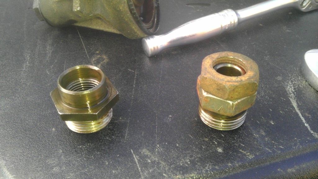

Before I could install the block adapter from the kit, I had to remove the female block thread adapter in favor of a male adapter that is typically used when an oil filter is attached to the block. On the left is what the explorer motor uses, which is needed for the 90* adapter. On the right is the adapter used for oil filters to the block...
Project ST- yet another V8 swap....
Here is what it looks like on the block...
To remove this from the block, you need to obtain two 3/4x16 nuts, install them on the adapter, tighten them against each other to form a jam nut, then using the inside nut, simply back the adapter out of the block. I got this adapter from a spare motor I have in my shop. Summit Racing sells these adapters if you don't have a spare motor laying around. The aftermarket has a hex formed on the inside of the adapter making installing and removing easy. The stock doesn't have this hex as you can see...

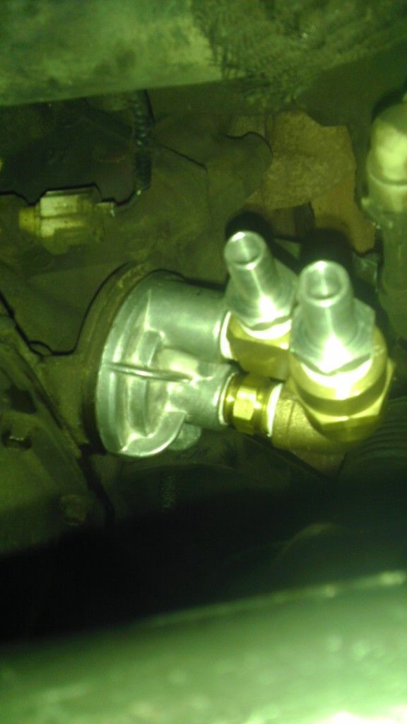

Here it is installed on the motor with a set of 90* brass pipe fittings and the kit's aluminum hose fittings....

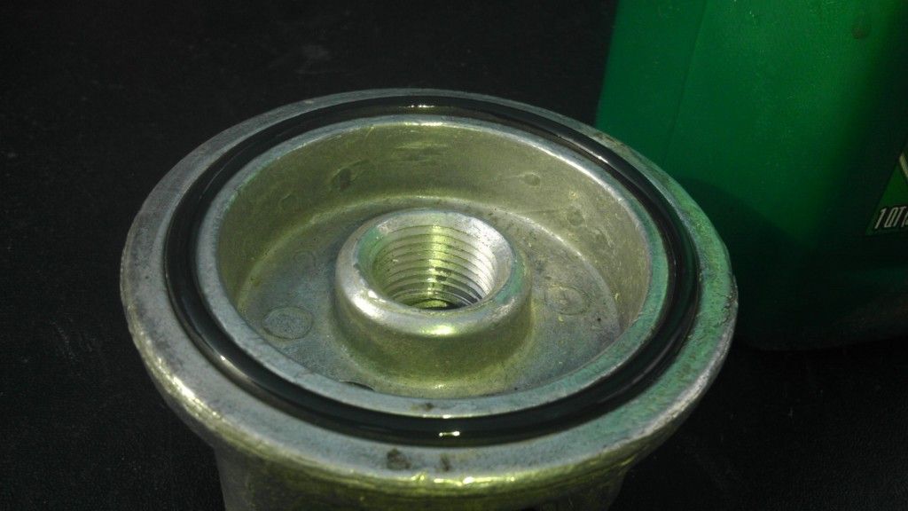

The block adapter I used is not one from the kit. This is one I had left over from a TransDapt kit I used on SVT. Here is the one from the kit. It has removable threaded fittings that is held in by a wire ring. I didn't like this as it is not a sealed fit, allowing oil and oil pressure to bypass the filter. Yet another feature I don't like about this kit. If it had an O-ring between the fitting and the housing, then it would be better...

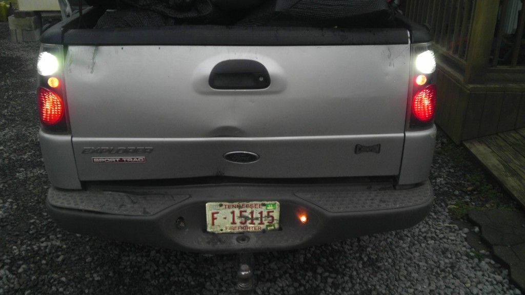

About a month ago I ordered a set of 68 SMD LED bulbs for my fog lights, and the next day I ordered a set of 68 SMD LED 3157 bulbs to replace my older style 5mm 19 LED bulbs. My fog light bulbs came in 2 weeks ago, but the 3157's just came in today. Here is a pic of them side by side....

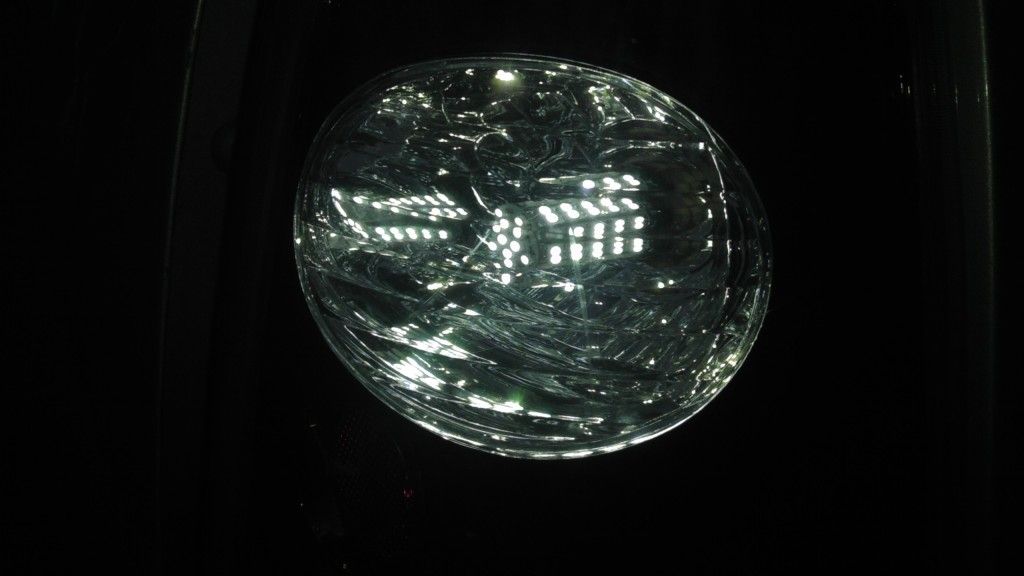

It's hard to see, but here are the 68 SMD's installed just in the left side, the old style in the right, I'm surprised they are not much brighter. You can tell the white LED bulbs throw a different color in the red lens, the right side uses red LED's in the red lens...
This pic shows each of the new LED's in the housing...
Here is a shot of the whole lens...
Full shot of the rear...
Overall they are a little brighter than the older 5mm design, but I am slightly dissappointed that they are not brighter for being SMD's. For those that don't know, you can substitute a 3157 for a 3156 ( it works in either socket, you just don't have the low beam, the low beam contacts are on the inside, the high beam on the outside, on the 3156, the contacts are on the outside). I got em off ebay, paid $16 and change for 4 LED bulbs shipped to my door. I figured I could throw the change out to try and see how they are. Buggman over on TRS also makes custom LED conversions, and I'm thinking they are brighter than ebay's. Of course the ebay ones are from china, so they may be a lesser output quality...

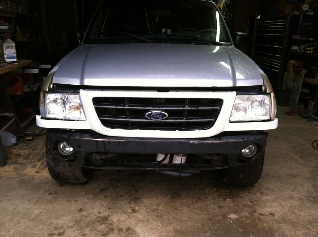

hows the front end looking?
Unfortunately, it'll be this way for a couple months. Things are going slow and I got other things going on. Still need a hood, header panel and grille. Care to donate :D
