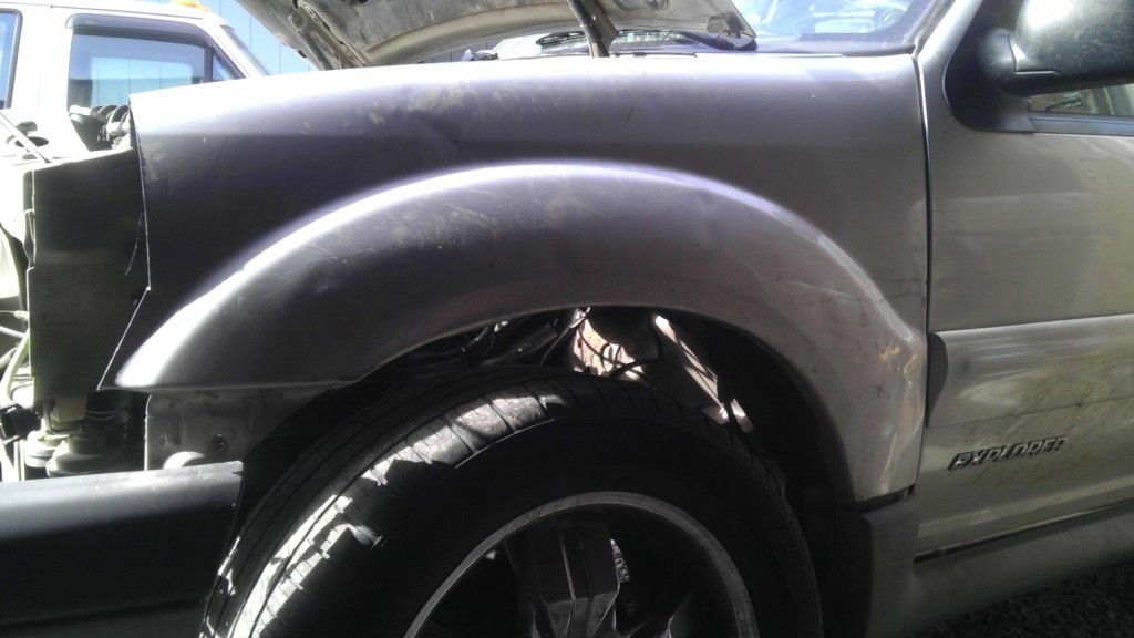

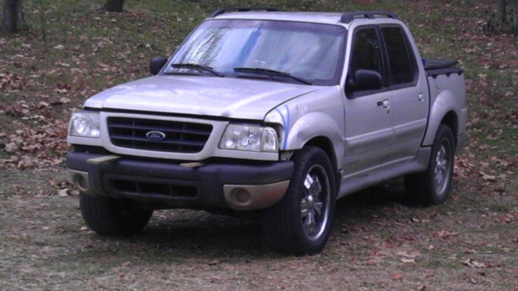

Ok, so as some of you know, Thursday I had a deer run into the side of my Trac coming home, and I figured now is as good a time as ever to do my 02 ranger front clip swap. I was hoping I could get by with using the stock trac hood with the 01-03 swap so I didn't have to get a hood, which is why I didn't go with the 04+ ranger clip. Anyways, here is what the deer did to my driver fender....

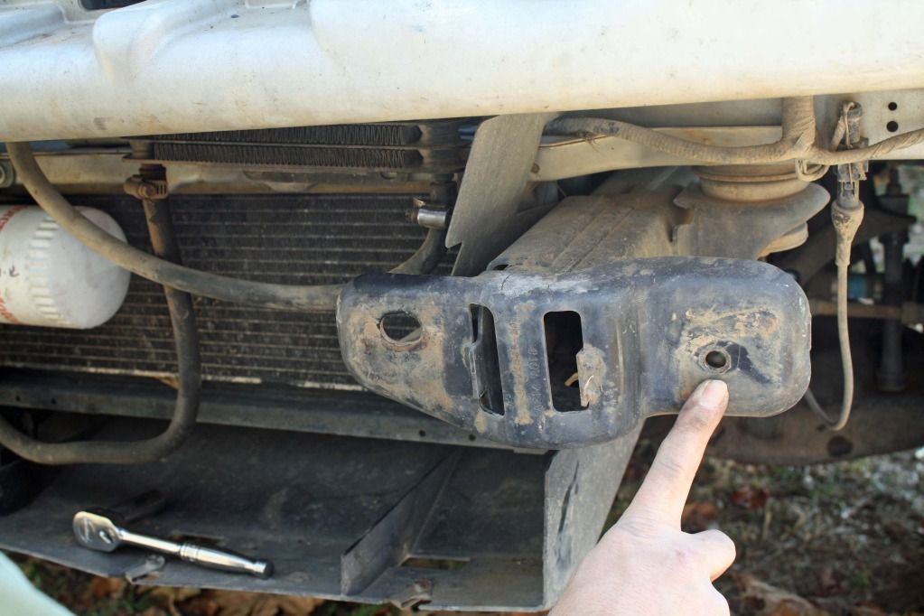

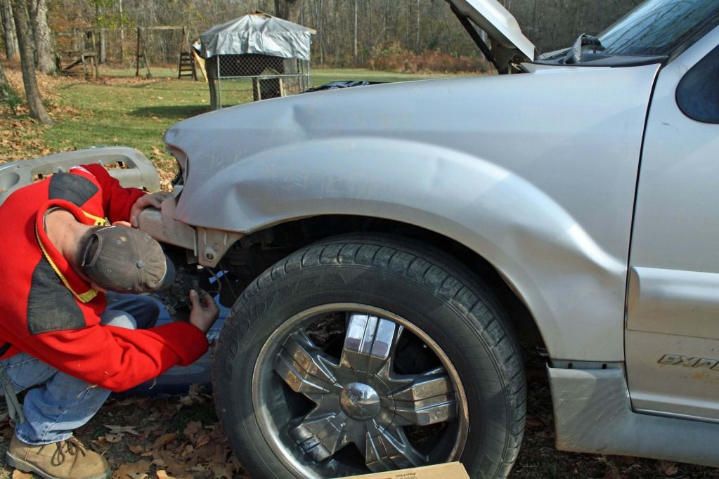

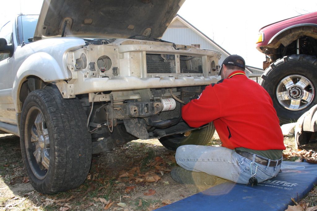

Here I am pulling the front end apart. I had to pull the grille, headlights/corner lights, header panel, bumper support, and the factory tow hooks...

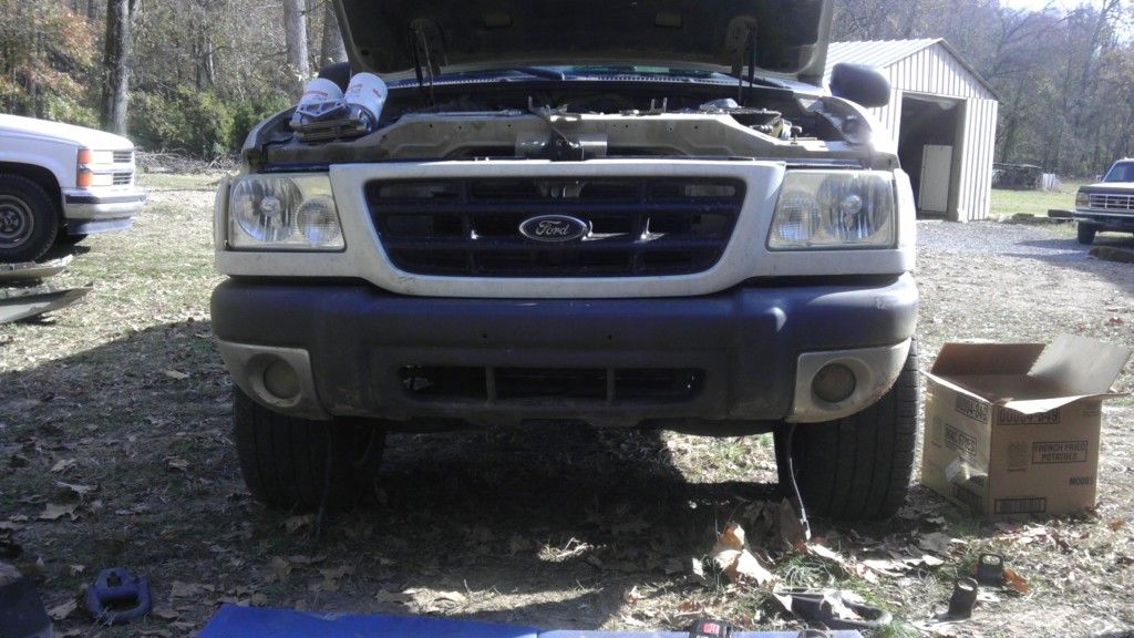

I just mocked the header panel with the grille and lights in place to check for fitment...

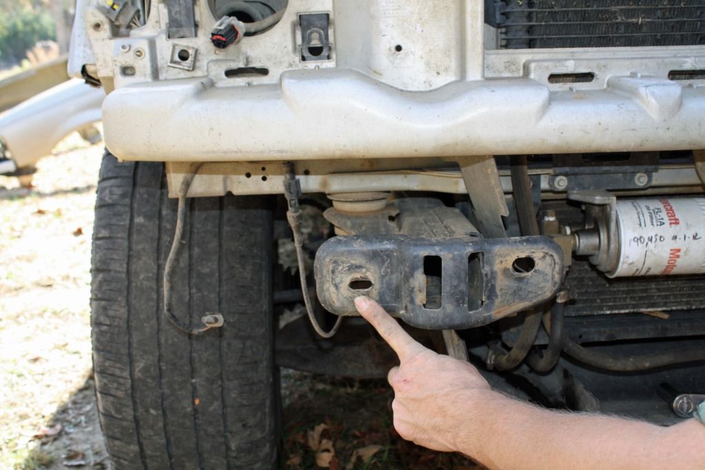

Thats my external trans filter. My dual oil filter housing is going next to it, I'll also be turning the single filter housing vertical. The tires are actually about 35% even though they don't look it. Next set will likely be 35's....

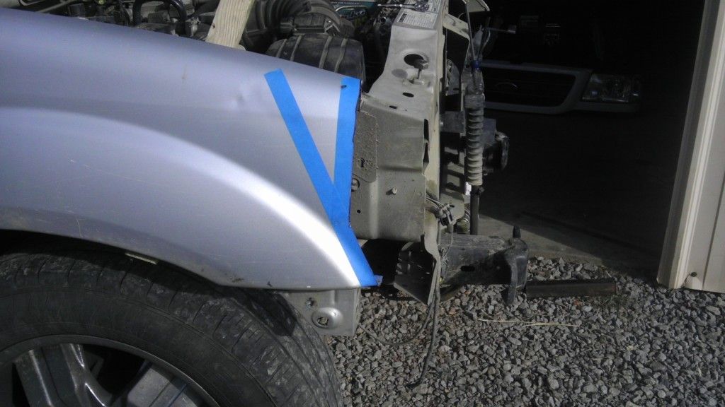

Ok, so after this morning of feeling someone dropped a truck on me and then injesting box of 2 year old rat poison, I finally got out this afternoon to do more work. With all the measuring I did, it wasn't enough, and as you will see, I'll need to do more metal work. I started by pulling the fender off and knocking most of the dents out from the deer's handy work...

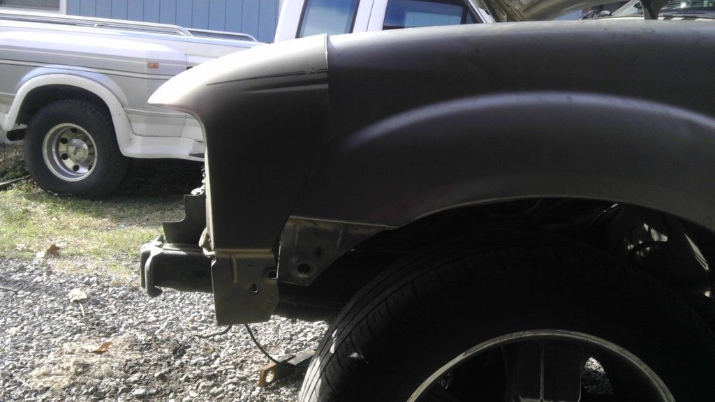

As you can see, I also cut the front of the fenders off. Cause of the flare that the fender has, I had to cut it on an angle like you see...
Here the replacement piece is mocked into place..

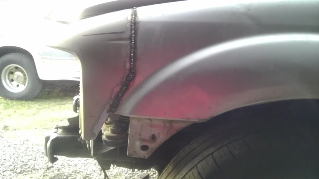

Here is the two panels being paired together. I started at the top, aligning the heighth, horizontal plane, and the forward angle/pitch of the nose. Took a little manuvering, but finally got it in place. Then, I aligned the panels and tacked them in place so the two panels would match, you can also see one of my measurements where I was off...
After its tacked into place, then its welded into place using care not to put too much heat in one place to prevent warpage...
This is about as far as I got today. I had to stop early as I had other tasks I had to do. You can see by the difference in the panels at the bottom that I need to extend the fender side further down, but this will take quite a bit of fabwork as there is multiple compound bends and contours where the flare is. I'm thinking of getting a set of SuperDuty pocket style flares as they will cover the imperfection. For now I'm thinking of just angling the front to the fender. Most likely the custom bumper will hide this section, which will end up getting cut off anyways...
