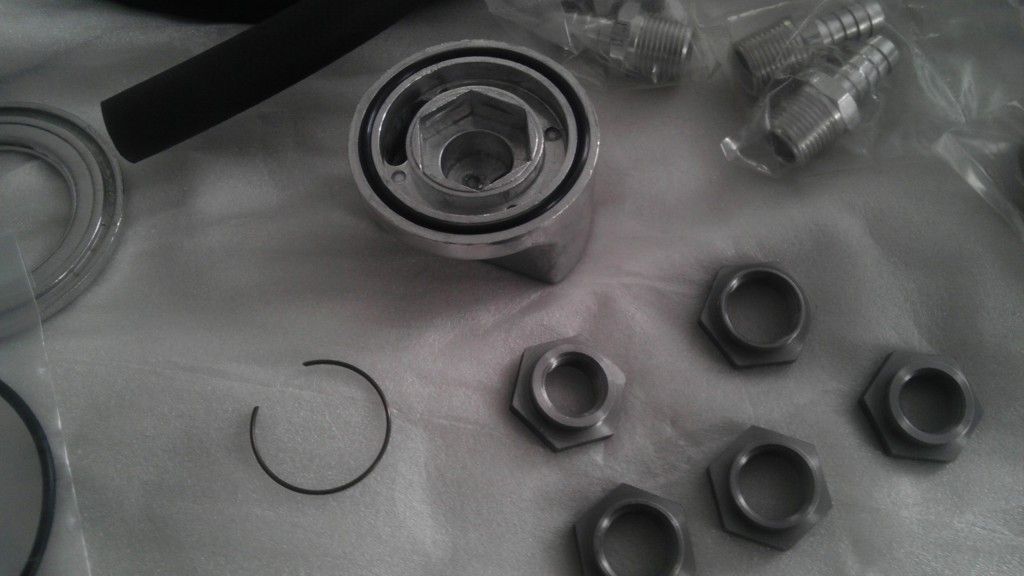

I've put about 6k miles on the trac since the swap, and its time to change the oil, again. Ever since I did the swap I wanted to get away from the small 820s motocraft oil filter and run a dual setup like I did with SVT. I ordered a kit from summit, summit's brand, # 4986-1. SVT got transdapt unit. Both dual filter housings from both companies are almost identical. The block housing, however is very different. I'm not at all impressed with the summit brand block housing. It has individual fittings to adapt to different blocks with different threads. That fittings is retained by a wire spring similar to a snap ring. Since the fitting just sits in the housing, there is nothing that seals it, allowing both oil and oil pressure to bypass the fitting. I have the old housing from the transdapt kit, and I'll be using that one..

Since I have rack and pinion and not a gearbox, I think I have enough room that I don't need the 90* block adapter. Later when the 60's go in I'll use an early bronco box that sits outside the framerail so it wont interfere with the block adapter...
