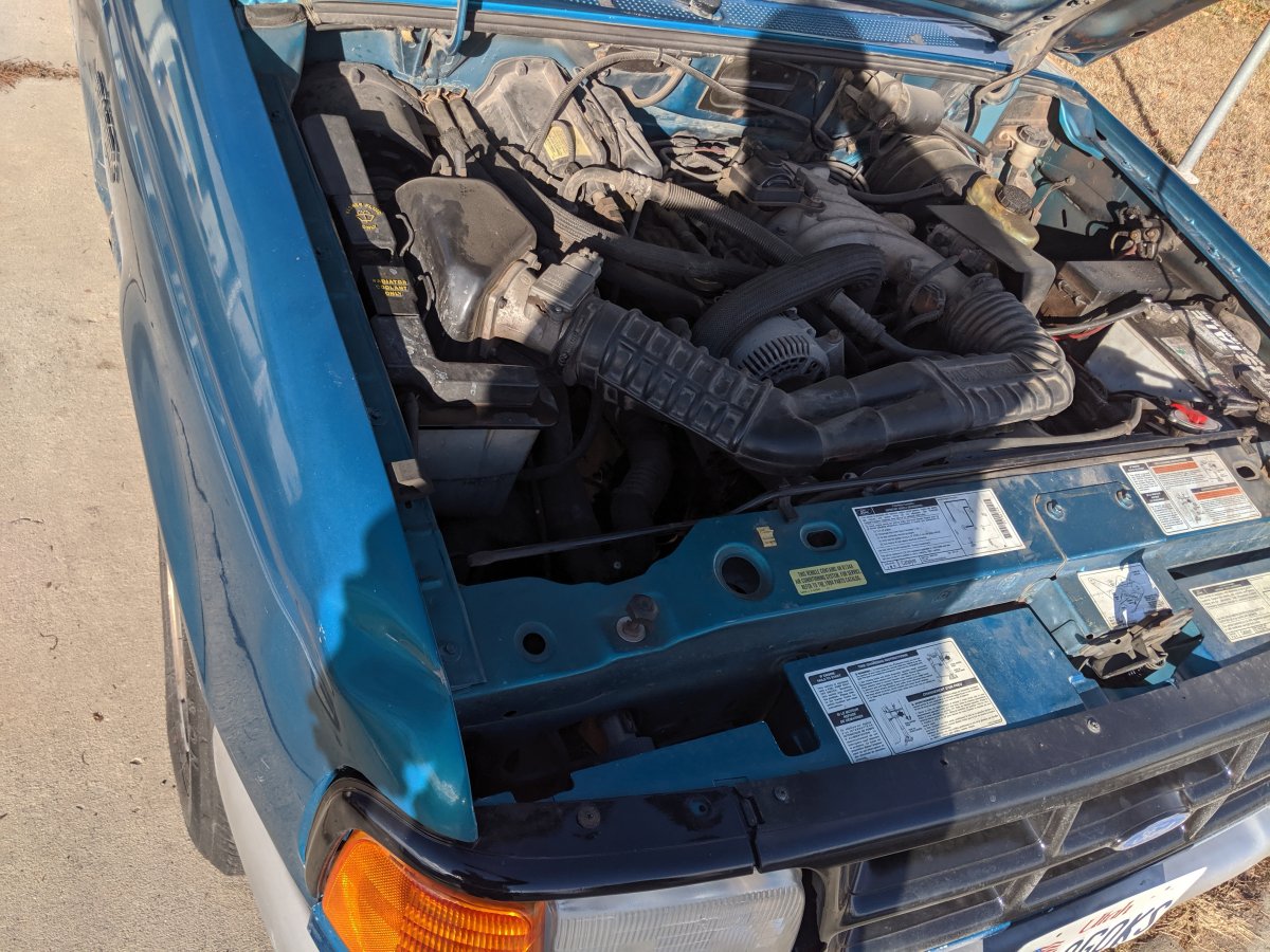

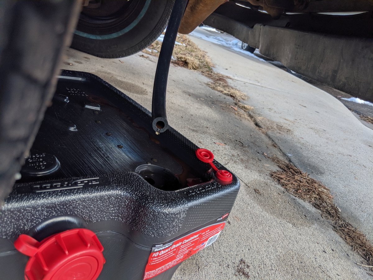

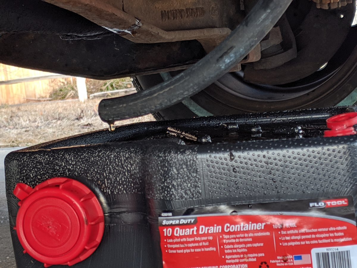

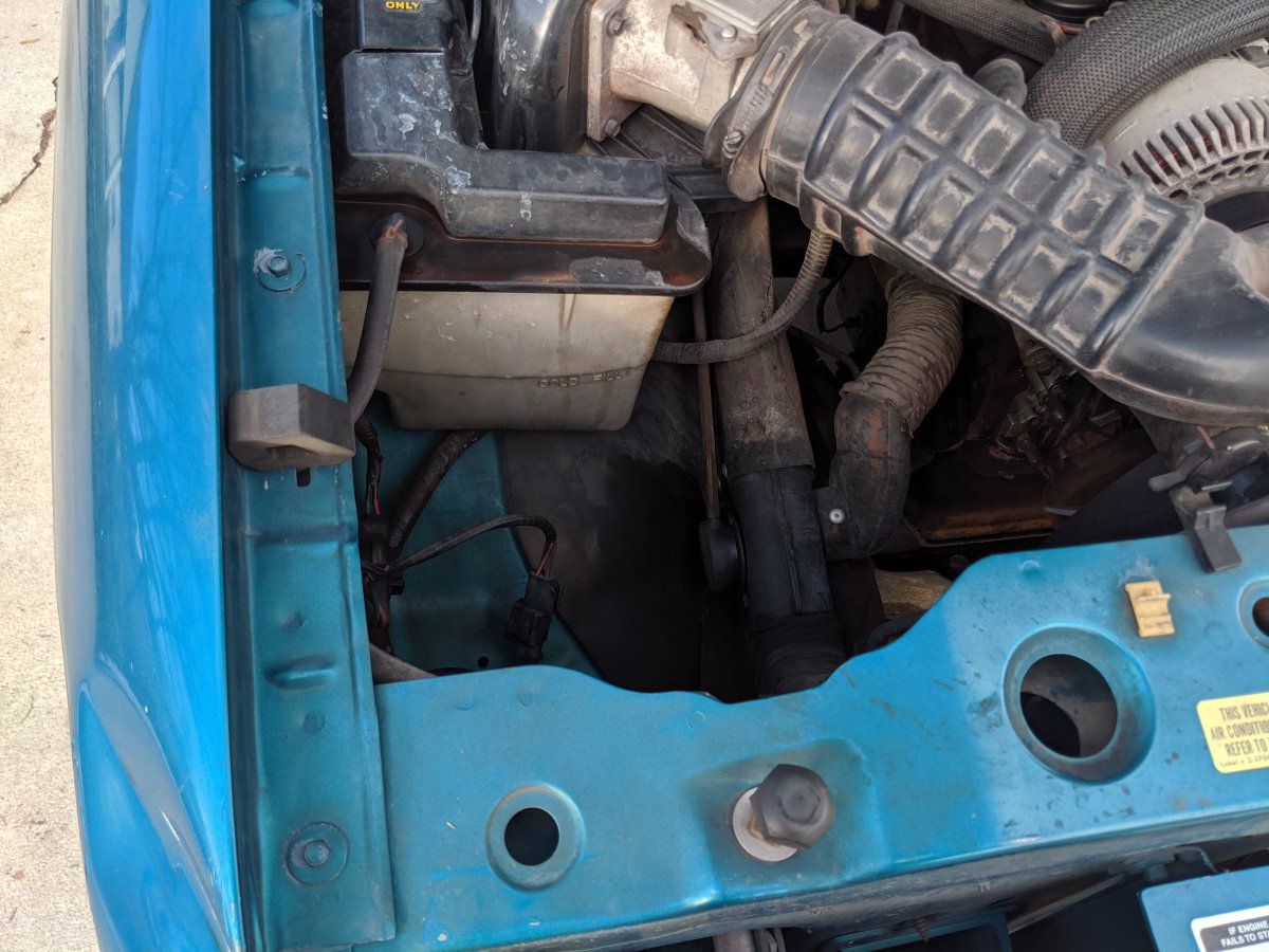

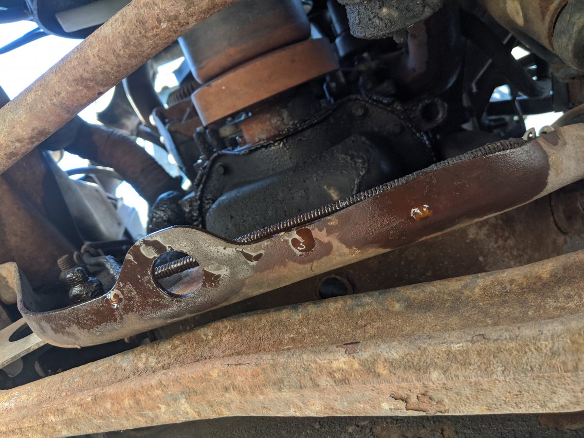

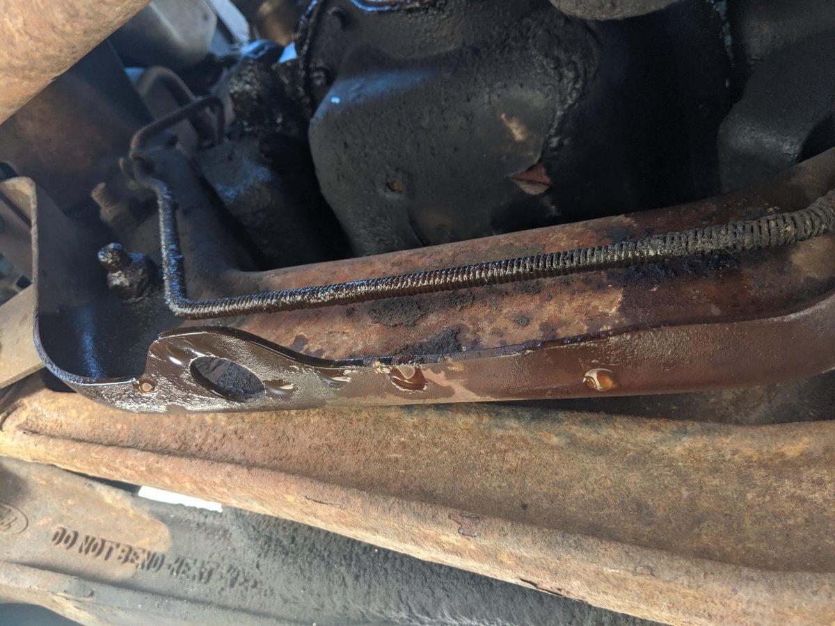

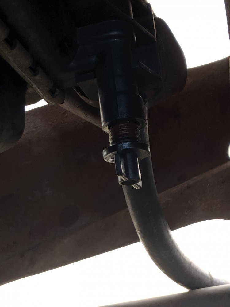

First real attempt at a repair project on my '93 Ranger XL (who shall be named Rick Sherman, I think) is a bust. My goal was to change out the thermostat, but I barely managed to drain a cup or two of coolant. With the radiator cap off and the valve at the bottom as open as I could perceive it able to go, it merely dripped. The reservoir didn't seem to be budging, nor did what I saw at the top of the radiator. I even pulled the valve plug out of the bottom of the radiator, which got a little more coolant out (through the plug hole, not the spigot).

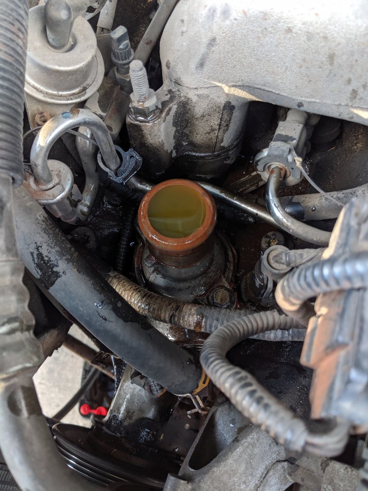

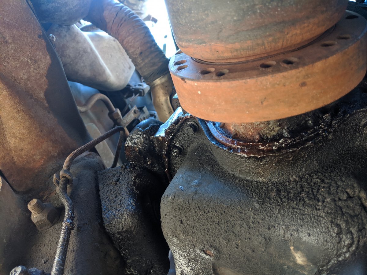

After a while, I thought I would try to at least reach the thermostat. I got the hose off and *whoosh*: a non-draining thermostat housing scowled up at me as the coolant that had been in the hose ran down over the engine.
I thought, "Maybe if I run the engine? Heat it up? Move things?" So I replaced the hose atop the thermostat housing (reclamping it), and started it up. Nothing. Stood with my hand on the throttle for several minutes, holding it open. I thought it odd that while I held the throttle open to nearly the same spot the whole time, the rpms fluctuated quite a bit. Still no love from the drain tube. So with light fading, I packed up and accepted today's temporary defeat. If anybody has bright ideas, I'm listening.

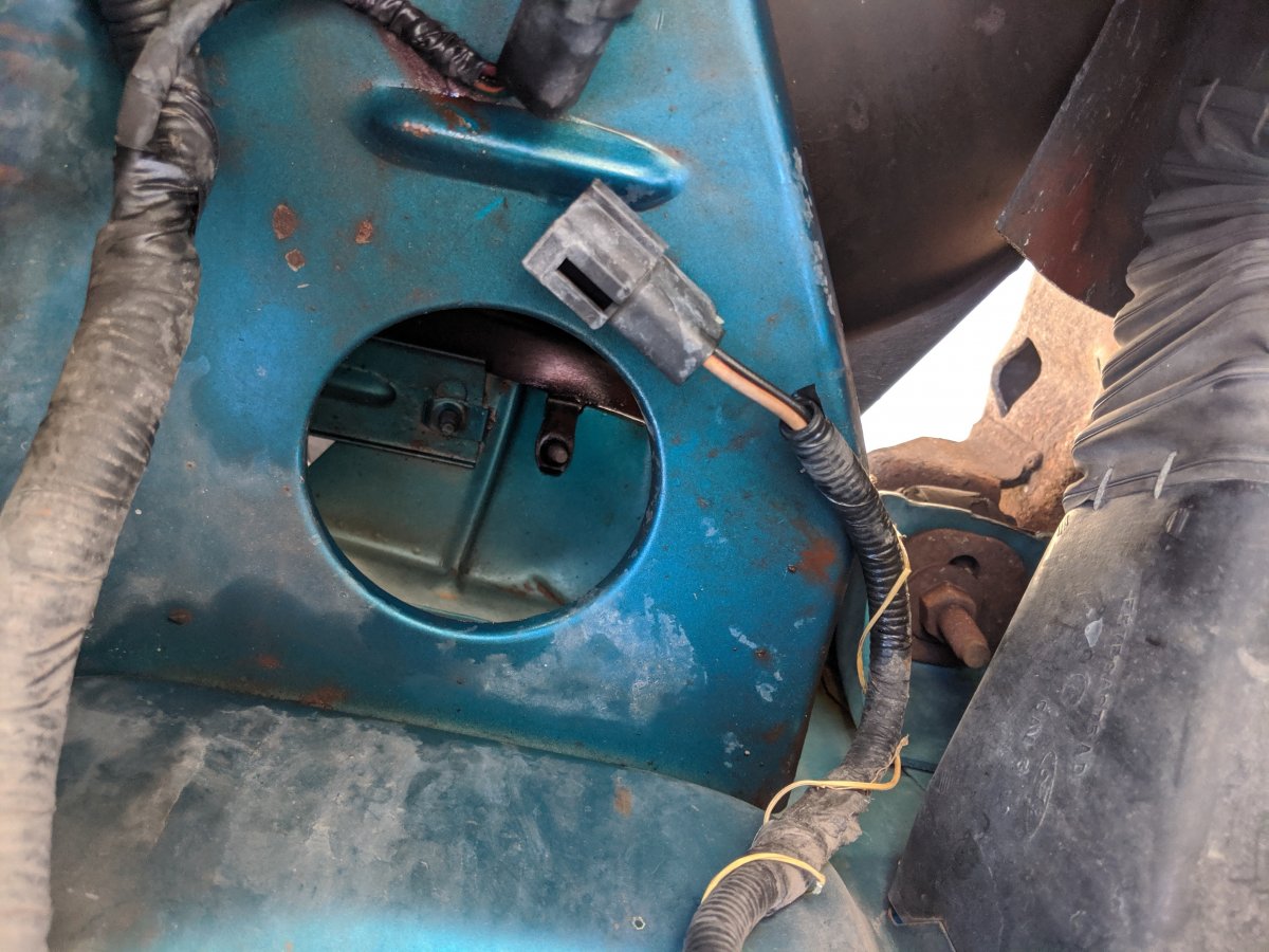

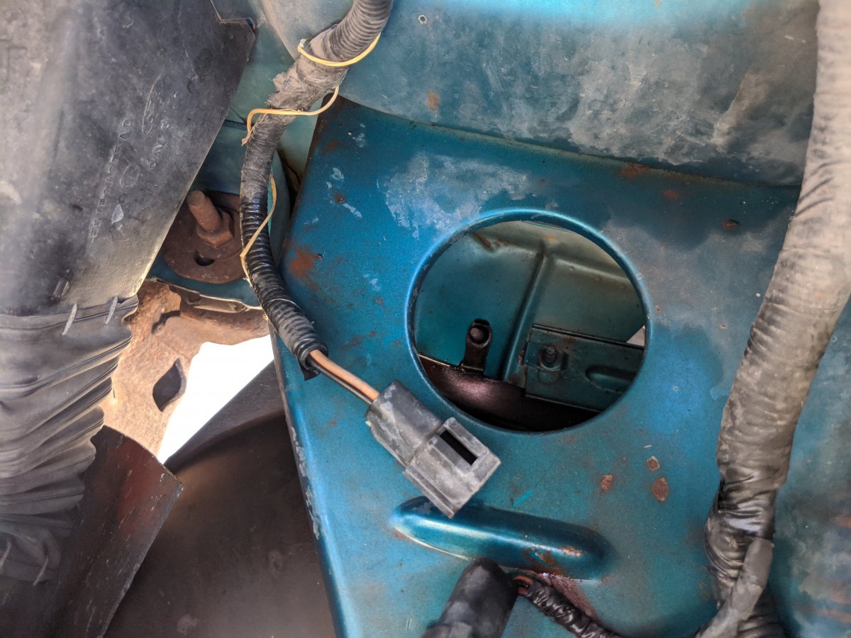

As a side note, there's a plug in the front passenger-side corner of the engine bay that's not plugged into anything, and I'm not sure what it would plug into. Any ideas?
That plug might be a fog lamp harness plug maybe.....

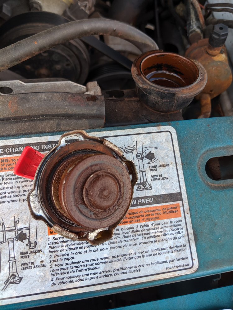

Also if you are not getting anywhere with the petcock pull the rad fllip it upside down and run water through it for a long time and spray air in the hole for the petcock it probably has black sludge in it. Or get a new radiator. Hoses thermostat and housing.
Dont be surprised if you get a big air buble somewhere in the block or heater core after filling it up again. If you have an air compressor get a vacuum pressure setup. Follow instructions from the manufacturer.
Looking at the condition of the cap... your radiator is plugged.
Well, the pressure test at O'Reilly's showed a leak in the radiator itself, so a new radiator was already on the shopping list. *sigh* So how do I drain the system without getting antifreeze everywhere? Or should I just assume it will get everywhere and be ready for the hazmat cleanup?
Its antifreeze not the elephants foot at Chernobyl.....
Probably want a new water pump also, get the hose out and spray water through the block with the pump off then use straight antifreeze since your blocks gonna have lots of water in it. And sometimes you cant avoid making a mess. Especially with how bad that system looks.
It's gonna be everywhere... I would try pulling the lower hose with your drain pan below.
You need to spend some time and effort flushing the system before the new radiator goes in... including back flushing the heater core.
