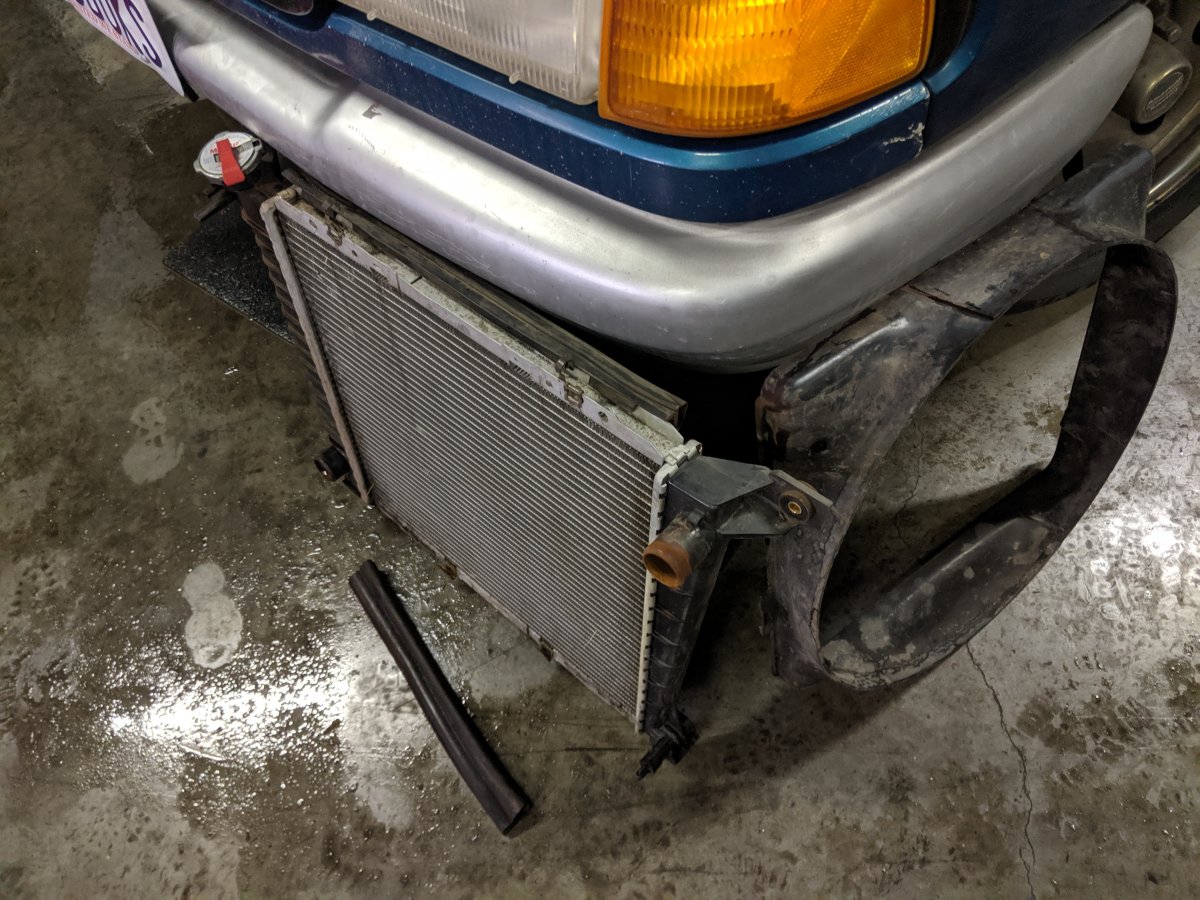

While your at it you might want to feel your coolant hoses too to see if they are soft or cracked. That's how my radiator looked when I flushed it. My advice is to get a wide drain pan or cut down an old tot down to about 6-8 inches and use that for a catch pan as coolant gets everywhere. Pull the big hose at the bottom of the radiator and start flushing with a garden hose. Be sure to use concentrated coolant (no 50/50) since you will have more water in the system/engine than you might think and it's better to be safe than sorry since it is winter time. I think I filled 4-5 five gallon buckets when flushing out the nasty brown coolant.... Hope you got somewhere to take the waste too.
The Waste Management transfer station is just a little way down the interstate, and that's where the O'Reilly's guy suggested I take the old stuff. I do think I'll look into a couple more Homer buckets from the Home Despot, though.

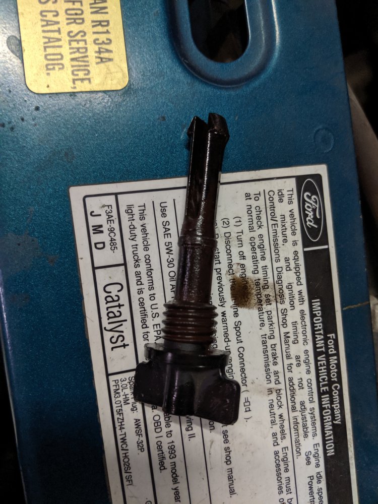

Never found a better way for that. You'll get your aim dead on someday. Then the petcock will break and **** everything all up.
The drain plug on the bottom of radiator can be removed all the way. When I have done coolant drains on my 3.0, remove the radiator cap, and slowly loosen the drain plug. Let the coolant drain slowly into the pan, and after some time I remove the plug from the radiator. The rest flows out into the pan, no mess on the floor. Learned that from my dad decades ago. For getting rid of coolant, I have always taken to my mechanic, and he pours it into the can where all of the other coolant goes. Whoever comes and gets it when it full, no idea. Probably same type of company that gets all the other fluids when the container are full. Seeing that people dont maintain cooling systems has always been one of the many things that bothers me.
To get the radiator to drain... try putting a few pounds of pressure into it with a pressure tester,(5-10 lbs) then open the petcock slowly. That will usually blow the clog out.
If you don’t have a pressure tester, go borrow one from the auto parts store.
You may make a little mess. Put a length of hose on the drain and run it into a bucket. That will keep the mess to a minimum.
I actually pulled the drain plug out the other day when I made that first attempt to drain it, but I confess I didn't add any pressure (don't have a pressure tester...yet). Actually, a friend of mine has generously offered the use of his shop on Saturday, so we'll see if I can have better success on Round 2.

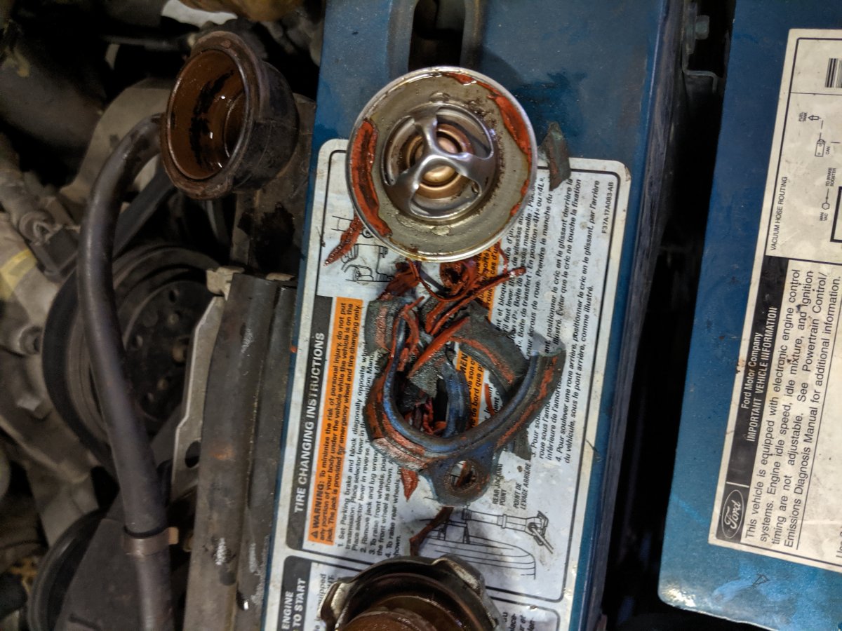

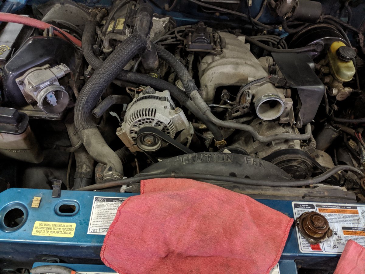

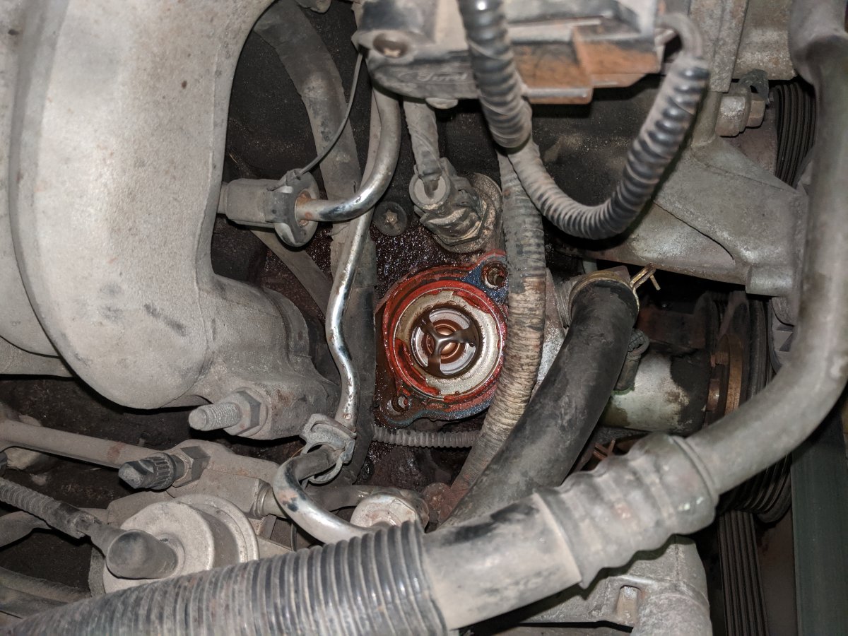

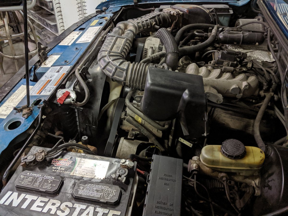

Okay, I've got the new radiator, new water pimp (yes, pimp), and new thermostat. Radiator's drained. Thermostat housing is off. Flush now through the thermostat seat? Wait until the pimp is off the block? Or is this when I sacrifice the chicken and make a Jackson Pollock with it's innards?
IMG_20200111_135218.jpgIMG_20200111_134321.jpgIMG_20200111_133432.jpgIMG_20200111_154907.jpgIMG_20200111_172656.jpg
Edit: Well, things are back in. New radiator and thermostat, but I didn't manage the water pimp. Still no heat, so I'll have to try again and look more closely at the heater core.
