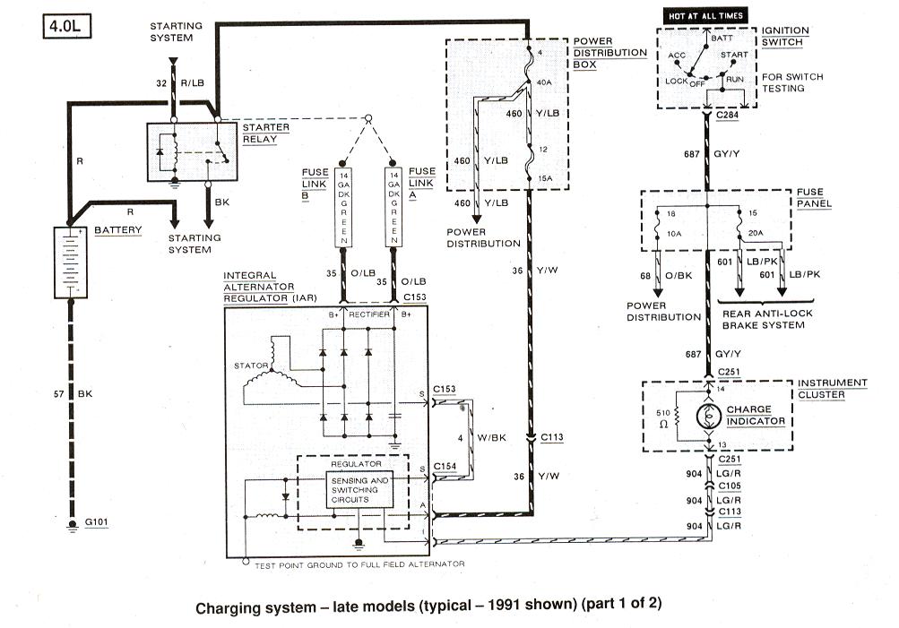

Next was the alternator. I bought a replacement harness, but after further inspection, I only needed the stator connector. Mine cracked ever so slightly and would no longer stay tight on the alternator. When the stator plug is disconnected, the battery light turns on. When the connector is lose, the battery light fades on an off, usually to the rev of the engine and bumps in the road.
Project Little Green Turd
The connector in questions is C153 on the following schematic. The kit I ordered included C153 and C154.
