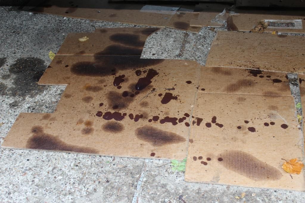

There really isn't a lot of dripping after the oil goes on
