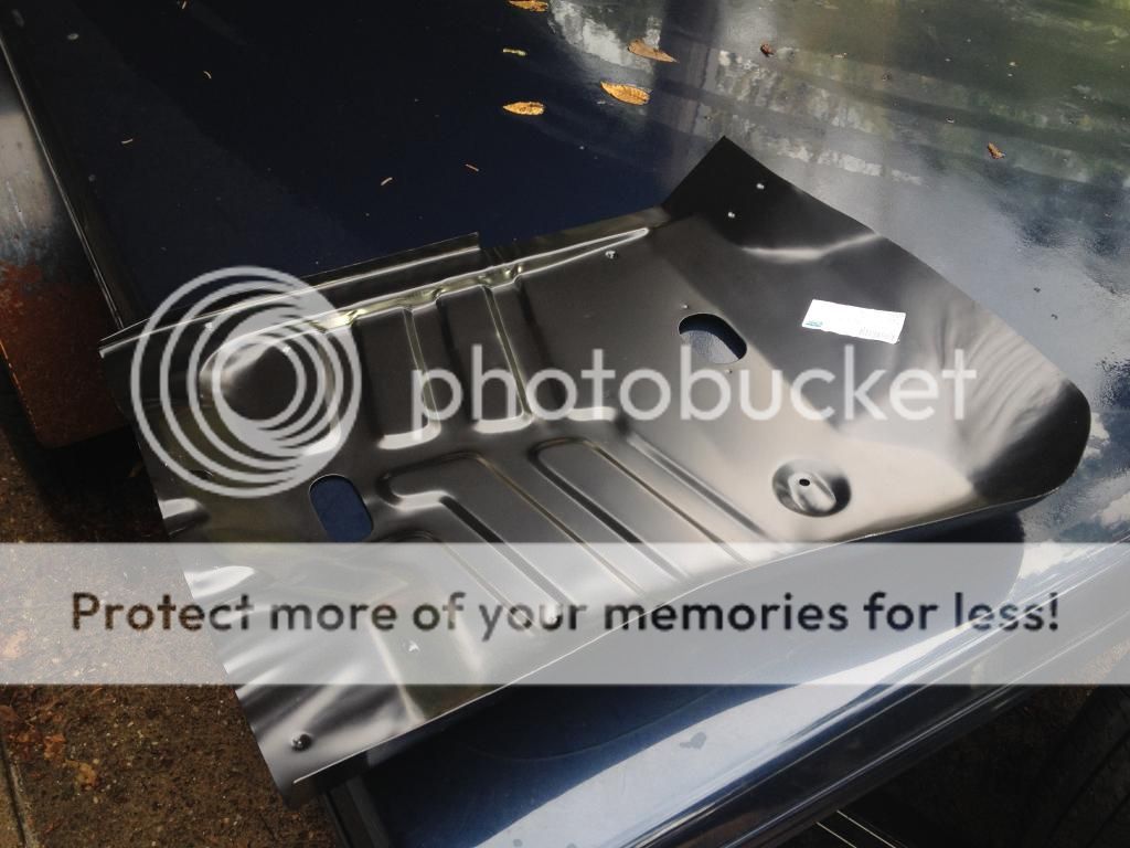

New floor board arrived. Hopefully I can get that in on Sunday with the help of my buddy's dad (no welder yet and I lack the skills)

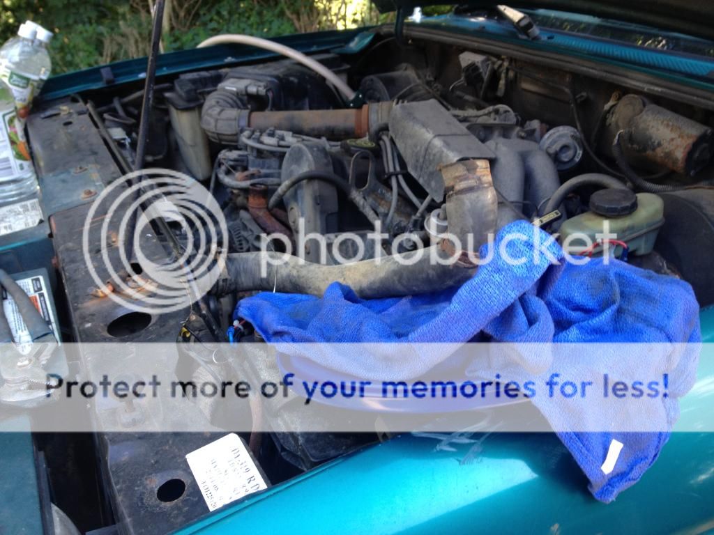

Decided to drain the Peak Super Flush last night and begin disassembling the cooling system. Got some slightly discolored water out and some sediment as well. I am pleased with that product thus far.

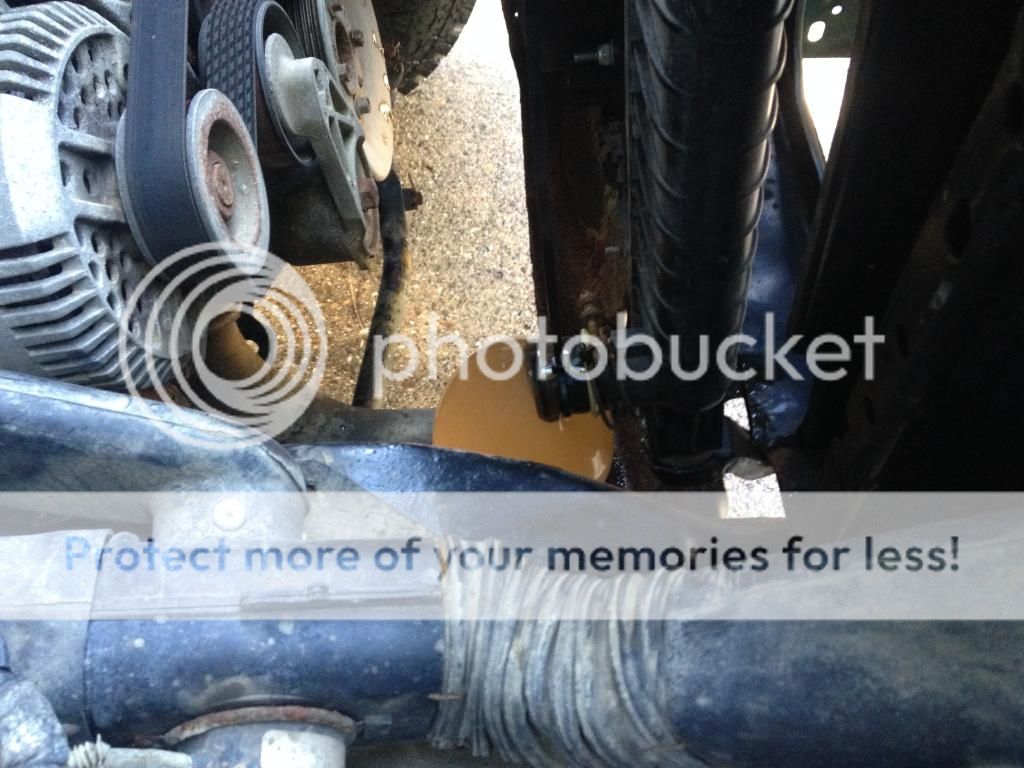

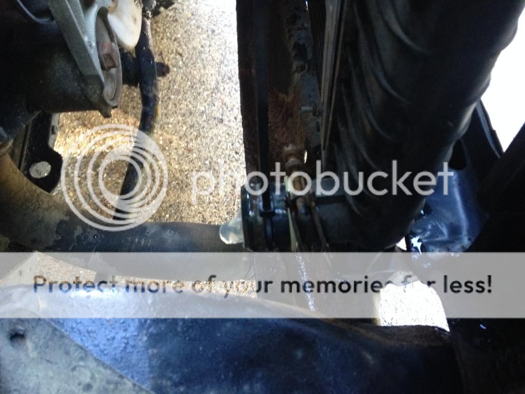

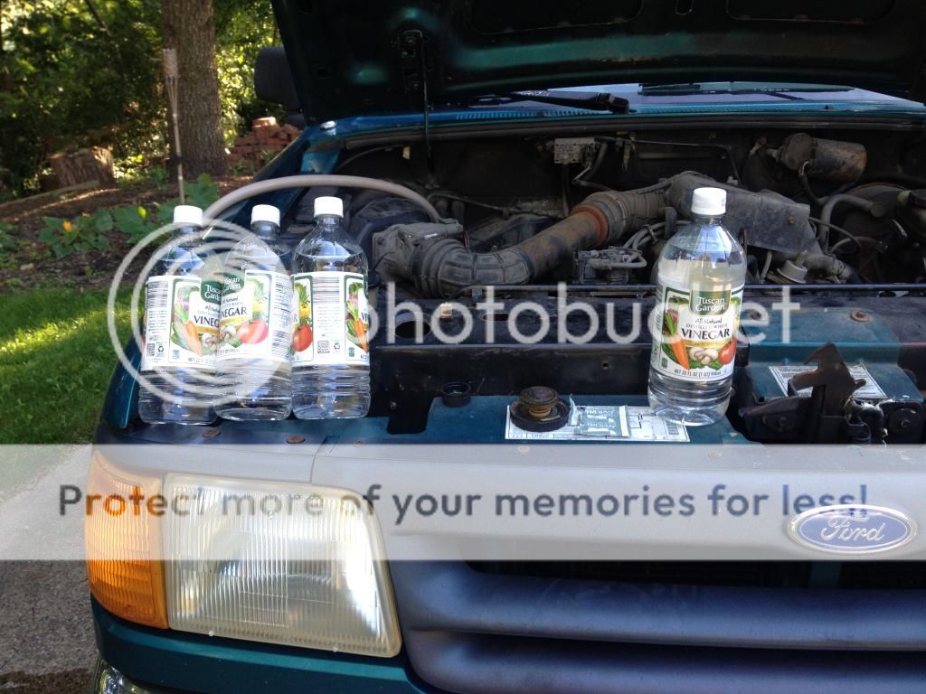

After the system was flushed with the garden hose, I pulled the radiator hoses and plugged the bottom hole so I could fill the radiator with white vinegar. It is a weak acid that helps eat away the iron deposits in the radiator. I am just trying to get it as clean as I can. I let is soak for a few hours and got even more sediment out.
I used a "balloon" to plug the outlet...

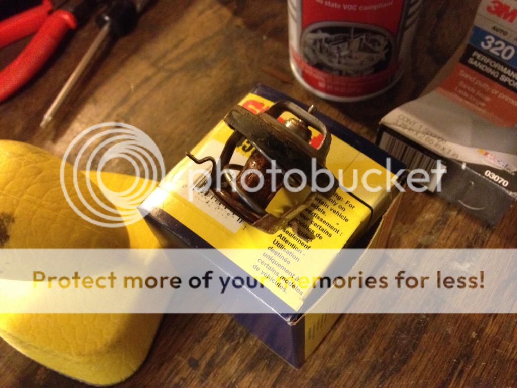

Old thermostat:

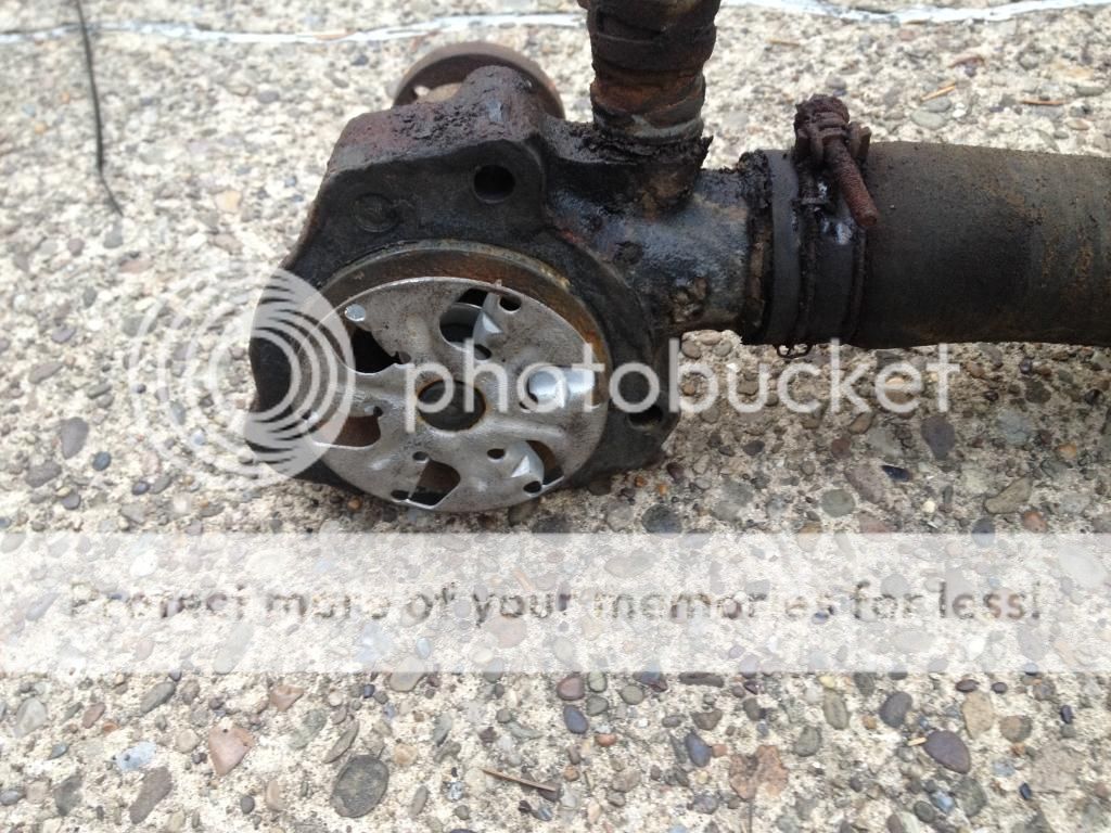

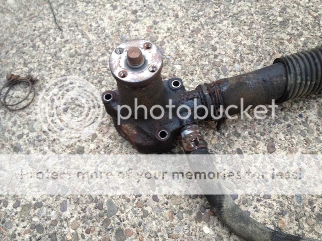

Old water pump:

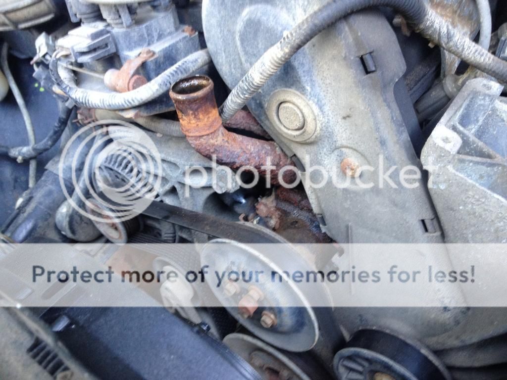

Everything came out rather easily... which scares me. I am replacing the heater hose attached to the water pump. It was really dry rotted near the outlet. I was pleasantly surprised to find the bearings and water pump still in decent shape (205,000 miles on them). I am gonna clean it up and throw it on the shelf for a spare.

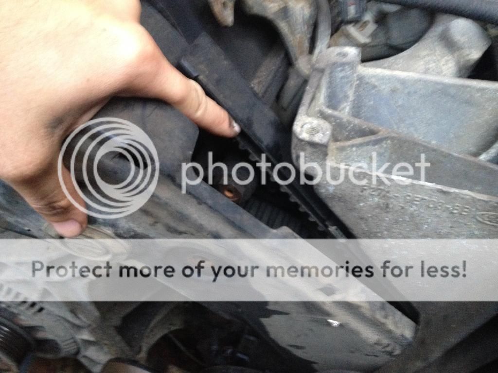

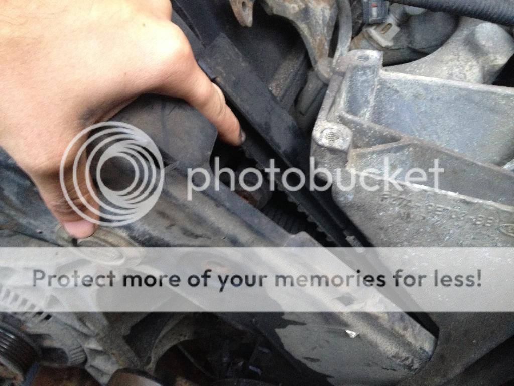

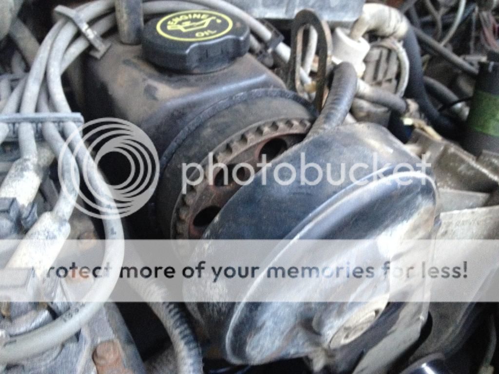

To remove the water pump, the manual recommended pulling the timing belt cover. I am glad I did this. I found the belt is rather cracked after 20 years of use and the tensioner is tensioning anything either. While I have it apart, I am going to replace those as well. I read the procedure in the Tech Library which was very helpful.

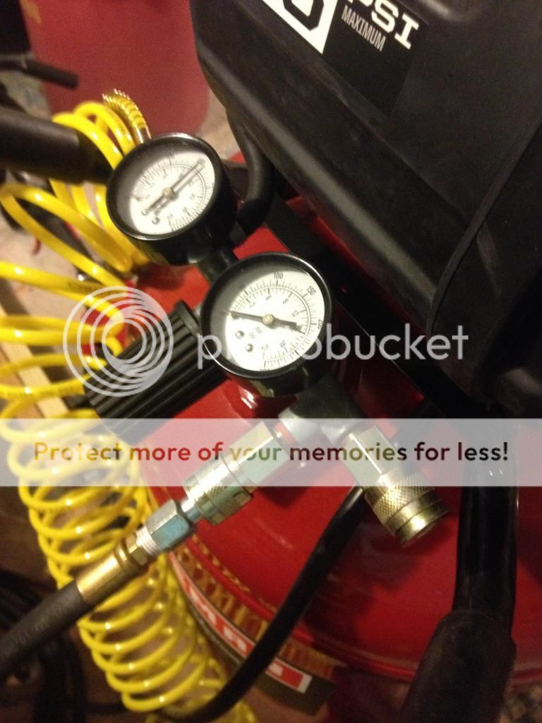

No pressure:
Pressure:

Old water pump:
