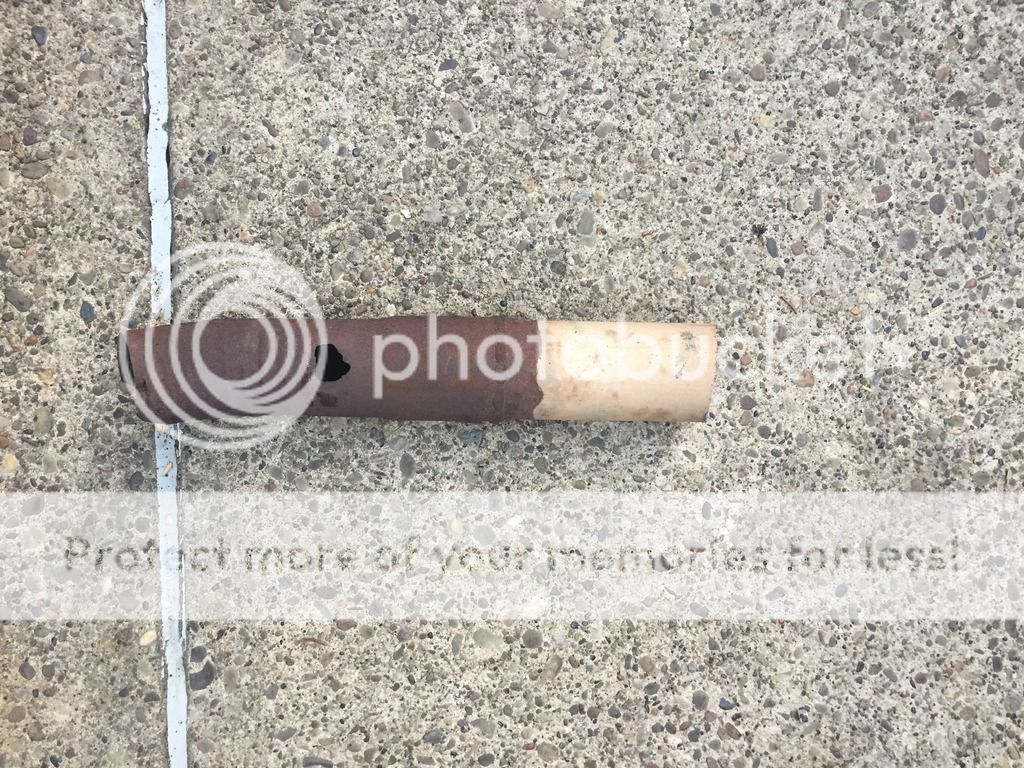

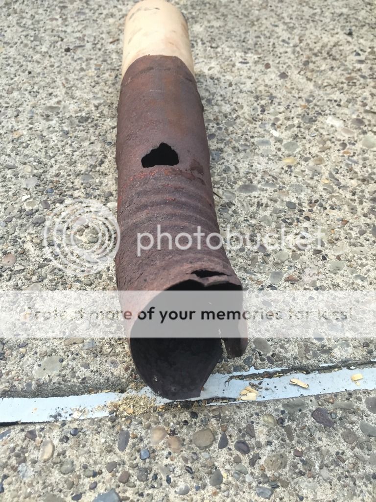

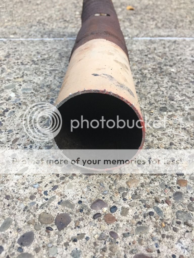

Small update... Throttle cable snapped at the pedal a few weeks back. Some electrical tape and a pair of vise grips got the truck home and I got a new cable from the junkyard. Also had the exhaust rust through at the supporting hangar. I got the exhaust on the Ranger fixed with parts I had on the shelf. I only had to buy the 45 angle piece. Here is what I cut off.

The rusted piece is an aluminized tip from Advance. The straight pipe is Summit Racing aluminized pipe. Apparently they are not created equal....

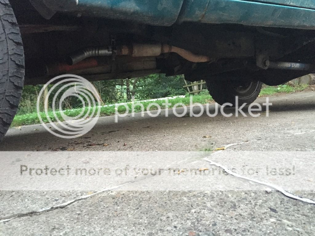

Installed a new Summit universal hangar on the bed support.
Project Little Green Turd
It is now very secure and tucked up nicely.

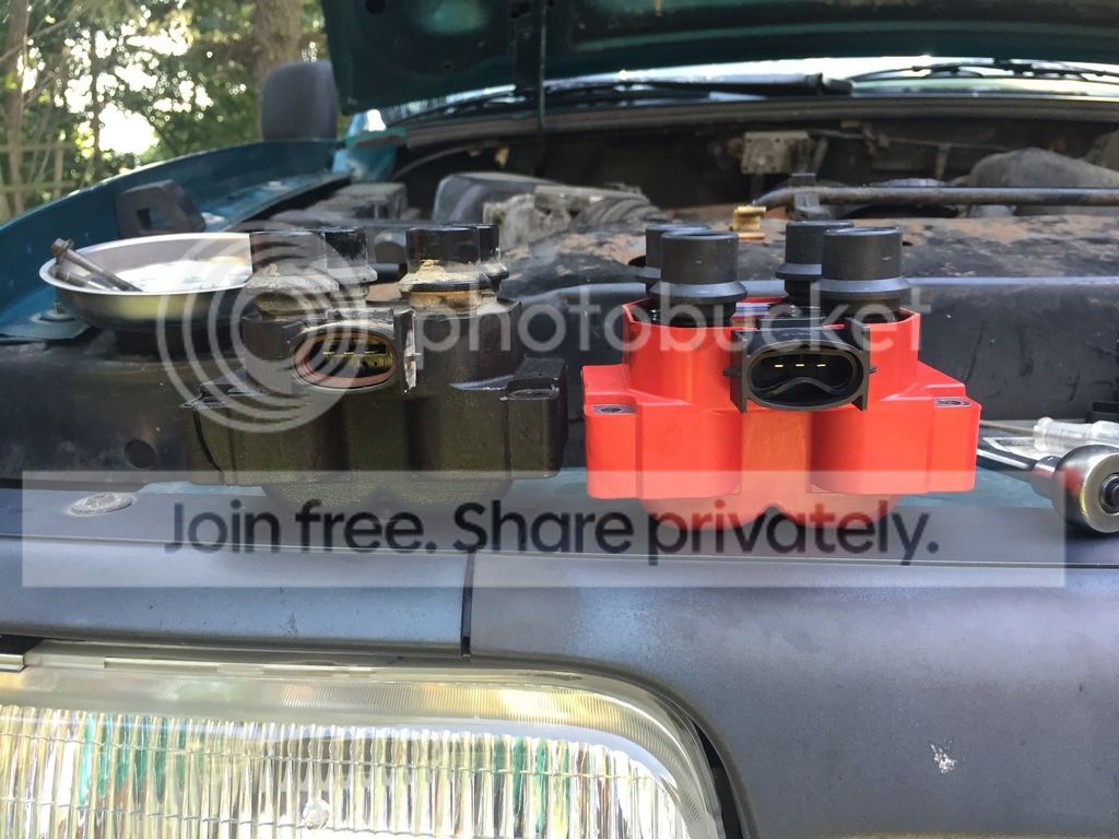

So I have been tinkering a bit with the Ranger. I DD it back and forth to work for a total of 60 miles per day. Since it is highway driving, I have turned my attention to extraction a bit more power so my foot is not always on the floor. After doing some reading, it seems that uppin injector size from 14lb/hr to 17lb/hr is the ticket. So after it passes inspection in September, I will swap in some new injectors. Since I am adding more fuel, I figured it is a good time to replace/upgrade the original ignition module (223k miles on it) for the exhaust side spark plugs (the 4 that cause combustion). I went with MSD-8241 which is listed for 95-04 Mustang Cobra. Got it down to $55 from Advance which seem pretty reasonable. I initially noticed the engine runs better at top end.

Only problem was one of the mounting screws snapped off regardless of my best efforts to remove it safely. Oh well.

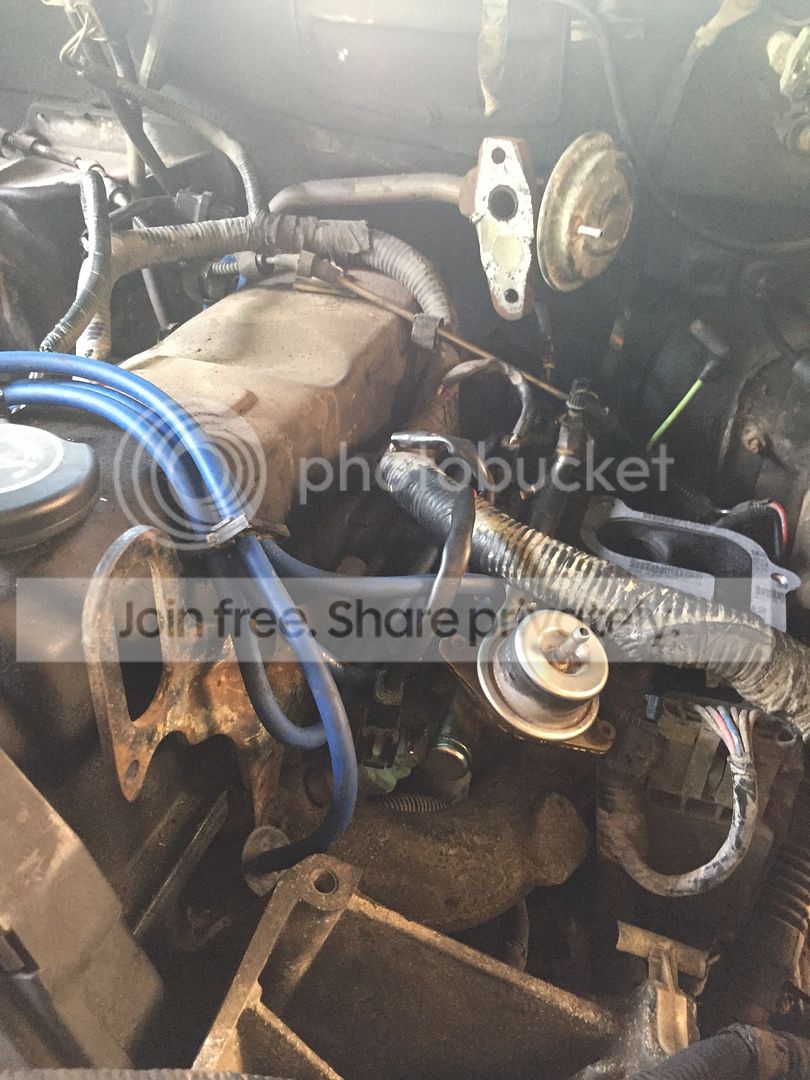

I got the injectors, spark plugs, and wires installed this weekend. First response is a noticable increase in power. I have a vacuum leak that I still need to find, but after that, I should be good.

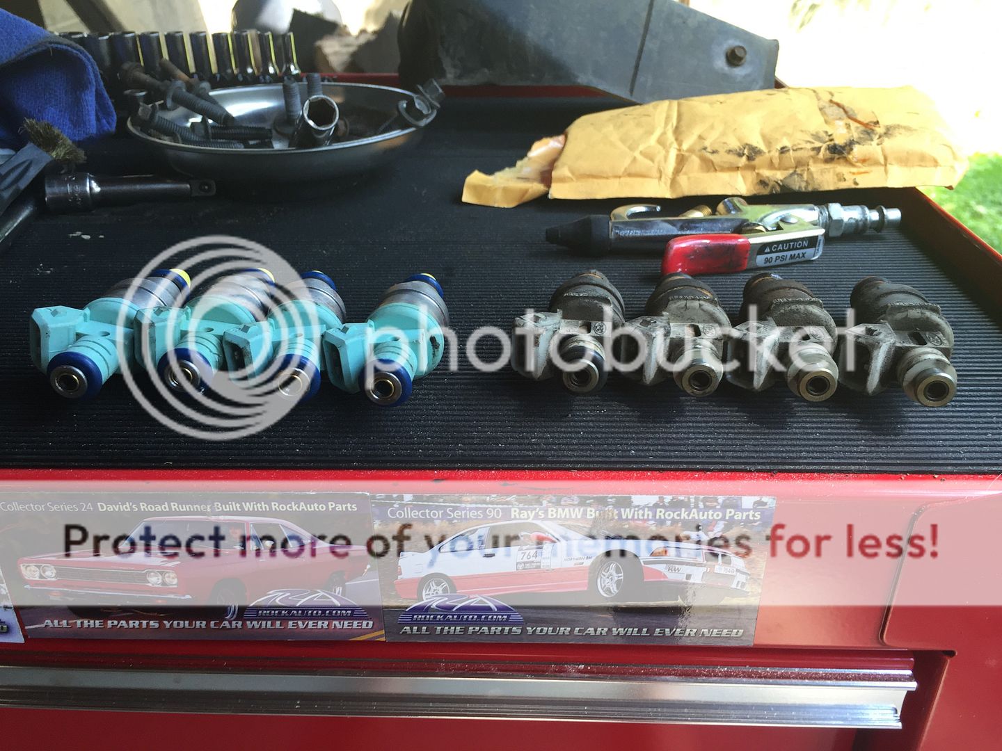

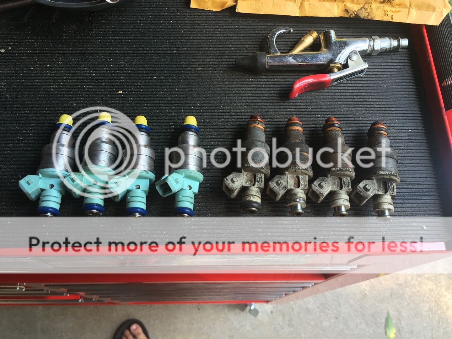

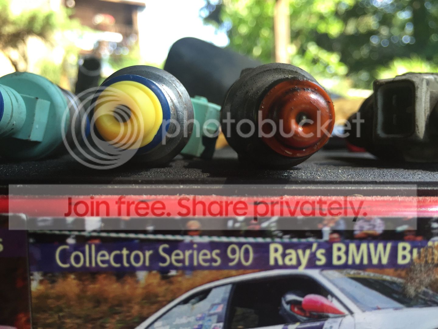

New rebuilt 17 lb/hr injectors vs the stock ones

The old ones were a single nozzle. The new ones have 4 tiny nozzles.

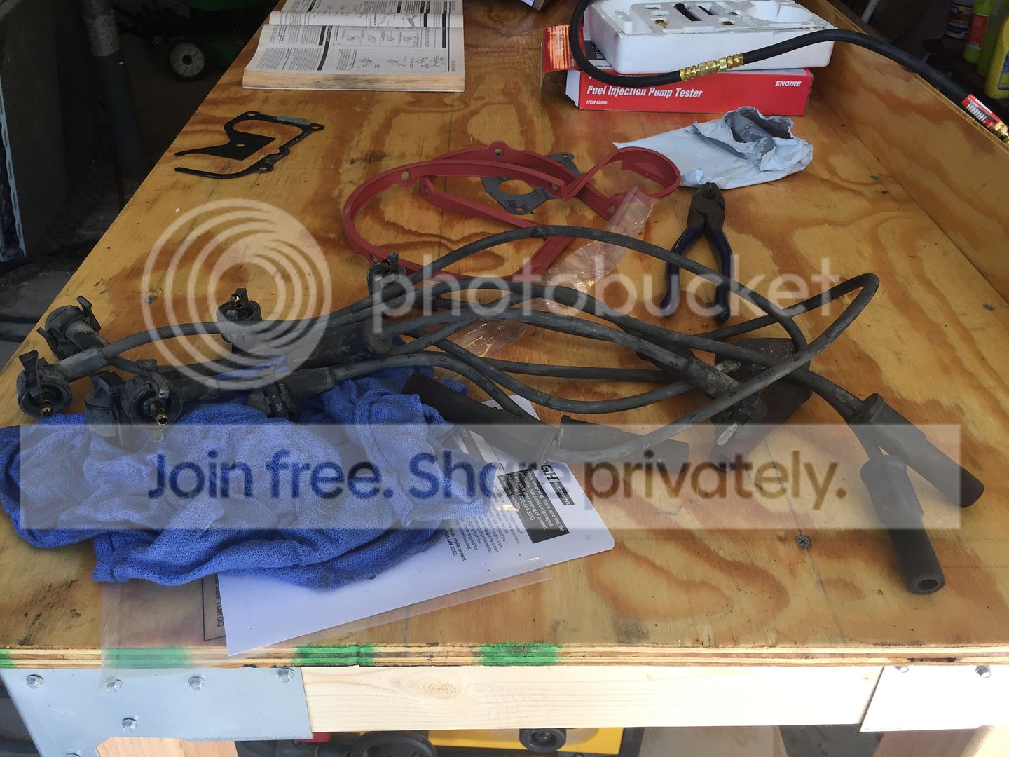

New wires

Factory wires with 223k on them.

Replaced the hoses and connectors I thought were the problem and no change. The next suspect is the EGR gasket. I didn't replace it and now that I think of it, it was in bad shape. That will be tomorrow's attempt.

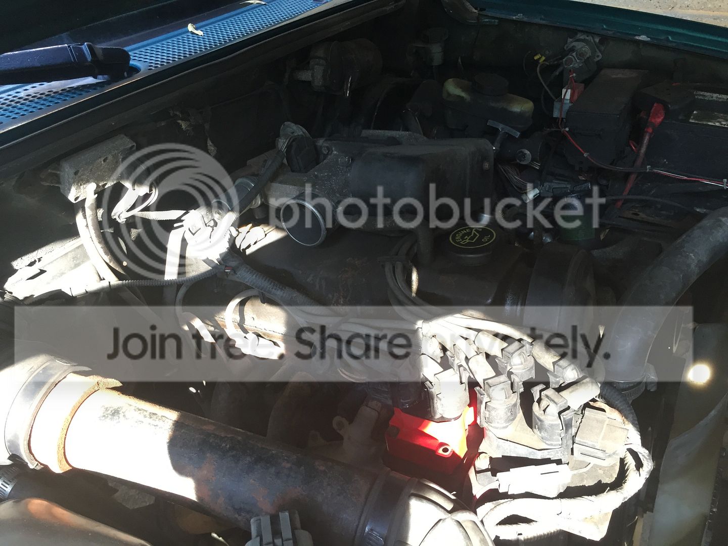

So far, new EGR gasket, new throttle body gasket, new EGR solenoid, and new EGR valve. Just a little more work to solve the issue I hope.... Runs and drives great and idles great for 45 seconds or so, then it poops its pampers. See video below. VAC gauge is bottom left and tack in upper right.

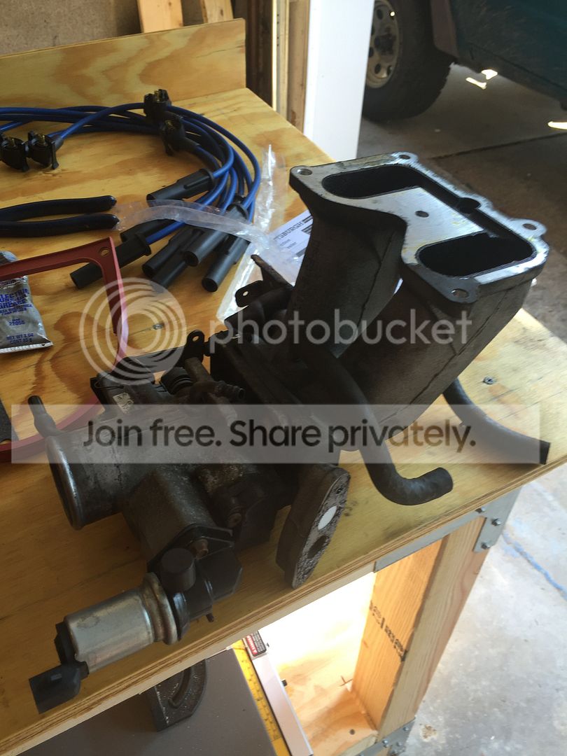

Ok. So the problem is resolved. The issue was an old piece of upper intake manifold gasket that I missed. Replaced all upper gaskets and we are good to go.

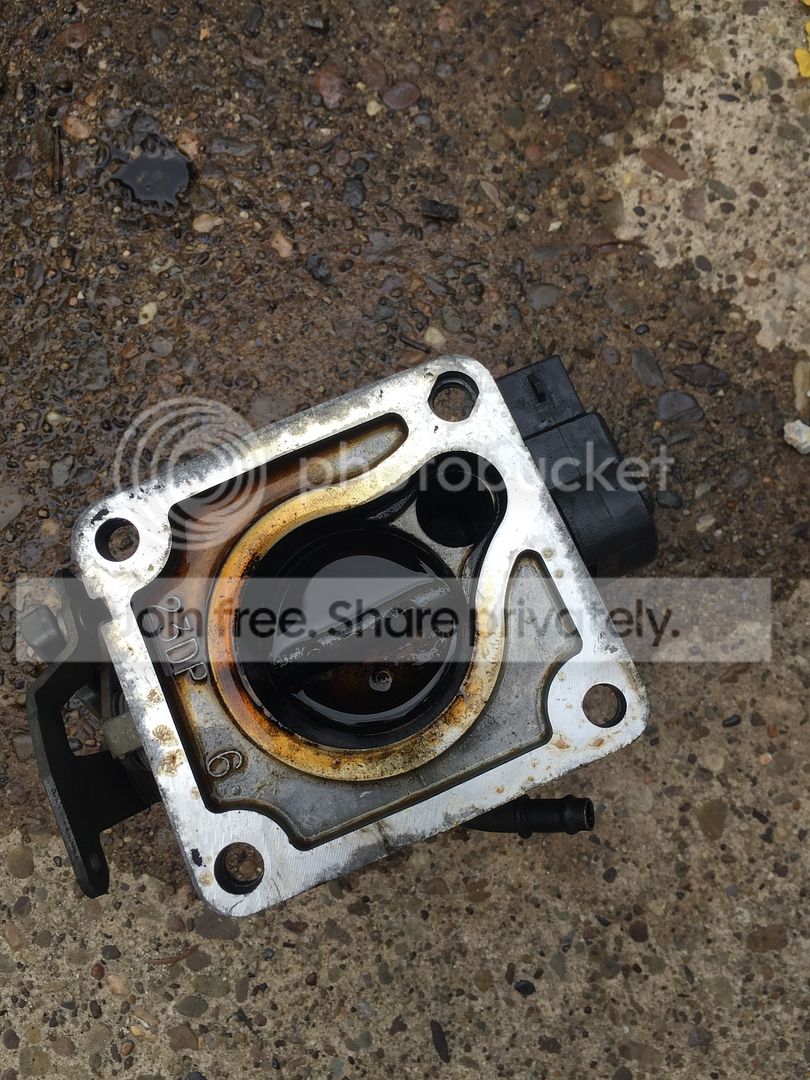

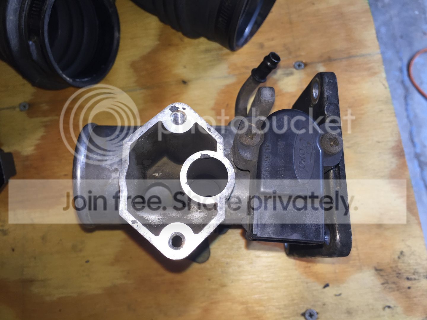

Cleaned the throttle body.

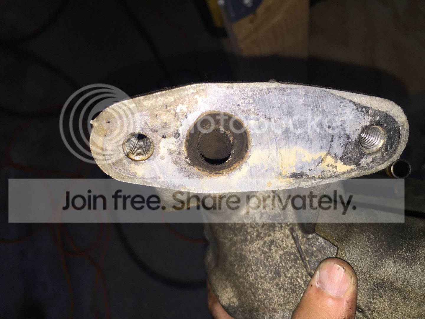

Cleaned the upper manifold as well. The EGR channel was almost completely plugged.
