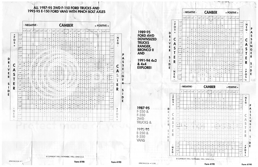

Moog K8986 and K80109 Alignment Instructions
Here are the instructions for the alignment bushings if anyone should ever need them. One of boxes didn't have any instructions and I couldn't find them online. The instructions are applicable to both bushings.
Project Little Green Turd
K8986 Alignment Table
K80109 Alignment Tables
