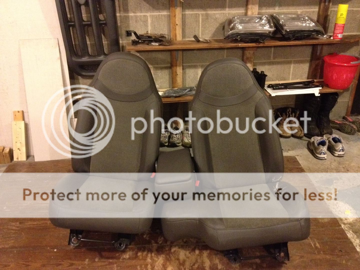

I brought home some new seats I got off of 1bad. 60-40 seat out of an 03 edge. Its in pretty nice shape. I am going to clean it up this week and install it next Sunday. I am going to try and finish everything up next weekend, but I have a bachelor party Saturday night... :icon_rofl:
I'll put up a few pics of the seat later.
I just finished cleaning the seat. It's not perfect, but way better. Are these are way more comfortable than the broken bench seat. I think the bench is doing to be the new garage seat.
