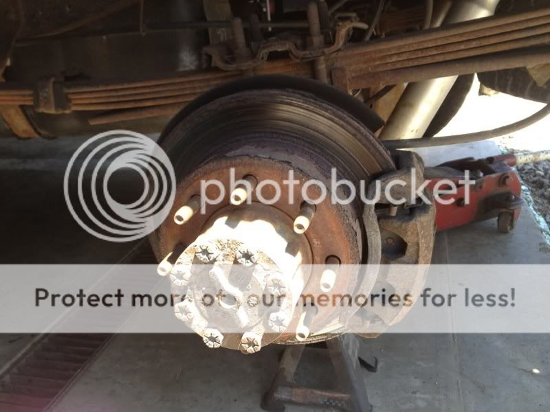

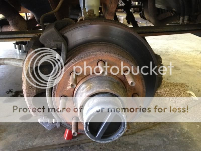

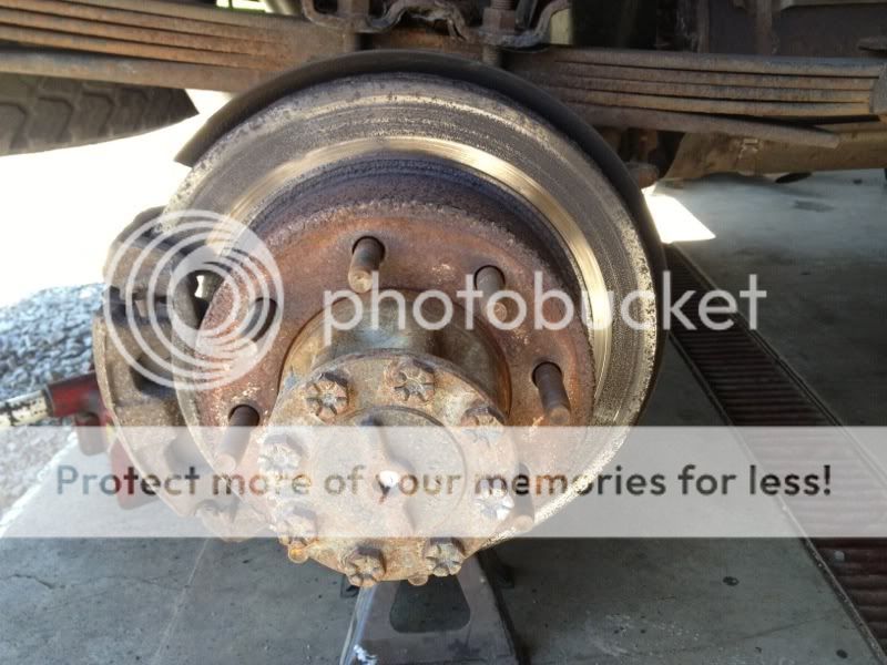

F250 went to the garage while I was at work today. Rear brake line rotted through. I wanted to fix it, but it was no safe to drive. $400 to repair at the local shop. They wanted put new rear brakes on it too. That was going to be another $350. I old them I want the absolute bare minimum done. I need it safe to drive to my house and that's it. It absolutely kills me to give my hard earned money to the local shmucks to fix my shit. I always get rammed in the tail pipe when someone I don't know works on stuff.
No offense to all the good mechanics out there, I just can't ever seem to find them when I need them.

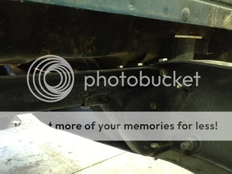

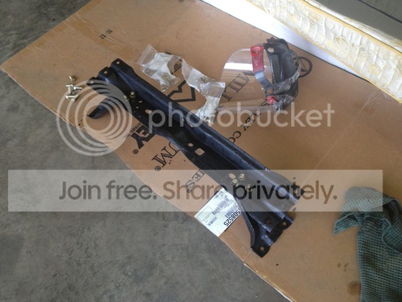

I got a good frame cross member from 1badexplorer this morning. I painted it and installed it this afternoon. For once, something went in easily :icon_rofl:

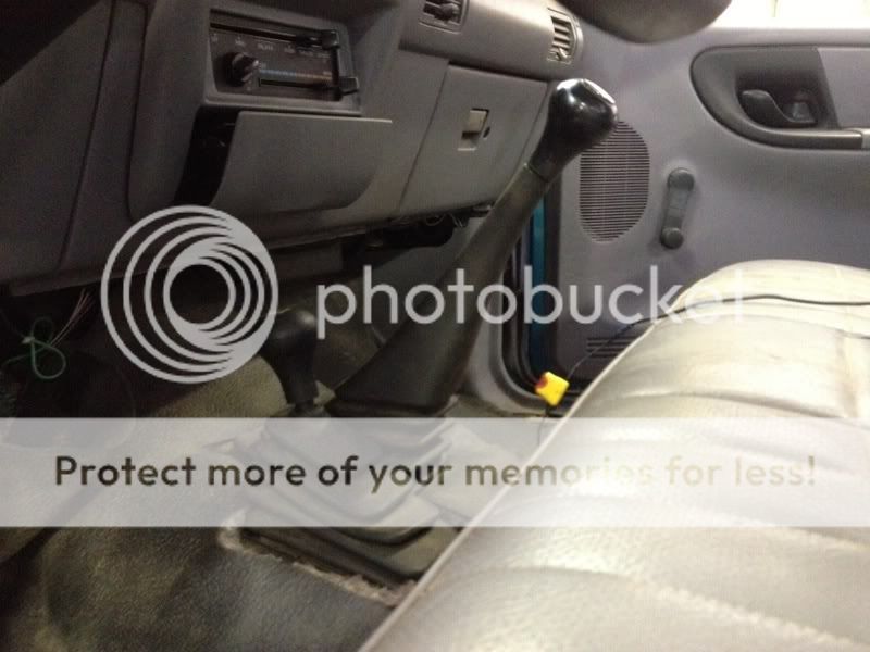

I also got the transfer case shifter installed and adjusted and the cab back on and installed with the James Duff Hardware kit. I loaded up a bunch of extra parts I had in Joe's garage and brought them to the new one in the house. I won't have my Ranger done for the ride in Ohio on June 1st, but I may come out and ride with 1badexplorer or I'll bring my quad and ride that if the park allows it :icon_cheers:

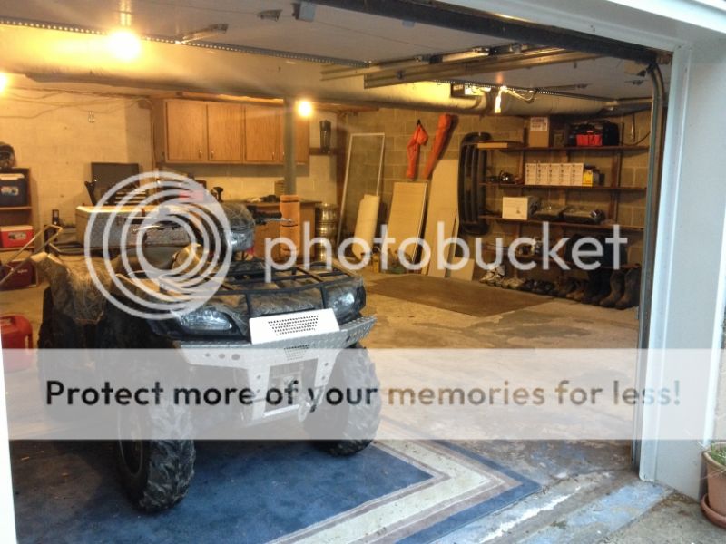

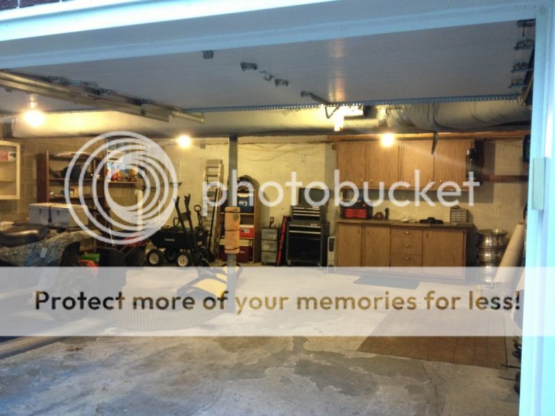

Finally got the my man cave unpacked at the new house. I still have room which means I don't have enough crap :icon_rofl: The quad looks right at home too!

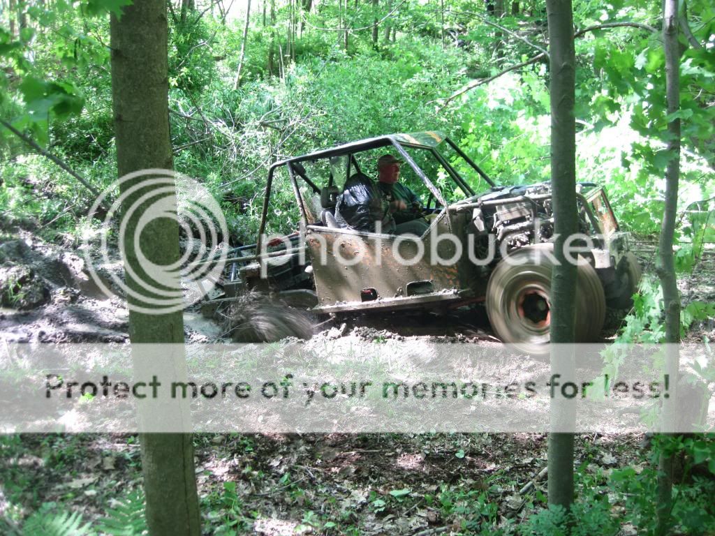

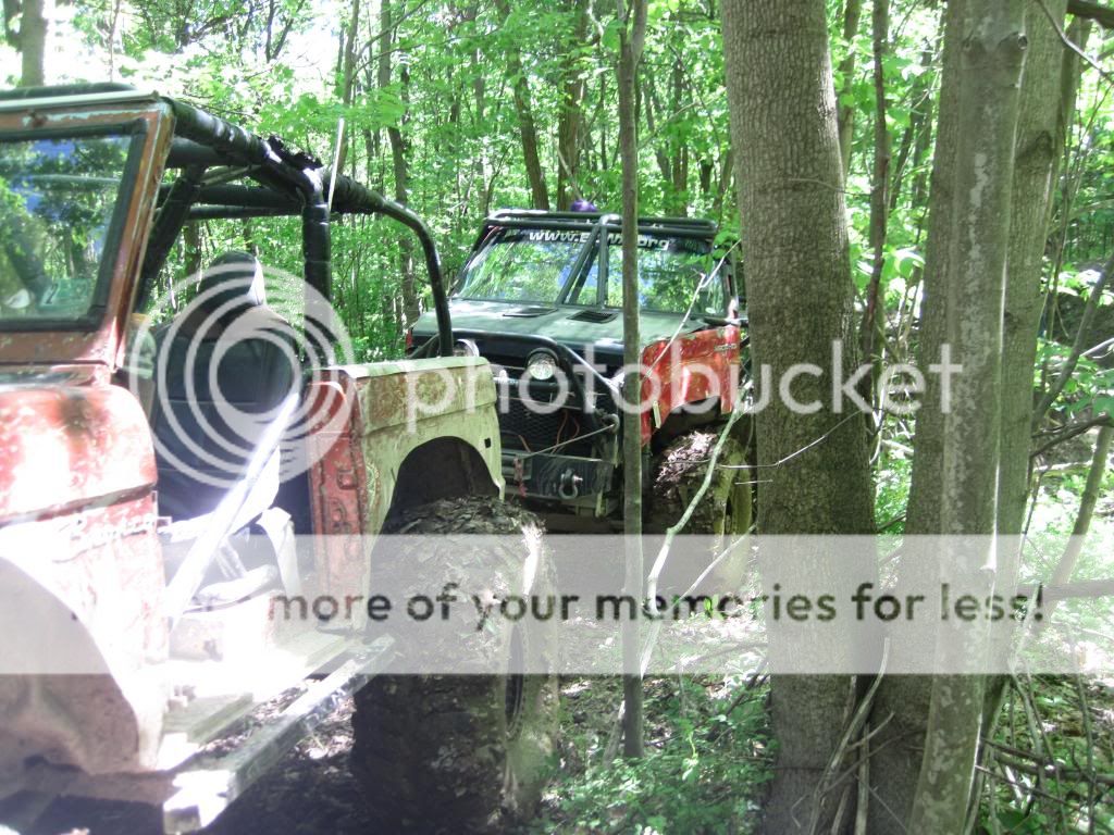

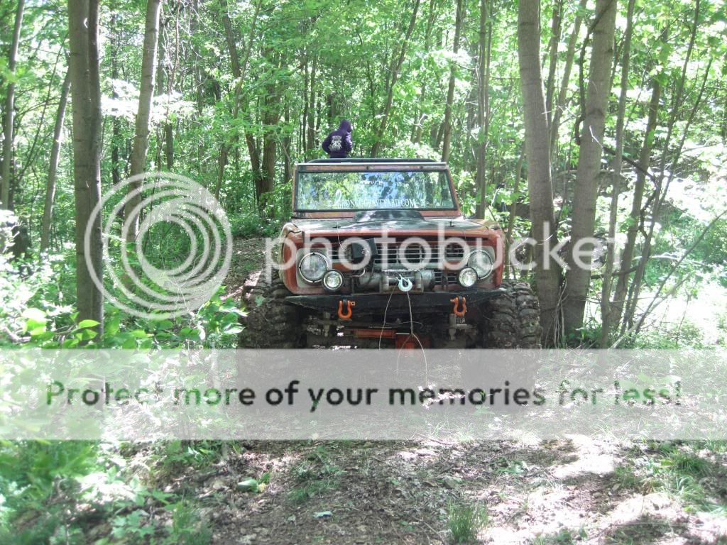

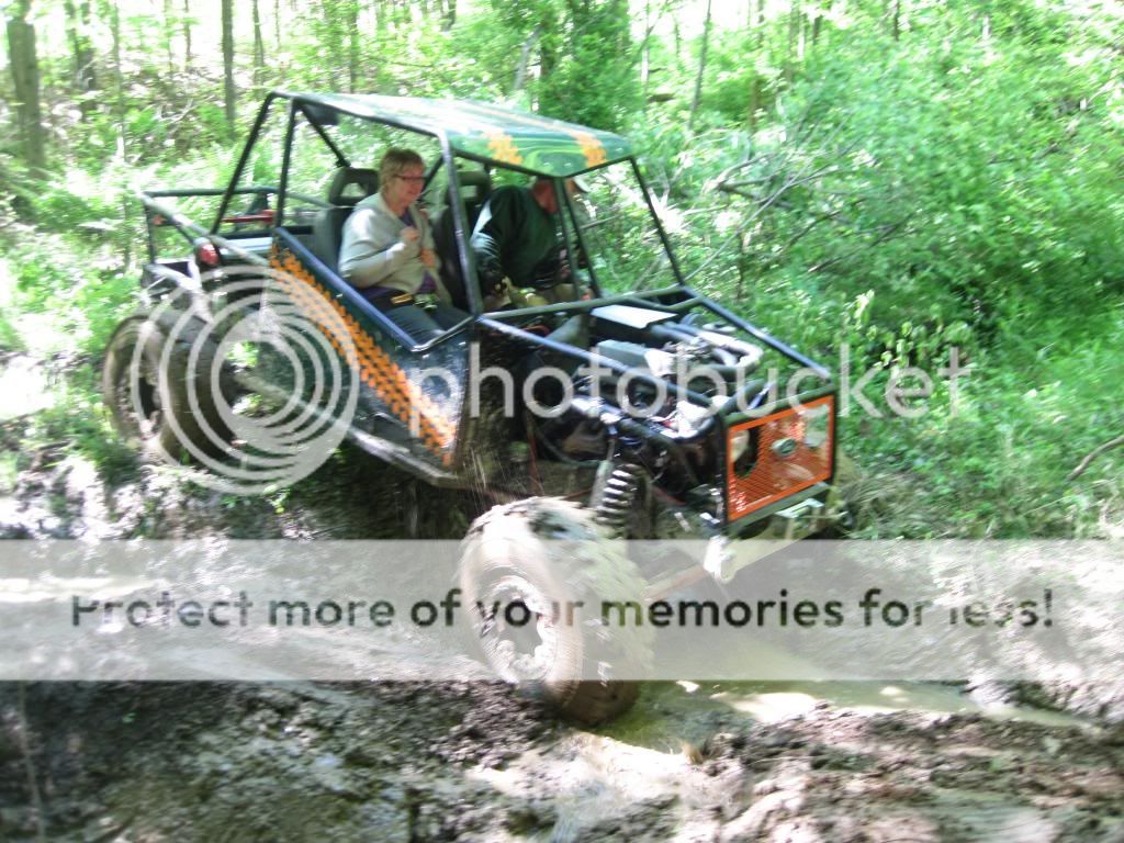

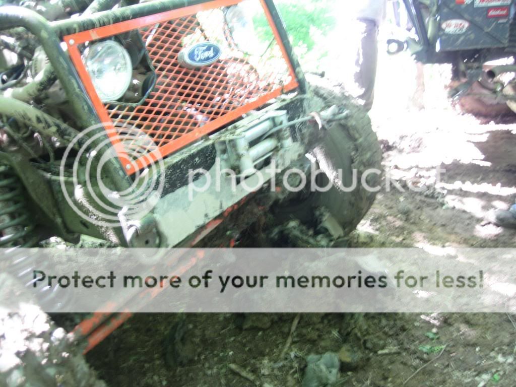

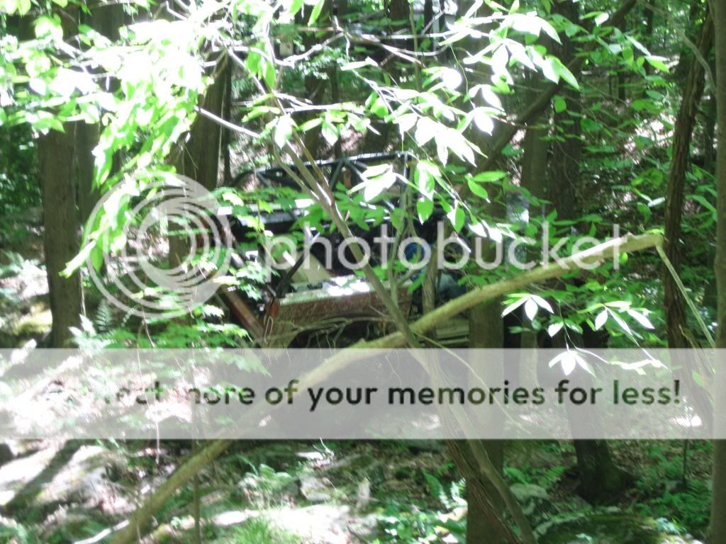

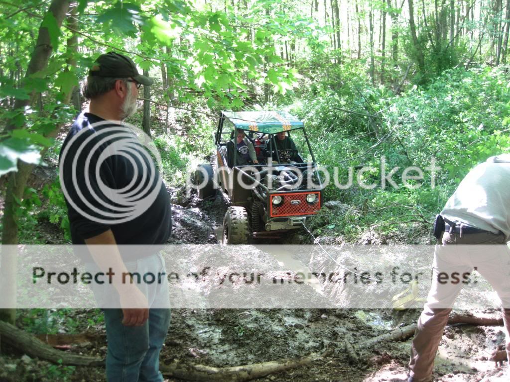

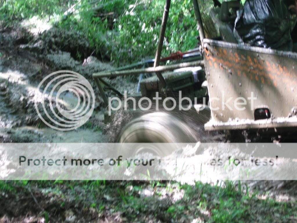

Here are some pictures from last weekend when I took the quad out with 1badexplorer. Most of the picture are of a 1990 Bronco Truggy on 38's that got pretty stuck...

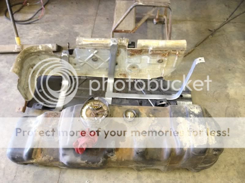

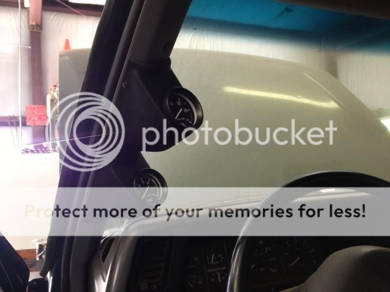

I got some more done today. Front drive shaft is back in, shifters are installed with the floor plate in the cab, gauge pod is installed and oil pressure gauge is connected (Vac and wiring will wait for now, radius arm bolts are torqued, and the gas tank is ready to go back in once I get more bolts.

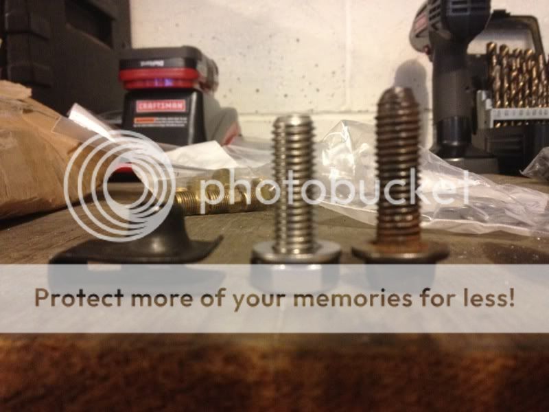

Just ordered bolts and extruded U nuts for the gas tank. I got stainless M10x1.5 bolts and matching plated extruded u-nuts. As far as I can tell, they match the stock size. Ordered a few other oddball items I need for other projects around the house too.

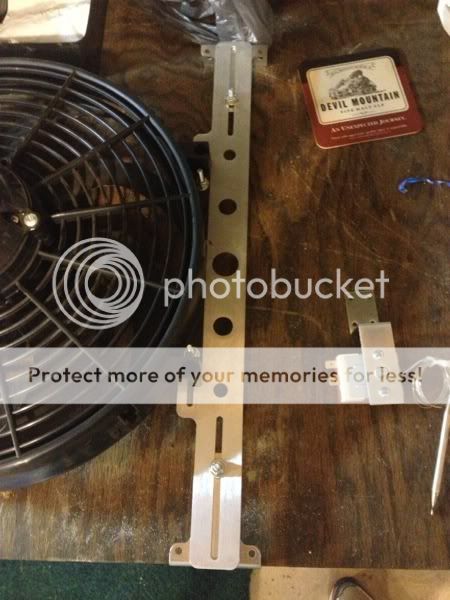

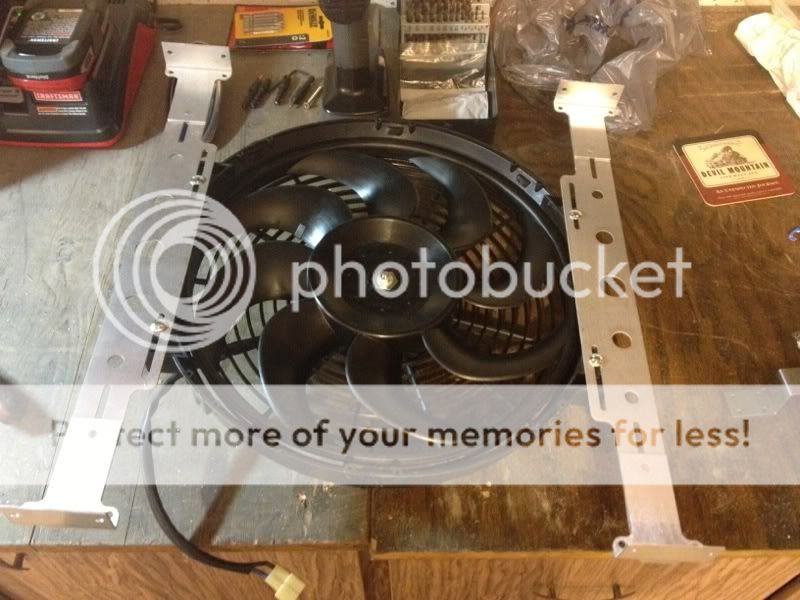

LMC Truck Fan Kit for Ranger

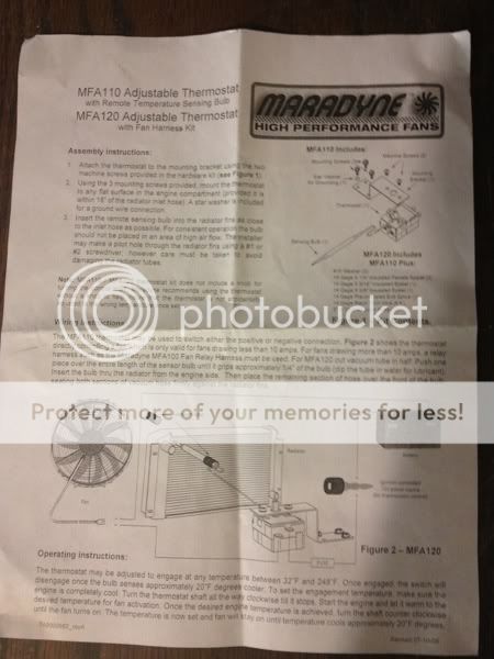

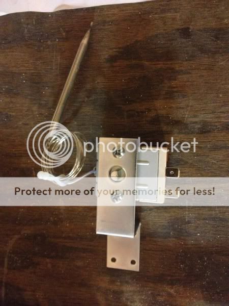

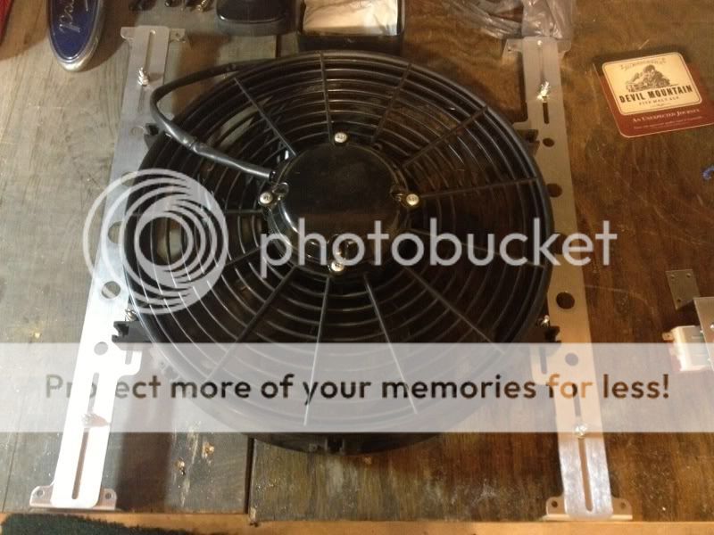

I got my fan assembled tonight. It was just sitting in the garage looking at me so I decided to put it together and see if there was anything complicated about it.
There isn't (Not really surprising).
Anyway, I figured I'd throw up a few pictures if people need ideas for fan brackets and thermostats. I have included the instructions as well.
I am going to get a small water resistant enclosure to put the thermostat in when I install it. I have also decided that I am going to put a bypass switch around the relay so the fan can run all the time if need be (in case the thermostat shits the bed), a kill switch for the fan power, and a bypass for power directly to the battery. I'll probably mount all these switches in the enclosure because they will only be needed in emergencies. The thermostat is adjustable between 32-248 Deg. F so hopefully the extra switches will never need used, but I'd rather take the time to do them now then run into problems later. I will also put a 10 amp fuse in the circuit because that is what the thermostat is rated to handle. I will detail the install and probably draw up a little schematic once the truck is back on the road.

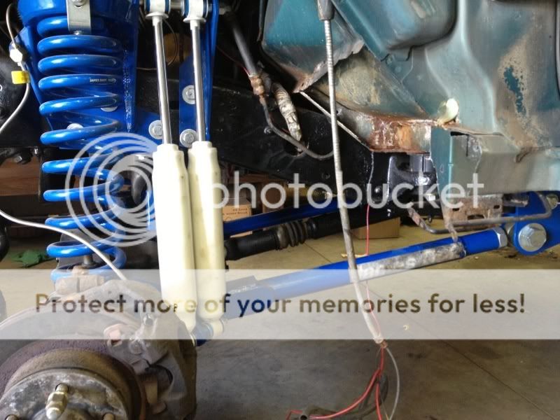

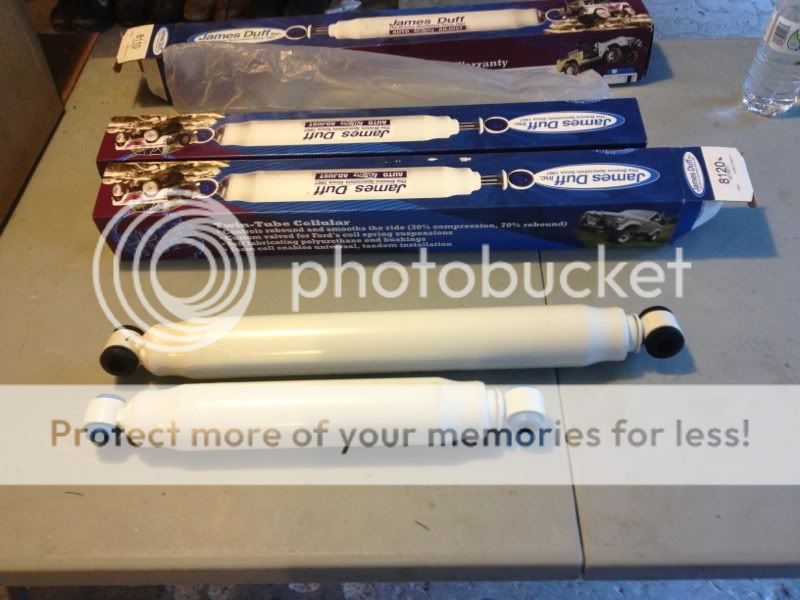

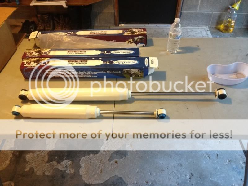

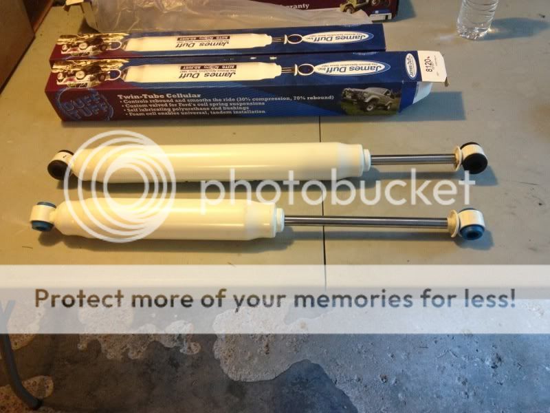

The rest of my parts were waiting on my desk at work today. I got my bed bolt kit, my shocks, and my bolts for the fuel tank.
The shorter shock is a James Duff 8110, which is what came with my 3" lift.
The longer shock is a James Duff 8120, which is really long and will more than suit my needs :D
Collapsed:
Approximate ride length:
Extended:
From my measurements, fully extended I needed 33.5" and these shocks are 35.5" fully extended. The springs are pretty stiff, so I think I will be alright under compression, but we will see... :icon_rofl: It won't be the first thing I screwed up and it won't be the last.

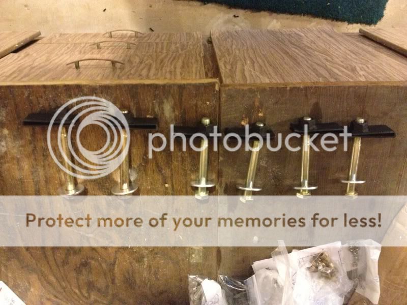

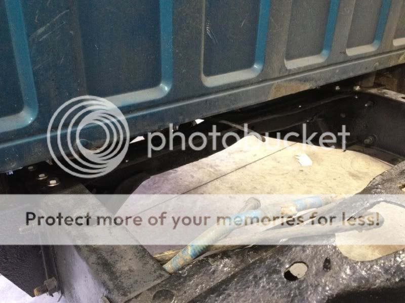

Bed Bolt Kit from RangerFrameFix.com. Its nice quality and at $60, way cheaper than buying the parts from Ford or LMC Truck.
The fuel tank bolts are M10 x 1.50 x 30mm 18-8 stainless (with matching washers) and I think I actually ordered 5mm too short. But they should serve the purpose and at $0.51 each I can't complain. Replacement flange bolts in stainless were almost $3.00 each and they were made by ARP which was way overkill for holding the tank in. The extruded U-nuts are regular carbon steel.
I should be using all this stuff on Saturday and with any luck the bed will be back on an I can turn the engine over again! :yahoo:
