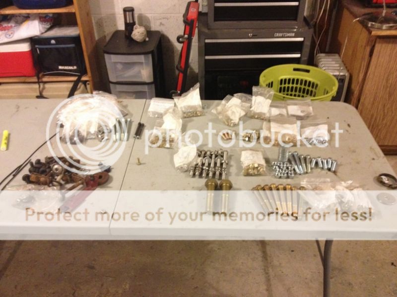

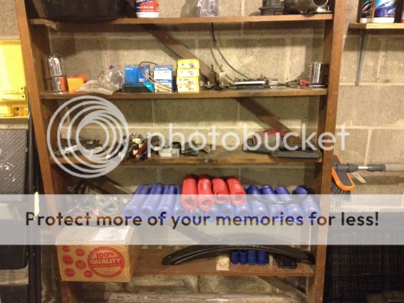

I went through my spare parts last night. I had a lot of little shit leftover.
Project Little Green Turd
I'll probably put some parts up for sale in the near future. I have a lot of extra shit I won't need.

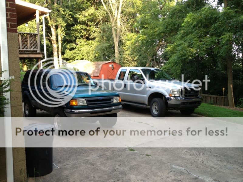

Here is a photo of the pair:
