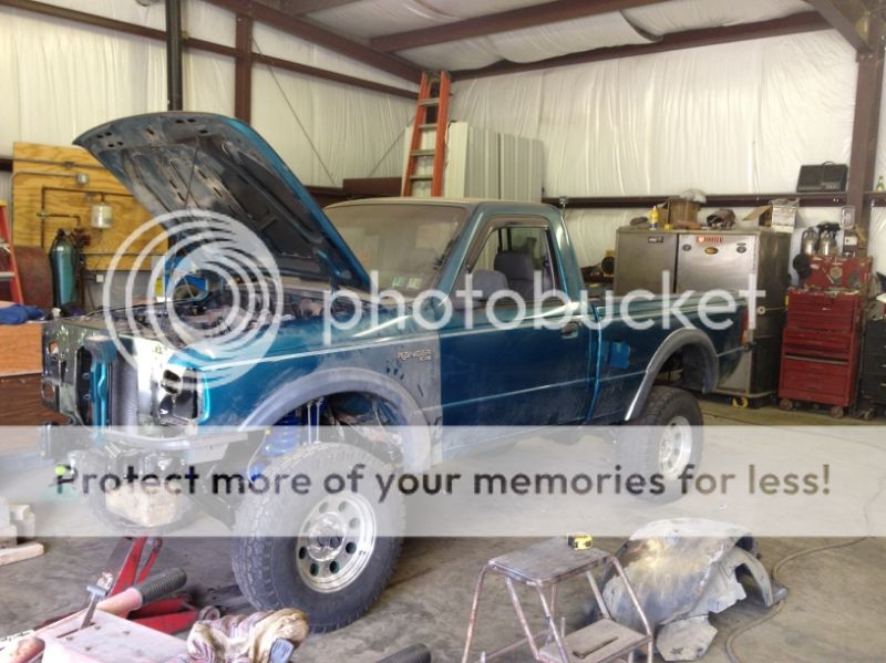

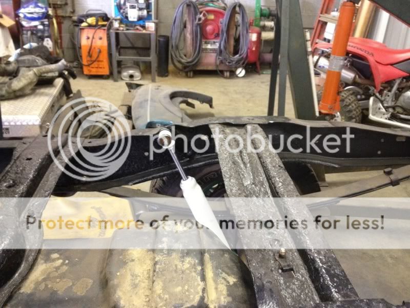

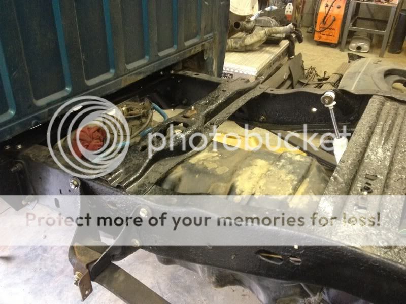

I went home to work on the Ranger yesterday. Got the clutch and brakes bled, fuel tank in, rear driveshaft in, and air cleaner back on. I have a very dead battery, charger couldn't revive it. With the help of the starting feature, we got the old girl running last night. I have a small oil leak where oil pressure gauge attaches to the block and still have a power steering leak, but everything looks really good besides that.
Pictures and a short video to follow tonight.

Shocks and Gas Tank:
Project Little Green Turd

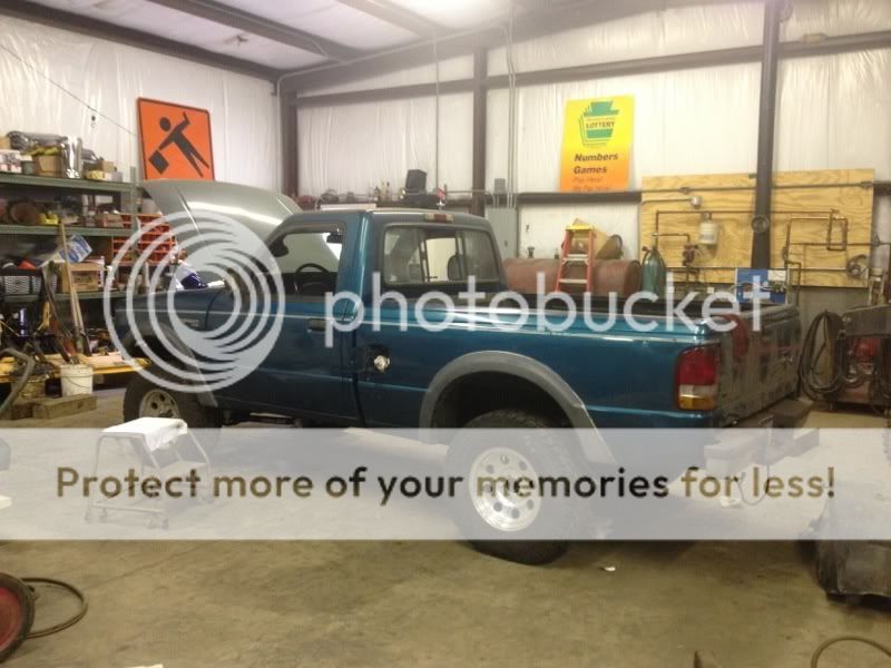

Ready to start:

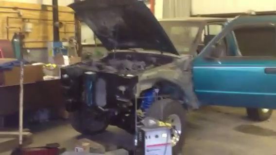

Video:

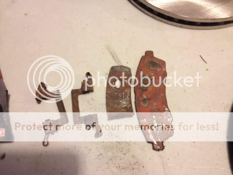

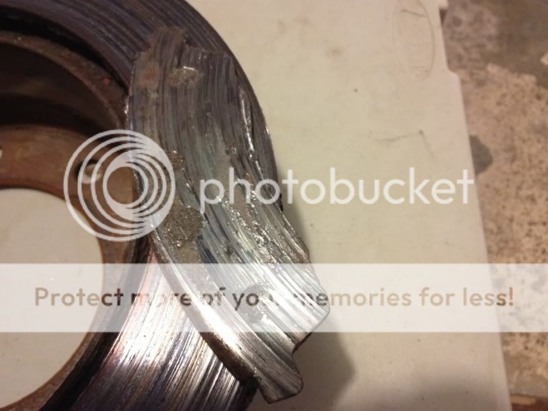

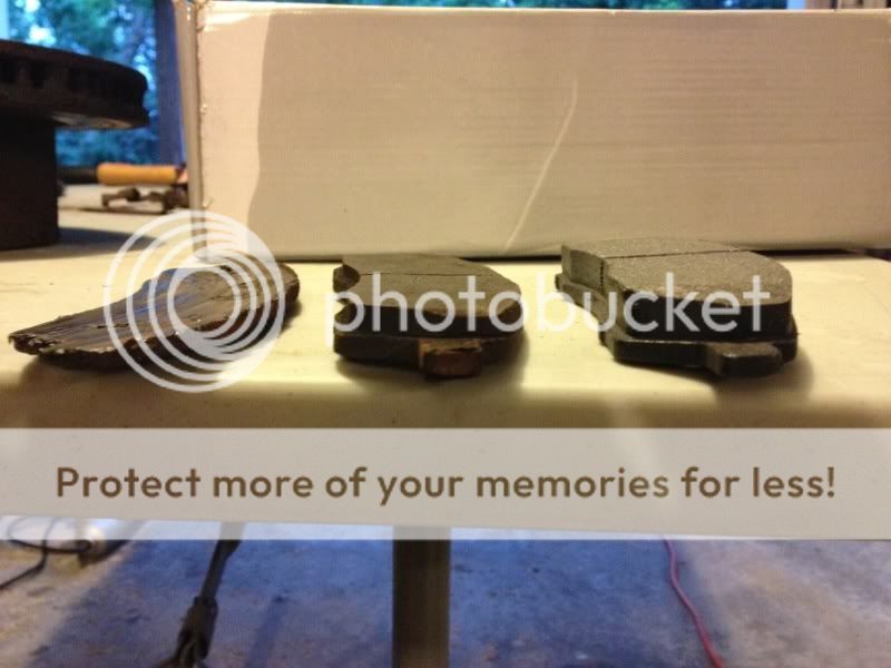

Super Duty was making some weird brake noises recently and they kept getting weirder. I found this:

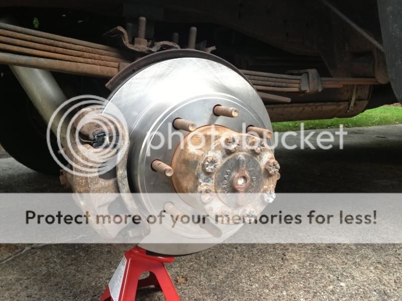

And now it looks like this:
Gotta do the drives side rear tomorrow if the weather holds out. I ran out of time tonight.

What kind of undercoating did you put on there?
I'm getting some sandblasting done and spraying rust converter on, and i'm considering putting tractor supplies farm equipment paint, a couple people said it works really well.
I used Chassis Saver from Magnet Paints. It is some sticky shit, had it on my finger nails till it grew off. I wired wheeled and then blew the sections off with air. Chassis save sticks best to rust and rough surfaces. I'm happy with it so far, but it hasn't been in the elements yet.
I imagine Tractor Supply would make some good stuff. Never tried it personally though.

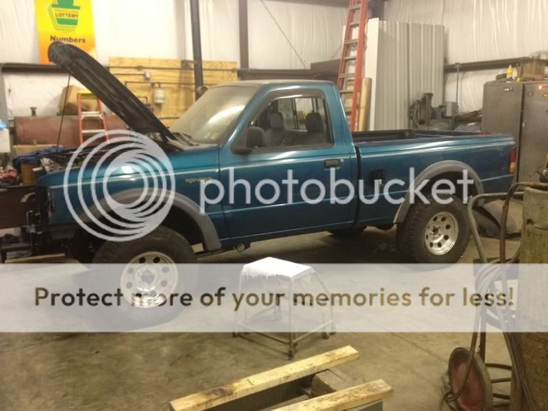

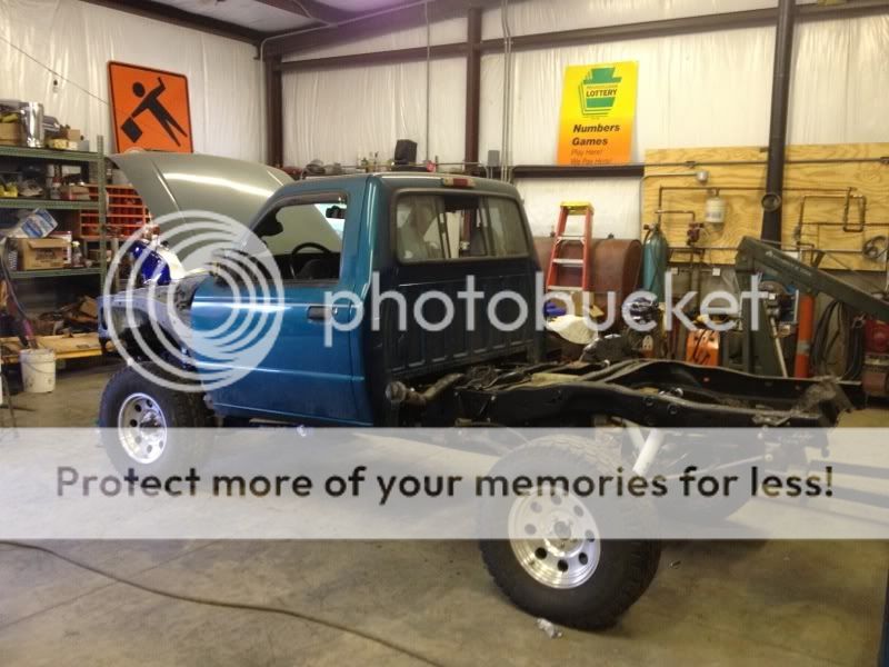

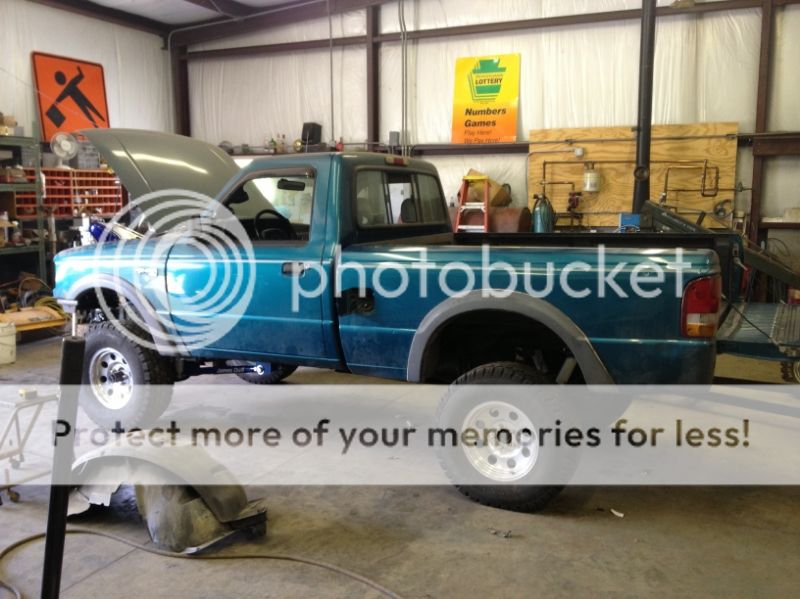

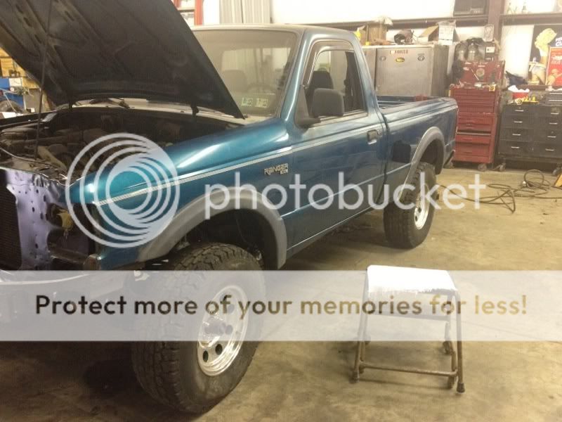

So after setting the bed and fenders back, I took a look to see how much rake I have. Way more than I want.... The rear add-a-leaf made the spring pack so stiff, the bed didn't drop the rear at all. It has almost no give. So next time back, I will be pulling the rear axle back off to remove the add-a-leaf and see if that corrects my problem.
Here is a shot to give an idea of the rake:
I used a jack to raise the front end up to make the truck sit level. I realize I could put longer coils in and also solve the problem and get more lift, but I don't want to keep dumping money into it :icon_rofl:

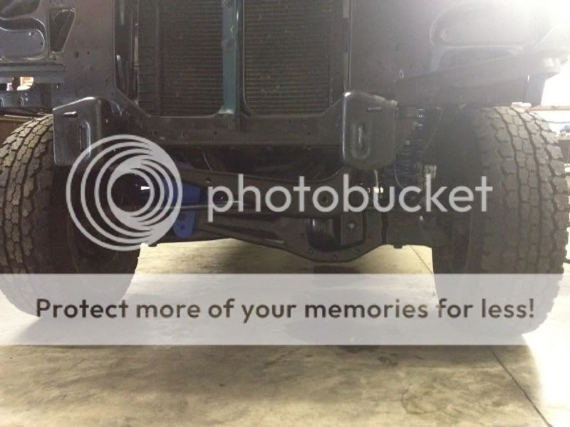

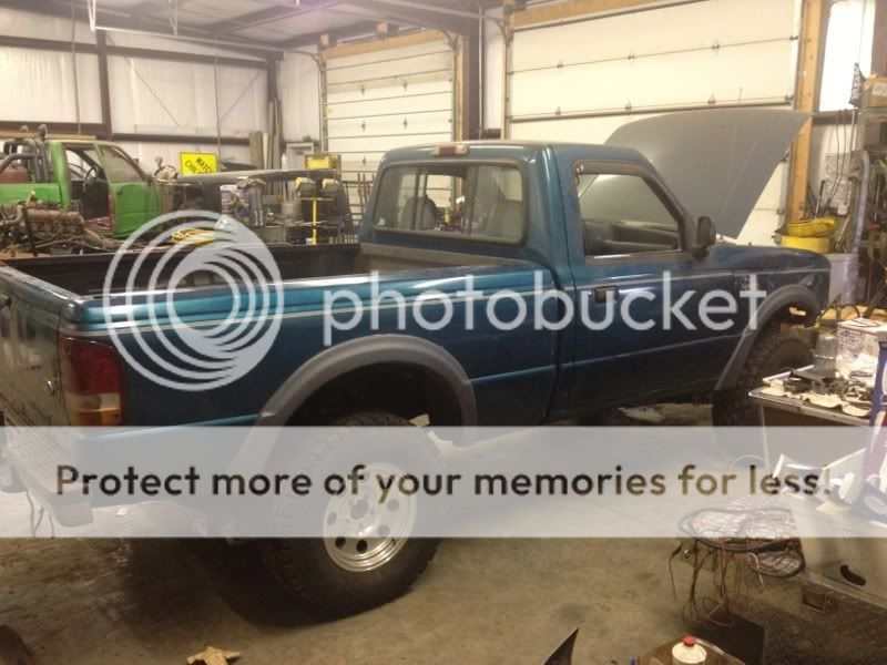

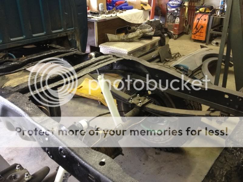

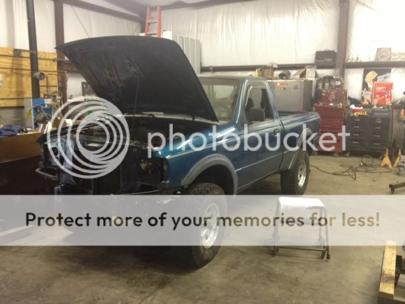

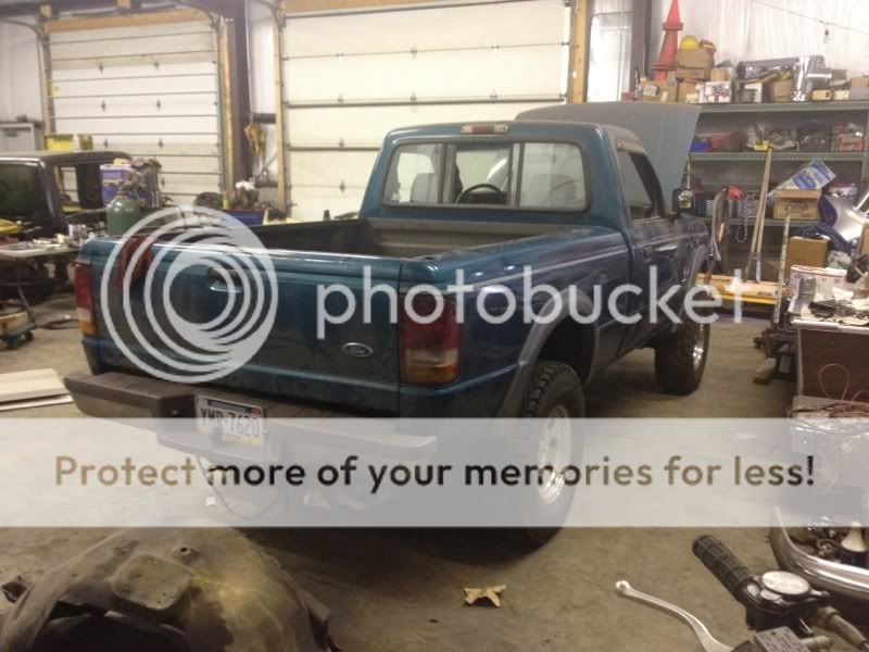

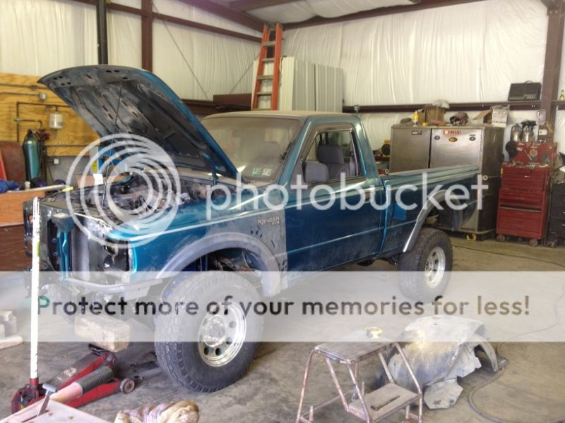

I got a lot done today. I pulled the leafs apart and took out the add-a-leaf for now and the truck sits level. I bolted the bed and cab down. I fixed straightened the rear bumper mounts and remounted it. I adjusted the drivers side beam up to the top hole in the drop bracket and corrected the camber issue (thanks to brinker88 for that advice). I fiiled the front pumpkin up with gear lube and in the process found that the return line on the power steering pump is leaking. I will replace that on the next trip.
After fixing the rear end, I had to switch the shocks back to the ones that came with my lift. They don't let the shackles open the whole way, but they will do for now. After mounting the rear bumper, I found that I have a clearance issue between the brackets and the rear spring bolts. I'll either trim the brackets or just shim the bolts out a bit.
Pictures:
