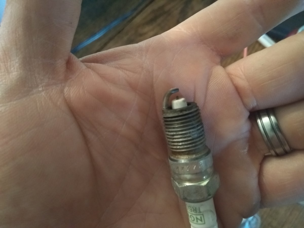

OK I re-did the timing and it runs the same, but I think I found a bigger issue. I did the compression test and I got values between 155 and 170 on cylinders 1-5. On # 6, however, I couldn't get it above 95. I assume this means doom lol. So where do I go from here?
Here is a pic of the plug from that cyl:
Forget about cheapo plugs, my ranger didn't even like the NGK or Bosch plugs, Only autolite or motorcraft, double platinum. I am currently running the autolite double platinums, she loves em! Fords waste spark system eats up plugs. She hated the NGK iridiums.
If you wanna save a few bucks you do the double platinums only on the waste spark side, and regulars on the other.

The number 1 with a bullet cause of low compression is worn valve guides, improperly seated valve guide seals do not help.
Pop off your valve cover and inspect your valve guide seals. Unfortunately, to inspect your valve guides is a little more effort. The good news is I just had a complete valve job done on my new to me 4.0L and it was $247, including all replacement parts and new gaskets.
