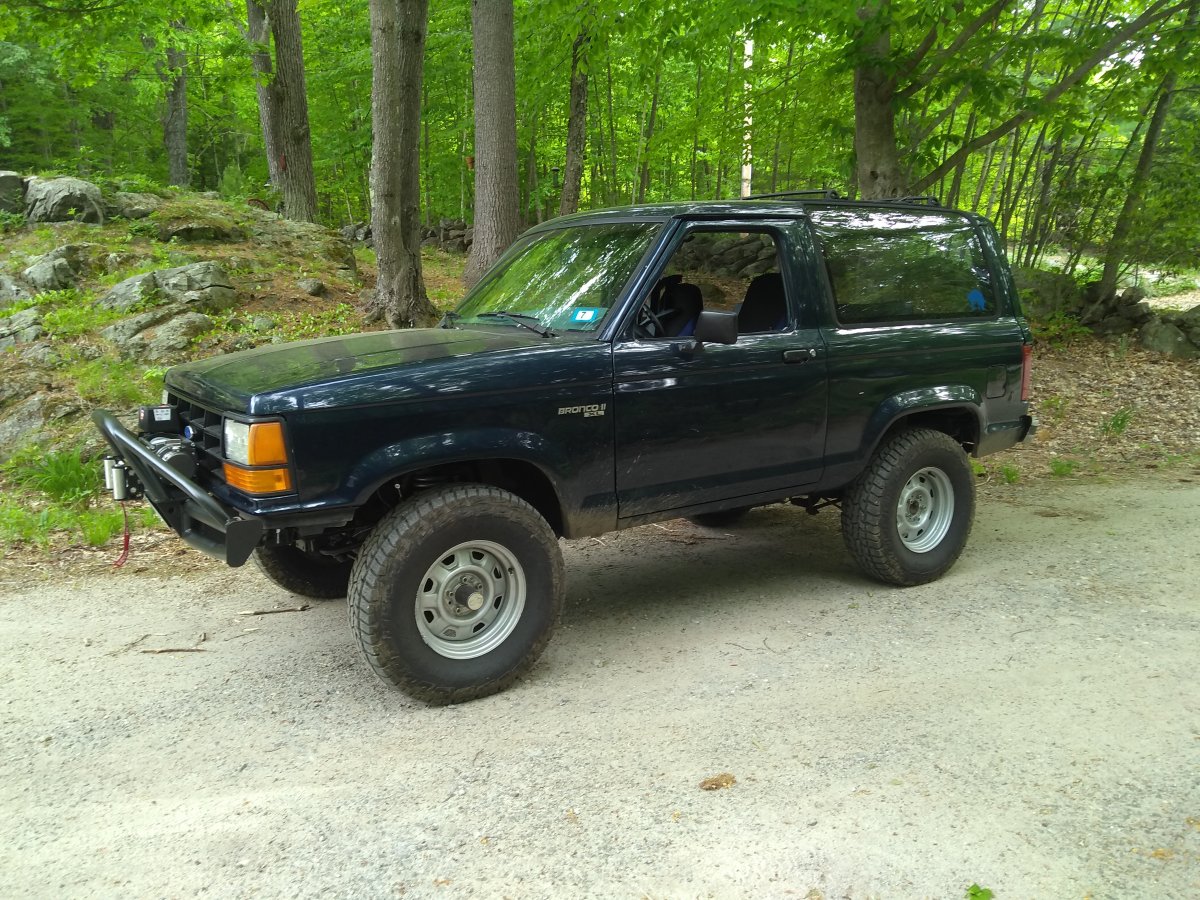

Seriously, that’s a nice looking BII.

And of course check your plugs, resistance on the wires, distributor cap, rotor, coil and I would also check the fuel pressure. Good luck and keep us posted. Is your B2 lifted a bit?

And yep, there is a 1.5 in lift. Rough country springs in front and wulf shakles in back
