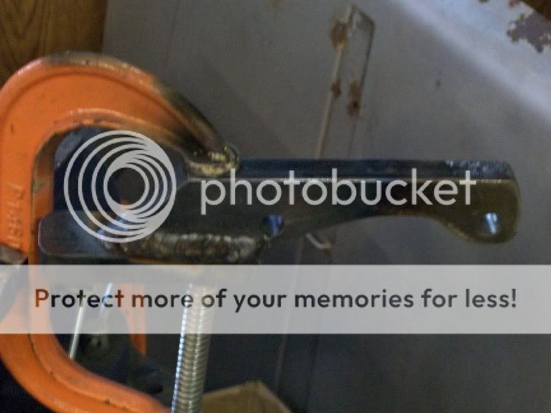

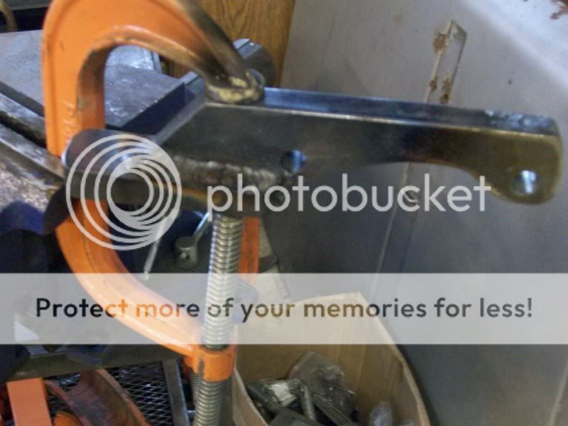

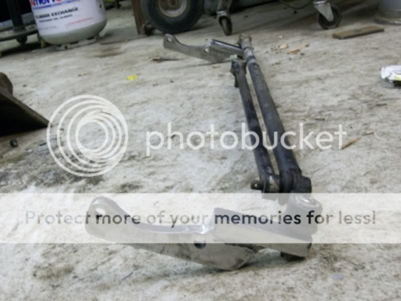

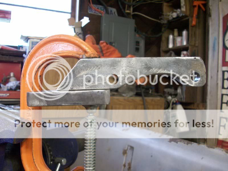

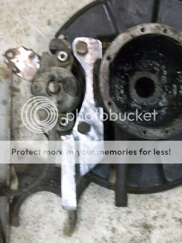

This is the passenger side arm, the drivers will look just like it. For ends, I'm going to use 5/8x3/4 heims. The tierod will go under the new arms, with a spacer under it, to take up the space between the heim and old arm. The draglink will go to the top of the passenger side arm, with a single through bolt going through both heims, both arms (old and new), and the spacer. This will put the tierod in double shear, and the draglink in single shear, unless I decide to add a tab to the arm....
I was hoping for one piece arms, but without a mill, I'm pretty much sol..
So I did everything I could to make sure I got good penetration for the weld. I chamfered the edges, preheated both pieces red hot then welded immediately double pass, then went back with the torch and let it cool nice and slow. I thought about an oil quench, but decided against it, cause I'd have to flip the fans on and lose my heat. These things are way beefier than both the stock arms, and mercedes arms, so I think it'll hold up just fine under the zuk. Not sure I'd try this on a heavier rig though, or with much bigger tires.

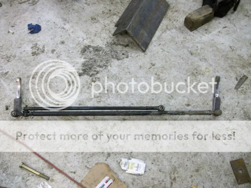

It's getting closer. I got the other arm finished up yesterday, I'm going a cheaper route than heims for now, just to get it going again. I'm setting it up for use with stock tierod and draglink, but both will be modified. I wanted to set it up where the draglink is behind the tierod, but the tierod would hit the pitman arm on full stuff. So what I'll have to do is spin the TRE for the draglink around on the tierod, since with the tie rods ends on top of the arms, the whole tierod is essentially upside down/backwards. I'll also have to retube the draglink to lengthen it, since I'm running the IFS box outside the frame, vs. the stock samurai configuration inside the frame.
Here's a few pics.

I am also extending/straightening my pitman arm in the process. This is to hopefully increase my turning, since the pitman arm I built originally is 1/2 inch shorter than a stock sami pitman arm, reducing the amount of throw, which reduces how far it will push the steering arms. I'm also straightening it a bit, which will get the draglink up further out of the way of the springs.
*Also, these arms will alter the ackerman angle, though I haven't calculated by how much. If you notice, the tierod ends are in towards the inside of the vehicle a little more than stock (i.e. shorter overall tie rod), which is neccesary to clear the tires. All the aftermarket arms I've seen do this as well, it's the only way around it while running 2.5 BS wheels. IF I were to run some wheel spacers however, my arms have the ability to have a correct ackerman angle, because they are reversible. If you take the arms off and swap sides, the tierod holes line up perfectly with the old arms TRE holes, BUT, the tierod ends rub the tire with the 2.5" BS rims. So like I said, if I swap arms and run 1/2" or more wheelspacers, the ackerman angle SHOULD be correct.

Well, everything is done except the draglink, which all I have to do is cut a tube to length and slide the blanks in, weld them up, and I'm ready to test it out.

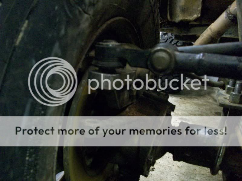

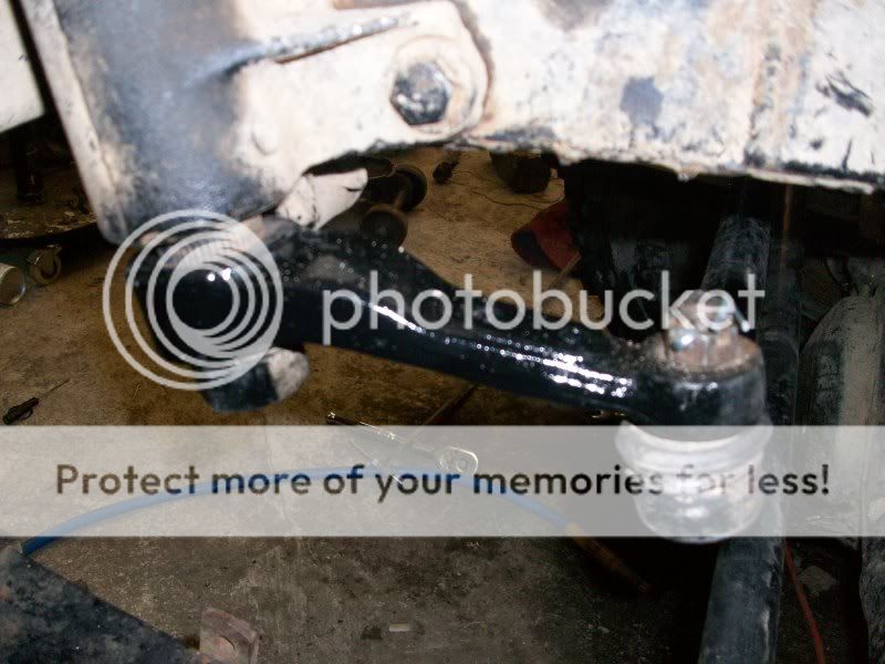

I got the arms bolted on, the tierod is a stock one, with 1" cut out of the adjuster sleeve, and 3/4" cut off the TRE. The passenger side got cut and flipped in between the TRE and the draglink rod end. I just v-notched it real good and welded it, we'll see how it holds up. This is still only to get me through till after my vegas trip in april. :D
The pitman arm got some special treatment. I remembered I had a sami pitman arm (yeah, I know I measured it the other day, but didn't even think about it.) so I cut the steering box end off of it, and after tacking it to the toyota pitman arm box end, I test cycled the suspension, and everything cleared, so I took the torch and got it red hot, and welded the piss out of it, ground it down smooth, so it doesn't have any ridges to form a crack.
The new pitman arm even has a bracket for the factory steering stabilizer. :icon_rofl: The pitman arm at least gives me a reference point for steering angle. It turned out just a (blonde) hair longer than a stock sami pitman arm, and the new steering arms are the same length as the old ones, so I should get a little sharper/quicker steering out of the deal. :icon_thumby:
I'll run the pitman arm till it breaks, then I have a length reference, and can just get a sky pitman arm. That's one of the only things I can't do here is splining. I don't have that much patience with a sawzall...:icon_rofl: Hopefully I'll get a chance to finish it up tomorrow after work, and I'll get pics posted up of the finished product.

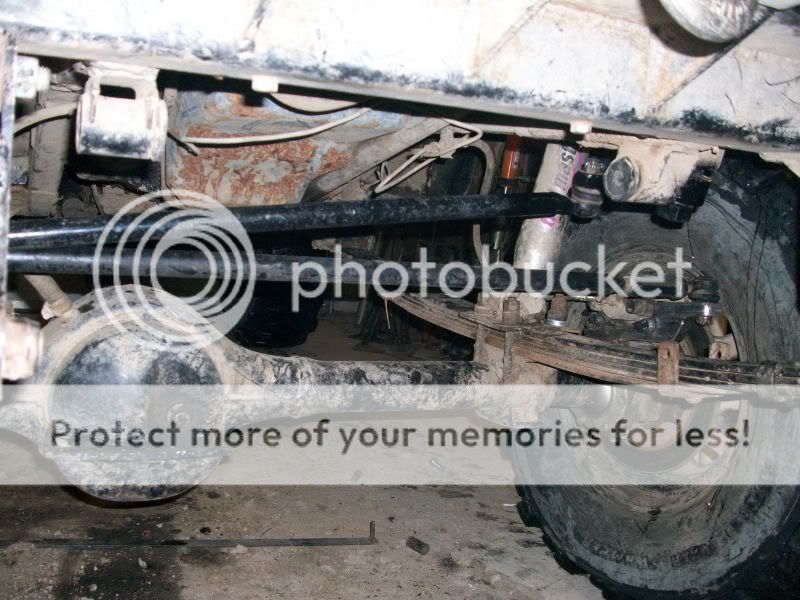

The highsteer is all done for now. I'd still like to go with heims at a later date, but it works for now.
My toyota/samurai hybrid pitman arm.
Project Fordzuki
In the picture, it looks as though the draglink would hit the tierod on comression, but it will barely squeek by with the wheels straight, the more I'm turned either way, the further it is away. I did this to have the longest possible pitman arm possible, to allow the most leverage/throw from the steering.

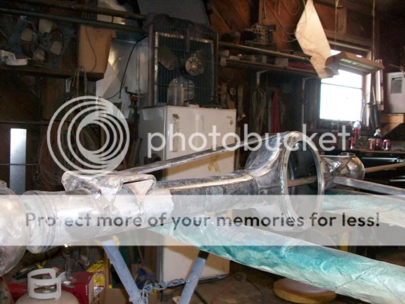

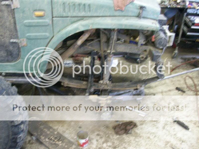

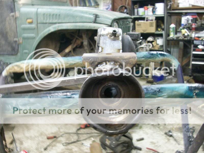

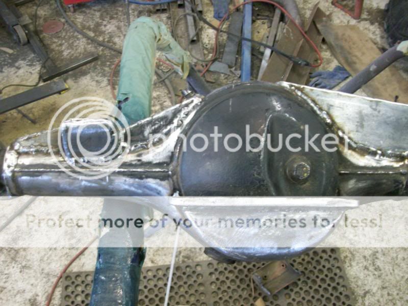

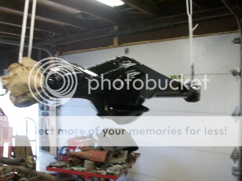

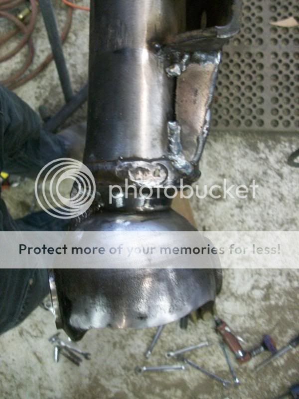

This past weekend, I took the LJ up to Elbe hills for a cleanup/work party, and took it over a small jump a couple times, and ended up bending the front housing, and bending a rear shackle. So I decided it was time for some beef.
I'm replacing the front and rear housings, and trussing them both to prevent them from bending again, the rear was already taco'd when I got it, and it seems to have gotten worse over time.

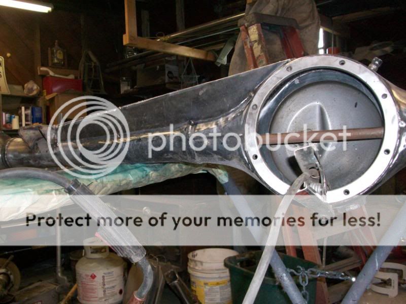

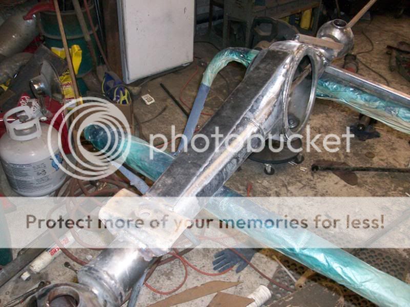

So here's the start of the front.
Project Fordzuki
Project Fordzuki
Project Fordzuki
Project Fordzuki
Project Fordzuki
Project Fordzuki
Project Fordzuki
Project Fordzuki
Project Fordzuki
Project Fordzuki

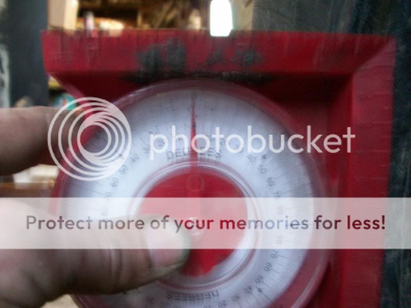

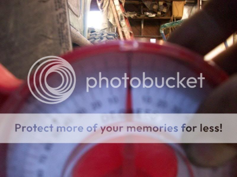

7 Degrees positive caster
Project Fordzuki

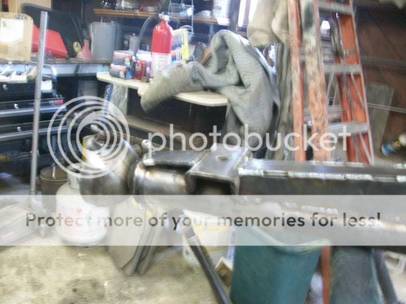

That's it for now, I ran out of wire, so I'll have to grab some in the morning and get back to it. :icon_welder: I'm going to truss it all the way out to the ends of the tube.

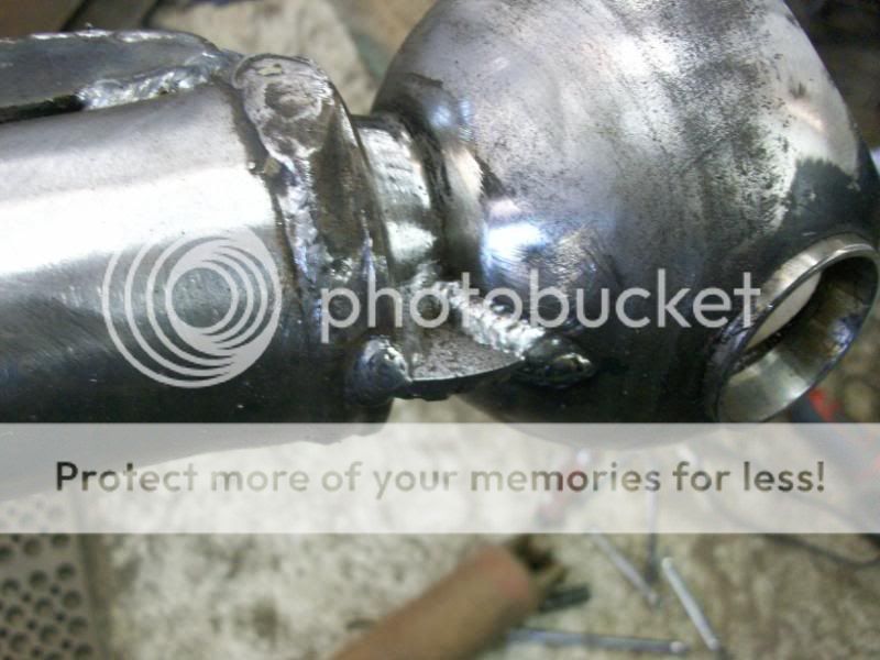

more....
Project Fordzuki
Project Fordzuki
Project Fordzuki

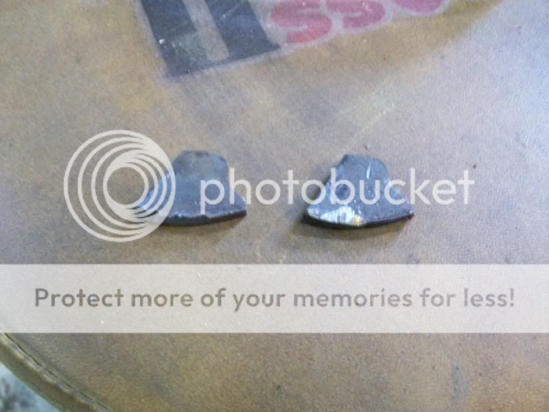

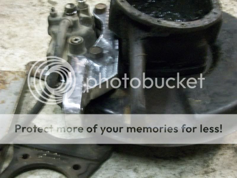

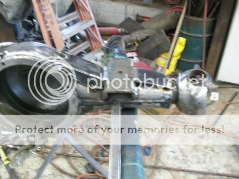

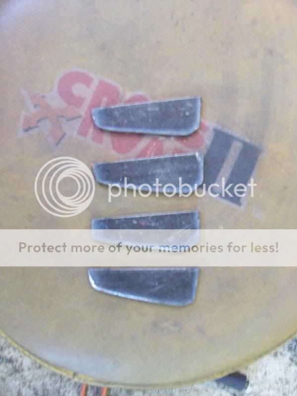

Knuckle ball gussets
Project Fordzuki
Project Fordzuki
Project Fordzuki
Armor and perches capped

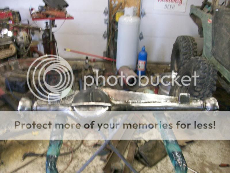

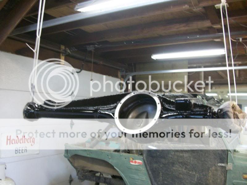

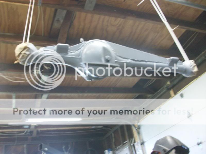

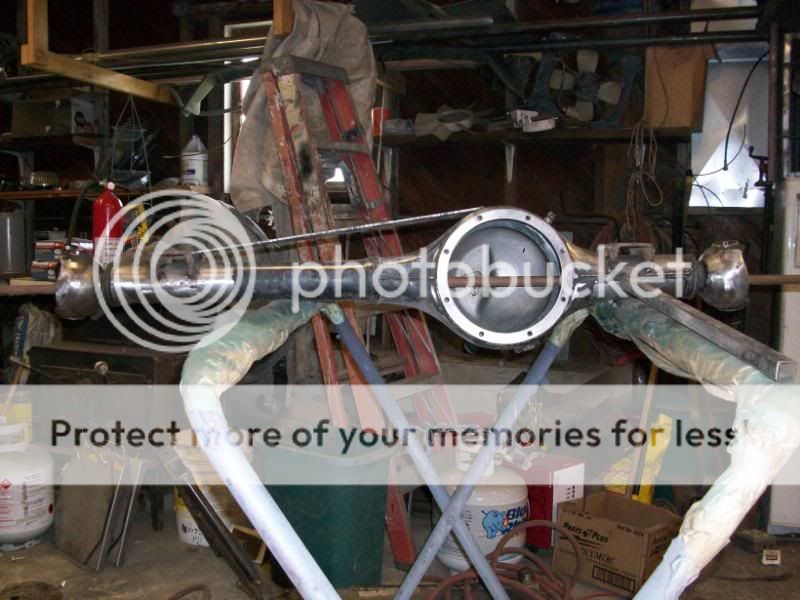

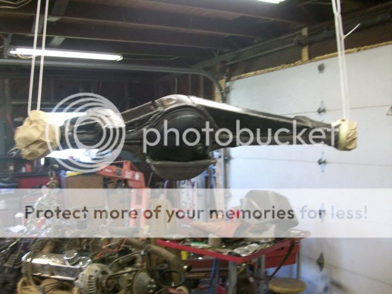

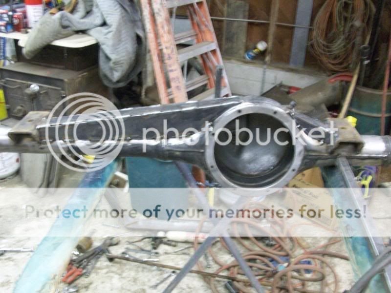

Now for the rear....

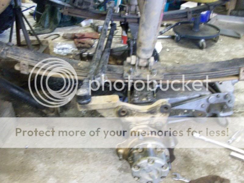

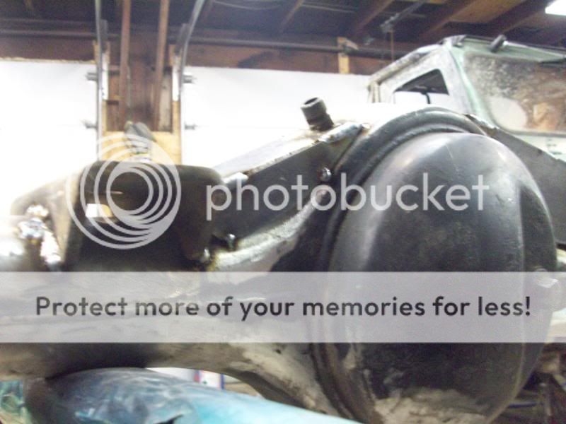

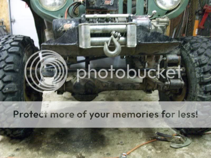

Ok, so I lied. I will be building a new housing for the rear, but for the sake of getting back out on the trail, I decided to "try" something. But before we get to that, I was looking at something as I was putting the front axle back in the rig, whadaya think? :icon_twisted:
Project Fordzuki
Project Fordzuki

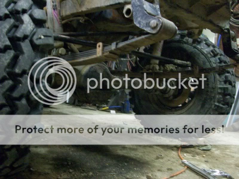

With the arms flipped around on the knuckles, it puts the tierod about 3/4" above the springs in the BACK. :icon_thumby: This means, theoretically, that I could move the front axle forward something like 12 inches, with no modification to the steering whatsoever, aside from turning the arms around.
This just means in the future, when I go 3-link and coils, I have an easy option for steering, and can move the front axle forward more for stability.

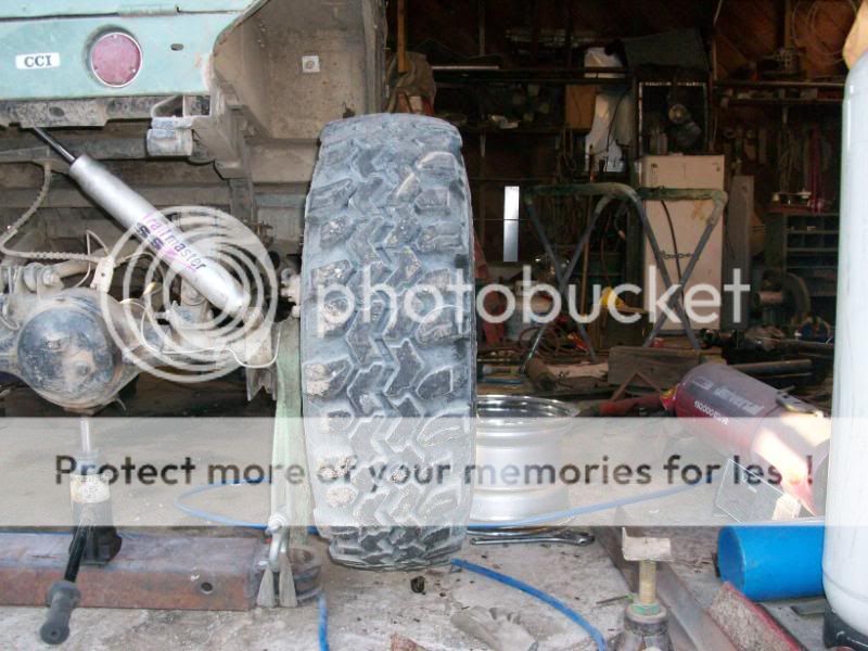

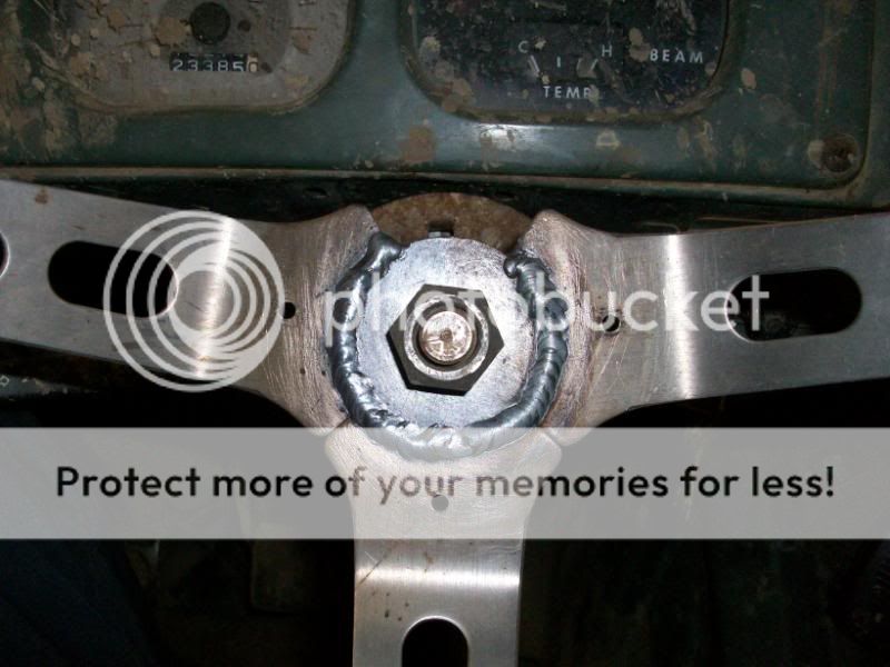

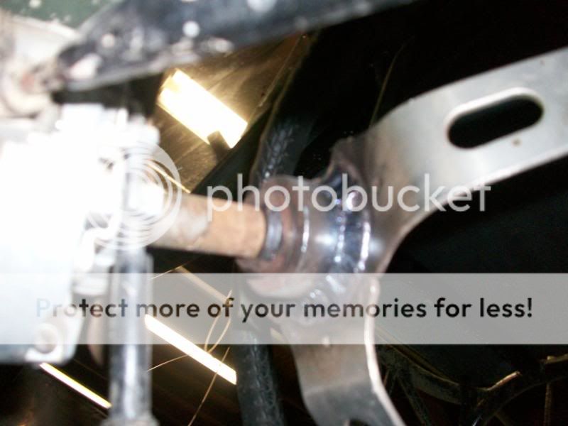

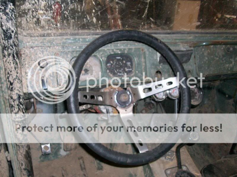

After finishing up the front, setting the wheels straight, and setting the toe to 1/16" in, I decided to center the steering wheel, since in essence, the steering is just how I want it now.
Well this turned into a dillema, since the ranger wheel wasn't splined, but instead has just the two flat spots in it. My thoughts went to a deeper dished steering wheel that Nate had given me, but the center was splined rather than like the ford wheel.
Looking at the center hubs, the ford one just had two rods, under all the rubber, while the new wheel has the 3 spoke flat design. The problem with cutting and welding the centers was, the fords was 1 7/8" OD, and the other was 2 1/16th, a bit wide for me to feel safe welding up.
So I ended up using an 1/8" flat washer, welded both to the ford hub, and the inside of the new wheel. I clamped it all together to a piece of 3/4" flat stock to ensure everything was flat as could be, and welded the front and back.

This way I was able to clock the hub in the wheel before welding, so it would be centered. :icon_thumby:

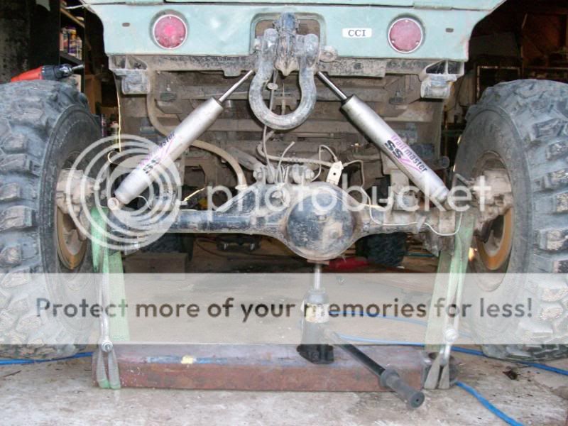

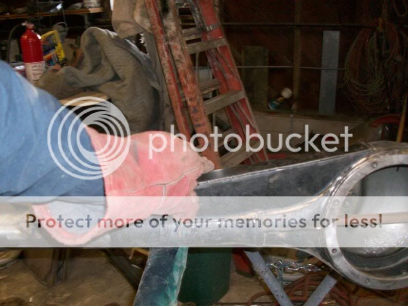

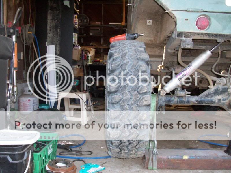

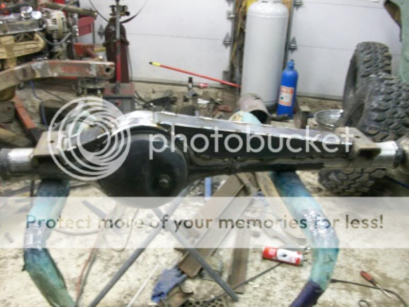

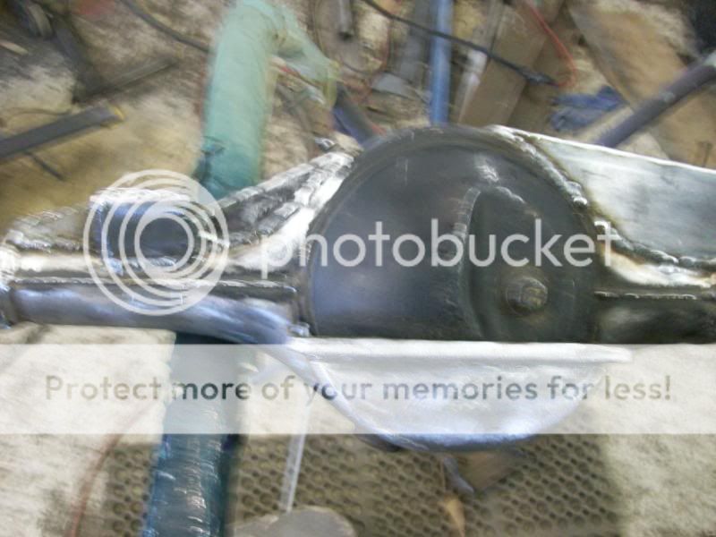

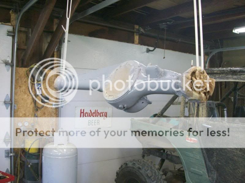

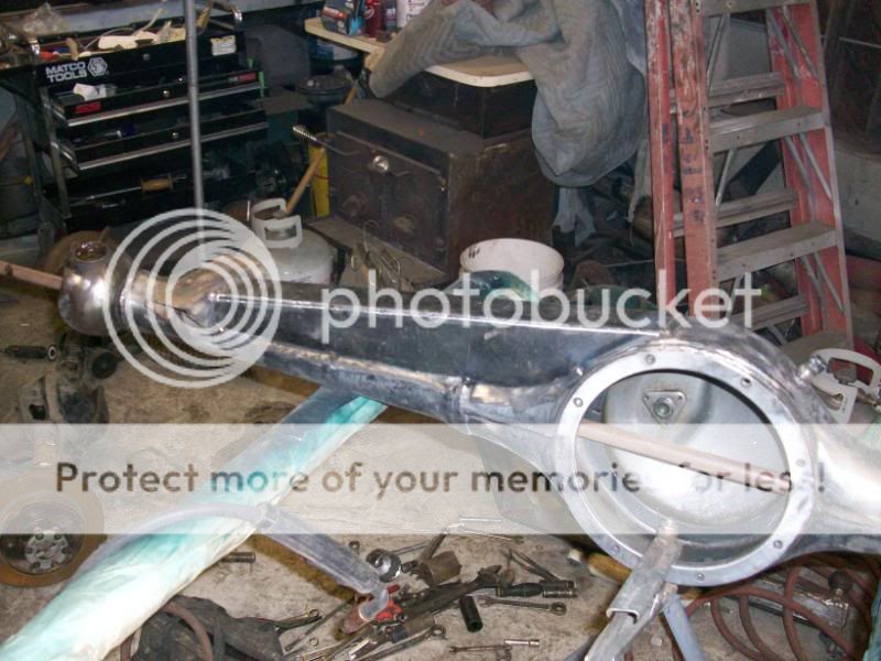

I decided to take a whack at straightening the rear housing, and it worked impressively well. The real test will be to see how long till it bends again.
Project Fordzuki
The piece of steel is a stinger from a tow truck, 1/2" wall, and weighs in at between 150-200#. :shok:
I just used two treesavers, at the outermost part of the housing, and the bottle jack under the pumpkin, with a piece of 1/4" to spread the pressure.
Project Fordzuki
Project Fordzuki
Passenger side afterwards
Project Fordzuki
Drivers side
Project Fordzuki
Lining it up with the tailgate...
Project Fordzuki

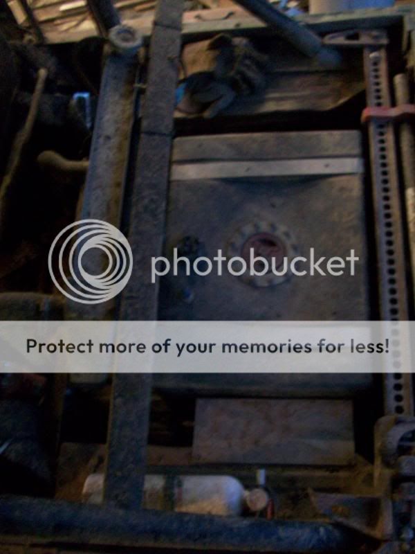

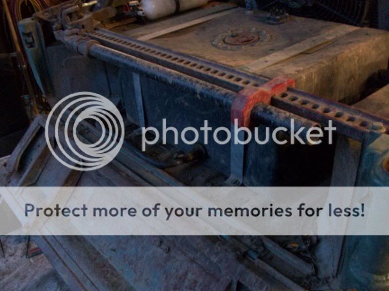

I also flipped the fuel cell around. It dawned on me last weekend, that when I got down to a few gallons, it would sputter on hillclimbs. So I decided to flip the tank around to make the pickup in the rear, rather than the front, which still isn't ideal, but it'll work till I get a better fuel cell in there.
The jack fits better in there now too, it isn't resting on the fuel cell anymore.
Project Fordzuki
I plan on making a removeable shelf just above the fuel line, so I can use that bit of space for storage too.
And there it is. For now. I still have to fix the rear shackle, but that shouldn't take long. And then I'll be ready to go play some more. :icon_hornsup:
