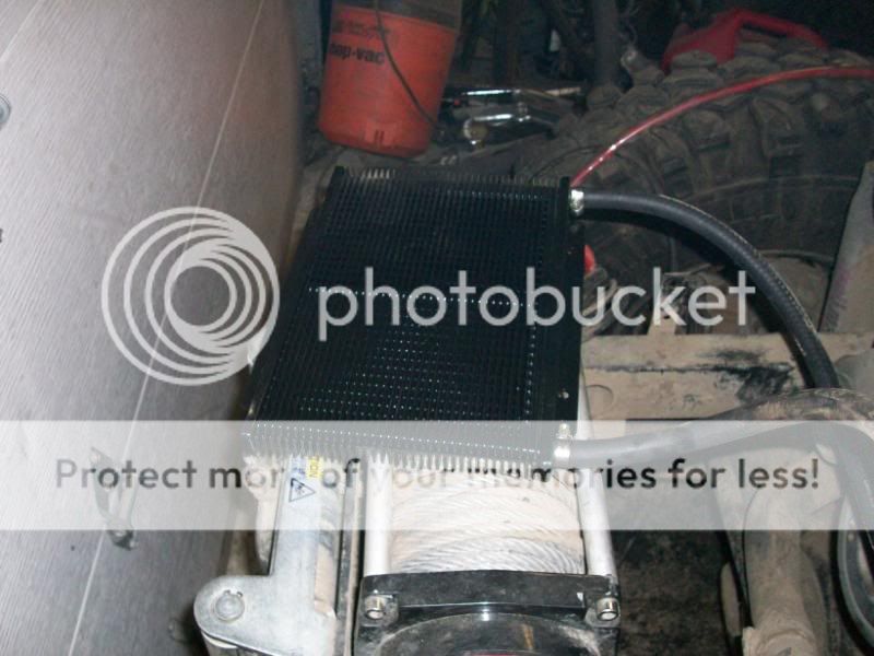

So I got the steering done finally. I had to swap pressure lines over too, cause the fittings weren't quite the same, and I could see a little seapage going on when I was filling it. I also added a dayco trans cooler to the P/S return, so it should keep things nice and cool. :icon_thumby:

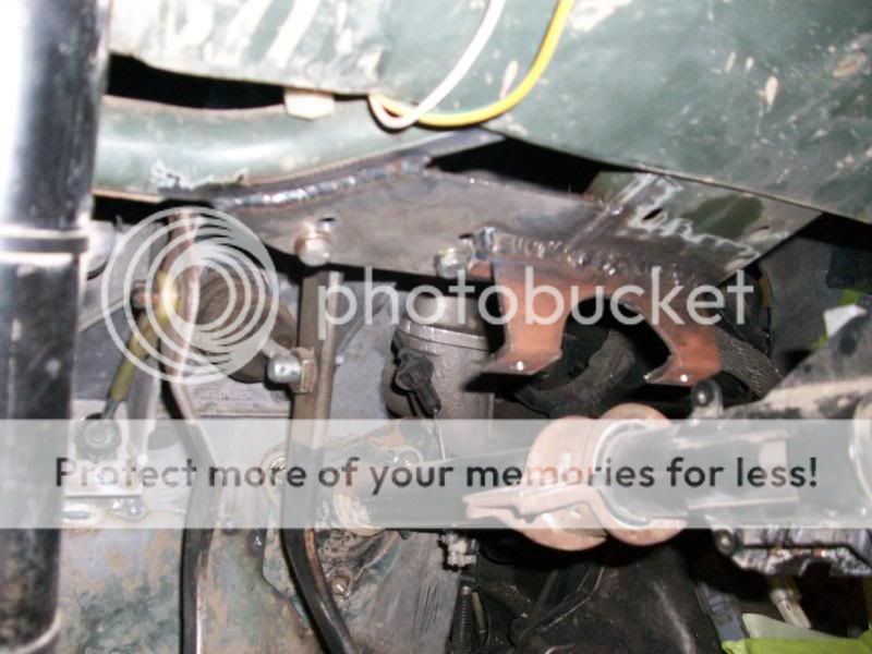

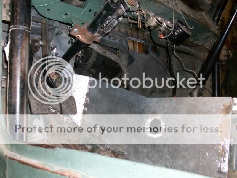

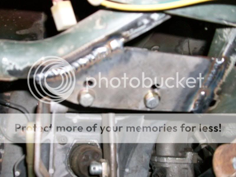

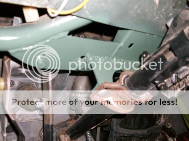

I got the underdash stuff finished up too, I had to mount the pedal bracket to the dash, as well as the steering collumn. So this is what I came up with.
Project Fordzuki

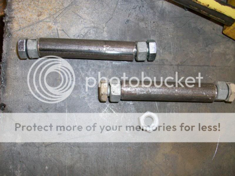

The original plan was to have sleeves this long, and a through bolt, but I couldn't find any long enough, so I improvised. I welded a nut to either end of the sleeve, and it just has a bolt at either end now. :D

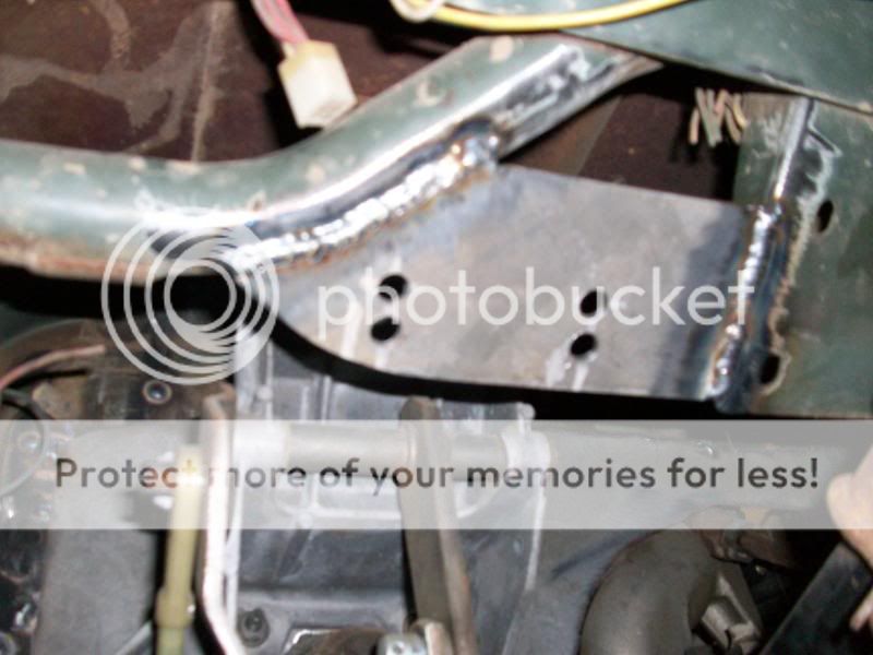

Clearance now. I'm way happier about this than an 8th inch.

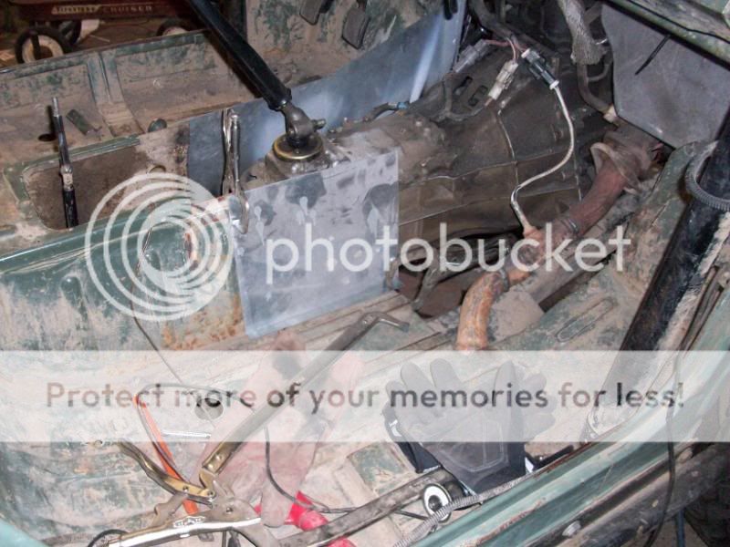

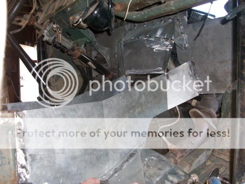

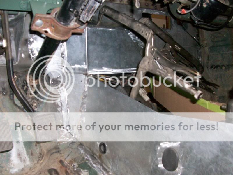

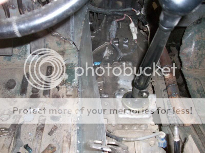

I made some headway on the trans tunnel yesterday and today, it's going alot slower than I'd like it to, but I also want to make the work halfway presentable too, so I'm taking my time. Basically, the drivers side is done, except for the ONE piece that I need in there to mount the gas pedal.

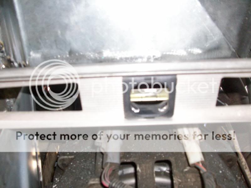

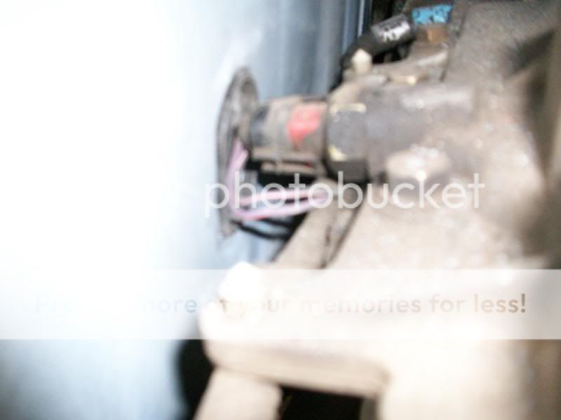

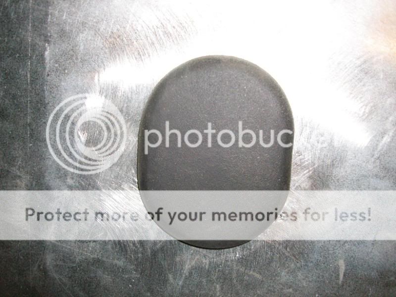

This is for access to the reverse sensor...
Project Fordzuki
Project Fordzuki

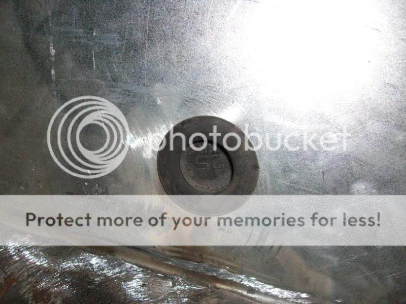

And this one is for the clutch bleeder.

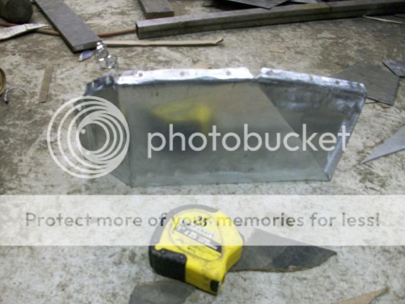

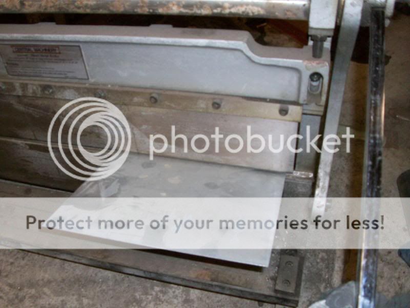

Bending the first piece for the passenger side.
Project Fordzuki
Which turned out to not quite fit because of how the floor sits. :annoyed:
Project Fordzuki
I can invision the passenger floor looking like a cluster f$#@, but I'll do my best to make it look good.

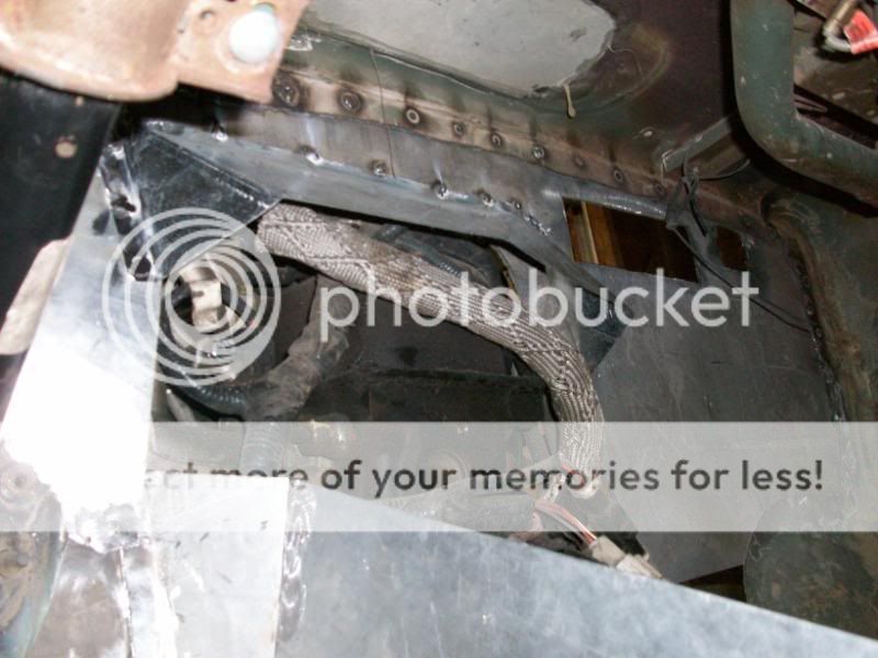

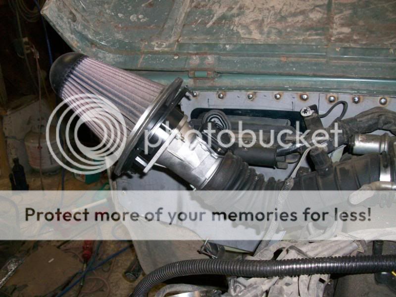

I also got the welds around the perimeter of the firewall ground down and polished, I'm still toying with the idea of running the intake into the firewall, I'm not sure if I even have room to run the conventional airbox... everythings definately coming along though, I can see possibly wrapping up loose ends this weekend, I have friday off for the 4th. :icon_confused::yahoo:

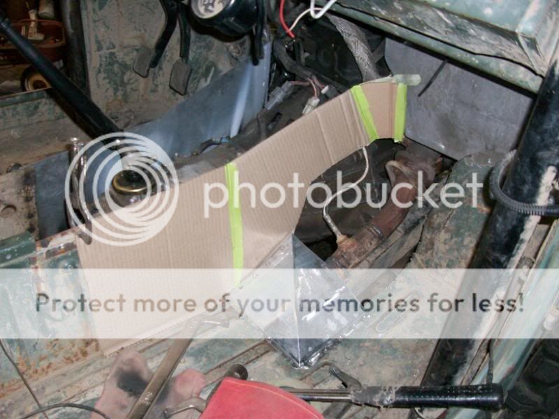

If only cardboard and masking tape were structural..... :icon_twisted:

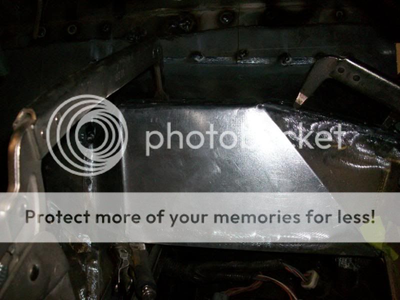

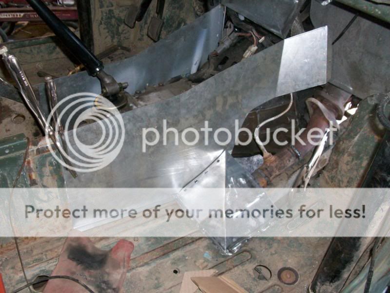

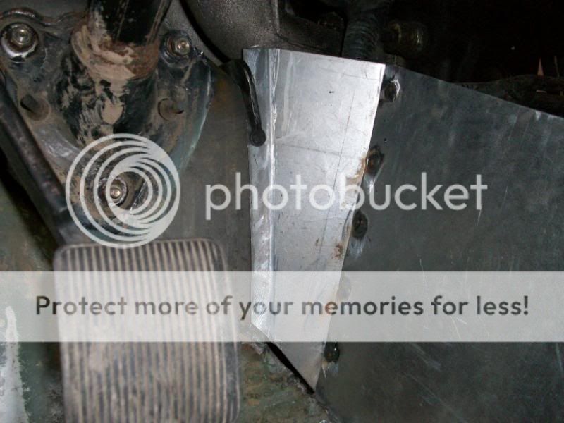

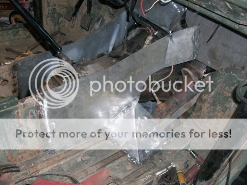

I got some more done tonight, I'm waiting for another piece of 18 guage large enough for the passenger side, so till tomorrow it sits in cardboard. I did get the piece made so I can finally mount the gas pedal, and the starter piece for the passenger floor. I'm hoping to get the rest of the floor made in two pieces, and the whole passenger side of the trans tunnel made from one piece, then it's just the top and it's done. :yahoo:
Project Fordzuki
The floor starter

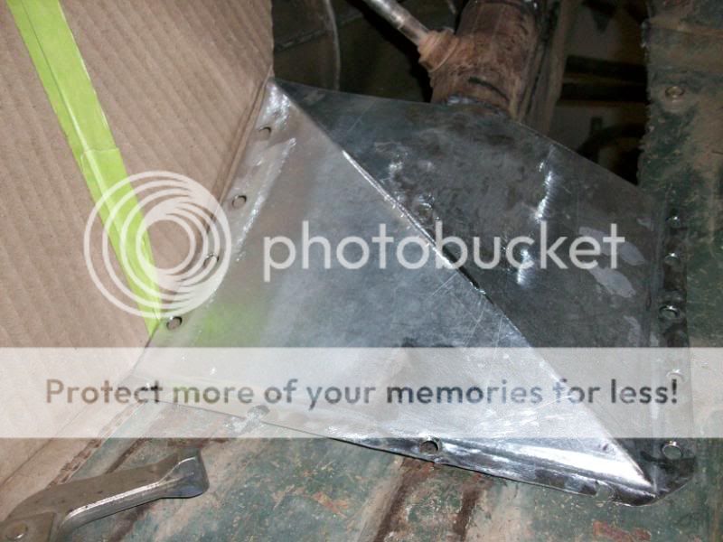

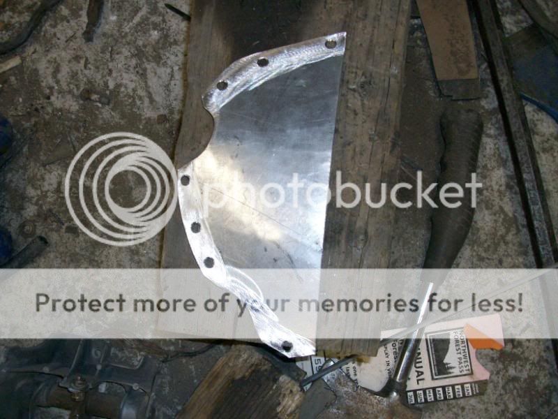

The last bellhousing cover piece.

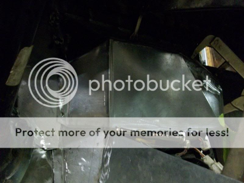

And that's it for tonight.

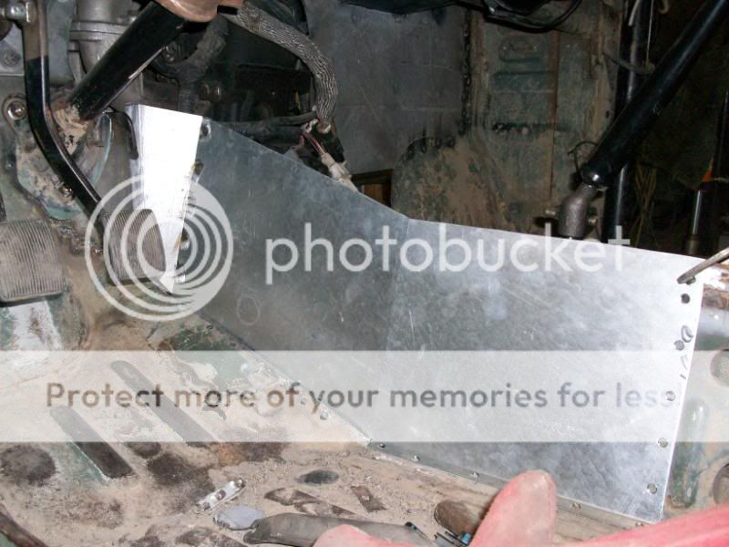

Getting real close now. My supplier brought some more 18 guage today, so I was able to make the passenger side piece.
Project Fordzuki
"Close enough for the chicks I go with" :D
Project Fordzuki

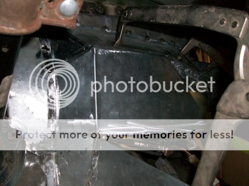

All welded in.
Project Fordzuki
Project Fordzuki
On a side note:
Since there are no gaps involved, I'm welding it in as I go, basically just to make the clamping easier. I don't want a bunch of screw holes to weld up. If this were say, a rear body panel, where the quarter to decklid gap was a concern, I would clamp it all up and then weld. :icon_thumby:
Aside from the top cover around the shifters, I think 3 more pieces will do the trick. After i get the one on the upper part of the tunnel made, and the floor piece that attaches to the firewall made, I'm going to take a break on the welding and grinding and prep the outside of the firewall for paint. Which reminds me AGAIN, I need to make the little shelf that the right apron attaches to on the outside of the firewall. But after I get it painted, I can hang all the wiring back up, find the routing of it, and start wrapping it back up. That and hang the front clip back on it, (which obviously needs to be done before the wiring) so I can hang the P/S cooler, and run the winch cables back through.

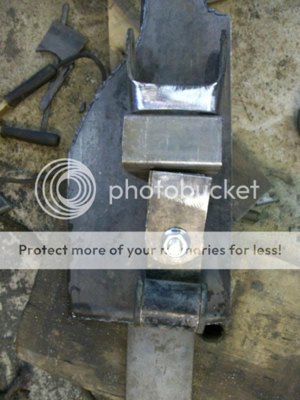

For some reason I can't find the picture that's posted here of the old one on photobucket, but here is one of the new ones, before welding it up, it also has two half circle gussets to support the two tabs on the bottom of the square tube.
Project Fordzuki
But basically, as you can see, the bottom most piece is actually the stock front leaf eyes, with a couple inches of spring sticking out. The eyelet gets bolted to the housing via two tabs. Then at the middle pivot, it sandwiches plate/spring eye/plate. These are welded to the box tube above, and gussetted like I said. Yes, the third pivot is a high friction joint, but it was free, unlike another "heim".
I ran it like that for the last two years, and finally bent the two tabs that stick down from the box tube, and also caved the bottom wall of the box tube. When I pulled it apart, the threads had barely worn off the bolt. I replaced the bolts when I replaced the shackles, but I'm still running that design. When I build a new rear housing it might get changed, but it works, and works well for this rig. :icon_thumby:
