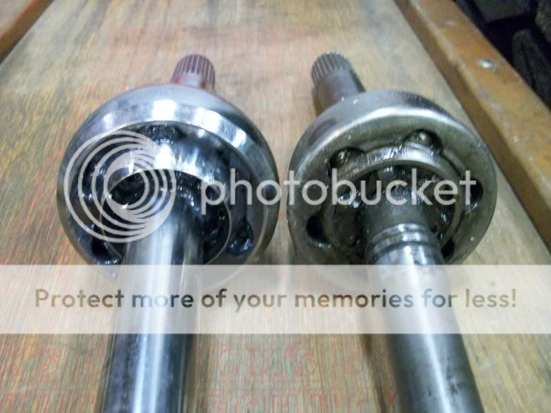

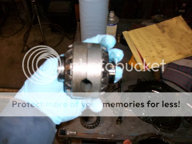

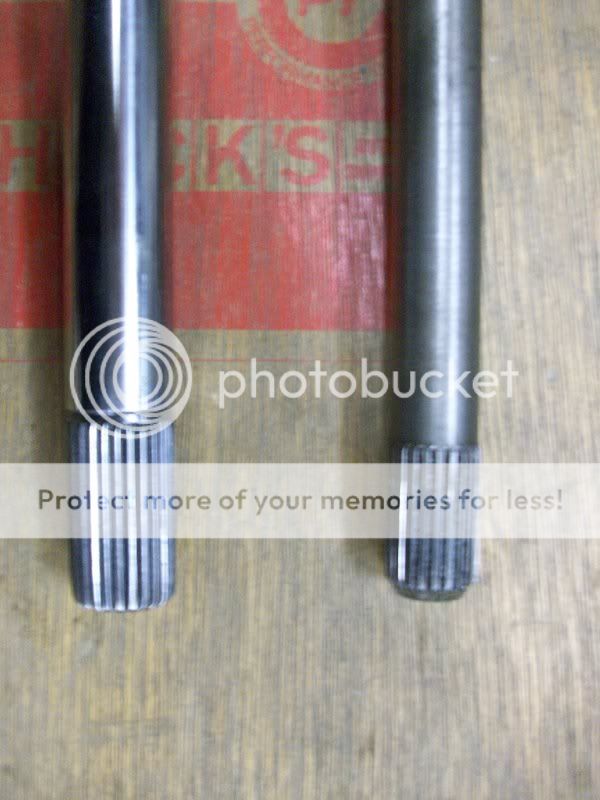

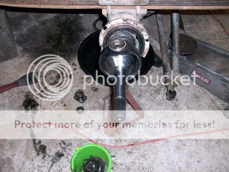

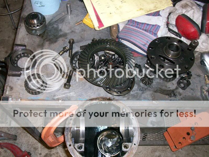

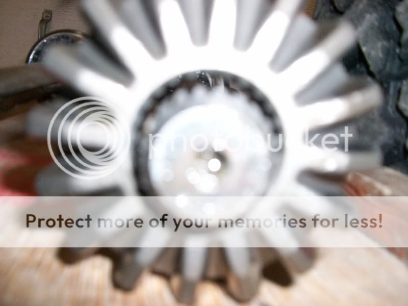

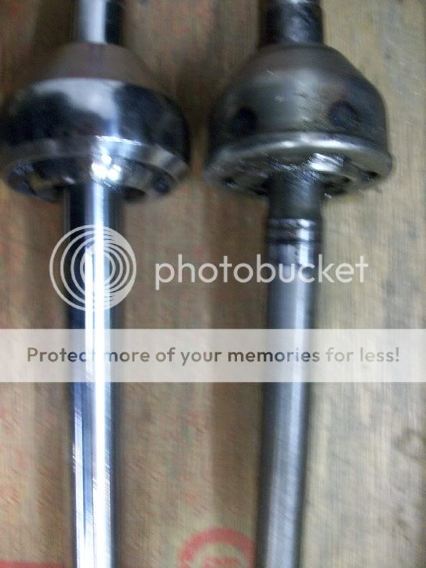

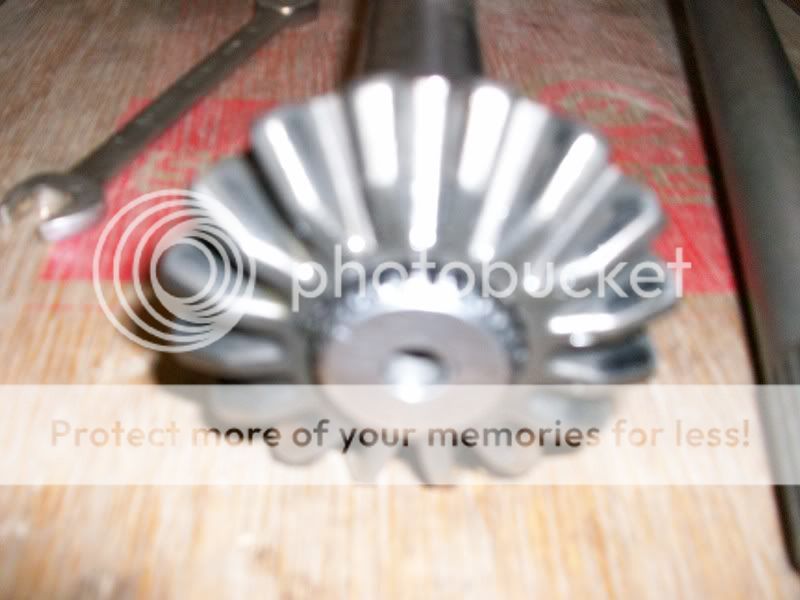

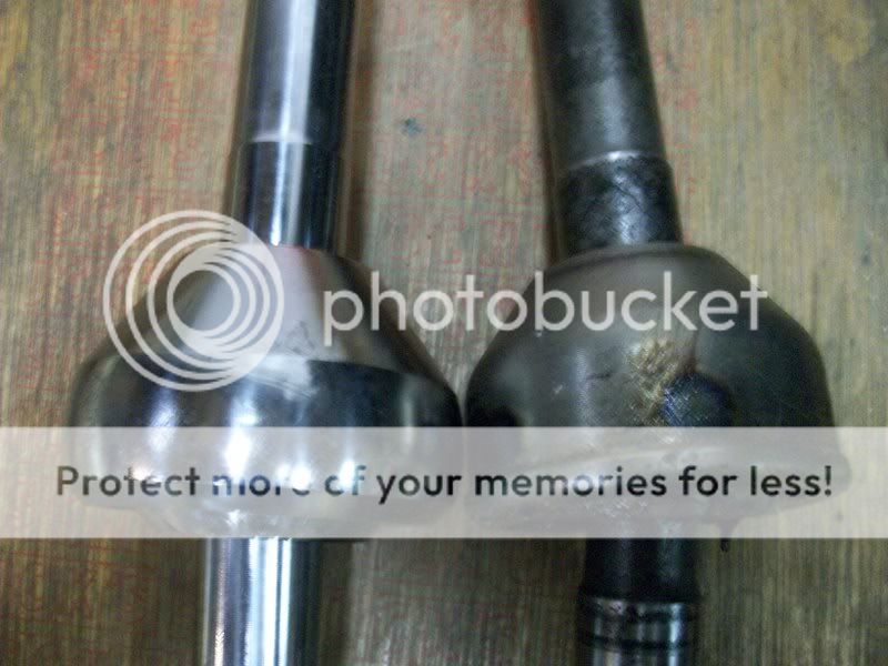

I got my chromos and lockrite in today, so I went to work installing them. I had to first pull the thirdmember out of a spare rear, that had a leaky pinion seal and bad pinion bearing. So I sacrificed this third for the sidegears, which are 26 spline, as opposed to the front sidegears which are 22 spline. The chromo axles are 26 spline and match the diameter of the rear axleshafts. I needed the sidegears to go with the locker, because the sidegears mesh better than the optional couplers they sell. :icon_confused:
So I got the sidegears swapped out, locker installed, and the third back in the housing, and one of the shafts slid in. It's quite an ordeal getting the new birfs into the ball on the housing. :D

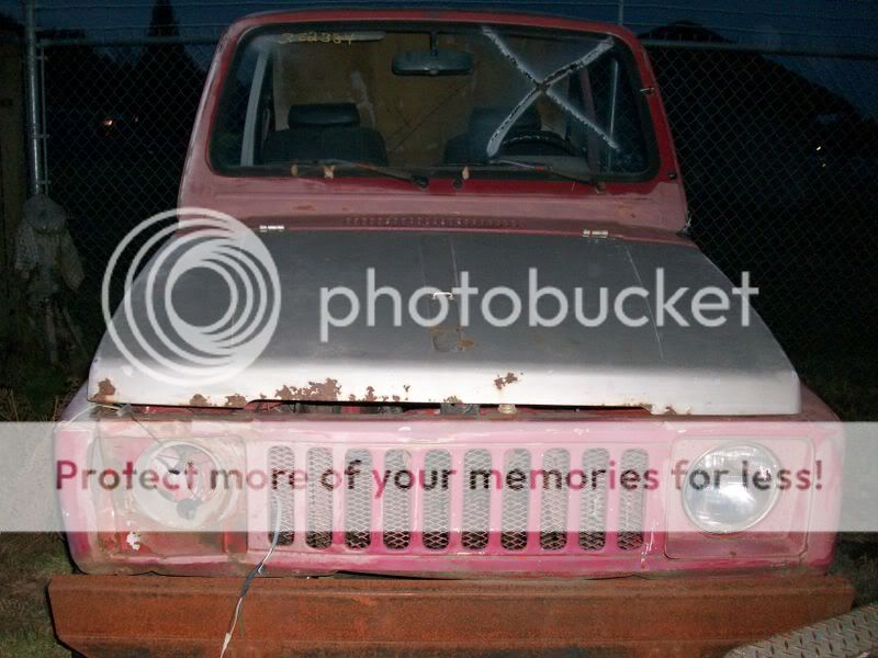

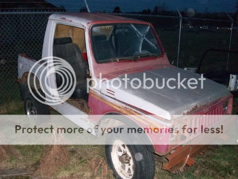

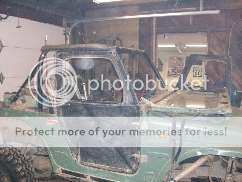

This is the start of the new project. 84? Suzuki Sj410 (still pre samurai) with the front half of a tin top grafted on. I'll be enclosing the back wall, and making somewhat of a pickup out of it. Enclosed for winter wheeling. :icon_thumby:

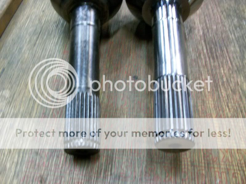

Birfs: New vs. Old
Project Fordzuki
New vs. old

Swimming for sidegears.
Project Fordzuki
The tiny little sami lockrite. :icon_rofl:
Project Fordzuki
26 spline sidegear on 26 spline axle
Project Fordzuki
26 spline sidegear on 22 spline axle

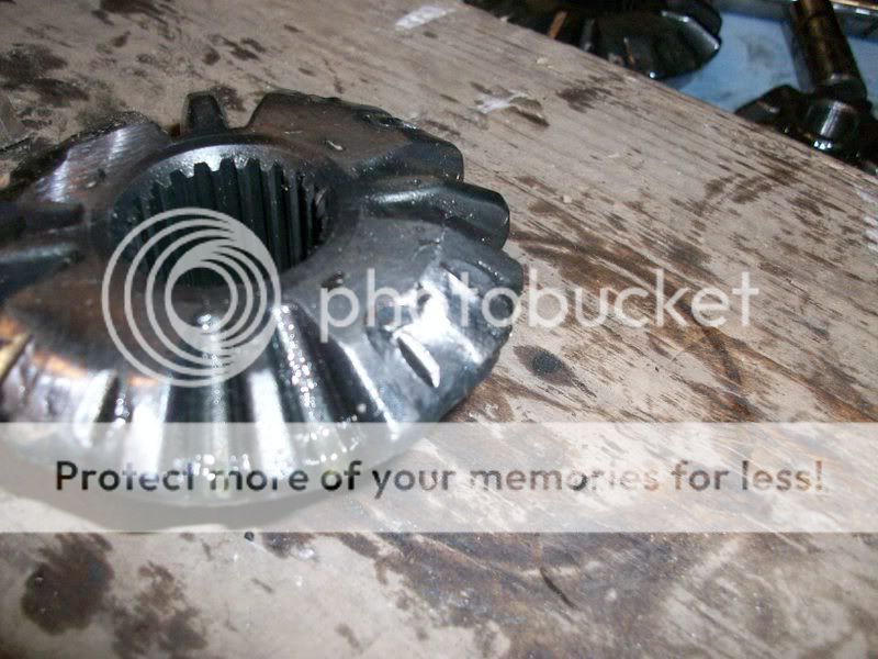

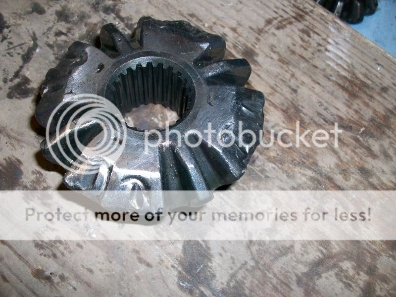

Interesting note* these are the 22 spline sidegears I welded to "spool" the front originally. These have been abused and have seen two broken birfs. I've been running them for about a year.. HARD. As you can see, the spiders have started compressing the welds, but aside from the indents, there is no visible stress or wear on either the spiders or side gears. :icon_thumby:

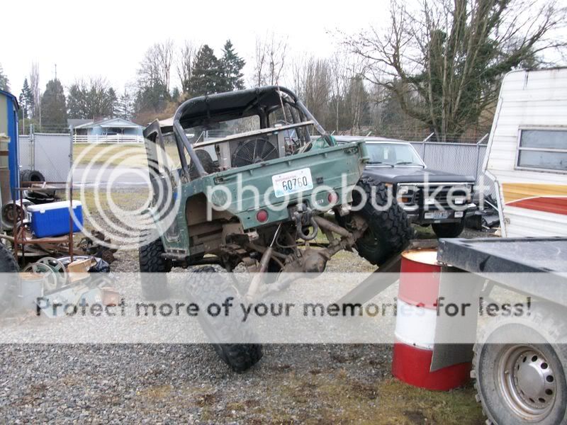

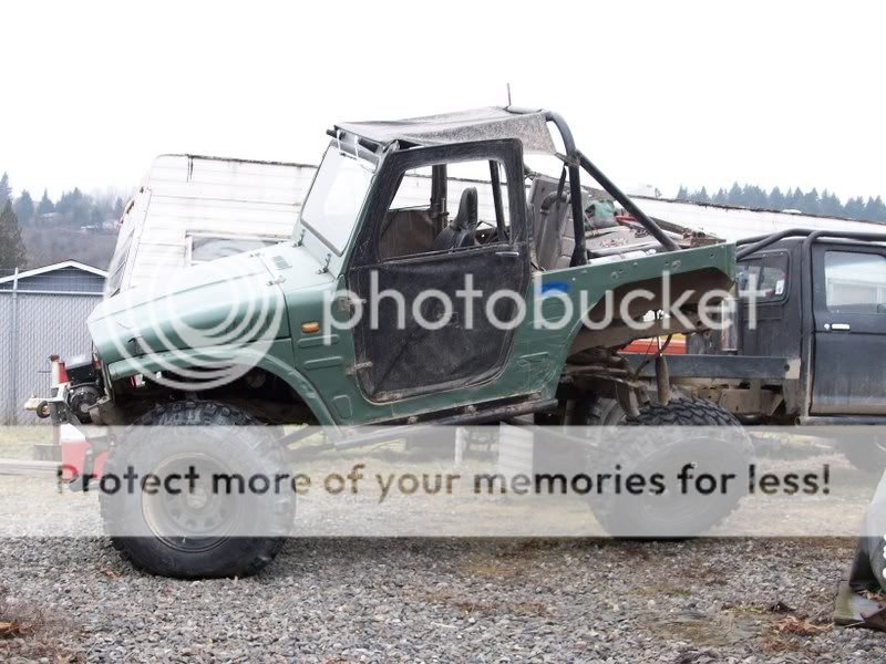

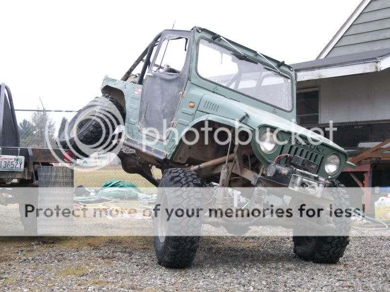

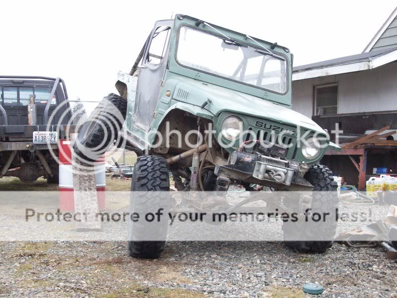

Heres a few pics playing around in the yard, the suburban broke the RTI ramp, so I had to improvise. :icon_rofl:
First the ramp
Project Fordzuki
Project Fordzuki

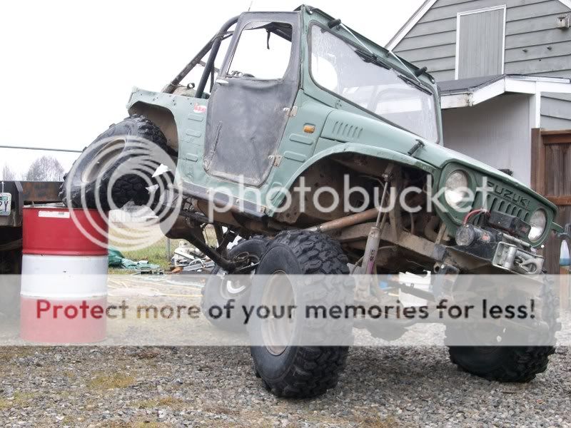

Then the barrel (35")
Project Fordzuki
Project Fordzuki

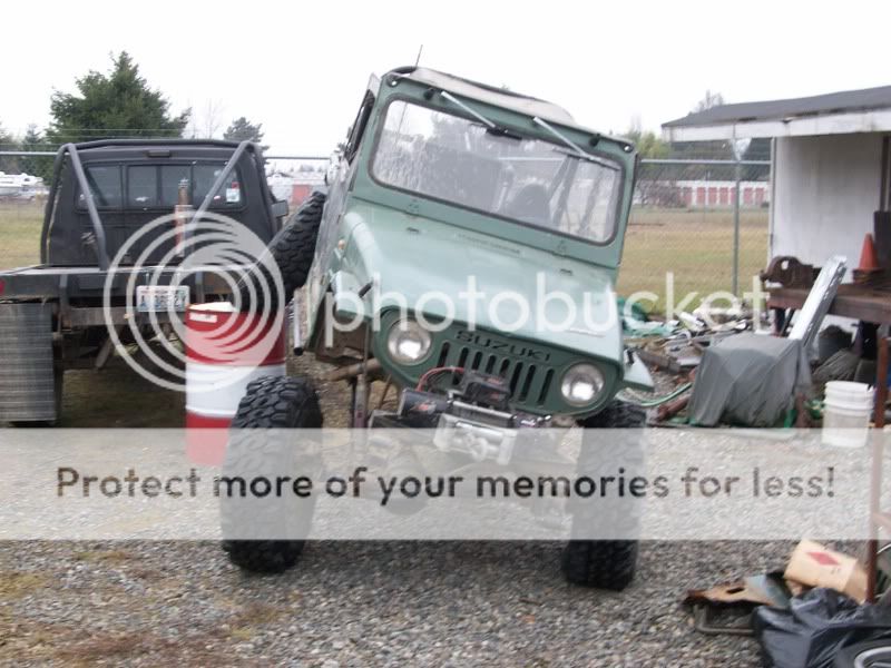

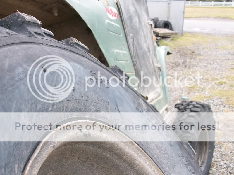

Then just the truck (40") :headbang:
Project Fordzuki
Project Fordzuki
Project Fordzuki
Project Fordzuki
Kindof liked this view
Project Fordzuki

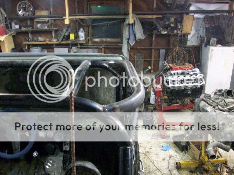

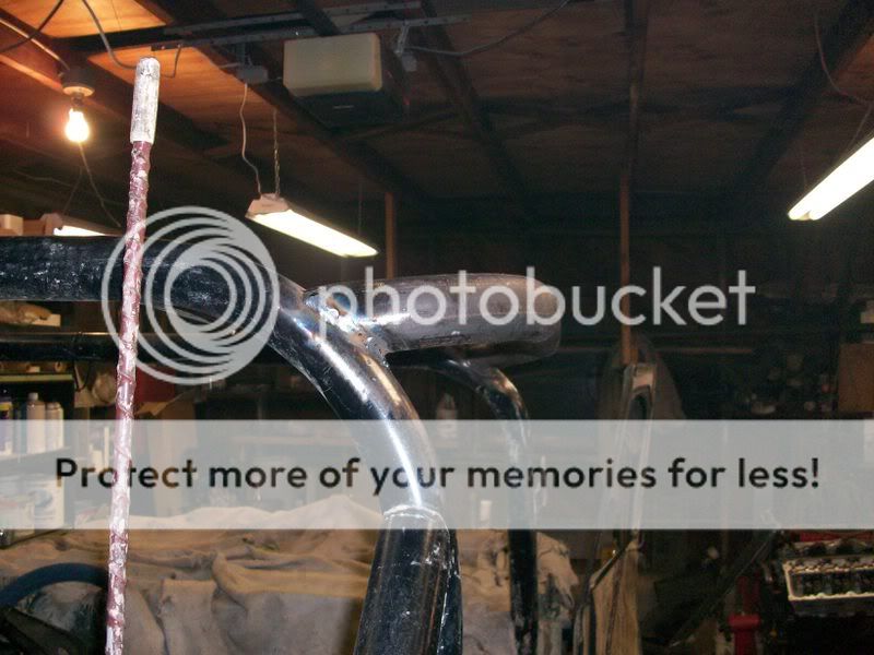

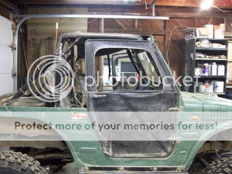

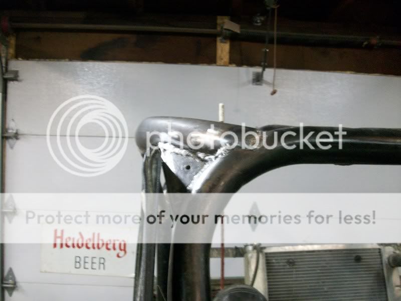

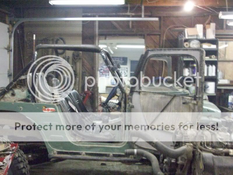

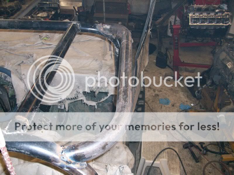

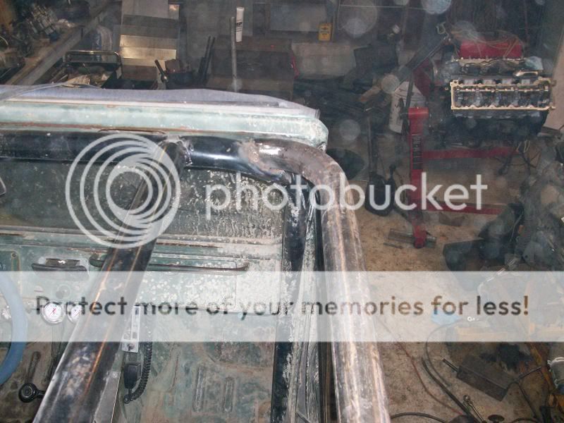

So tonight I started fiddling around with an idea that had been floating around in my noggin. I had originally planned on an external loop around the windshield, with the likely addition of a full exo soon after.
Well, after toying around with the idea, I decided I didn't want to disrupt or block anymore of the body than I already have, and leave it exo-less. This posed a new problem of what to do about protection for the windshield frame in the event of a flop, or the everpresent Northwest threat of leaning into trees, banks, rocks, etc....

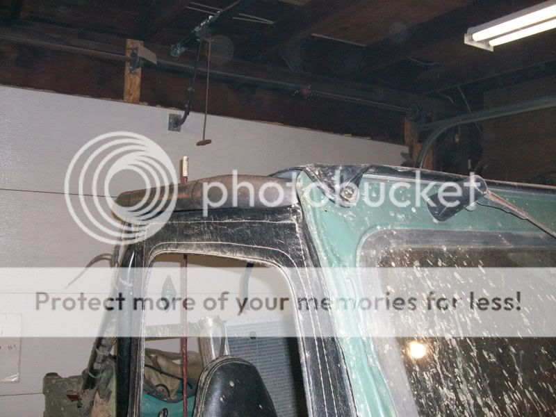

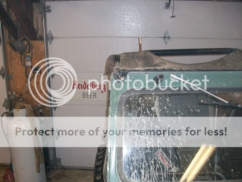

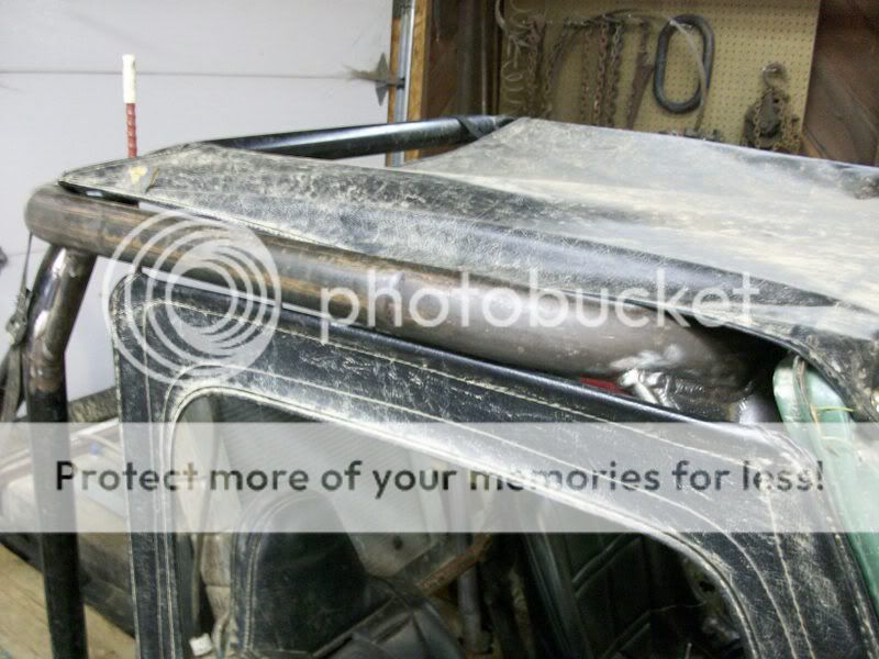

So I came up with this, it's a "roof slider" of sorts, just an addition to the cage which protrudes out to the outer edge of the windshield frame, and a little beyond.
Project Fordzuki
Project Fordzuki
Project Fordzuki
Project Fordzuki
It also fills the gap between the top of the door and the bikini top, and allows the top to be mounted flat, instead of pulled down in the back corners.
Project Fordzuki
Project Fordzuki
Project Fordzuki
Project Fordzuki
Project Fordzuki
I still have the other side to do, and I will be bracing the corners, I haven't decided between plate gussets, or small diameter tubing.... :dunno:
I figure this way it gives something up top to slide on, but doesn't add the weight that a full exo would, and keeps the overall look of the rig the same.

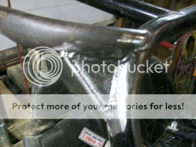

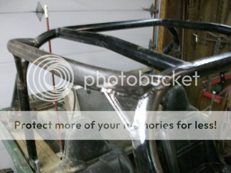

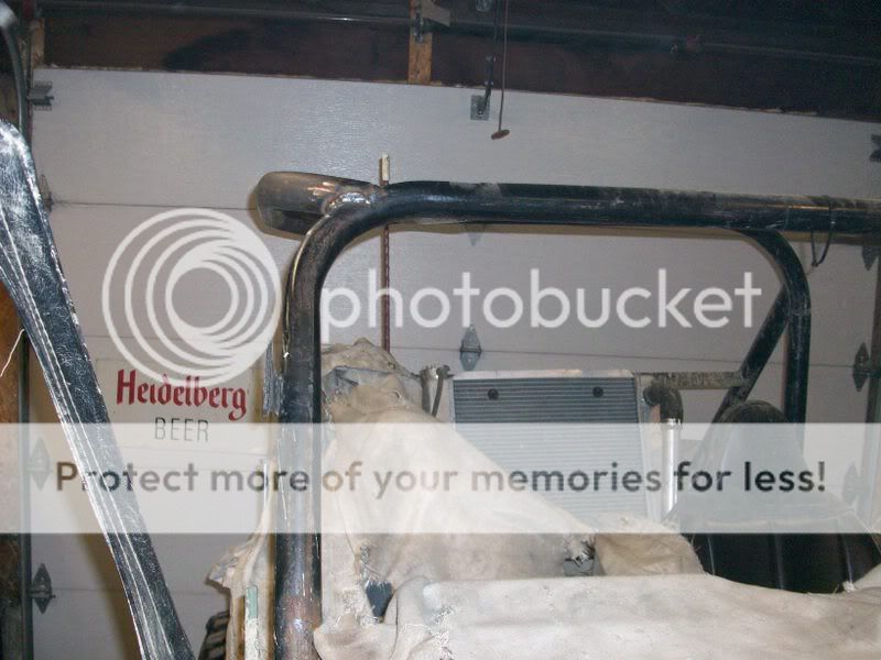

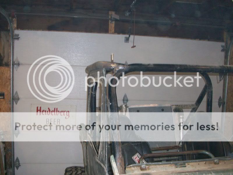

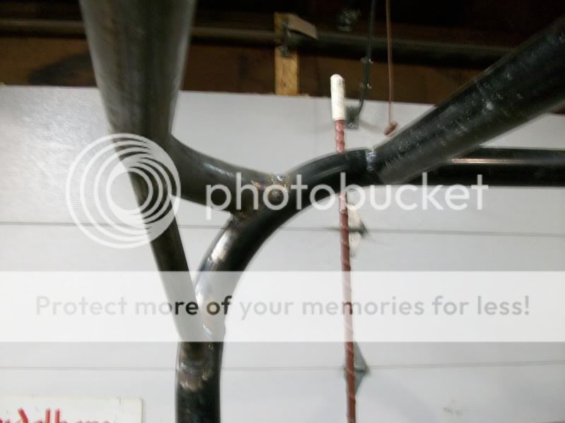

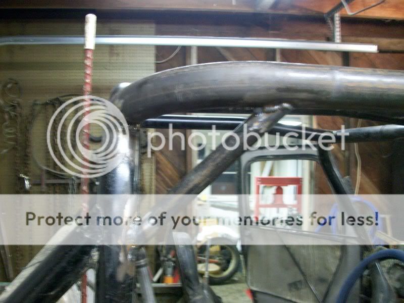

I added a couple gussets to the bar, I couldn't decide between plate and tube, so I used plate, tube, and round bar. :thefinger:
The tube one in the rear.
Project Fordzuki
Project Fordzuki
Plate with 3/8ths round stock on the front.
Project Fordzuki
Project Fordzuki
Project Fordzuki
Project Fordzuki
Project Fordzuki
Project Fordzuki
Now I just gotta make the other side look the same. :icon_twisted:
I'm also going to put some grabhandles on the inside, to keep people from grabbing for tube in a flop.
