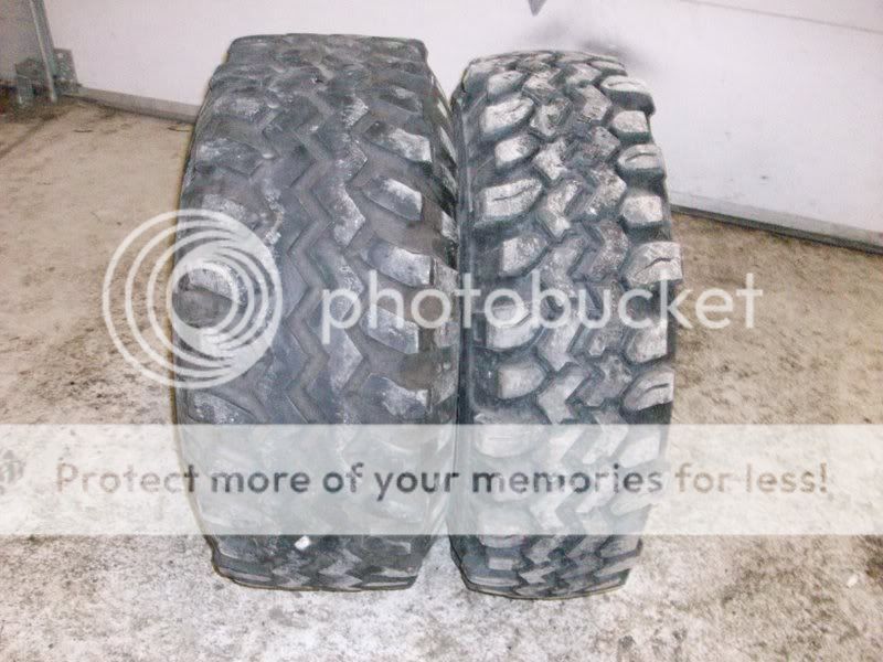

) It's kindof funny though, I came home the other day and found a set of 31x12.50 thornbirds out in my yard.
Basically it's whatever looks and measures out to work.

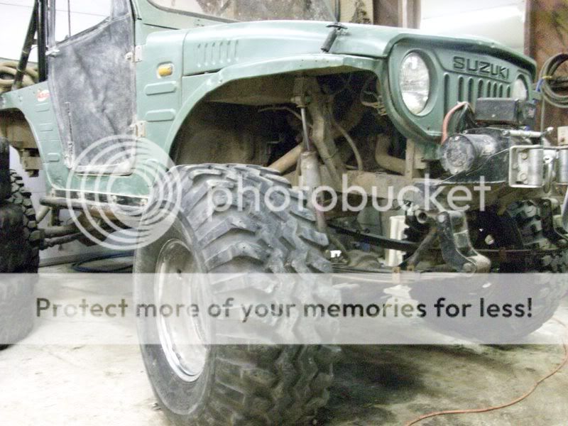

I honestly thought that Zuk on AG tires, was a side-by-side when I first looked at it!!
What is the difference between an SJ, and a Samurai? Is it just the lack of a the Samurai name? They looks almost identical from what I can tell.

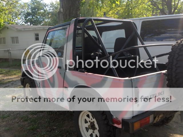

I went to take pictures, and the camera was dead.
So when it charges up, I'll run out and get a few of the complete cage.

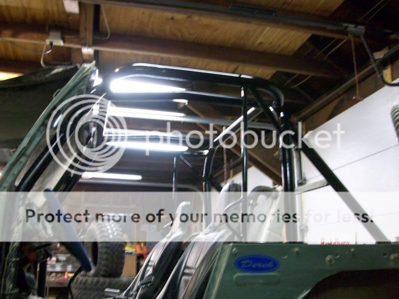

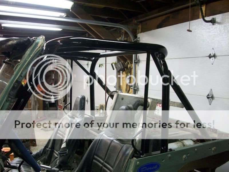

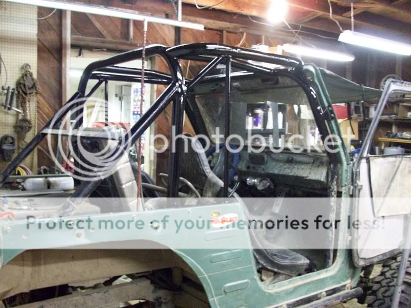

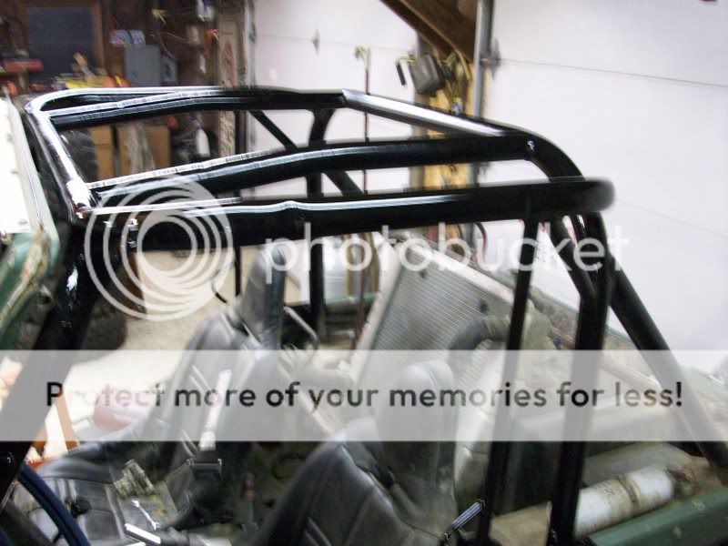

It's not so much the bender, as it is building off that existing rear hoop that was there. I should have just yanked it out, and started from scratch. I'm getting pretty decent with the bender, you just have to take your time, and learn how much it springs back. I almost always underbend, then work it to the final fit.

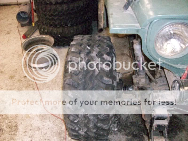

I'm going to be looking AT yj springs, I don't know if the centering pin is in the right location for a straight bolt in swap. I've asked two people who have yj's, and neither has come back with an answer yet.Basically it's whatever looks and measures out to work.
I finally got the rest of the cagework done, I'm not happy with how it turned out, but it's kindof growing on me, and I've got Ideas of adding a little in the rear in the future, so maybe I can make it all work. If not, THEN I'll rip it all out and start from scratch the way I should have in the first place.
I've got to feather the paint back on the old stuff, and give it a nice coat of shiney black, and it's ready to wheel. I'll get some pics up after paint.
I got teh YJ springs on my sami. i can take some pics of where the mount on the front and back if you like? i believe the rear spring center pin is in the same position as the sami but i know on the front you have to extend the front frame 6" to mount the front spring hanger and center the tire under the sami. let me know
