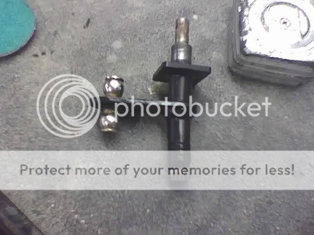

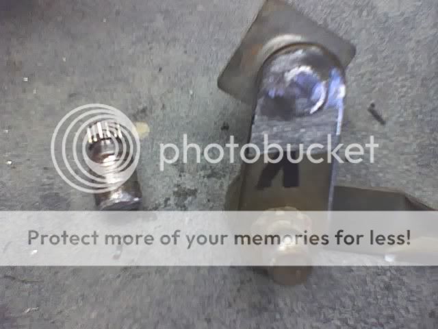

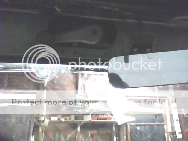

Small progress. Since the build, I haven't had windshield wipers, or rather a motor. Because the original motor was locked up. A samurai wiper motor will work, but with the roll cage, the motor wouldn't fit anyways. So I came up with this idea after using the linkage to manually wipe the windshield.
So I used an old Ranger window regulator and crank handle, cut the stub that the handle fits off the regulator, and welded it onto the back of the drivers side wiper stud. This is what I came up with, and it works great. And best part is, no wiring. :D

Oh! I thought you were saying you used a power window motor for it, not just the hand crank type regulator.

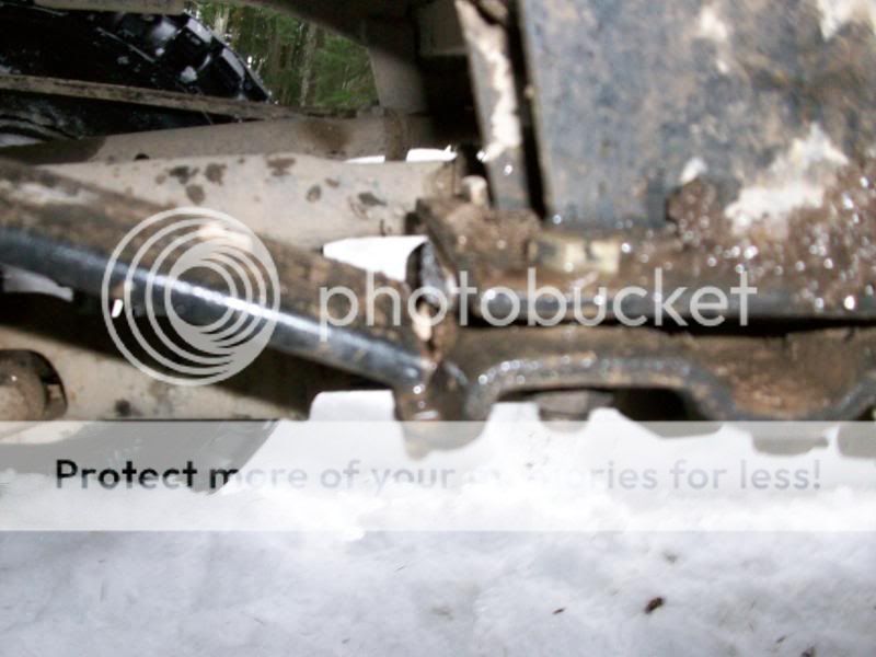

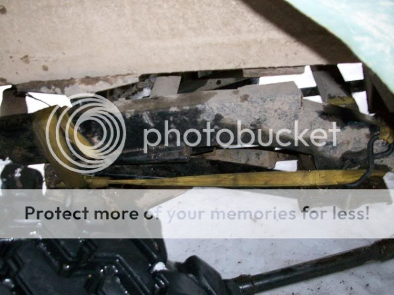

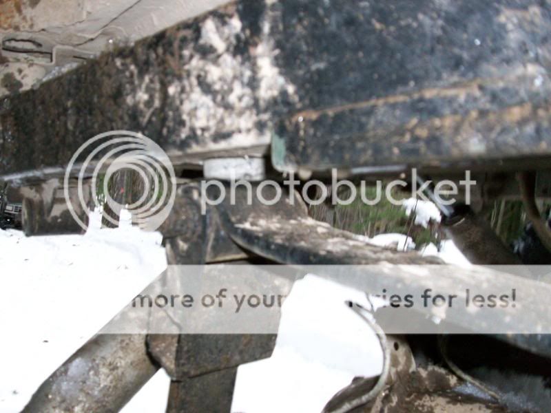

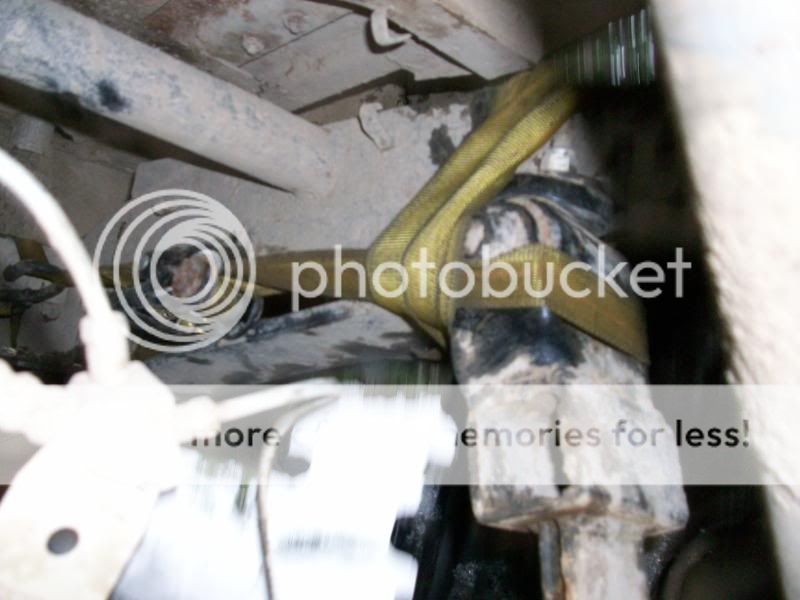

Today I broke another halfleaf on the back, this time it was the dodge leaf running mono, so the back corner collapsed. The axle was still held by the links, and the shackle was supporting the rig somewhat, so I ratchet strapped it together so the leaf wouldn't fall and pull the shackle forward.

So for now, I'm going to run the good monoleaf on the left side, and the old set of ranger leafs on the right side, that should get me through wheeling this next weekend, and then I'll swap them out for the set in my ranger. We used Exploder springs in the back of my dad's ranger, so his old set of ranger springs will get cut in half, and used in the LJ.
It has also come time to replace the front springs, which if you remember are Datsun pickup rear leafs. I have another set of mainleafs, but not complete packs, so I will probably end up mixing and matching some leafs in. The other option I've been researching, is Pinto rear leafs are the same dimensions, 47" eye to eye, 2.5 wide, but the centering pin is at ~19" compared to the Datsuns ~21.5. So it would essentially move my axle forward another ~2.5" which would be nice, other than the fact the steering box is already as far forward as it can possibly be. It's either that or move the rear spring hanger back 2.5 inches.... :dunno:
