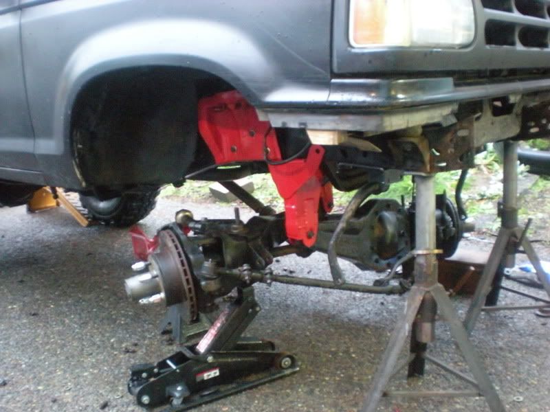

I got the rear lift on with my shackles and add-a-leafs... gave me roughly 5" of lift. Ive been working on piecing the front lift together. I was going to use some 4" springs, a small spacer, 3/4" or something, 80-96 F150 quad-shock front shocks, My JD 3.5" drop brackets that I added another 1-1/2" to, and some homemade extended radius arms. Got the drop brackets and D35 back in:
Then I stumbled across a CL ad and contacted the guy...
Complete rancho 6" lift, Rancho extended radius arms w/brackets, drop pitman arm explorer 8.8 and D35... Scored it all for $300!
So I got everything pressure washed and painted up tonight, tomorrow im going to start putting everything in...
More tomorrow...

Well I got most of the lift in today, all I have to do is drill the holes for the radius arm brackets, and a bunch of little things. Ill probably have this thing on the road by saturday. Painted everything up red and black and it looks killer!
Shes sitting back on all 4 wheels now:
Here is some pics of the lift:
The steering needs a little work, Im going to do a toe-in/out job on it and see how it feels, if its not too good, im going to have to find a 4" drop pitman. Either way, a little bit down the road, its going to get my version of the stonecrusher setup. It also needs a little fender trimming, fronts rub on the backside of the front fenders. Good news is so far there is no clearance issues with the rancho radius arms.
